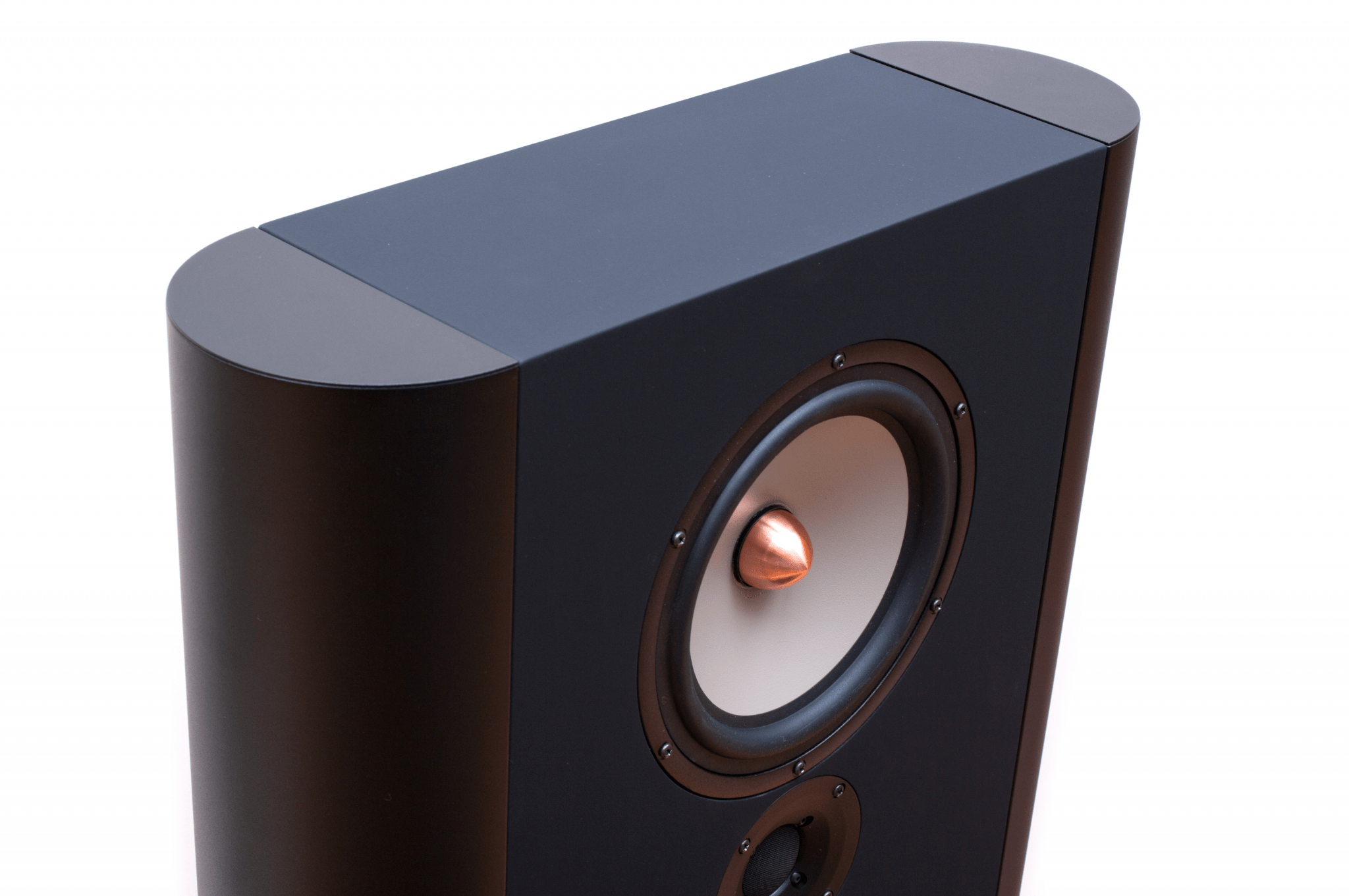

Agree, in case of a 2 way with 1" dome + 8" woofer I would add roundovers such as these:I went to extremes to eliminate nearby (to the speakers) diffraction objects. To me this is critical in a playback system.
"Avalon" style faceted baffles being a practical way to do it.
Funny you mention Avalon.

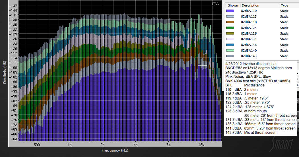

To get an idea of the relative levels from two meters distance compared to levels at the throat, I did this inverse distance test while evaluating HF compression drivers:
Even the B&K (Brüel & Kjær) 4004 test mic (<1%THD at 148dB, 130volt power supply) could be driven into distortion at the throat of a compression driver where levels can exceed 160dB peak.

As shown in post #10508, throat SPL may be 30dB higher than level at one meter. Peak levels could reach in the 160dB range.Well, IRC, when I place the mic in the throat of the horn, on the drivers exit...I can run out of headroom well before reaching high spl, in particular in the lower mid bass.

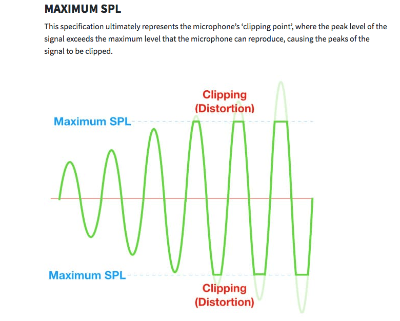

The back electret condenser test mic you use has a maximum SPL level, above which the waveform is "clipped" off- it can't put out more level.
Though the fundamental frequency reaches a clipping point that won't go any higher, regardless of SPL, clipped lower frequencies result in harmonics within the audio band. The lower the frequency that is clipped, the more harmonics fit in the audible range.

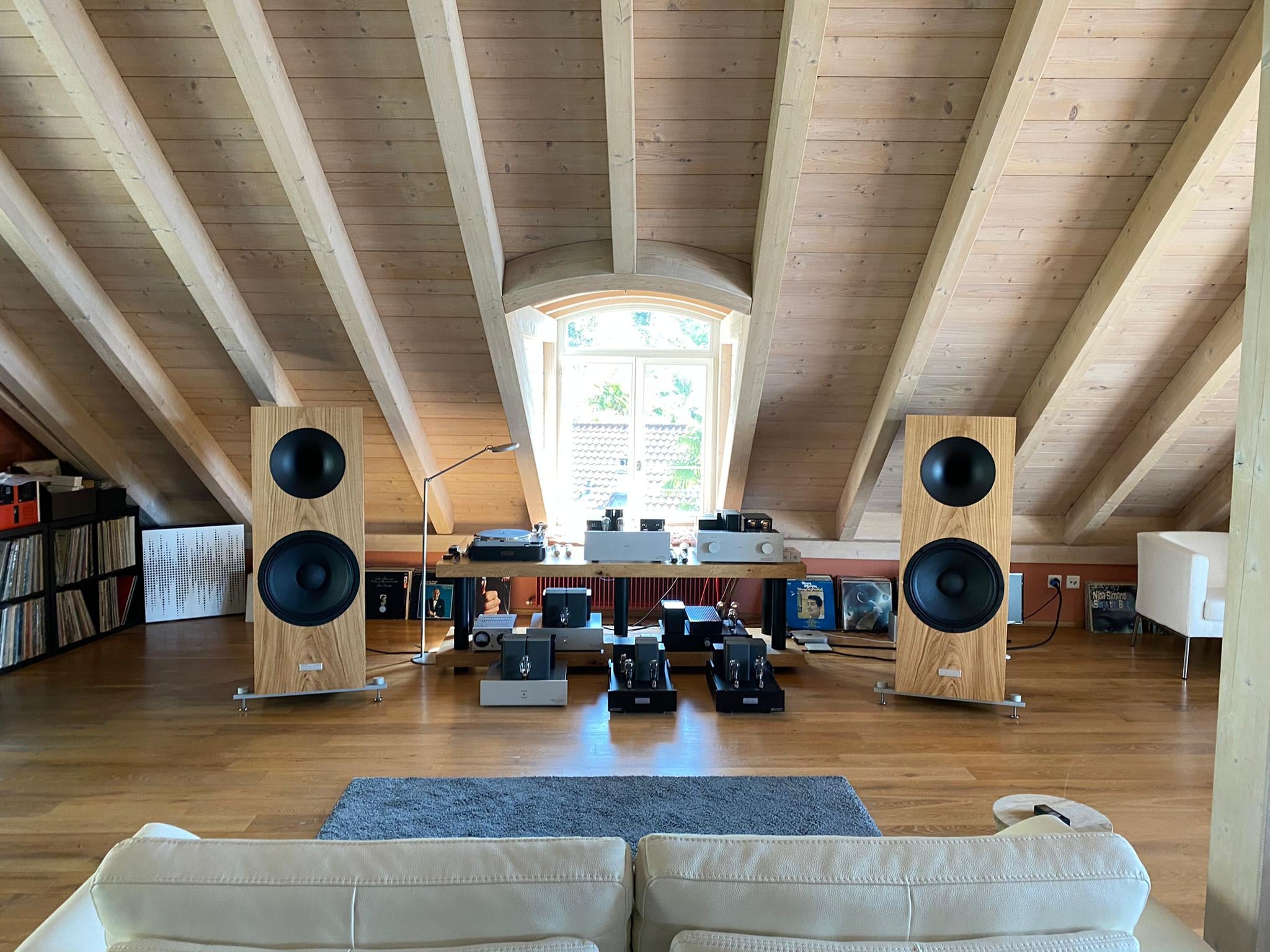

is that your system? if so, good job. any links to the projects?300 Hz seems plausible, even with an undersized horn, judging by the products from a Swiss guy, mentioned earlier in this thread.
He recently launched two 2-way systems. The first features a 15" + 4" comp. driver and his latest creation is a scaled-up version based on the same recipe: 18" + 5" dia.
View attachment 1021095 View attachment 1021097
According to the specifications, the crossover freq. of both systems is 300 Hz.
The 15" is probably equipped with the RCF ND950 2.0, because he almost exclusively used RCF drivers before.
For the 18" version, the Axi2050 is the only option.
Here you can watch a short video of the 18" in action.
