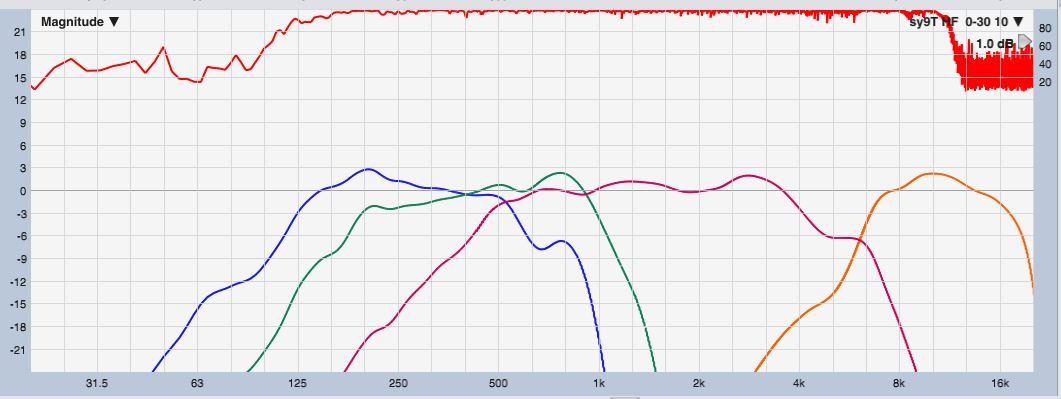

Here's the raw on-ax responses using the BMS that i have to work with:
The traces will be obvious to you, but for clarity to all...
Blue: two 10pr320" low-mids
Green: four 4ndf34 mids
Red: bms 4594 he HF section
Orange: bms VHF section
