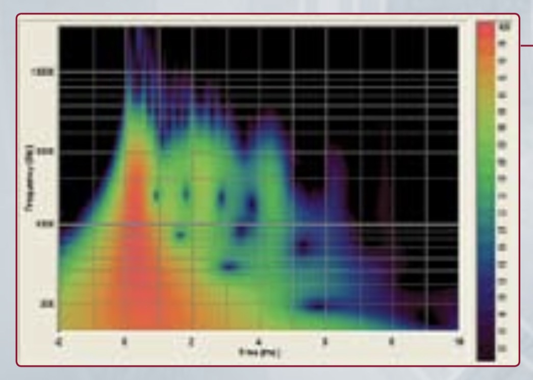

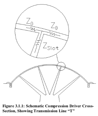

David Gunness describes the reflections within the phase plug in this 2005 white paper:
https://www.fulcrum-acoustic.com/wp...ker-transient-response-with-dsp-2005.pdfAudio Engineering Society
"The openings in a phase plug are arranged in such a way that, from any point on the diaphragm, the path to an opening is relatively short. The designer of the compression driver intends for all of the sound power produced within the driver to leave via the “nearest exit”. However, a significant fraction of the sound energy arriving at a phase plug opening will either continue past it or reflect back from it; in either case arriving later at other phase plug slots where the sound is divided again, ad infinitum. Rather than a single acoustical impulse, the response exhibits a decaying sequence of impulses. "
Figure 3.1.1: Schematic Compression Driver Cross- Section, Showing Transmission Line “T”
Acoustical horn resonances and mechanical radial resonances in loudspeaker cones also may be corrected with pre-conditioning filters.

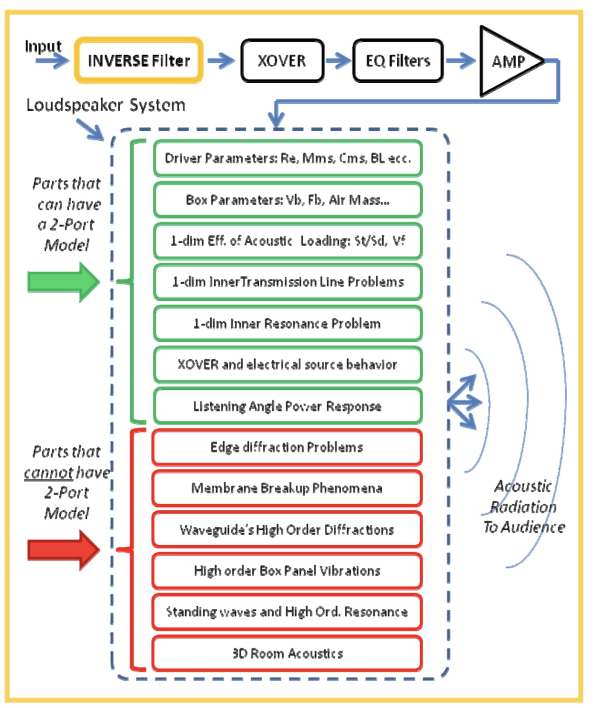

Cool. That's getting to dig deep in.“tq” or “Focusing” is a multi-stage process, with several different filters being convolved for the final result. I’ve installed a fair few Fulcrum boxes now, and they all got opened up to look inside. Measurements of the cabinet with and without processing, plus measurement of the amplifier outputs helped switch on a few lightbulbs.
It's been educational for me to run transfers on FA's Q-sys containers, and ponder them against the speakers they go with.
The original Gunness patent clarifies the actual steps in more detail, and other folks’ papers expand on it further. I’ve had chats with various folk in the pro audio world about this over the years, and the process typically involves measuring a lot of devices and making/refining lumped models of the behaviour to ensure it’s ‘fixable’. The Wavelet Transform is a very useful tool for this... Each filter is then typically synthesised to specified parameters, and combined with other ‘dark art’ to suit the manufacturer’s needs.
It's easy to see that a manufacturer needs to measure lots of devices given the prospect of unit to unit variability. It makes sense that a speaker model would be best tuned to an average of a number of units, just like a single box is best tuned to a spatial average.
It seems to me this is where DIY has a little advantage, and can safely tune a specific box to tighter specs than manufacturers can.
I had the good fortune to briefly meet Dave G at a trade show and tell him I was trying to copy his patent for DIY work. He laughed and was friendly and generous. At the time I was trying to understand his patent using a coax CD, one section as the driver and the other as a microphone to measure returning discontinuities. Told me that would work.

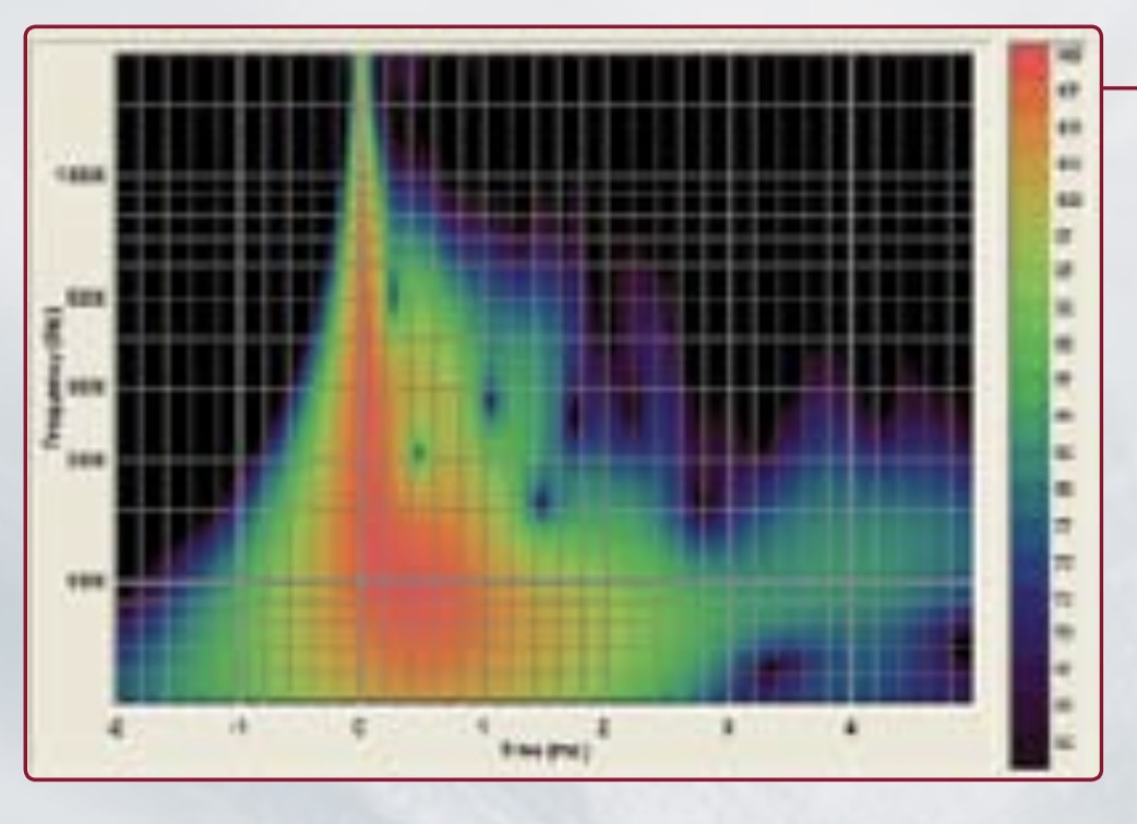

Forgive how blurry this image is - it's cropped from a low-resolution scan of an old EAW magazine advert - but think the effect of these phase plug reflections is a little more obvious in a coloured Wavelet plot than in the greyscale version on the AES paper:David Gunness describes the reflections within the phase plug in this 2005 white paper:

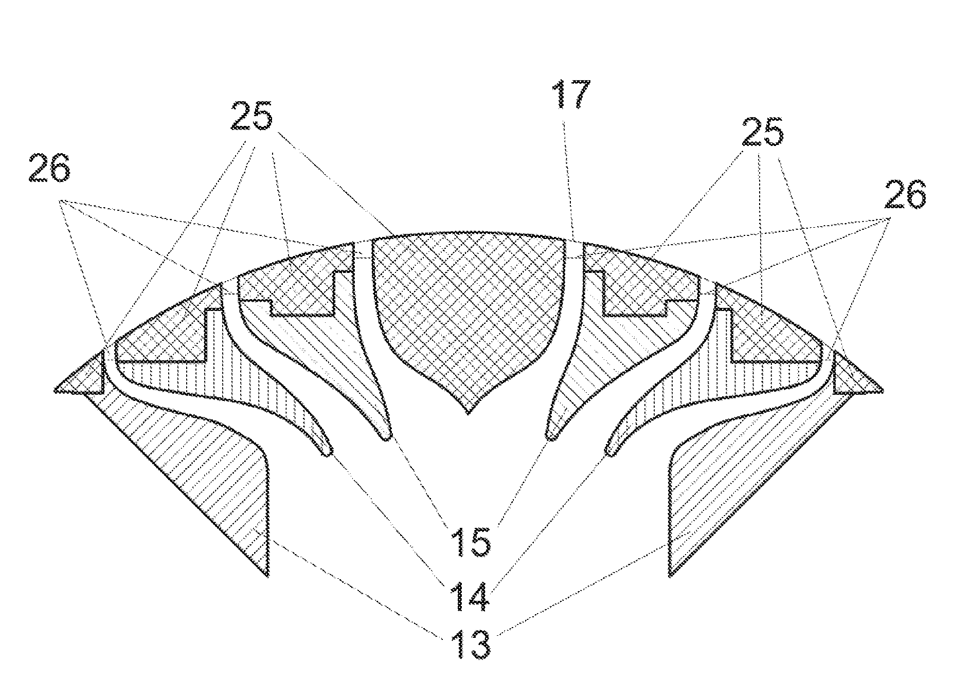

https://patents.google.com/patent/US20180234758A1/en?assignee=elettromedia&oq=elettromedia

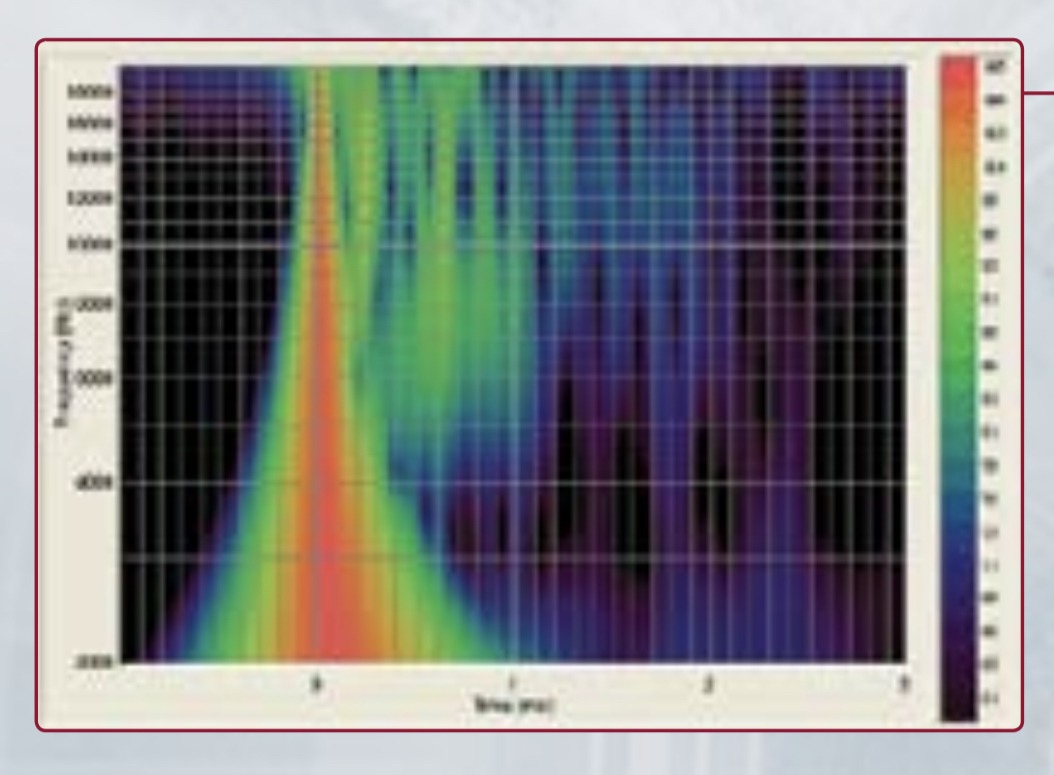

For the sake of completeness, here is the other pair of before & after wavelet plots for the original Gunness cone resonance filter:
These are acoustic measurements, but the filters are generated from two-port models, as shown in the Di Cola paper I linked previously:

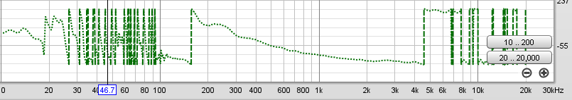

1/12 smoothing if I recall correctly
17.5" above center in Red
8" below center in blue
17.5 to the right in green
The above is without a XO and has eq on the top end. This voicing measured more neutral...outside, than what I get here in this crowded living room space.
The sound is very neutral...I can hear into the mix very well with these.. I listened first with the 300hz XO and was moved by the natural presentation of the music on each reference song I chose, Of course, I chose songs that I knew for a long time, and the voices sound amazing. The Victor Wooten bass solo sounded amazing, Then after I decided to listen without XO, it just got better lol. I had the cliche experience of hearing details I did not notice before etc etc....About 2hrs of straight listening btw.....I've things to do lol! But as a musician and music lover it can be easy to fall into a session like this especially when everything is so revealing. I definitely heard aspects of the songs that I feel would not be so easily conveyed by other systems....And I believe it has to do with direct energy.....the in your face-ness that can happen.....its just a large dose of direct energy drowning out the airiness of the room. Direct vs reverb, thats all.

You’re still not documenting your measurement data well enough to be useful to anyone. At what listening distance? What are the distances from source to boundaries?
Regardless, two initial comments:
1. The presence of strong comb filter effects from 400Hz up suggests that you’re either still hearing plenty of reflected energy, you measured with left & right speakers on, or both.
2. While you might like the sound for listening to music playback, a falling slope with a 10dB level variance even with a smoothed magnitude variance from 400Hz up is not a response that response of my studio clients would accept at the listening position for mixing or mastering purposes.

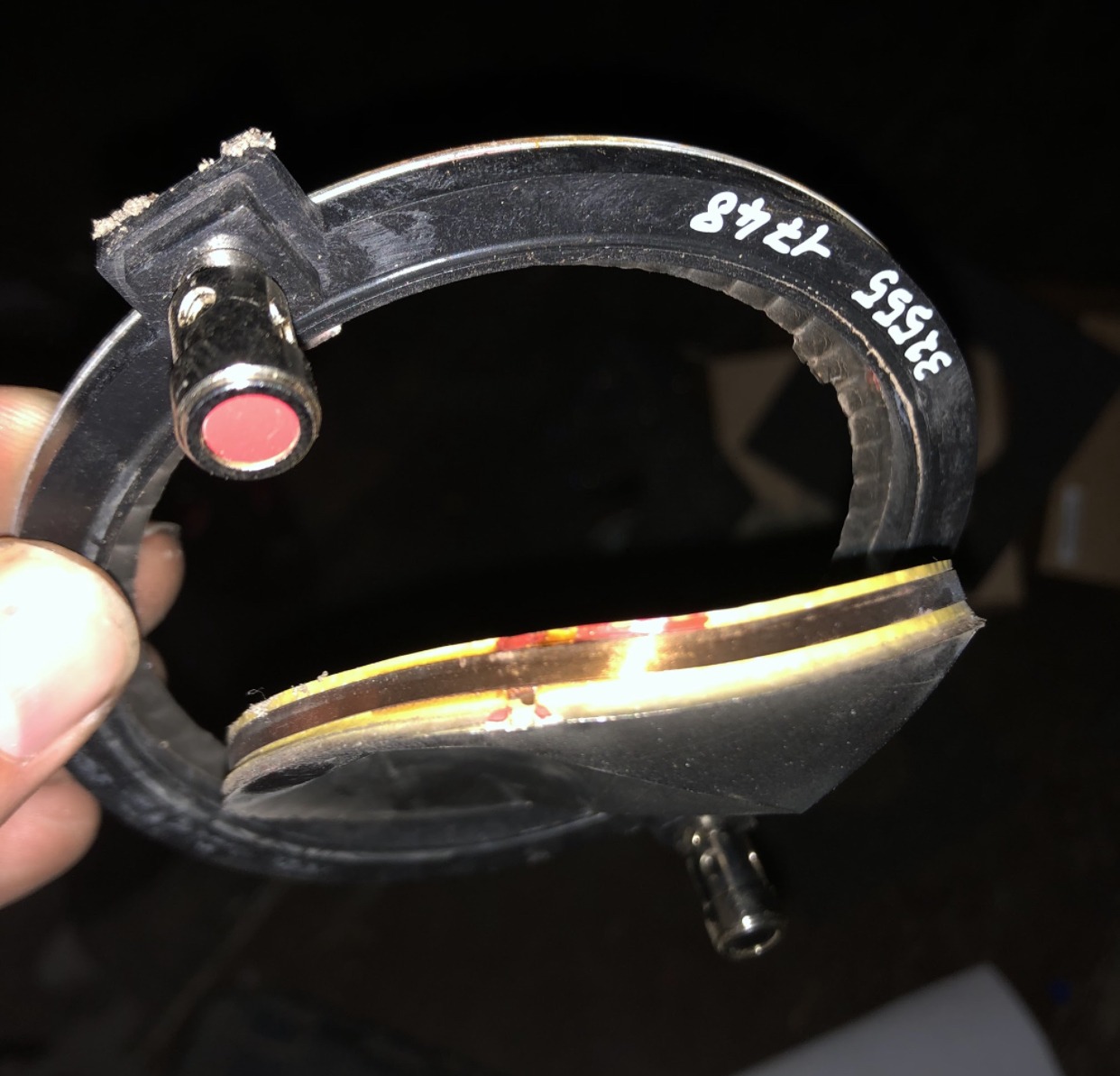

I would assume it was soft, considering, how "hard" I've driven it and never heard the "clacky clacky" thats supposedly supposed to happen. I couldn't even tell you what the sound sounds like lol....anyone got a video or recording of said event.The Axi2050 has a "hard bottom"
If xmax is generally conceived as 7-10% at xmax. What happens at 65%? How about a 142%In your "outside horn May 30, 2022 12:05PM" measurement (at 3volts?) THD has reached 102% at 100Hz. The previous test "300hz 12db bessel and better" has distortion about -8dB less, indicating the shallow crossover at 300Hz is still too low if you prefer undistorted output, and protection of the AXI2050 diaphragm when used for peaks exceeding one watt or so.
I'd guess that distortion increases until you hit xlim...Axi is not making this matter clear but at the same time I'm glad to not have hit xlim, if thats whats happening....

When the SPL of a harmonic rises above the fundamental, distortion is above 100%.If xmax is generally conceived as 7-10% at xmax. What happens at 65%? How about a 142%
The level at which you recognize distortion is another question, and is dependent on the order of distortion- higher orders are generally more objectionable, as they may occur where hearing is more sensitive.
Distortion increases drastically when Xlim is reached.I'd guess that distortion increases until you hit xlim...

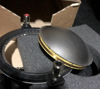

The Axi's titanium diaphragm can probably withstand a fair amount of hammering without fracture.
The same can't be said about aluminum or beryllium.
Art
Even titanium has its limits 🙃The Axi's titanium diaphragm can probably withstand a fair amount of hammering without fracture.
True enough!Even titanium has its limits 🙃
That diaphragm probably sounded bad for quite a while before the surround gave up.
