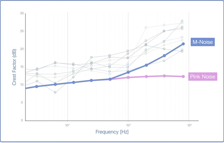

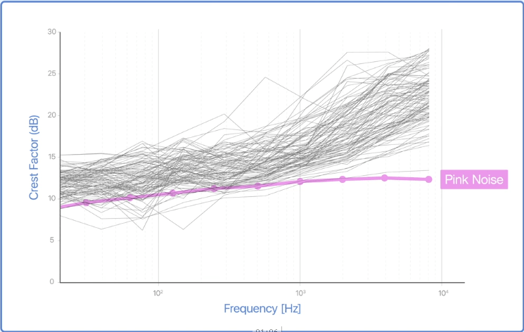

They just reiterated my earlier post but with better and more proper wording lol.....Crest factor generally rises with frequency as displayed within this chart of many examples super imposed upon themselves.
Can anyone interpret the frequency of this graph? Reminds me of how manufacturers use odd metrics to keep people from figuring out how things measure up.
The above graph is a visual representation of the data I sought to develop on my own using a fast acting RTA....I could use this graph to ball park the headroom profile I seek to create and expect of my own system vs the average levels I desire at desired listening distance vs......FREQUENCY.
my guess is that we have intervals at 100hz, 1000hz, and 10,000hz
I'd need to create a curve to superimpose over pink noise displayed at 1 octave scaling to make this information most effective or make sure to stay in the context of 1/3octave RTA
The 115db fork drop is arbitrary outside of how loud a real event can be.... it has no relation to an amount of gain over input signal making it useless to calibrate a system, only stating the dynamic requirement to recreate said event while still void of frequency specificity.
The above graph, if trustworthy, along with an accurate spl reading on an RTA would expose exactly where 115db takes place...likely around 1000hz or higher. Using the above graph putting 115db, 15db over an typical average of 100db.... which is easily 10dbs too loud. I can speculate that a more dynamic source like a movie might still hit a higher crest factor, reaching 115db peak while average will be much lower, since 90db is loud and all parts of movies are not.
I don't need 15db of headroom at 100-500hz...according to the graph above, 10db is more realistic. If aiming for say 95db as an upper monitoring level, which should be generous, then 105db would be transient level for that part of the spectrum.

One could use a pink noise source to voice their system in the shape of the crest factor trend line using a 1/3oct RTA... then take a sine sweep measurement to view thd levels of the predicted transient spl level....

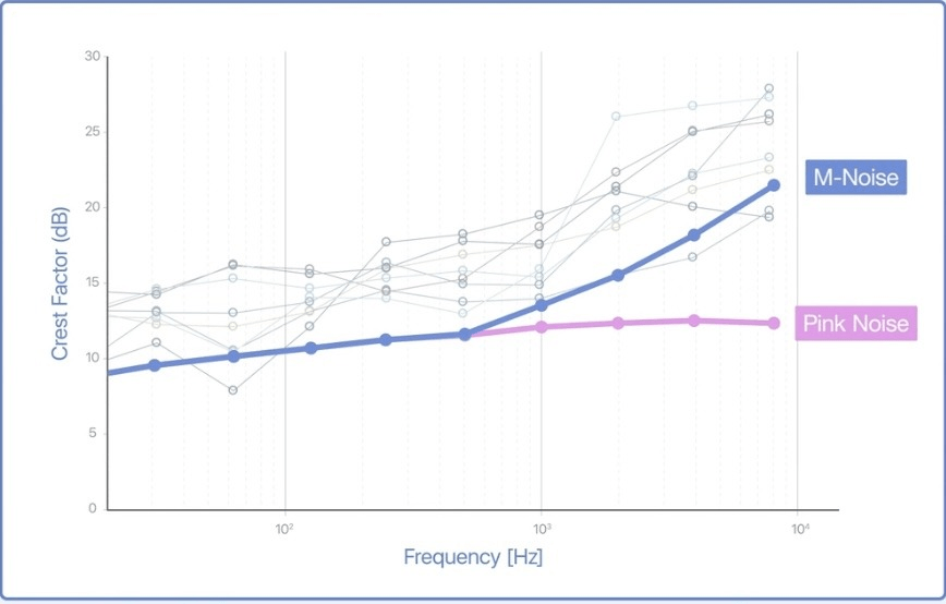

The blue line is an example of the Trend line you might follow to voice your system playing pink noise, for the test...Taken into consideration that pink noise is generally flat on a 1/3oct RTA, you would just adjust the idea for that.
Basically, after setting up voicing as described, run a sine sweep that is approximately 7db above desired listening level, at 100hz.
Another view of the potential test voicing curve...
As long as the idea is understood, one could choose a test voicing slope of their own discretion
