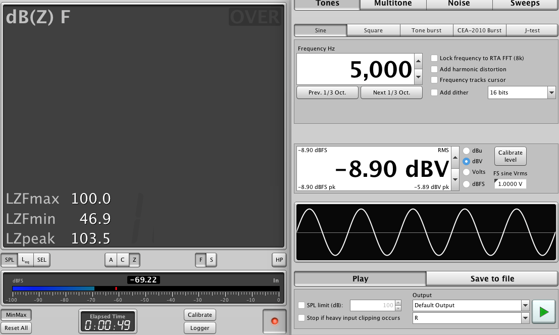

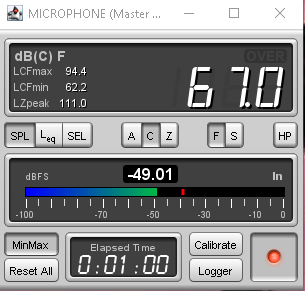

The EAW SMAART V6.1 (I still use) has three "speeds", Slow, Fast, and Impulse, each of which has specific time constants.
REW has two "speeds", Slow and Fast, and an additional L peak.
If REWs "LZpeak" was "Impulse", it would not conform to the usual definition, and would also not read +3dB (the peak to average ratio)over "LZfast max" when measuring a continuous sine wave (peak to RMS ratio of 3dB) .
What is the usual definition of LZpeak? I can't find anything for it; LZ Impulse using 35 ms is all i've found anywhere for peaks.
I think REW's LZfast max and min will read sine wave RMS, so LZ peak should read +3dB...
So I'm still thinking REW uses a 35ms weighting for it's peak.
Ivan's NTI meter does, and it seemed to read a bit higher than our anecdotal hand clap comparisons using REW.
Like that means something, guess he claps louder. Lol.
Time to ask John M i guess.

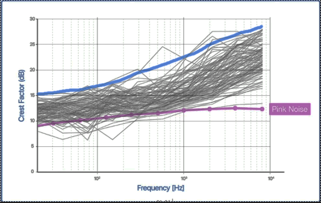

Peak is no less subject to the ideas of scientific sound quality than FR. A peak that is grossly higher than the other peaks will stand out very much.....Too much, if aiming for a balance, as music/movies tends to do. In particular, music that is meant for the louder listening crowd (EDM/RAP/ROCK).... If passage A is much quieter than passage B, in a classical piece. The peaks will still keep within a margin of error of each other.... The difference between Passage A and B will be similar to turning up or down, the gain knob.... Or the woodwinds will be lower than the brass section for Passage C..... so the peaks of the woodwinds will be in balance with each other, while the peaks of the brass section will be in balance with its selse while sitting on a higher shelf above the woodwinds. There will be more dynamic situations if one looks for them. A movie will on average be more dynamic, as whole....Think of a scene where the camera is viewing a very quiet field in the morning, and then a gun shot goes off as the hunter shoots at its target, the camera being his point of view..... It seems that in movies, no one wants to recreate the real dynamics of a chainsaw or gun shot btw....thats pretty important.
So thinking of the 115db Fork drop....Or 110db chain saw at 1meter...this establishes a basis for what real events can do....
We tend to monitor real life events at lower than real life level. Except in clubs lol. Peak is only as good as fast its capturing method.

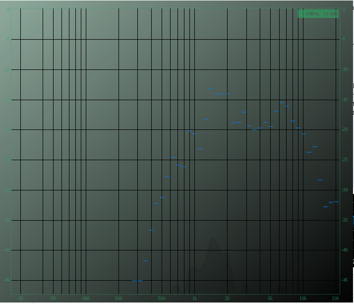

So I recorded my clap below, shown in peak and 1/3rd oct
True peak is 12db higher than what my RTA could capture. -13db vs -1db.
Placing a high pass at 3khz, created a -15db peak on the RTA vs -2.6 on the True peak meter
In real life this clap was about 120db meaning I'd have to crank the stereo to achieve it.

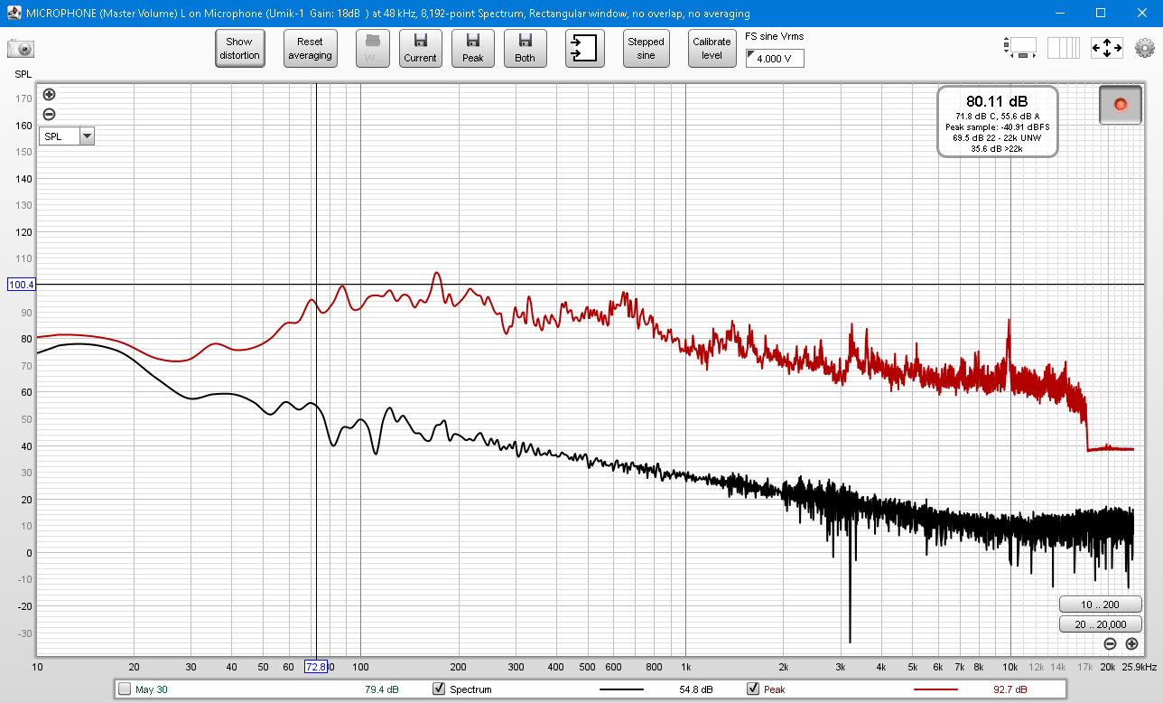

Another error I made was regarding the Adjust RTA levels....One should leave this option off....for truest spl reading... consider that in The RTA things are more or less weighted.
https://www.roomeqwizard.com/help/help_en-GB/html/spectrum.html
In other words RTA and Spectrum is really slow compared to the Lpeak. Actually its so slow it is comparable to RMS even though its called Peak within REW RTA with the Spec
Transients in the lower frequency might might be easier to catch. The greatest difference between rta peak and true peak in the test above happened in the mid range during a certain kick that come in periodically. The kick seemed to peak near 100hz at -15db, causing the True peak meter to hit -4db at times.

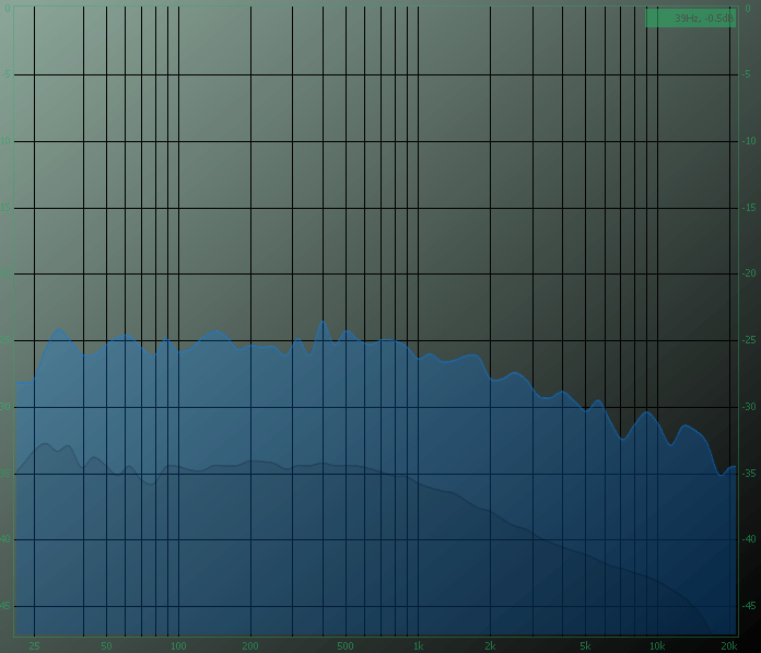

This is what a loud listening session looks like on the 4" two ways at almost 1m, using the same song.
It was that damn kick that drove peak to 111db Zpeak....and it likely lives at 100hz.....
So after all of that analysis in 1/3octave, the hook line and sinker is that Z scale, is the actual most neutral, way to look at the system.

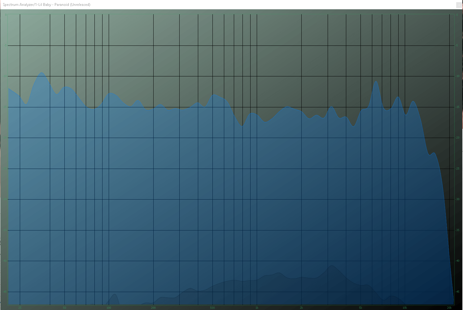

Below is pink noise on 1octave scaling...and please double check my work. Just know that in this setting, white noise appears flat.
the peaks of the music/movies are likely going to fall within a margin of error along this line, because everything is based off of neutral tone, with things typically falling with a range of each other. I made a prediction of those ranges above. I just noticed, the thickness of Meyer trend lines support my thoughts on my observations though I have only sampled a portion of what music could be. The thickest parts of the grey trends are about +/-3.5db....
You will also notice that in the sub area RMS and Peak can be very close....in Movies and Bass heavy music. Bass being, a lot of times, the most stressed system...Music/movies seek to maximize efforts here, regardless peak or RMS, conscience that there is only so much, yet desiring max fun factor....

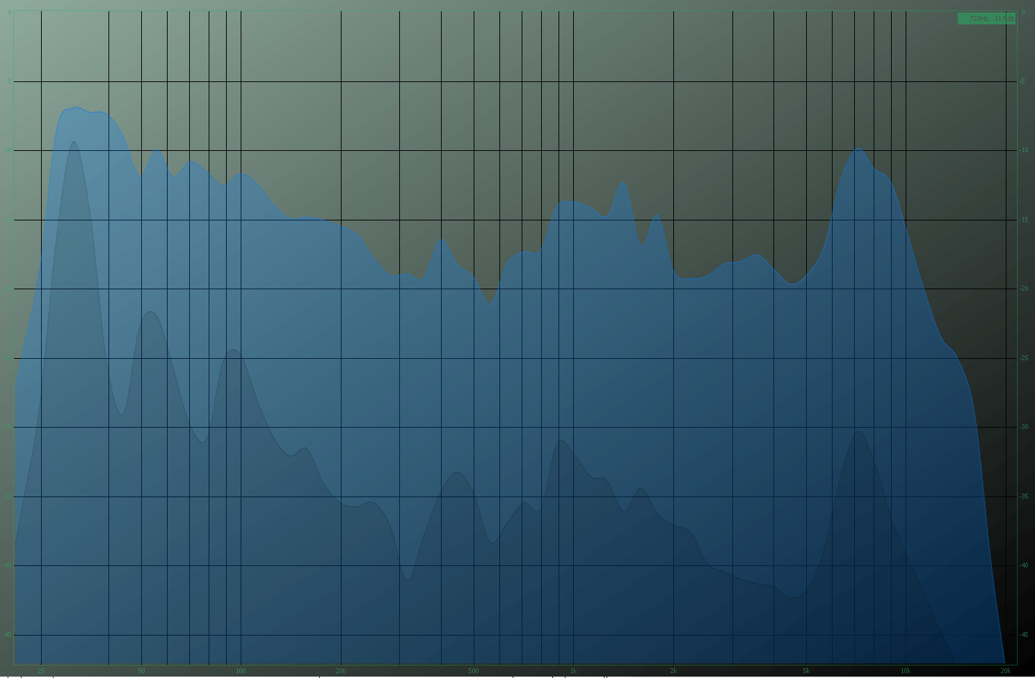

I pulled up "The Hulk" and checked out some loud areas
Notice the trend of peaks read by the RTA are as I described on this 1/3oct RTA. Plus minus 3.5db, in a round about way..... On the 1/1 FFT, this will be slanted like pink noise. The true peak meter maxed out at -4db which as about 6db than highest peak on the RTA......
One octave above vs 1/3 octave below, through the small two ways voiced with a slight bass tilt already.
Heres some white noise (black line) played under the movie curve, in 1/1 octave
The bass roll off of the 4" woofer is deceiving....Bass will continue to increase completing the trending line, on the 1/1 oct scale , using a system that is voiced neutral and more capable of covering the whole spectrum.

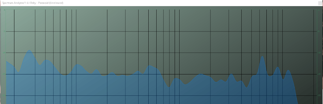

here is the Action Movie "The Hulk" The vast amount of stimulus fills out the peak range evenly.
Here is todays chosen song....The areas where there are no main instrument fundamentals, lag behind in volume, ~450hz area and ~3500hz area
Switching the move or song into 1/1 octave moves all the peaks lower on the HF side.

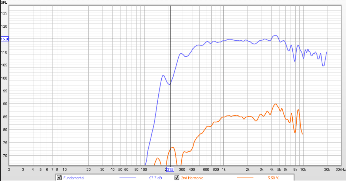

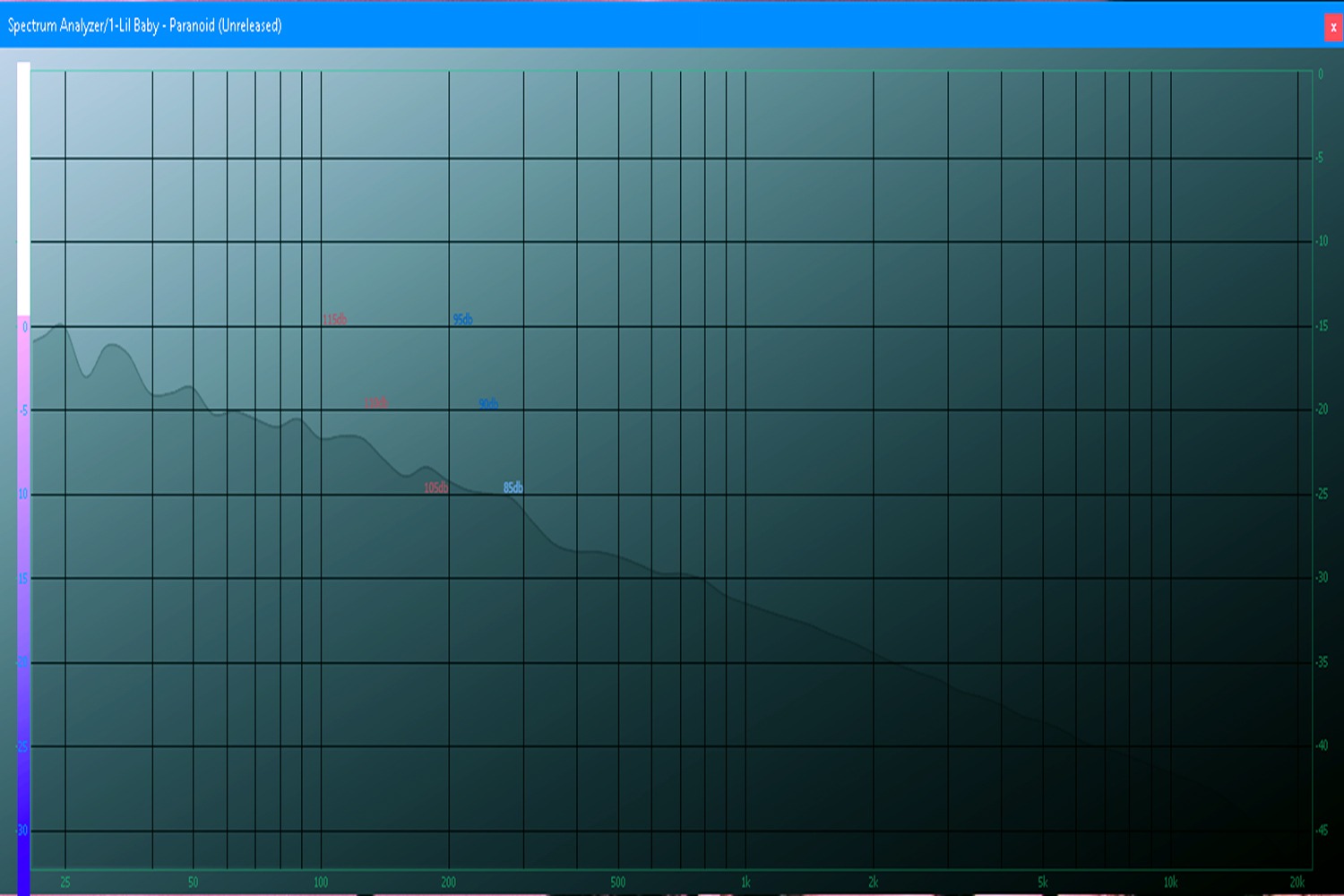

I placed the cursor at the highest 2nd order thd before -15db of ~200hz.....5.5% at 215hz...
The woofer is dominate according to VituixCad. Where the Horn , is down 15, the mid woofer carries the signal.
After attenuating the 2 peaks in the Horns roll off, in addition to a lr48 at 183hz, The driver is even lower at 200hz, about -17db, and everything below is receives a sharp reduction with introducing a higher GD to the system. The mid woofer has a LR24 low pass at 300hz. A KA of 1.5 points to 429hz which also happens to be -15db down on the midwoofer, where the horn is down 2-3db and dominating. So That means that I can be on axis with the horn without worrying about getting out of the sweet spot of the mid woofer. Even at 1 meter. I'd need to take a measurement with the mic in horn resting on the exit, at volume, to see what thd says below horn resonance in order to avoid excursion strain that will contaminate output of everything else.
These diagonal lines are approximate pink noise slopes on the 1/1 scaled graph, plenty of headroom, with 350hz achieving 1.4% 2nd at 108db at one meter. 215hz had the highest 2nd order thd above -15db on the first measurement. 5.5% at 97,7db..... This happens to remain 97db with the XO

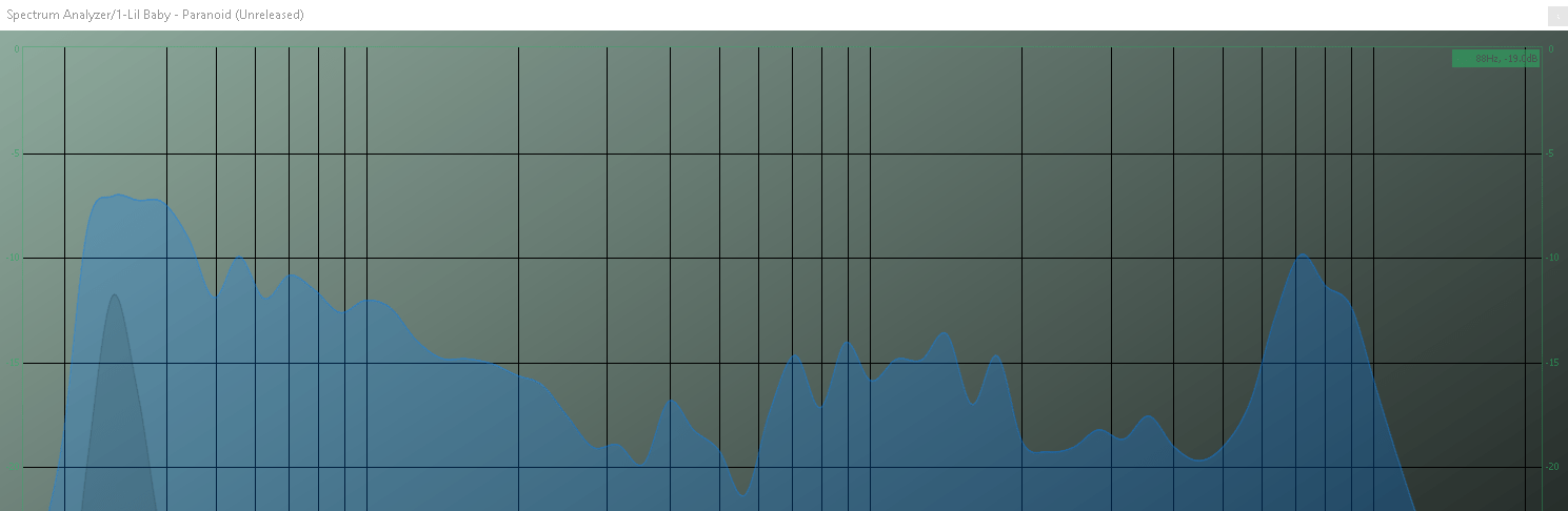

If you remember the Rap song that was balanced within 3.5db plus/minus on the 1/3oct...here it is on the a 1/1 scale
vs
@weltersys
Art, I'm replying to my own post in order to correct it, as I've confirmed that you were right....John M kindly replied to my inquiry on the REW forum.
His reply, "The peak reading is based on the largest absolute sample value seen in each block of audio data. There is no time weighting."
That's really cool and makes the meter even more valuable imo. 🙂
