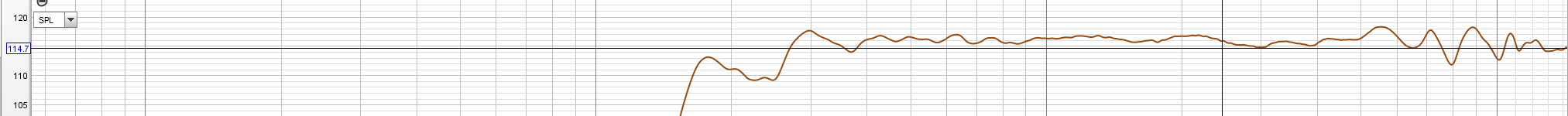

Now that you have explained that the lower trace was 2nd order distortion using a 48dB Bessel 200Hz HP filter, we can see about 1/3 octave down from the crossover frequency, H2 has risen to 18% with about 106dB output, and at 140Hz, 71% with only about 95dB output, ouch.I pretty much disregarded the 12" measurement and you inspired me to take the horn back outside and take 1meter measurements... Outside, I voiced the speaker and then I used the CEA2010 tone burst to test frequencies in the cross band for distortion, -4.5db on the gain sounded about right to me, as in, I shouldn't go higher this sounds distorted enough, then I ran a sweep as you can see in the last measurement.
A 4" direct radiator in a little box can do around 6dB more level at 140Hz with around 10% THD..
Looks like at 300Hz the horn is doing OK, it may reach rock&roll, or even hip hop levels near field without farting out using fourth order filters.
Compared to Butterworth or Linkwitz-Riley, Bessel has the widest, most gradual crossover region. Considering the horn's steep acoustic rolloff is not at all gradual, BW would probably be the better choice to maximize output above the crossover, while minimizing excursion (and distortion) below.
The CEA-2010 tone bursts up to "-4.5db on the gain" (whatever SPL that is) would be interesting to see the higher harmonics generated using the horn below Fc, and their peak levels.

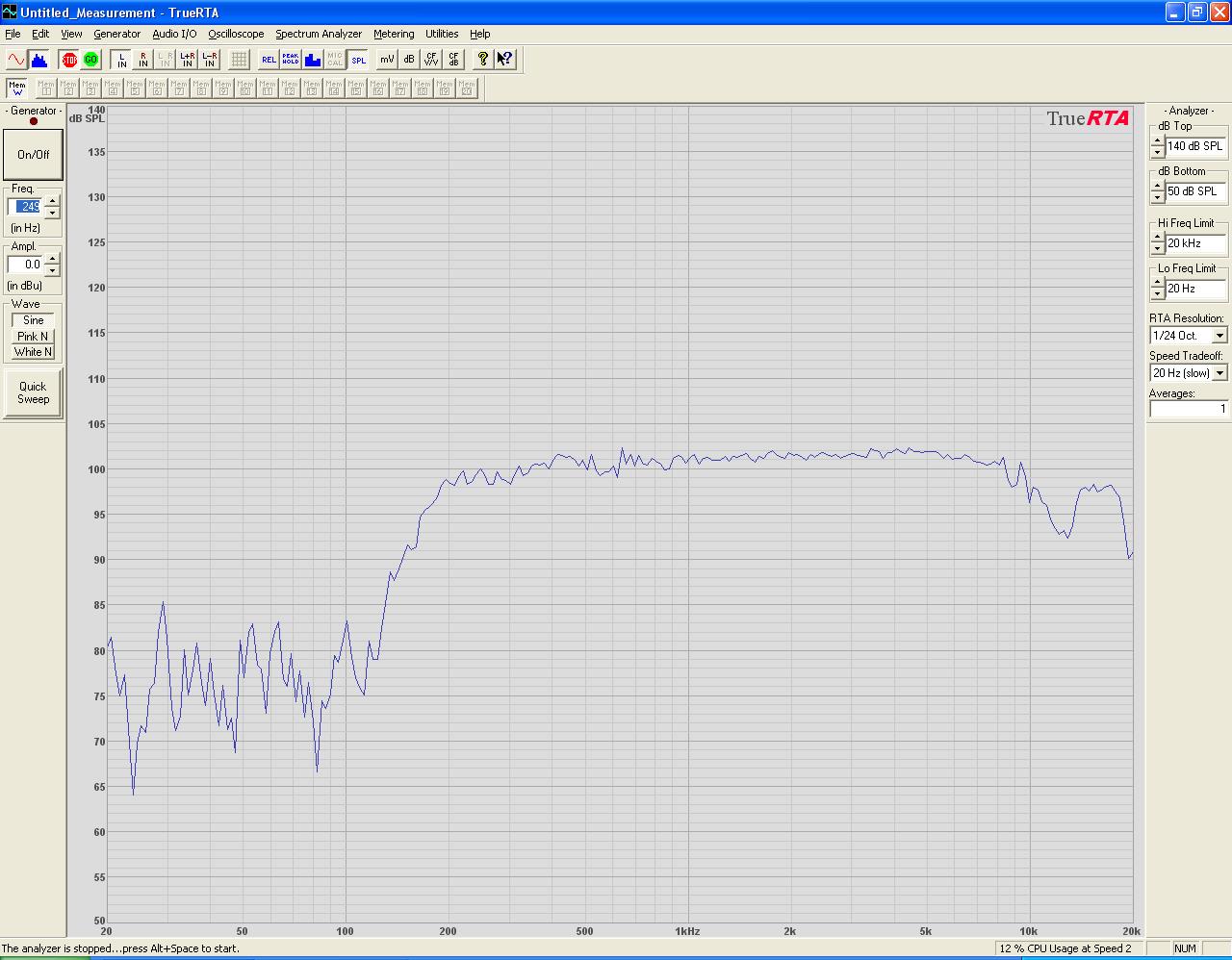

Why are you using a Bessel 48?Heres another outside measurement at 1m with voicing and 200hz 48db bessel.
Really, why Bessel at all?
Bessel has a handful of variations.....which one are you using?
-10db and -20db???? The woofer will be dominate.....Thd will not measure as high in combination.... But I take it this, is the way its done.H2 has risen to 18% with about 106dB output, and at 140Hz, 71% with only about 95dB output, ouch.
Its random, happens to be the top of menu for filter types.....Why are you using a Bessel 48?

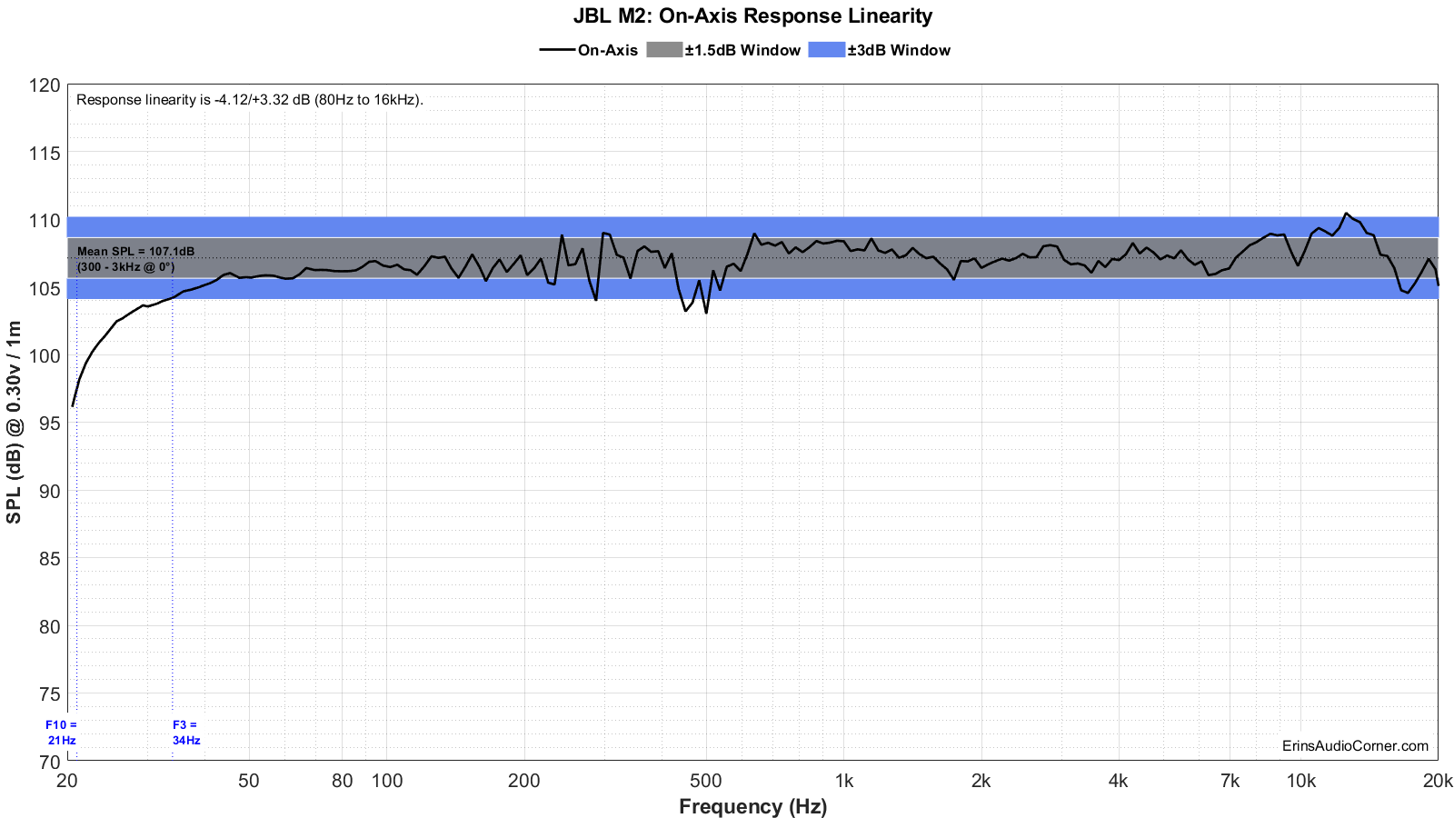

At 77db theres enough headroom...
The levels in the graph are on average, higher than whats needed for 85db.
Thanks to dsp, the xo point is never set in stone really. 200hz causes the image to be much more centralized to the horn. My experimentation hasnt been with the drivers in proper configuration. I still think this temp, improper, situation is being used to expose the cracks. I said already that I believed the horn to deliver more directivity at 200hz than the woofer but more experimentation is warranted. A lower xo also is more friendly to close sitting positions, another aspect that puts strain on the tasks at hand.
Which one of you ran out of headroom using a horn/compression driver at 1m? What was they xo point and horn cutoff? Is this rhetorical ☺️

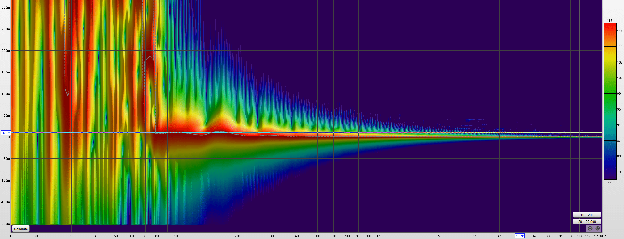

He actually had the same conversation with me here....part of that formula involved taking measurements outside, so of course Rew has decay and the bunch....The initial measurements I took, I shared the Rew files. One of the advantages of a big horn, I think, is having the resonant note placed low in the room mode territory....like BR, no one can tell the difference between a good vented and sealed design until the rooms rt60 gets very low. The decay isn't grossly out of pocket on the resonate notes and nearby harmonics but they are in the burst decay.Recently Mabat commented in another thread that horns/waveguide could exhibit resonance at cutoff freq and that the way measurments are presented kind of 'hide' the effect ( well this is how i interpreted it).
1/3oct Burst decay
wavelet 1/24 res
The FR is like +/- 4db with minimal effort.... +/- 2.5db in some areas and +/- 1.5db from 400hz to 5khz...... How good do you think I should aim for? Of course when it comes time I will let Audiolense do its thing to a target curve....The first thing we hear it the frequency curve.

The resonances of your horn+Axi2050 are all 'textbook' phenomena.
At the low end these are primarily horn related and >8 Khz the diaphragm dominates.
The wavelet only confirms the previous predictions (based on the K+T test).
