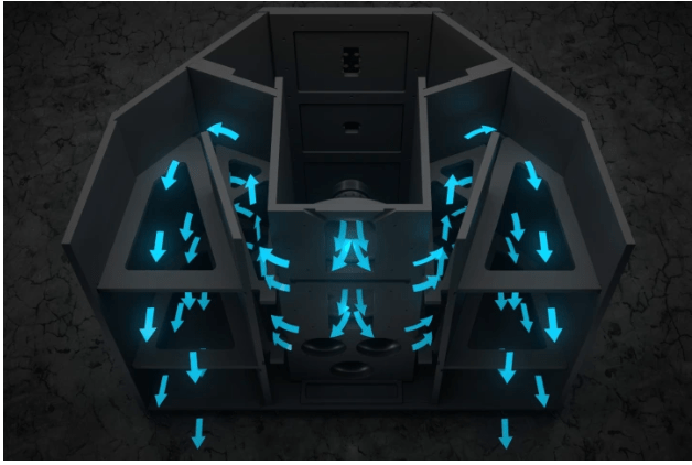

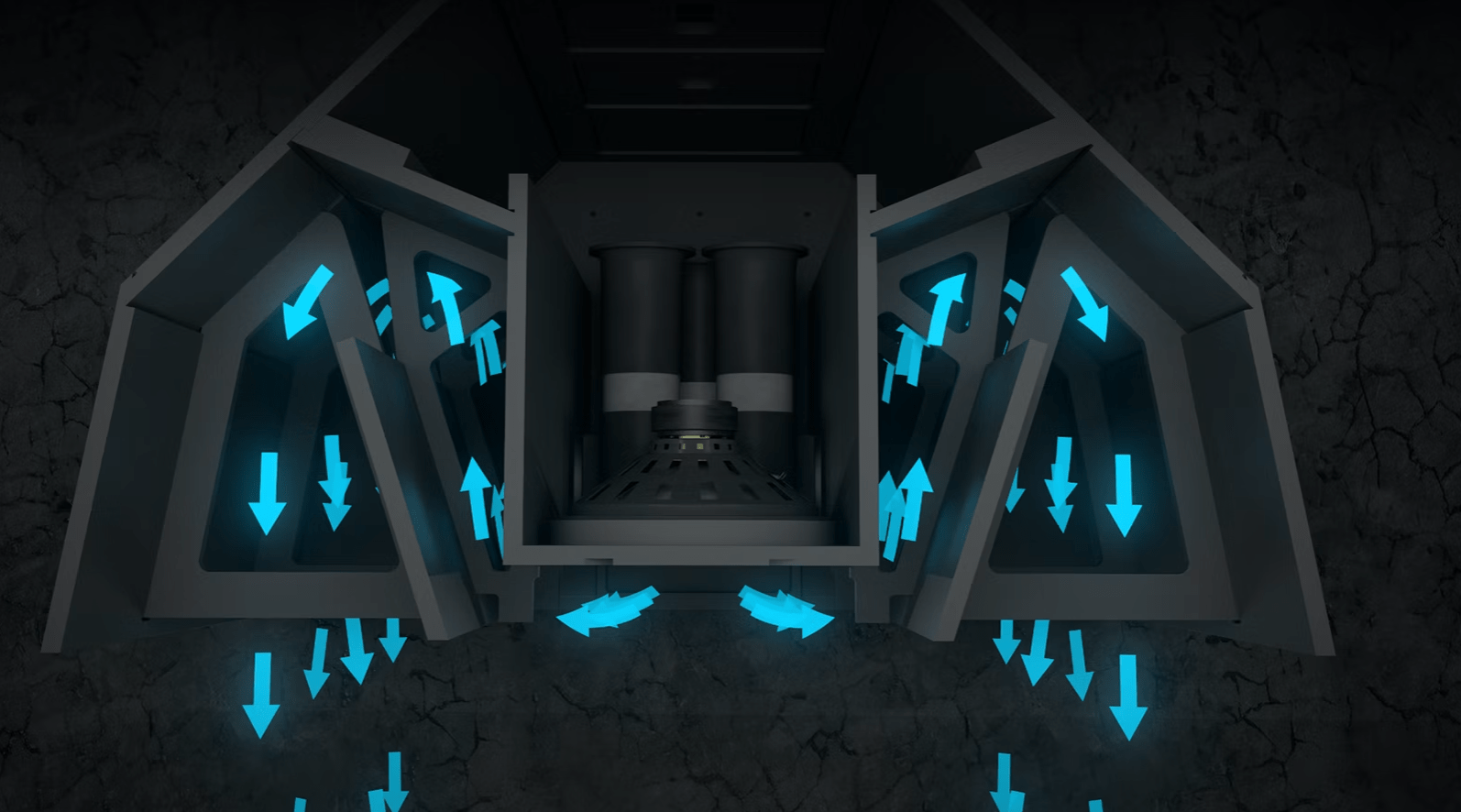

The front horn of the Jubilee would serve as a wave guide for the bass produced by the BR Ports....while lacking actual loading in the sub area the, the waveguiding should increase directivity would it not?
How does one figure out the Low pass filter affect of the Horn bends? There will be a cancellation based off of the Slot in front he woofers and ports. The Jubilee has slot sin front of the woofers just like the La scala...What for?

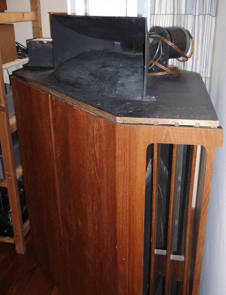

Yup those are it, after pulling my drivers I was a fair bit off on the angles of the throat I believe. I have the extra adapters not pictured for the threaded drivers as well. I did however get some measurements, and the horns load the driver below 300hz without any issues. When I'm at my pc I'll try and upload some measurements.
The horns are basically clones of the old (tar-filled) Altec H-1005.
Several US-designs were licensed to European companies.
Vitavox manufactured its own variant of the Klipschhorn, the CN-157, including a modified, metal version of Paul Klipsch's wooden radial horn.
Vitavox:
Klipsch:

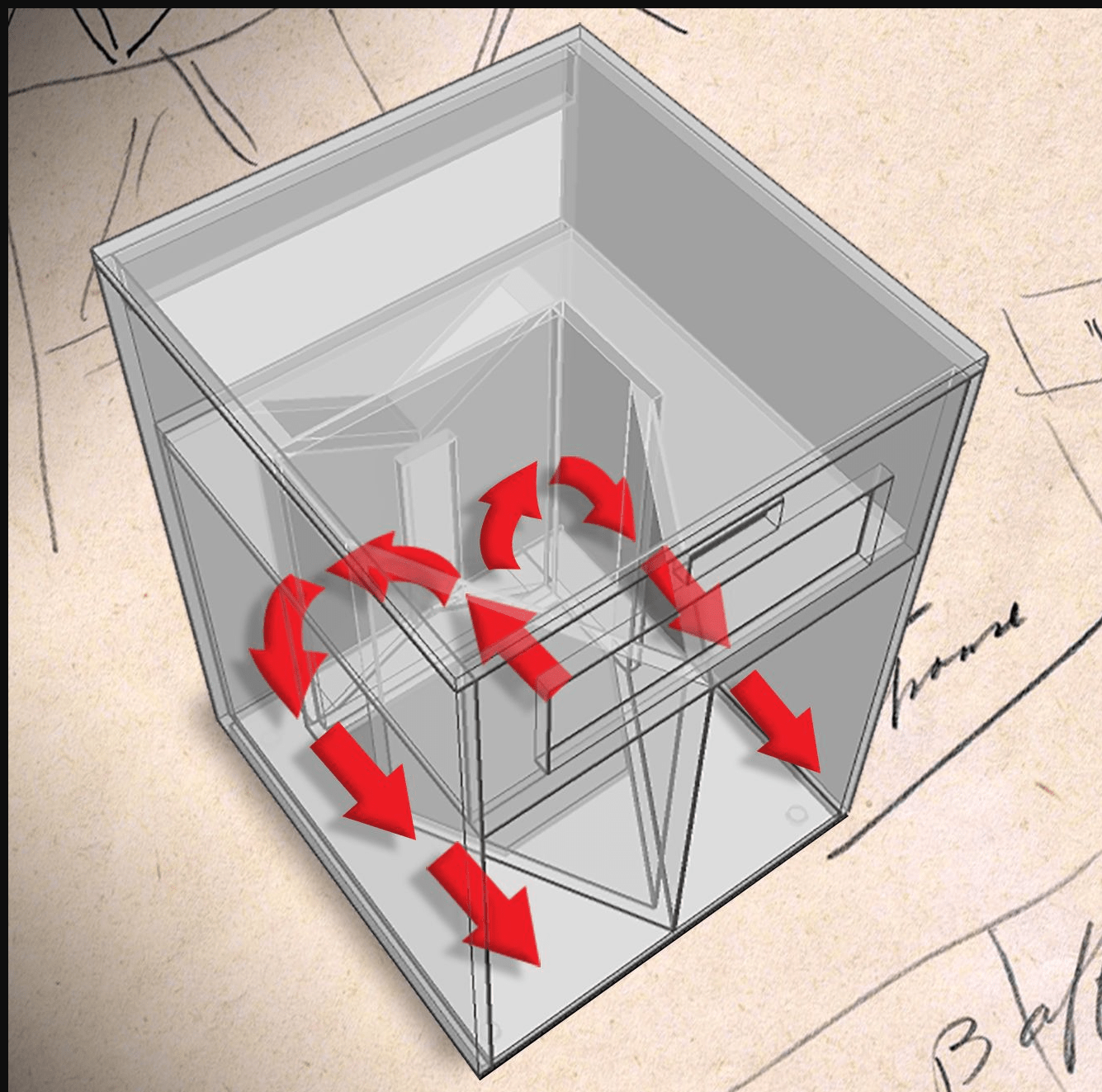

No patent for bass reflex combined with horn loading.
The Fb is down in the 25Hz range, the "waveguide" is not large enough to increase directivity much at all for waves 10 times the length of the mouth.
By measuring a straight version and comparing it to the folded version ;)
Increasing the throat to mouth ratio is good for efficiency, a requirement for a 12" driver to keep up with a horn loaded HF compression driver.
Reactions: 1 user
Camplo wrote: "The Jubilee has slot sin front of the woofers just like the La scala...What for?"
So bear with me, I crossed these bridges 25 years ago, so I'm a little foggy. But my recollection is the slots tend to damp resonances and widen midrange dispersion and coupling into the horn mouth. One of the difference between my bass horn design and Martin Seddon's which you showed with the AH-160's is that my bass horns used EV12L drivers in compression enclosures. In my case the 12L's were slot coupled for the above stated reasons. So in addition to minimizing and smoothing the folds with Hyugens wave reflectors, I slot loaded the 12L compression drives to improve mid coupling to the hyperbolic exponential bass horn. This too help smooth the critical 300-500 region simplifying filter design. This may be part of the reason my bass horns have such flat FR. This was my approach, not necessarily the best one.

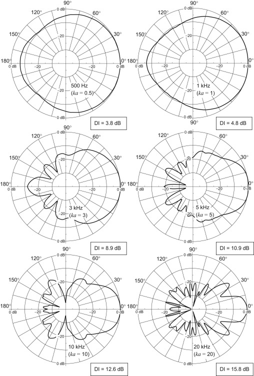

Doesn't source size have an effect on directivity even in the omni parts of the passband. For example, the direct field will extend farther for a 15" woofer playing the same note as a 6" woofer on the same baffle... while this note is in the area considered omni or larger than either diaphragm

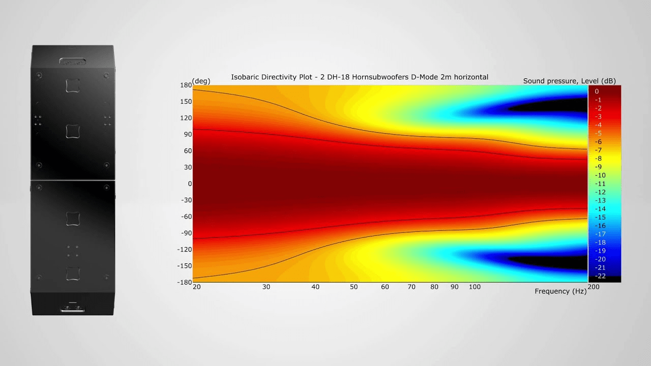

Directivity is just a measure of how the horn direct its energy into the environment. As charts below illustrate directivity changes with frequency. Low DI corresponds to wider horizontal or vertical dispersion. High DI here starting at 5khz translates to increased beaming and lobing as frequency moves toward 20kHz. The horn mouth accepts energy from the driver. The horn throat directs energy toward the flare. The flare couples energy into the environment usually in a controlled fashion.

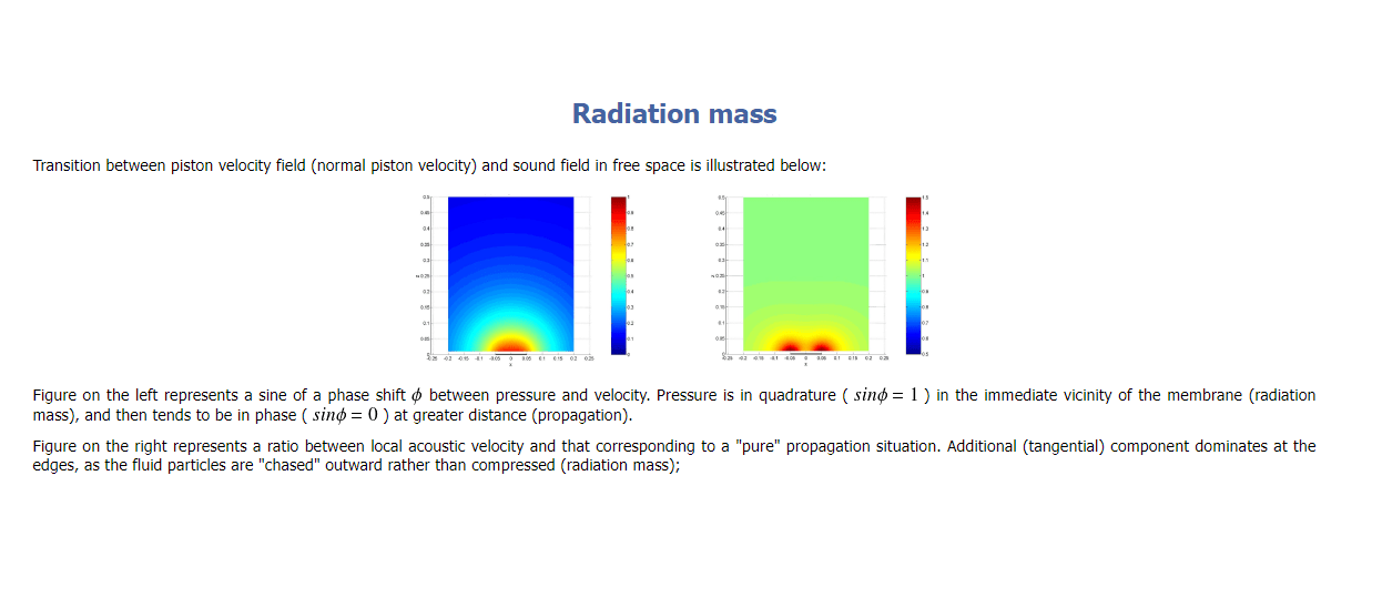

But you probably mean radiation mass/impedance?
Thank you for clearing that up....I am definitely talking about the radiation mass....Larger area of radiation, have larger radiation masses that equate to a higher degree of direct energy to the listening position than a smaller mass.
So with that in mind, I am thinking that the Mouth of the front horn in the Jubilee serves to increase the radiation mass, thus increasing direct energy , also increasing efficiency?
Reactions: 1 user
The radiation mass of my horn is larger than my 15" woofer as long as above cutoff I suppose...below cutoff the mass shrinks into the horn.... but what if the driver can keep up pressure without loading? Seems the horn would still maintain the larger radiation mass due to line length and mouth area.

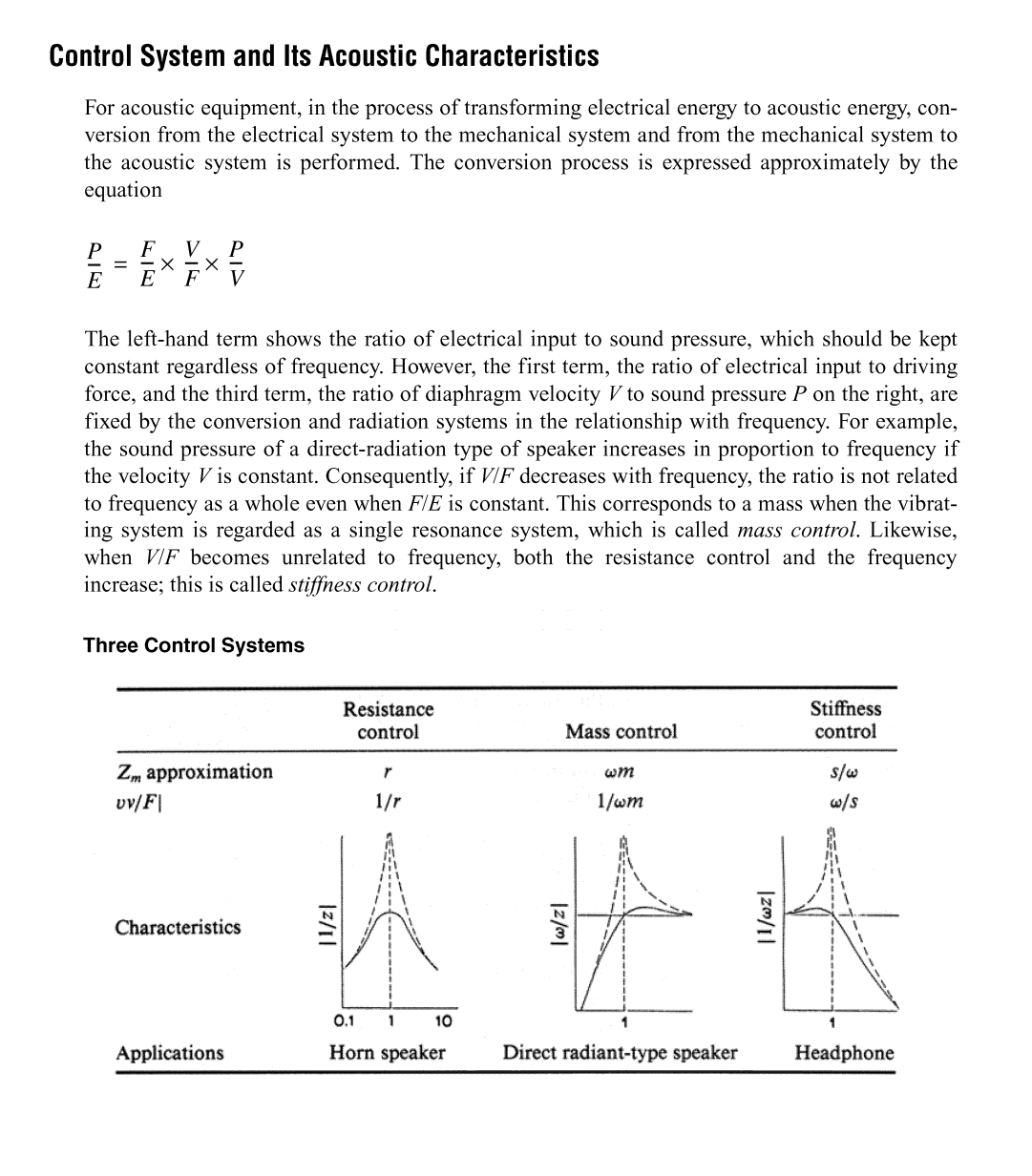

In simple terms, it's about electro-mechanical energy conversion.
Remember, a horn acts like a transformer, converting high-pressure, low-velocity acoustic air movements into low-pressure, high-velocity sound radiation.
That's why you (also) have to take into account the (complex) impedance.
This article explains a few things on the basis of the Klipschhorn.
