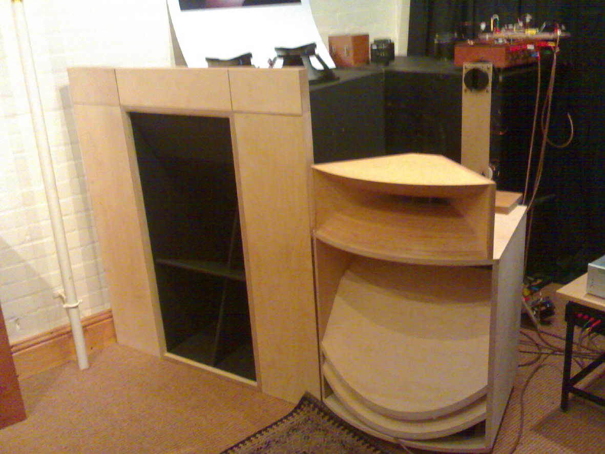

Prototype:

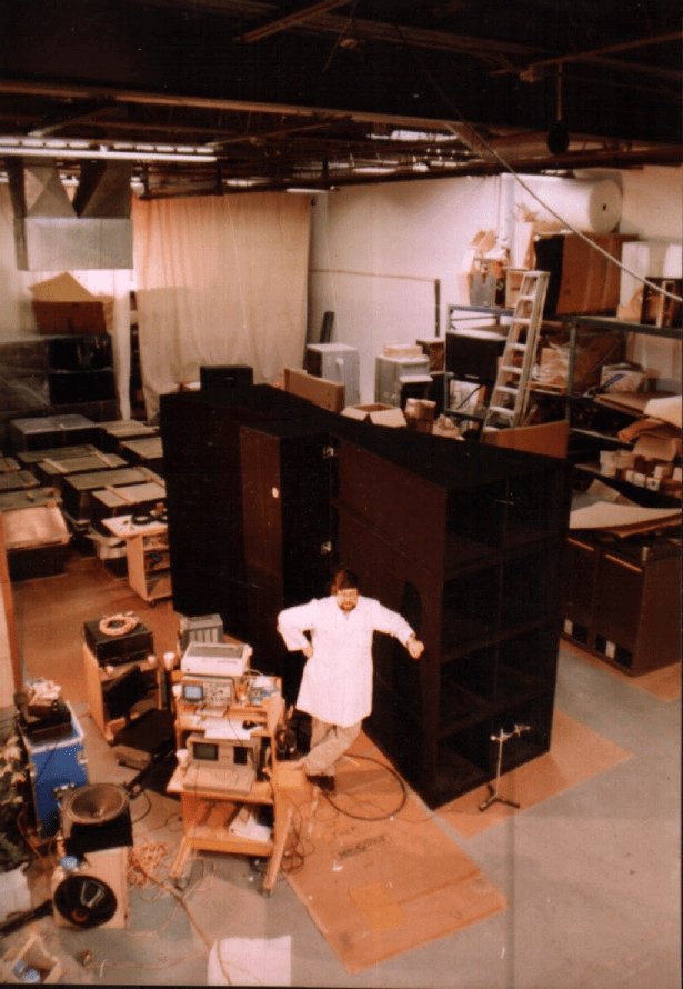

Tom certainly likes big subhorns:
One of my favorite clubs - that recently closed its doors, featured 2x J1, 16x TH118 on the main stage and while I became a fan of the J1's, those TH118s are no match for the single stack of 4x2x21" FLHs (on the previous page) wrt quality of the (sub)bass.
Of course, it's difficult to compare clubs due to room acoustics, FOH engineering etc, but my opinion is based on many visits to venues/events all over Europe.

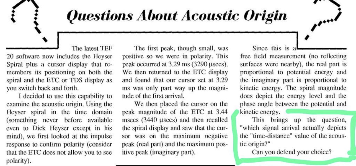

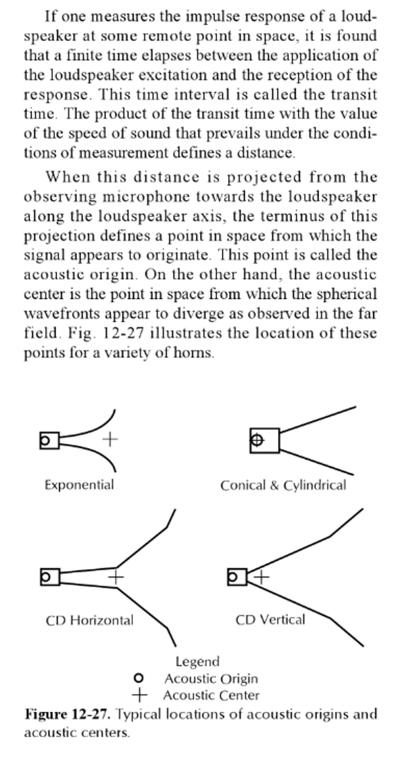

Hi Ro808
Thanks for the illustrations in post 10672 on acoustic origin vs acoustic center. Where does that illustration come from, "the only book an audio engineer needs on their shelf."? Had a quick look in the index, found no acoustic origin or center....
Nice day to all from Denmark
Steffen
Steffen
Definitions of acoustic center and origin: chapter 9, page 153 and the illustrations on page 375 (in the browser type Ctrl + F + "acoustic center")
