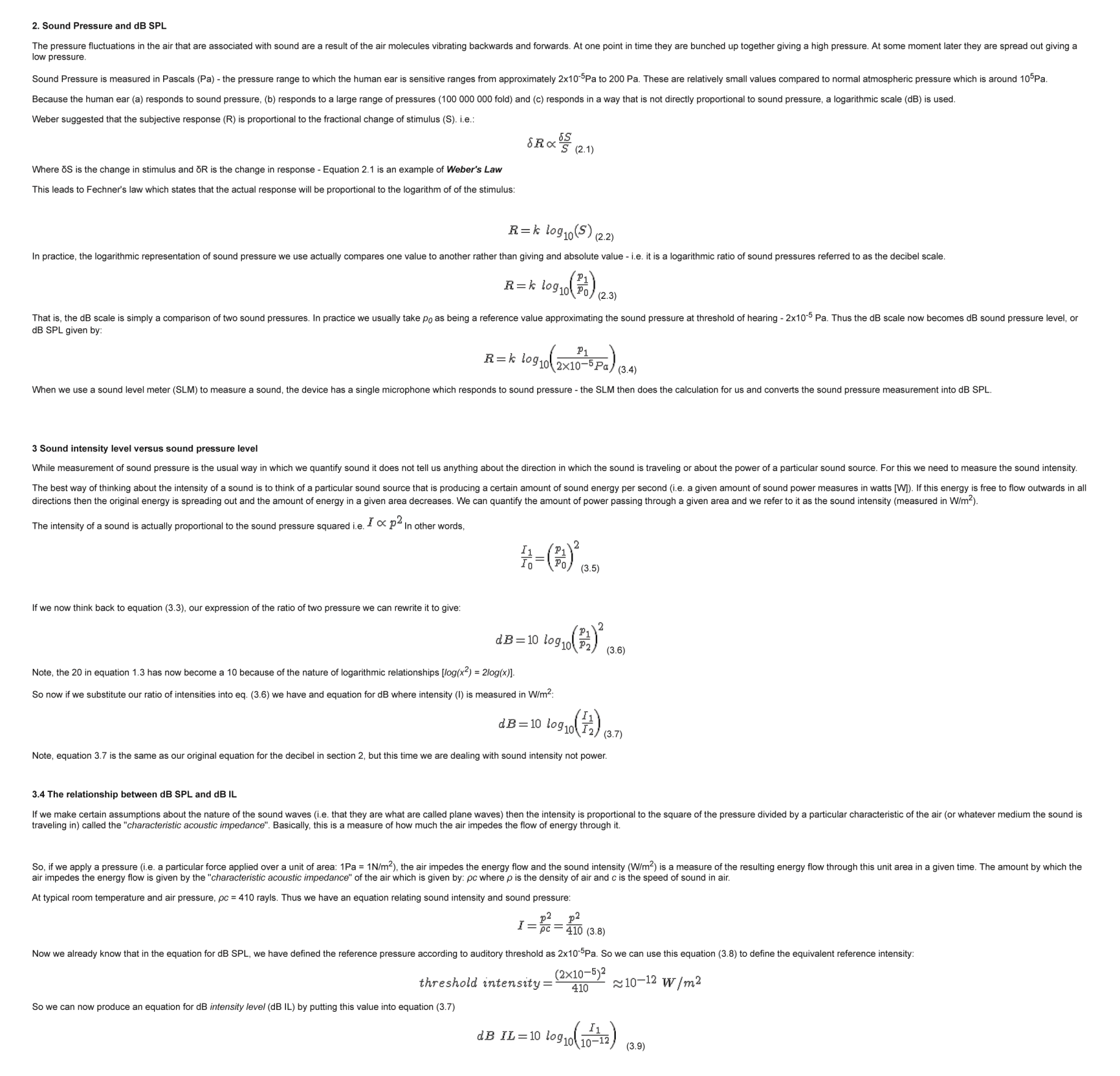

Energy, power, intensity and pressure
Sound Energy
- Energy is defined as "the ability or capacity of an object to do work". If we think of a single speaker producing sound, as it moves it does work in the process of moving the air molecules around itself - the energy is transfered to the air molecules. Energy is usually denoted by a capital E and the unit of energy is the joule (J).
Sound Power - Power is simply the "rate of expenditure of energy" - that is how much energy is transfered in every second. For our speaker it describes how much energy is expended per second in moving the surrounding air molecules. Power is usually denoted by a capital P, and the unit of power is the watt (W).
Sound Intensity - As the speaker plays a sound, the energy travels out in all directions and as it does so it is spread out over a larger area. Sound intensity refers to the amount of sound energy that passes through a particular area in one second (i.e. power/area). Sound intensity is usually denoted by a capital I and the unit of intensity is W/m2 or Wm-2.
Sound Pressure - When the speaker isn't moving the surrounding air will be at atmospheric pressure (with a certain density of molecules). As the speaker moves outwards it applies a force to the air molecule pushing them together (compression), as it moves back it leaves a region of fewer molecules (rarefaction). The moving molecules then collide with adjacent ones and pass on the energy. The sound pressure is simply the amount of force that is applied by the moving molecule per unit area. Sound pressure is usually denotes by a small p, and the unit is the pascal (Pa) where 1Pa = 1 N/m2.

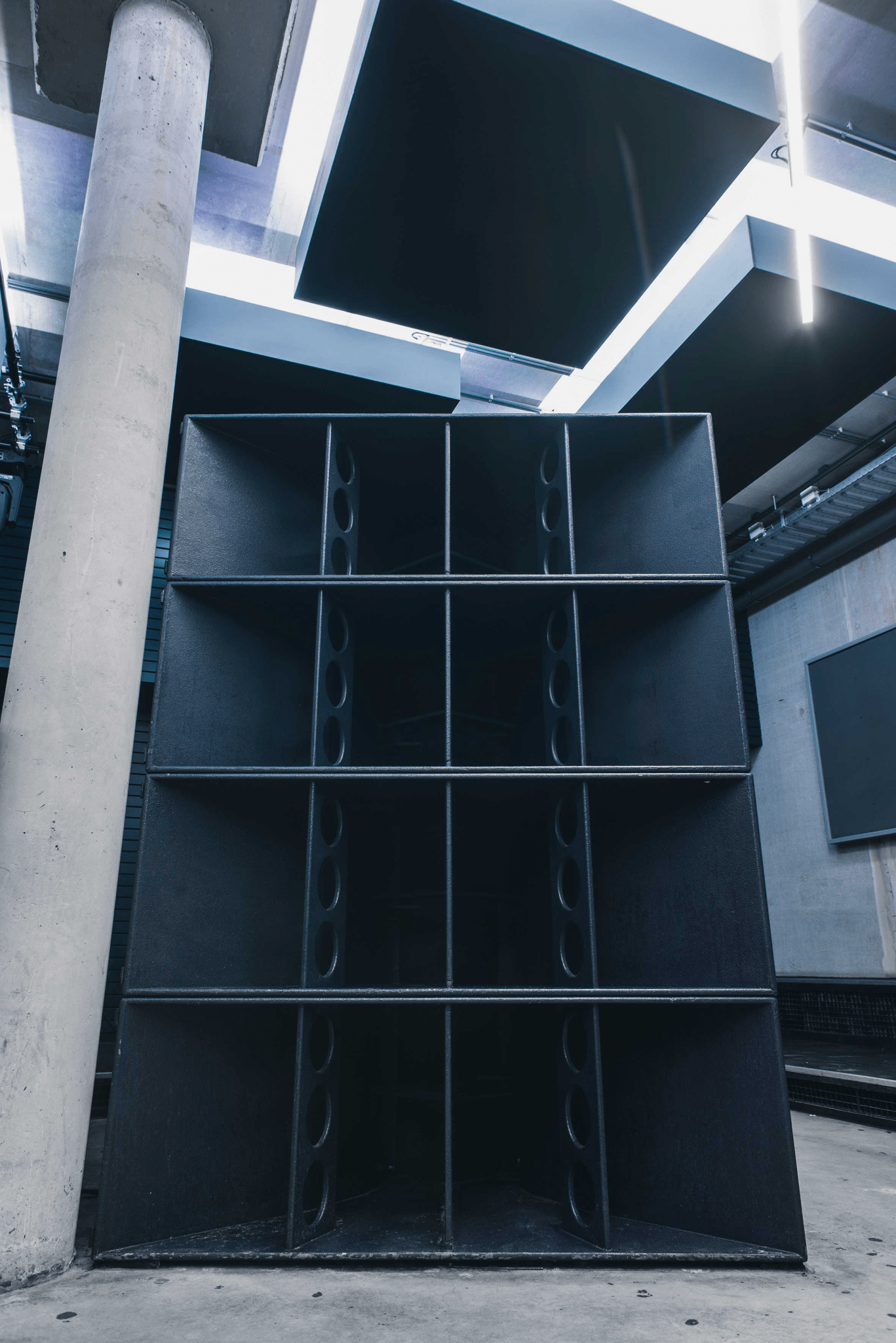

That relationship of pressure to velocity at the mouth is also one reason that I think people like to stand close to a powerful bass horn. That ‘trouser flapping’ physicality could be attributed to the relatively high velocity at the mouth when compared to a sealed or ported enclosure.
I’ve definitely noticed this feeling with well-designed tapped horns, as well as classic front-loaded horns with a sealed rear chamber. Standing near a TH412 at full chat is a very moving experience! There’s a lot of Whole Body Vibration, to use the proper term.
You do get some of the same effect from modern, large ports on powerful dual-18 subs when driven with lots of voltage swing, but there’s something that’s just violently fun about a bass horn with a large enough mouth radius to be effectively loading at 30Hz.
It is also quite damaging to your hearing, of course, but very few of the pleasures in life come without risk 🙂
....but there’s something that’s just violently fun about a bass horn with a large enough mouth radius to be effectively loading at 30Hz.
Yup, like this:
Somehow I tend to prefer FLHs over THs, at least from experience with PA.

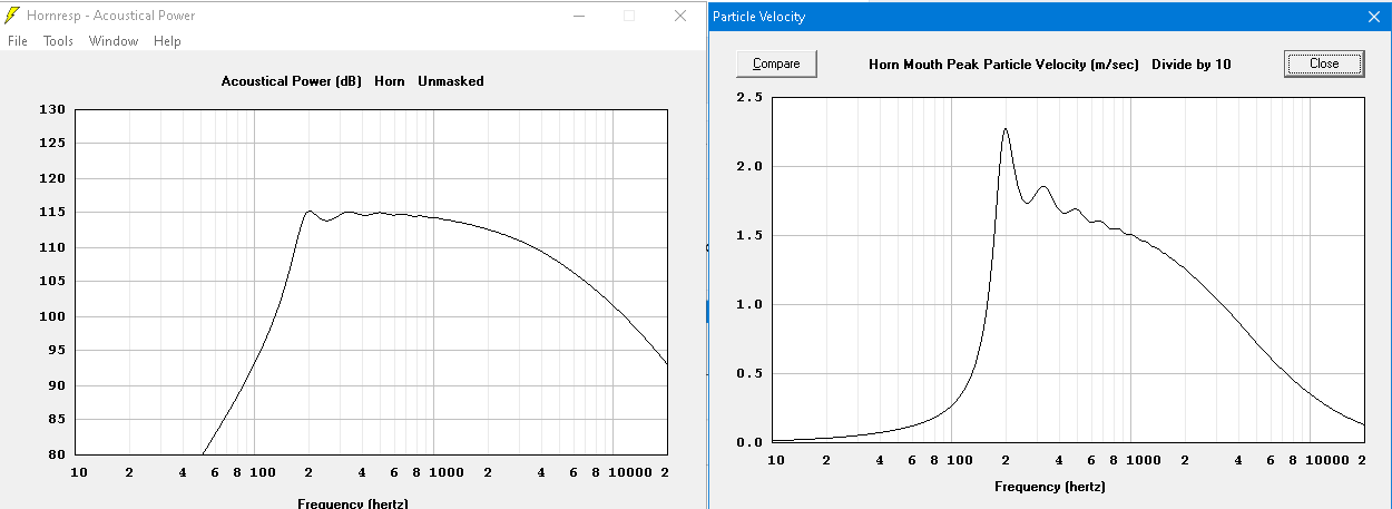

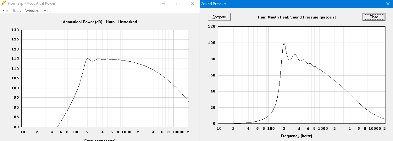

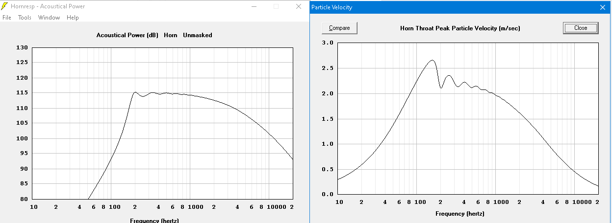

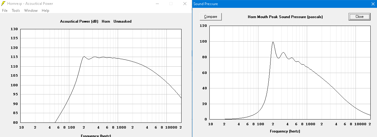

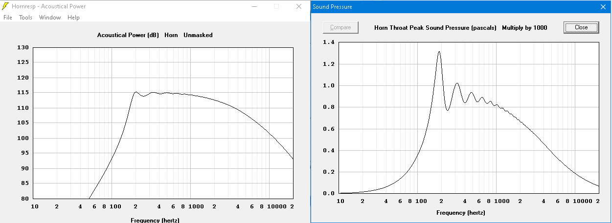

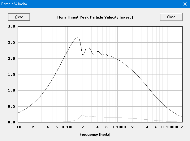

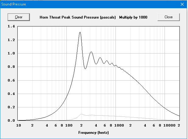

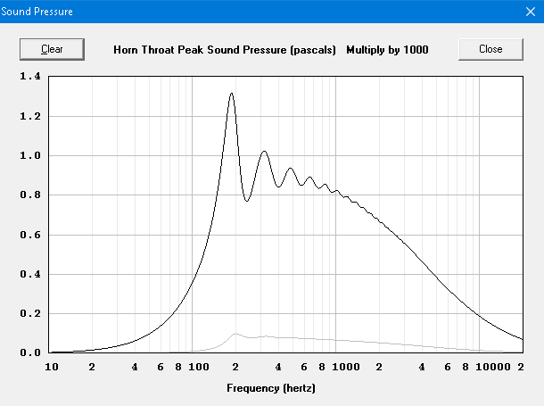

According to hornresp....we go from high velocity to low velocity....Which makes sense to me on the surface. I also recognize the complexity of the discussion and that the devil is in the details. Anyone have those details>?
HornResp is showing High Pressure and velocity going to Low at the mouth. The pressure side of it makes sense to me, thinking about putting the microphone down the throat, increasing SPL.... The velocity side of it makes seems to me also....I think lol.....A larger radiation source needs less Velocity to create pressure. The same reason a Large woofer has to travel less distance to create the same SPL as a little driver traveling much father. The coupling of the Air turns the airmass that is couple to the driver into a "diaphragm" thats the size of the CSA where it couples to.
Particle velocity vs Volume Velocity....Volume velocity almost sounds like another word for intensity. Thanks for the input @DonVK

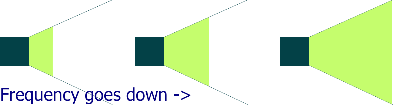

This picture below might help me explain what I think is going on at different notes of a horns output.....The Chartreus areas represent coupled air masses.....The coupled air masses move in unison (to some degree?) with the diaphragm. like a dynamically changing air piston whos size depends on frequency. So at the lower notes, just above cutoff, the air mass is largest (this heavy mass causes GD).....as we move up in frequency the corresponding CSA/Axial length of the couple air mass, moves deeper into the horn.....
The larger CSA of the airmass, in the lower notes increases Volume Velocity dramatically.....And is also the responsible for increasing the Radiation Mass
below cutoff, we lose coupling....the radiation mass shrinks to the size of the diaphragm.

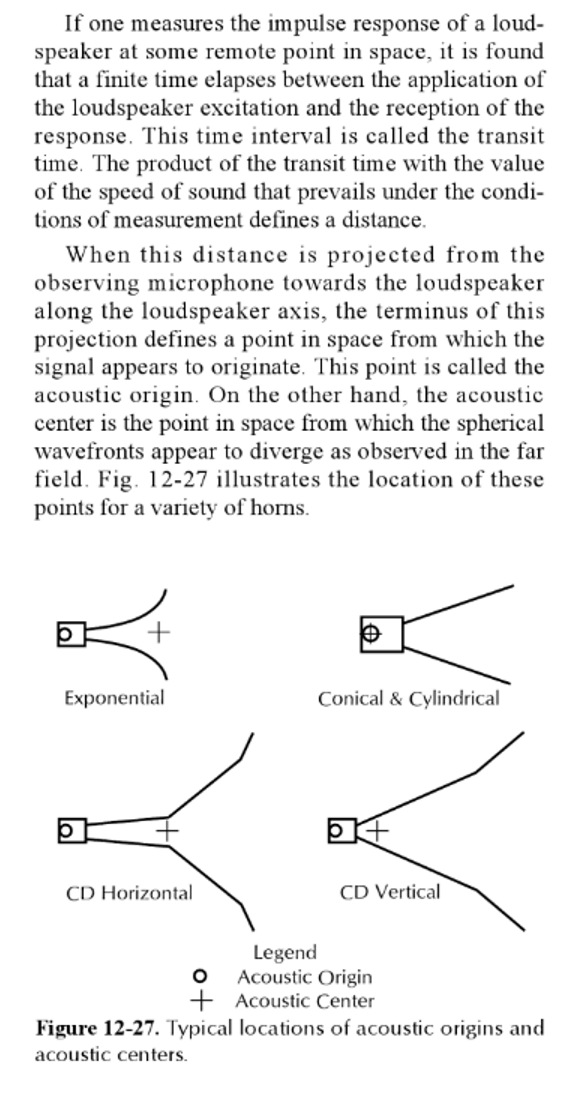

Driver + horn are a single electro-acoustic system, but you seem to refer to acoustic origin.
Thx Ro
That helps explain some of the parent source location difference i've been hearing in my syns, between the same primary conical horn with and without secondary flares.
