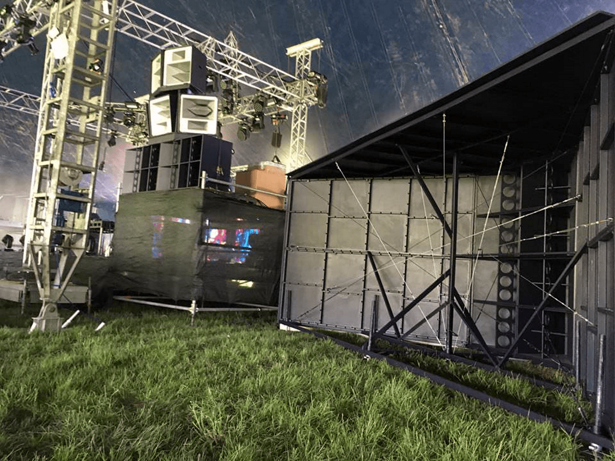

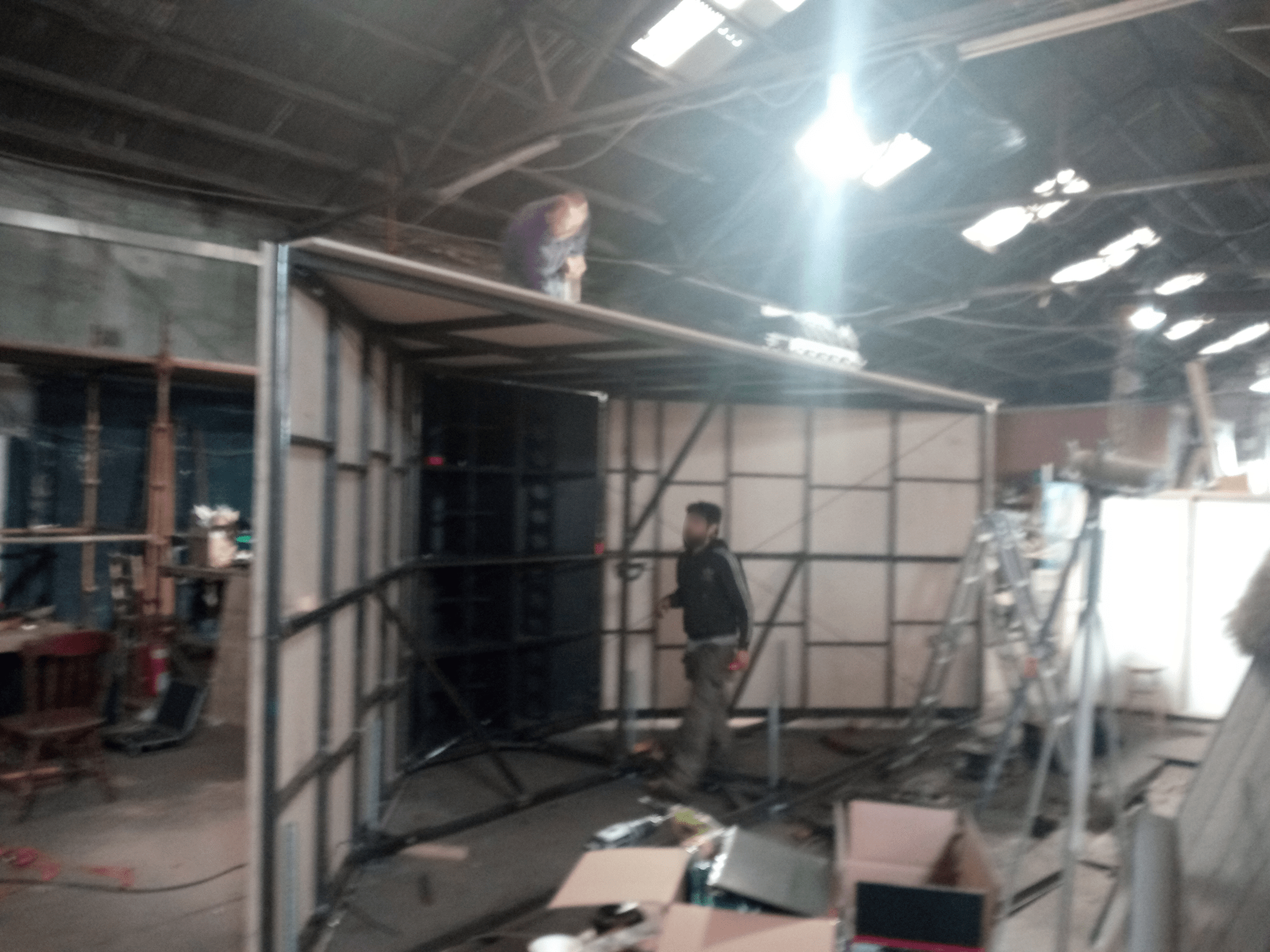

Can you tell us move of the bass horns in post 10,669, a page before this one ?
4 of these, stacked:
Compared to tapped horns lf extension is limited, but what it does, it does with authority.

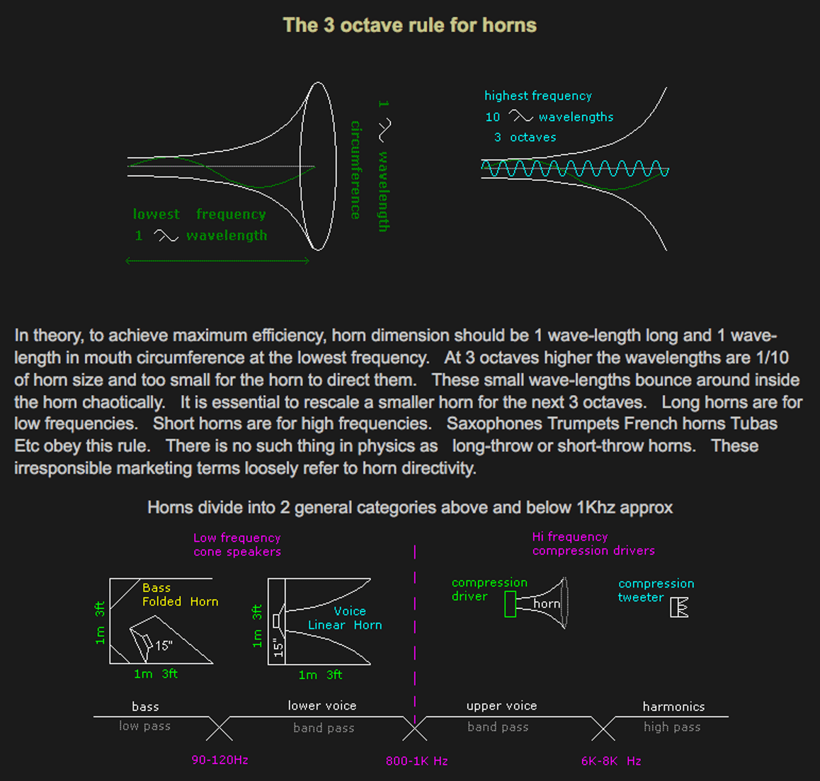

"A properly designed front loaded horn will sound better than a back loaded horn or a tapped pipe. It will have less output though, or be bigger than a back loaded horn or tapped pipe. If you want quality go for front loaded horn.
You will need to decide on how low you want your system to go. The size and cost for a 20 Hz system is probably 4 times compared to a 30 Hz system."
I'd say that the size of the radiation mass and directivity is more important. A properly terminate horn is going to have the highest RM CSA.
@GM - I think I've narrowed down my perspective to the details of the radiation mass, and the transition from piston velocity to free space
"Transition between piston velocity field (normal piston velocity) and sound field in free space"

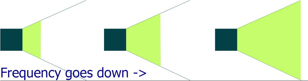

Horns extend piston velocity to the point of where they couple in the horn...A large horn in its lower notes, still above cutoff will extend piston velocity to larger CSA of the horn...I previously argued that the shape/size of the airmass involved in coupling gets larger before it reaches cutoff. The axial length corresponding to frequency it couples with, will determine the CSA ,of the airmass. This airmass also extends Piston Velocity outwards from the actual diaphragm....The larger CSA of the Airmass/AirPiston, moving at piston velocity, raises Volume velocity and intensity....which I think are some of the building blocks of Direct Energy.....or at least thats the last thing I proposed lol.
For any example of FLH/TL/TH/BR etc To me.... the major factor is the Size of the Radiation Mass and its characteristics, that generally show the transition from Direct energy into free space...... The larger the Vent or Driver involved in the radiation.....the more direct energy.
If we wanted to be scientific and create another factor to "Null" when comparing different enclosures. For sure, Radiation Mass CSA, would even the playing field.....It is similar to using all the same box volumes when when comparing enclosures or using the same driver, etc.
By setting a static Radiation Mass CSA and then comparing enclosures....I predict that the ideas like this

I have a theory on long short throw for mid highs.
Perhaps a narrower dispersiom horn can get its sound to a place in room (far throw).
Think a better signal to noise ratio.
Less room reflections.
Like when i had a 12" full range crossed at 150hz.
I was supprised at how loud it would go in room without sounding mushy.
My theory is less hf bouncing all over the place.

Hello Norman
Yes you would think. In a normal size room I am not sure ends it up mattering as much. The dimensions are so small in a room compared to say a stadium that the actual differences in the reflected field?? You are only controlling the directivity over a limited range and where the sound power is most intense the only control is that offered by the driver and baffle size.
My preference is for the short throw wide horns such as the JBL 2344 and the M2 waveguide. They sound more natural to me than systems with higher directivity like the 4344 as an example.

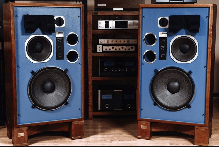

Hello Camplo
4344 are old school monitors so they are using an exponential horn on the 2425/26 compression driver and diffraction lenses same on the 2405. The diffraction lenses on the exponential only work horizontally and marginally so. Same with the 2405. In the vertical they beam to the point that when you set them up it's important to have the HF drivers at ear height or at least aimed that way.
If you compare a 4344 to a 4430/4435 an Array 1400 or the M2 it is a night and day difference as far as uniformity between on and off axis response. The newer designs are far better. The difference is clearly audible especially if you change your seated position, stand or move around the room.
Because of this in actual use if you stand or move off axis there is a clearly audible tonal shift. It's essentially "head in vise". Speakers that do that do not sound real/natural to me using sounds in real life as an example. I will admit it's a preference but when at a real live event have you experienced a similar tonal balance change in a couple of feet?? I certainly haven't.

The term 'natural' (sound) would justify its own thread, but I guess I know what you mean.My preference is for the short throw wide horns such as the JBL 2344 and the M2 waveguide. They sound more natural to me than systems with higher directivity like the 4344 as an example.
With regard to horns versus waveguides/direct radiators, it's mainly about the 'perceived signature' of the wavefront and the interaction with space.
Very short horns, such as the M2 waveguide, sound more like a dome tweeter on steroids.

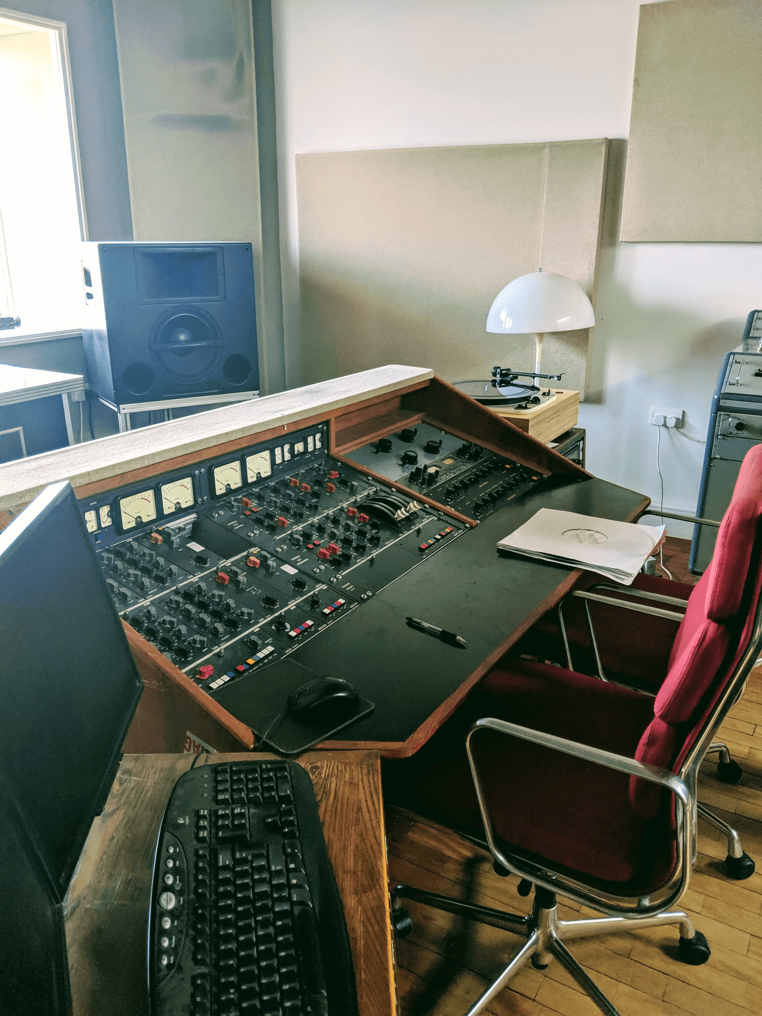

This short conversation, following a visit to a mastering studio (see pics), between some guy and Peter Qvortrup (Audio Note UK) - who, after more than 40 years in the industry still detests horn loudspeakers, is illustrative:
"How did you like the Meyers? I've never heard them, only heard about them."
PQ:
"Hi H....k, you mean the speakers? I thought they were terrible when I am honest, but even so, the test cuts we heard sounded unbelievably good. Peter"
he thought they were terrible but sounded unbelievable great....ok"How did you like the Meyers? I've never heard them, only heard about them."
PQ:
Thank you for explaining. "They sound more natural" = They have a wide pattern, or neutral off axis character.... Possibly constant directivity even....If you compare a 4344 to a 4430/4435 an Array 1400 or the M2 it is a night and day difference as far as uniformity between on and off axis response.
My stance has always been this.....User error....Its like playing a woofer at Xlim and blaming the speaker for distorting ....Stay in the sweet spot, there is nothing else acceptable for monitoring.
I try to only judge speakers while in the sweet spot....for critical listening, I would want to only be in the sweet spot... At the top of the HF there is always beaming.....
Distortion increases as you move off axis....Can I say that?
No, the 'test cuts' (mixed using those Meyer Sound X10s, but listened to at home on his AN-Es) sounded great.he thought they were terrible but sounded unbelievable great....ok
