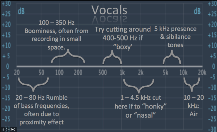

Seems @GM has the most insight on the topic....He purposely pointed to a part of the spectrum that one might perceive as;
"cupped hand" comment to be referring to "horn honk"
So this horn honk haunting might also be a factor of Where in the FR "trouble" occurs.....
AKA throat distortion down in the ~450-900 Hz octave and no doubt (in my mind) why W.E./Lansing/Altec added conical WG driver adapters to most, if not all, of their 500, 800 Hz horns designed for speech
These cheat sheets are to be taken as the standard but we see the same range described as "Boxy" and coincidentally "Honkey"

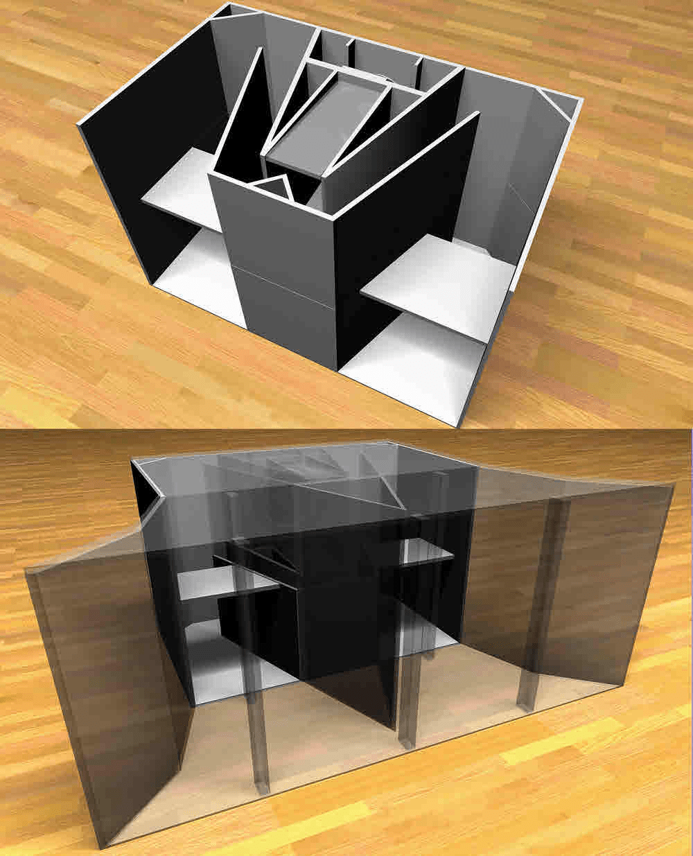

Sorry for the interruption, but what is ”this” and where might any information be found?
Ive been looking at recreating a lascala/belle bottom to be used as a midbass module (50-150/200) for more slam impact between the subs and mains…….and ‘this’ looks to fit the bill perfectly.

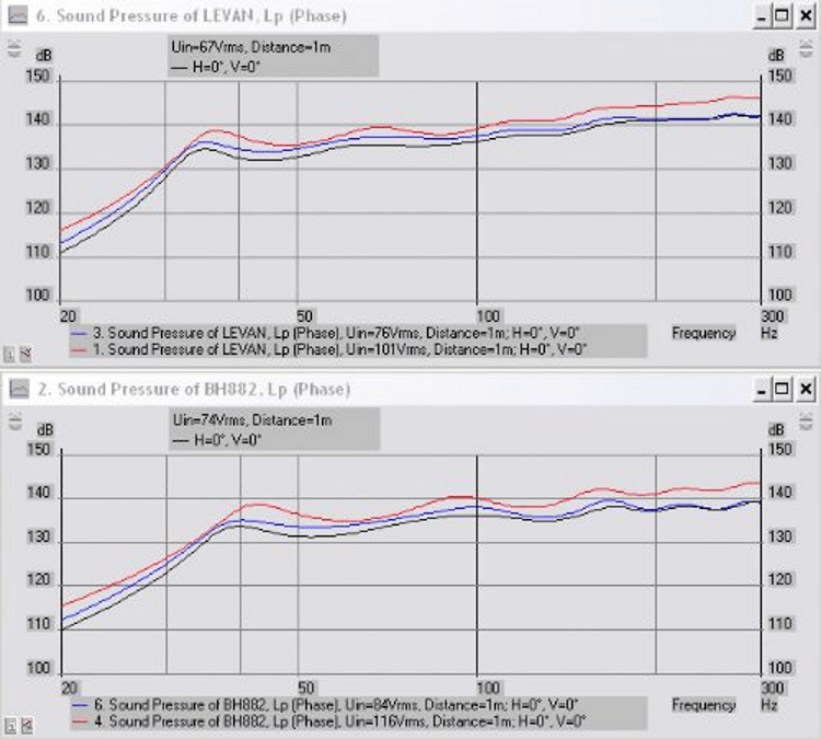

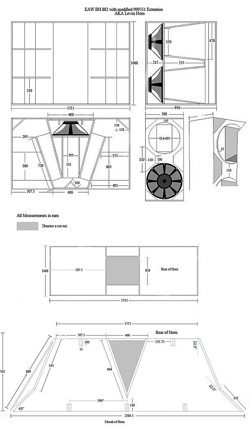

First, a quote from another forum:
"Upper plot is for the BH882 incl. Levan extension.
Bottom plot without the extension.
Plots show max. SPL by reaching Xmax of each driver.
red - Void V18-1000 (10.5mm)
blue - B&C 18TBX100 (9.5mm)
black - RCF L18/851K (9.0mm)
Input voltage for one driver @ 8ohm!"

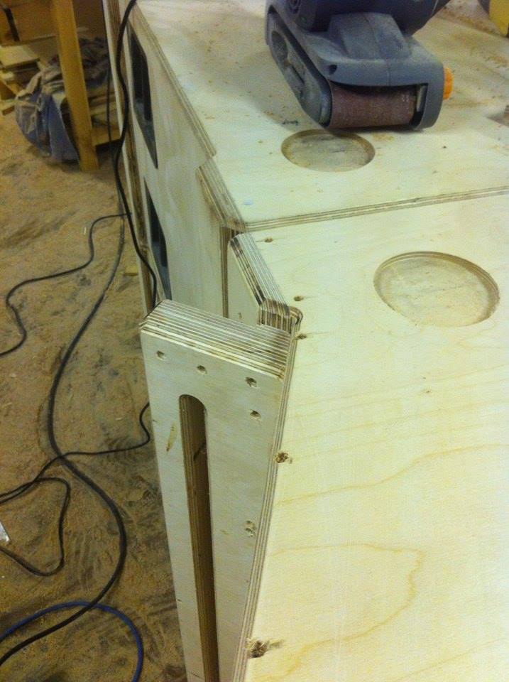

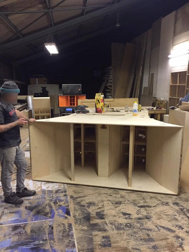

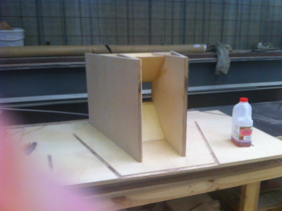

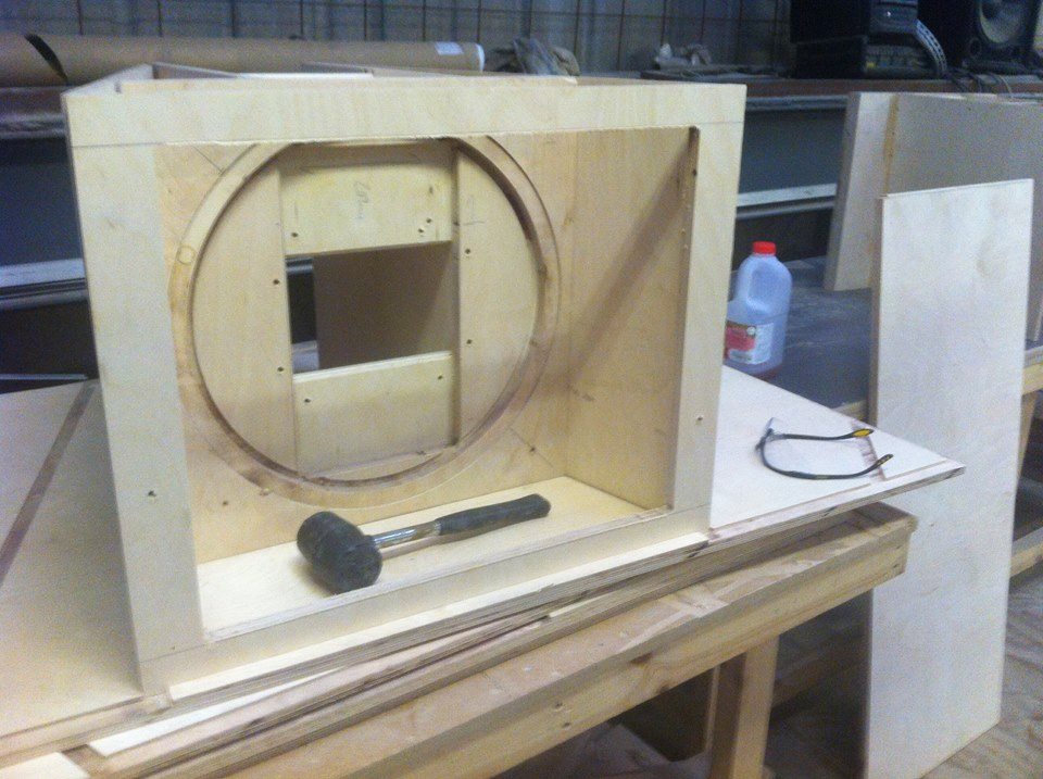

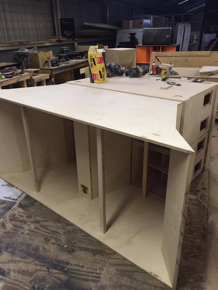

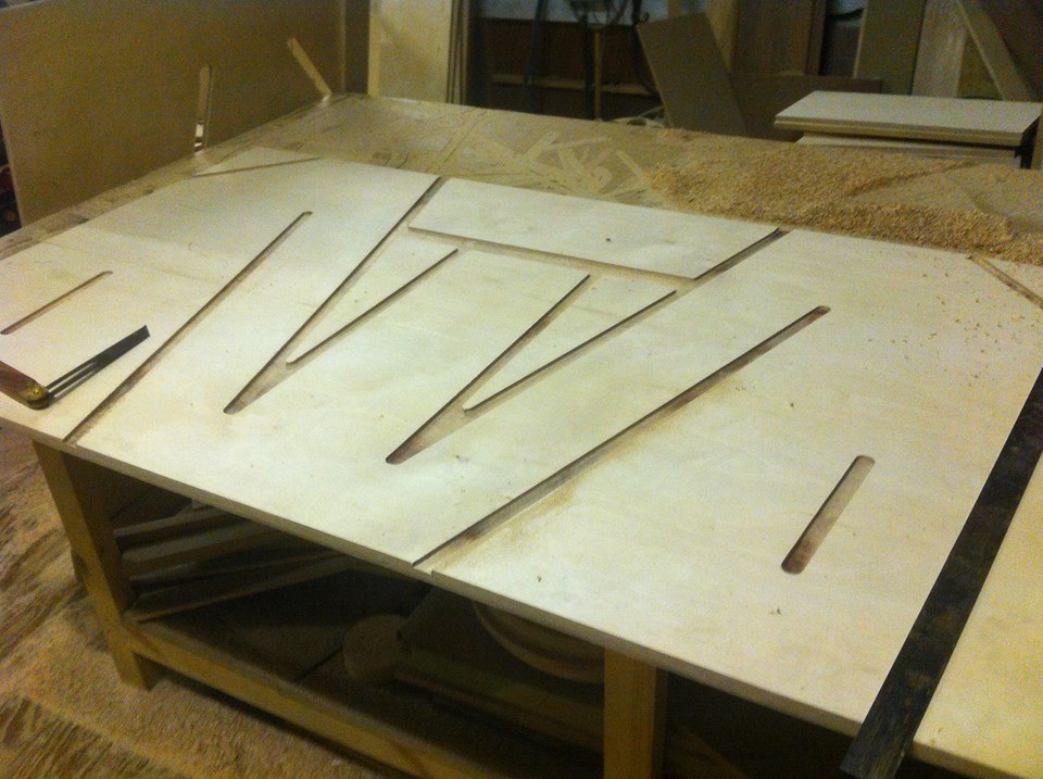

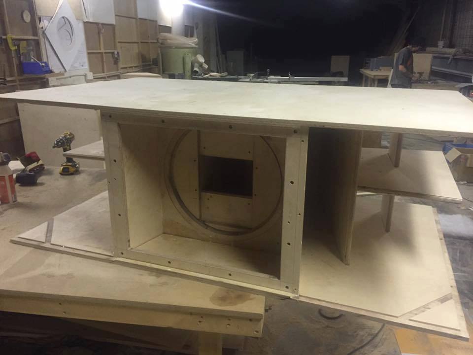

And a beautifully executed copy, for the Oberton 18XB1500.
