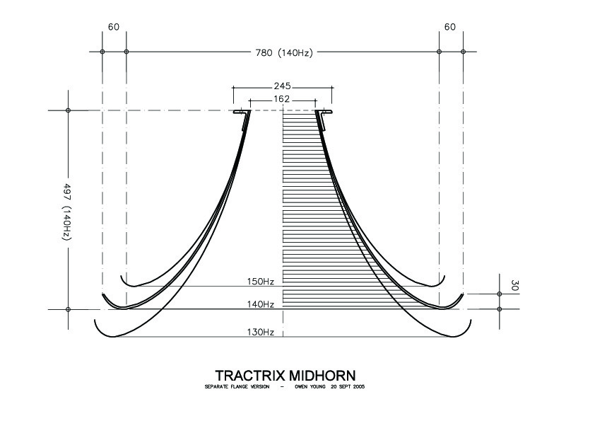

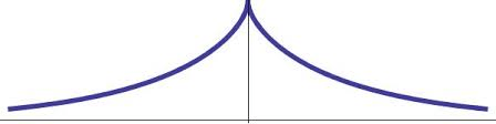

What I wish to understand is how and when a horn expands. In a literal sense there is only one tractrix curve right?
What I think is happening in a tractrix horn is that there is a throat section....The flare rate of the throat section decides the wall angle starting at the exit... then at when ever we decide the throat section is done, the tractrix expansion begins.... the end. I don't think that is right, but it seems like it might be close.
I do recall something about a tractrix horn starting with the mouth, and the working backwards?? The end of the curve should be a certain angle at the end, before roll off??? But when you through in the flare rate, it throws me off... Maybe flare rate potentially truncates the tractrix portion of the wall.... leaving only a certain flare rate to be a true or full tractrix expansion?? That doesn't seem right either....
It just seems that a tractrix curve only expands at a certain rate... so how do we get all the variation between the initial flare rate and when the actual tractrix curve starts and finishes???

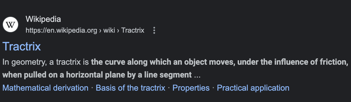

Tractrix is a drag curve. There is nothing like "flare".
Reactions: camplo
How do we end up with different tunings with the same wall angle at the exit. In particular when T can be a variable??? Is the whole profile of each tuning pictured, a tractrix curve? I guess T sets the initial wall angle to which the "Drag" line is centered?
The wall angle that you specify is the throat angle. Each value of "T" flares the curve differently and hence the LF cutoff will vary accordingly.
Ok so I need to separate throat angle from flare. @docali I think maybe you translate flare incorrectly? I get what you mean by "Drag curve" but your comment lead me to some readings suggesting that "friction" isn't necessary to calculate a tractrix curve per say?
How do I incorporate T and throat angle into the tractrix formula?

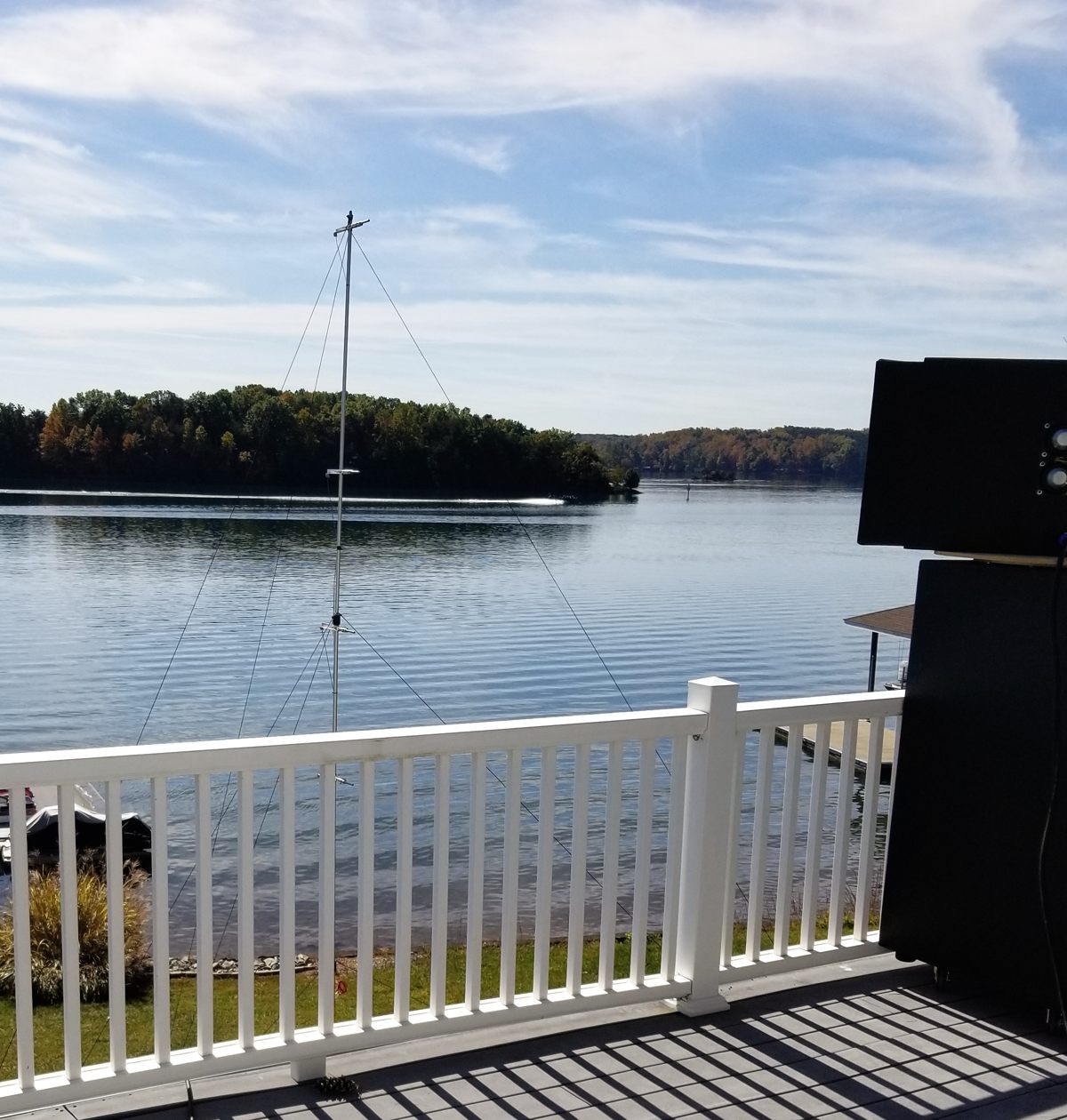

Yep, will do. I'll make a set of polars where the entire bandwidth of the multiple mid drivers being used is within 1/4WL frequency.
I'll do it on the syn11 box outdoors, far-field.
Got a new test rig to try out...multiple mics vertically, so in conjunction with a spinorama for horizontal rotation, I can get all kinds of off-ax meas.

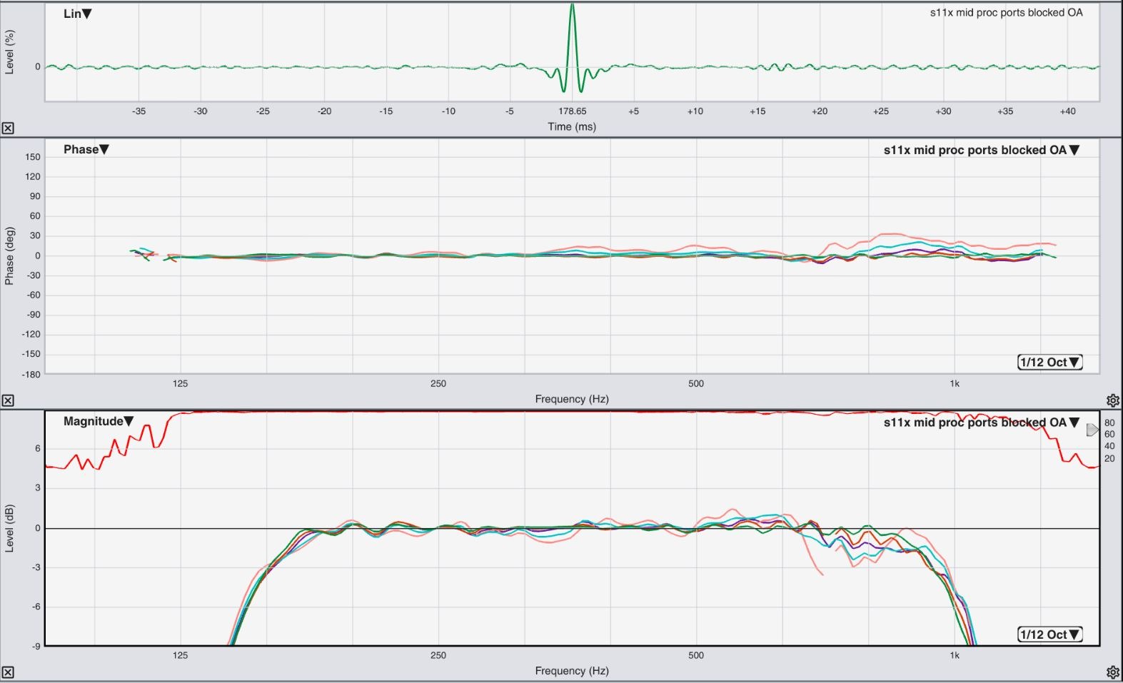

Trying to present the best data possible, and wondering if any mid port polar response variations I had seen previously were due to larger ports' interferences, I blocked all low and sub ports on syn11.
Used sheet metal and duct tape. (Have found in past tape only works for very low levels.)
So the mid ports were essentially measured on a 75x60 conical, with no ports.
Raw response looked quite usable from 150Hz to 1kHz.
I normalized on-axis response, both mag and phase, via FIR, with about 1/12th oct resolution.
Below are 0, 10, 20, 30, and 40 degrees horiz.
In my book, they are dang equivalent, surely to 500Hz if not a bit beyond.
(Angles are not really correct because POR (point of rotation) is forward of the CD's acoustic origin. My turntable isn't big enough to get that right on syn11.
But I don't think that matters at all for testing 1/4 WL summation.)
Anyway, it appears to me I stood in error thinking 1/4WL does not inseparably sum under rotation. Port interferences were blinding me.
Oh, I should add...on seeing great far-field summations with all ports blocked, I moved indoor to test up close where rotation would exacerbate any issue.
At 40 degrees, the closer side's ports were 18.5" from mic, the farthest 20.75". Sure seems like 1/4 WL holds to me ! (Below is the indoor, close up set.)

This test has really turned out to be a blessing for me......
After seeing how well all driver sections hold up after processing, with no ports in play, I now use this as the first stage in quasi-anechoic tuning.
On axis EQs hold up very nicely horiz, vert, and even in pattern corners.
So I now tune each section this way, starting with the CD, with all lower frequency sections ports blocked..
Then, I unblock all the ports and use a second stage of IIR EQs to smooth any anomalies on each section-by-section, caused by port interferences.
It's relatively easy to quickly identify what port interferences can be corrected, when they have been split apart from the driver section corrections on the unported horn.
The previous 'lump sum method', correcting both the 'match to conical horn and handle port interferences at the same time', worked;
but was so much harder with a lot of trial and error experimentation.
The new two-stage approach helps to quickly bin what should and shouldn't be corrected at each stage, and what holds up over the pattern.
And I think it helps better visualize the prime factors needing correction, and match appropriate corrections.
Waaay less juggling 😀

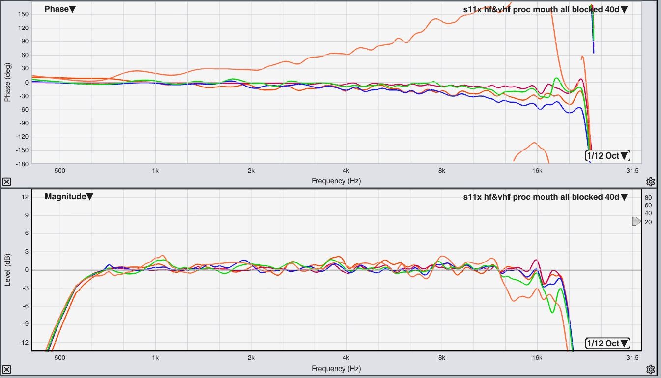

Hi Steffen, you are very observant, catching my use of different angles used for a tuning reference.
My longstanding use of a reference angle somewhere close to degrees, has been because it best represented the mean of averaged responses in a 0-30 degree window. Using it for tuning minimized the +/- amplitude of ripple around 0dB, for the set of 0-30 polars.
When I said to the forum, that I've been wondering if 1/4 WL summation is a rule of thumb for good acoustic coupling, or does 1/4 WL summation actually give inseparable summation regardless of angular rotations.......it was due to seeing ripple, when I thought there shouldn't be any if inseparable summation occurs.
To keep my speculations minimized, and trying to come up with the best test I could think of for testing 1/4 WL summation, it hit me I HAD to remove ports from the equation, as a source of potential ripple.
Covering all the ports quickly delighted me, how relatively ripple free each driver section behaved.
There is no significant difference between 0 degrees and 10 degrees for either mid or low sections.
The coax CD (shown below) has the most ripple, but the 75x60 horn doesn't have secondary flares, and I haven't bothered to carefully match Cd exit to horn flare, yet.
(note the 40 degree orange trace below is outside the 75 degree horn pattern; but due to point-of-rotation, trace is really more like 35 degrees.)
Anyway, for this 1/4WL summation test with ports covered, I could use either 0 degrees of 10 degree (or almost any thing below 30 degrees) for reference .
What's really cool, and I'll elaborate on the syn11 thread, is that I've found using FIR for this stage like always, allows identifying and separating the port disturbances from any basic driver section response rolloffs.
I'm optimistic that a new level of quasi-anechoic tuning has been stumbled on....🙂
And yes, fully moving back to the syn11 thread, other than responding here as needed re this 1/4 WL summation test.
B&C dcx464 on 75x60 conical; 500Hz 16th order LR lin phase high-pass

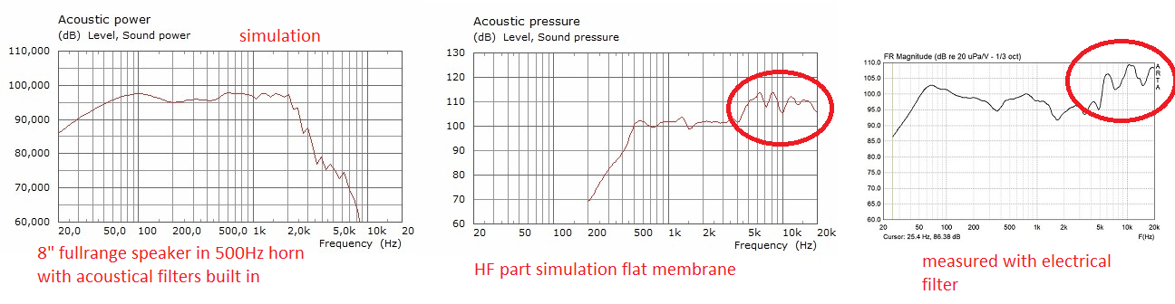

8" fullrange should be able to deliver 95-100dB in a 500Hz horn and closed back. Of course not everybody like whizzer cone but you can use coax instead.
I think this combo should be perfect for this thread. I'm working on novelity horn with acoustic filters built in, no electrical that is easy.
