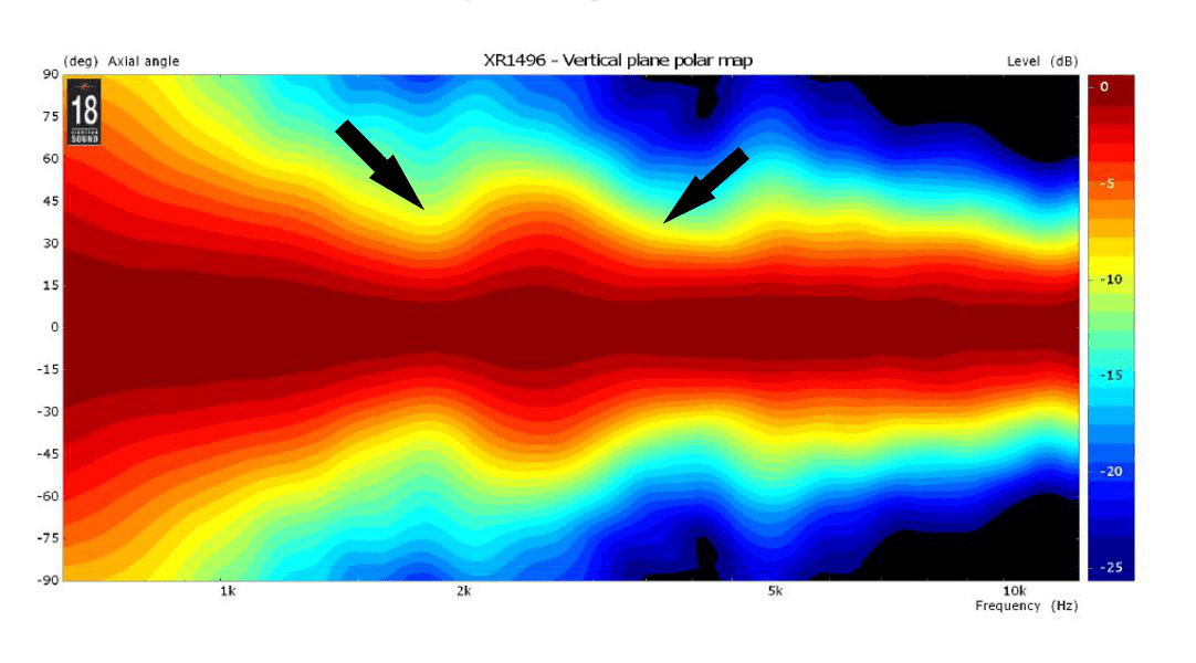

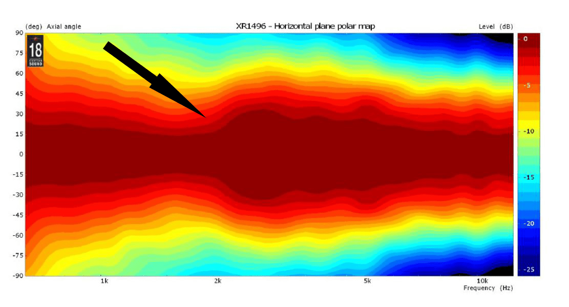

"Below 2 kHz the vertical beamwidth is actually greater than the horizontal beamwidth! This is sometimes referred to as “pattern flip”. The vertical coverage pattern of the horn, which is supposed to be narrower than the horizontal coverage pattern, is now the broader coverage angle. In other words, the horizontal and vertical beamwidth have flipped with respect to which is greater and which is lesser. This is particularly noticeable when examining the directivity balloons"
As long as one stays in the 'hot spot', pattern flipt isn't (very) noticeable, but it becomes apparent when one moves off-axis.
Maybe I'm a bit obsessive in this regard, but I can't ignore the effect ('shift' in image) when I listen critically/attentively. Therefore it's not really an issue in clubs and at festivals.

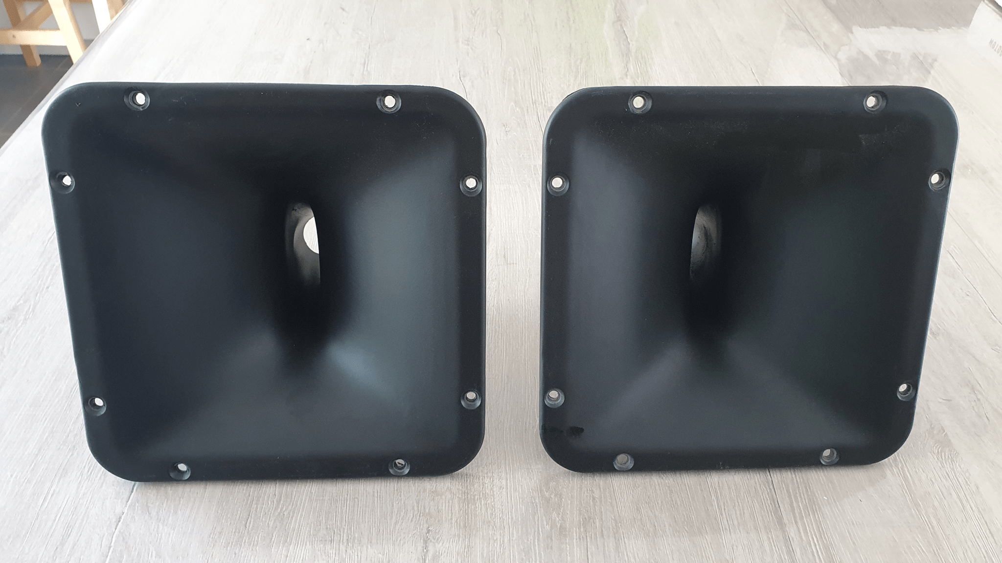

Not necessarily because of pattern flip, but this is the worst horn in terms of imaging I've listened to. I even prefer a classic diffraction horn with sharp edges over this one.
At least the above image is called waist-banding and not pattern flip.Tbh I never expected these lobes (narrowing/widening) to be so noticeable.

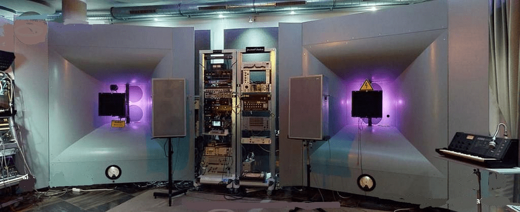

It's from Florian Schneider's own archive and posted in a Klangfilm group by the current owner of the Euronor Junior system.Ro808, whre did you find this picture (posted in a different forum) ? Thanks.
Correct, shouldn't post while eatingAt least the above image is called waist-banding and not pattern flip.

The Ø Audio Icons were high on my 'must listen'-list, precisely because of the XR1496s. Aside from the horn artifacts, the system sounded pretty good.
However, because of that experience, that horn is an absolute no-go for me and as indicated earlier, I'm not the only one.

"Klangfilm group" - what does this mean ?It's from Florian Schneider's own archive and posted in a Klangfilm group by the current owner of the Euronor Junior system.
A group on FB in this case.

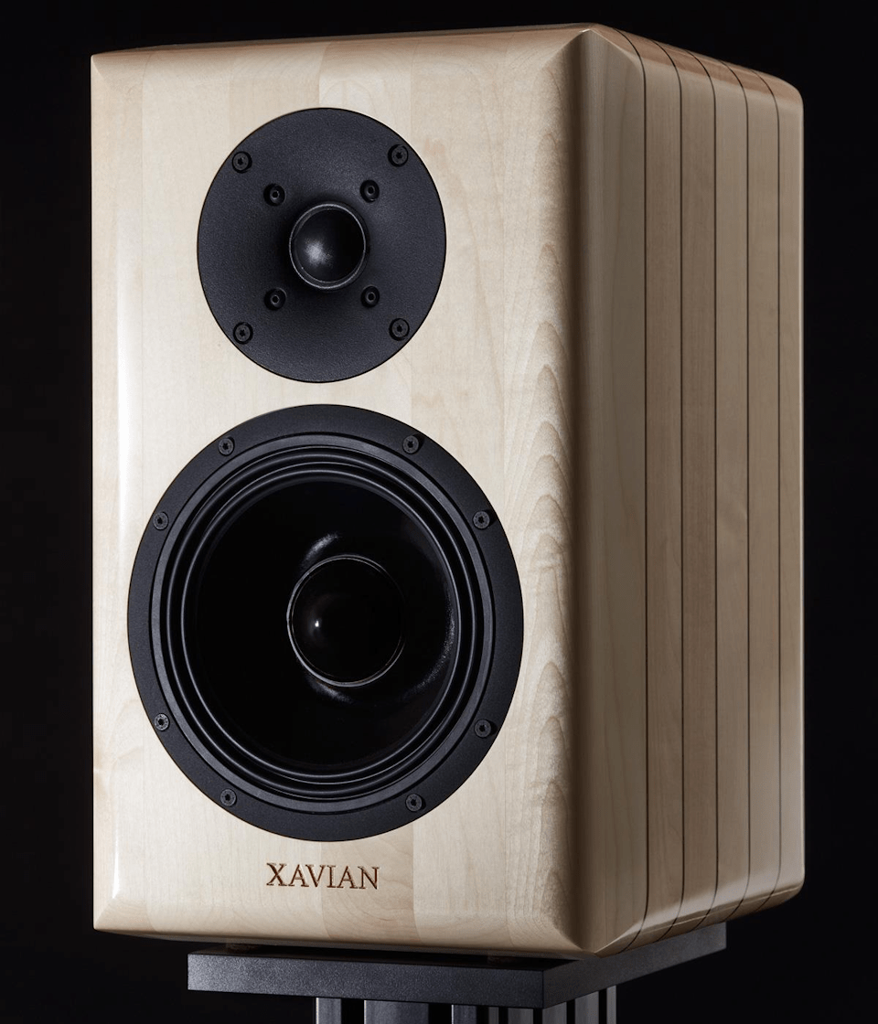

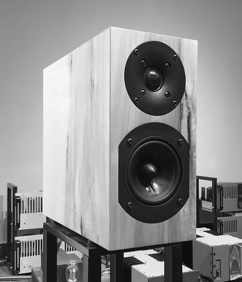

From my teenage years I've always had a soft spot for small monitor speakers such as these:
While I may switch to a fully horn loaded system at some point, a mini monitor on steroids is my current ideal.
