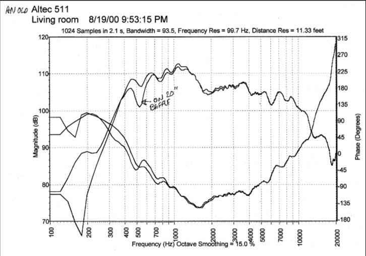

Phase Pattern Flip - How does this relate to perception? I've read people suggesting that they can perceive this and opted to not use a particular horn/waveguide because of it. I am wondering if it is more perceptible in one particular spectrum versus the other etc etc...
A more Acoustics related question
Kind of obvious (to me anyway) when looking at an extreme version such as Altec's 511/811 sectoral horns, i.e. note that from ~1800 Hz - up is the Altec 800 series driver's small conical horn and the 511's round to rectangular adapter that's 'pinched' down to the expo flare.
This was no doubt in my mind the main reason why they opted for a 1200 Hz XO in their Model 19 'flagship' that many (still) believe is the best overall performing 'HIFI' speaker regardless of (Altec) design type.

I experienced pattern flip with the mid/high biradial tractrix horns for the BMS drivers. When the mouth is horizontally much wider than vertically, the vertical directivity changes suddenly, below a certain frequency treshold. This is perceivable. Round/petal horns do not suffer from this.
Please explain what exactly you have perceived when doing what? And please explain the term suddenly you have used. What was differently to your strong beaming round horns?
