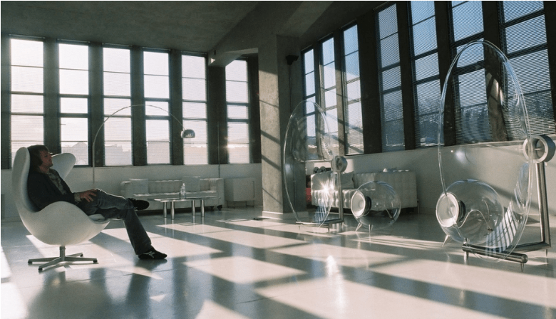

I had the idea to do something like this with a large elliptical horn and matching woofers on each side the horn mouth, Then I remembered that someone was basically already doing that, minus the twin subs for each channel. Select people on the board seem to keep hinting that vertical reflections are more an issue than horizontal. The next obvious evolution for me to get the waveguide bigger is an elliptical with its vertical axis the tallest and with the horizontal dimension being the width biggest acceptable. 30-36" seems to be a good place for me. To get the center of the horn at ear height, 48", things get pretty big at 96" tall. From there one could use the large surface of the flare for many purposes. I would create an MTM, seems logical. Maintaining the 200hz XO point, I would slot load 18"s at the top and bottom.
How long you think that would take to print
