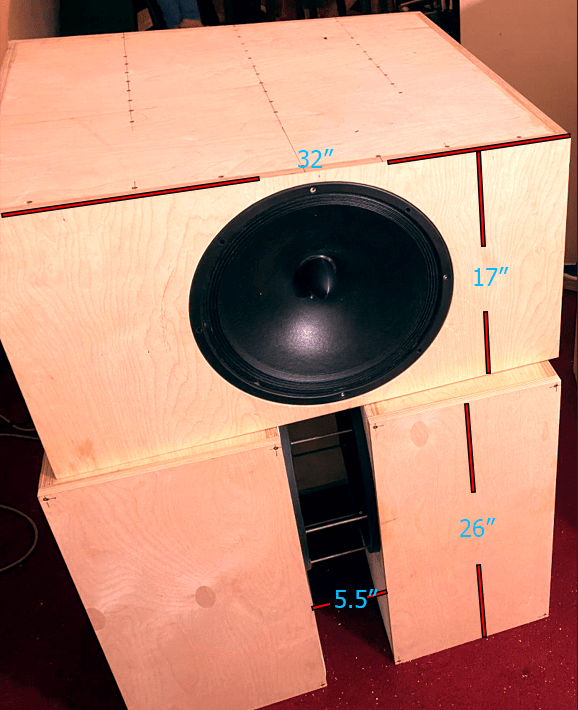

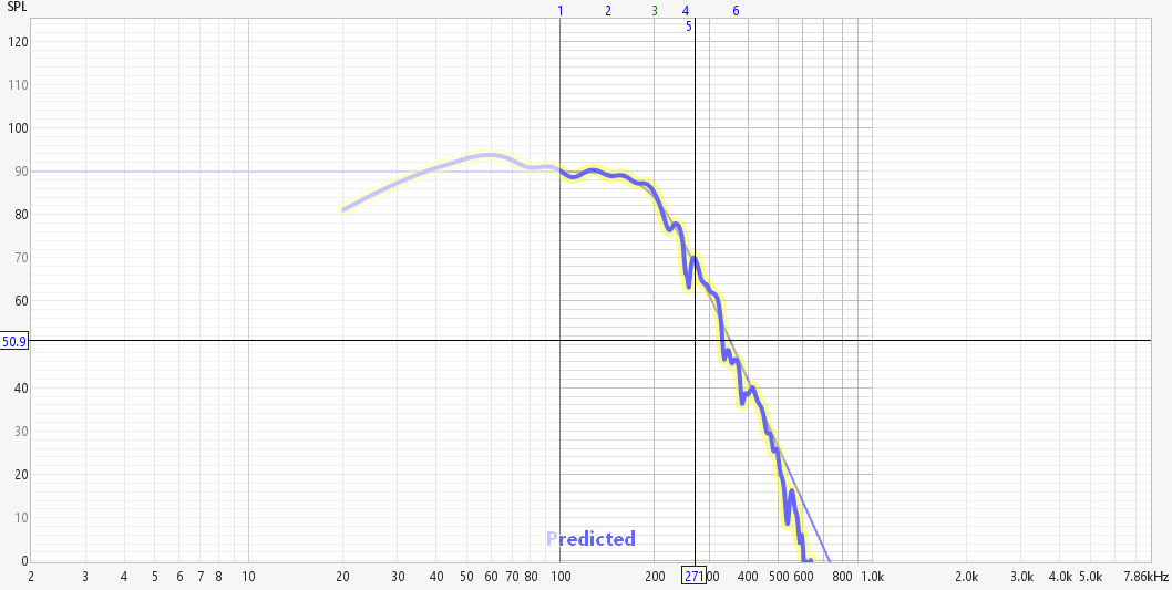

With your sealed dual 18" box you may be imposing yourself to a sonic disservice crossing over so close to the peak/dip frequency caused by the volume of the "front horn" plenum slot. Placing the woofers closer together or further apart simply changes the frequencies of the peak/dip.
Not high enough for a two-way using a compression driver for high frequencyIf I place them closer together it will move the peak/dip even higher.
To me, all your PPSL has done for you is maybe a few dB boost over a very narrow band of freqs, but in return you net a null at about 300 Hz which you can do nothing about. Art's point was that a CD cannot go low enough to accomodate this null no matter how close together you get them.
I just use them direct radiating up to the CD CD (constant directivity compression driver,) Like I recommended before.

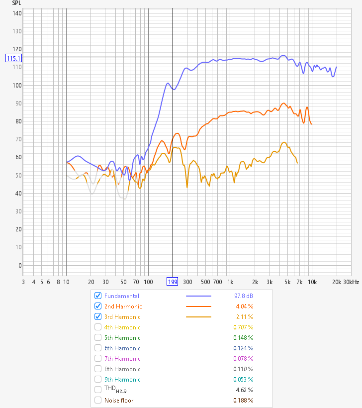

What are you worried about? THD/IMD? This is the loudest measurement I have. How loud do you speculate I need? If 95db rms, then 110db peak, minus -6db at the xo point and another -3db with the addition of another channel. 101db 200hz/1m. This is all about parasitic THD correct?
If it is about FR then, doesn't the above show that they can cross?To my knowledge Thd has not been subjectively correlated to anything perceptual.
Yes, any "X" shows a crossIf it is about FR then, doesn't the above show that they can cross?

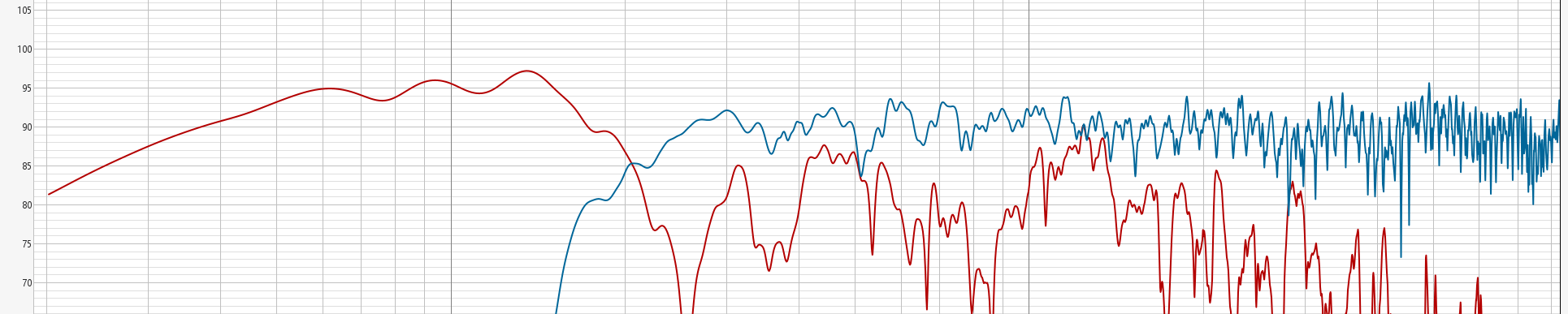

The PPSL 18" "drops off the cliff" above 160Hz, the HF driver's response is "off the cliff" below 300Hz.
Most would want drivers to have a reasonably flat overlap area near the crossover point, your choice has near an octave of compromised (shite) driver response around an acoustic crossover placed between those frequencies.
Considering you had/have high quality 15"s that could cover that range and more than an octave above and below, just seems a bad choice.

I am sure that there is some vibration cancellation, but the "moving mass" is not the total mass, and anyway I'd be more worried about a huge null at 300 Hz.So you are saying the vibration cancellation is more of a gimmick in my situation, considering the weight?
Yea, I'd hate to try and design a decent Xover in that situation - doable, at best, but likely a disaster.The PPSL 18" "drops off the cliff" above 160Hz, the HF driver's response is "off the cliff" below 300Hz.

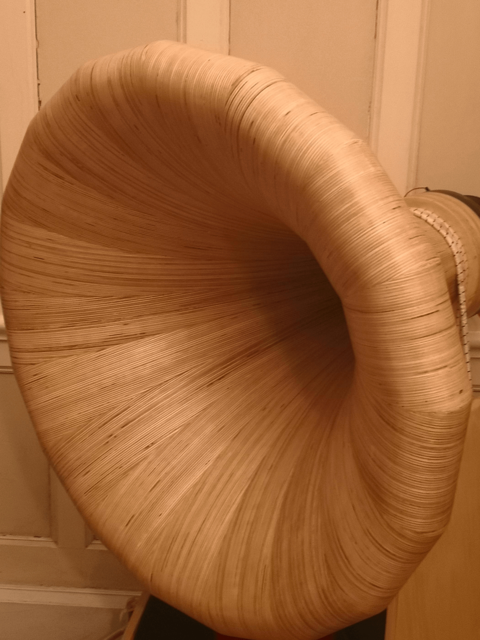

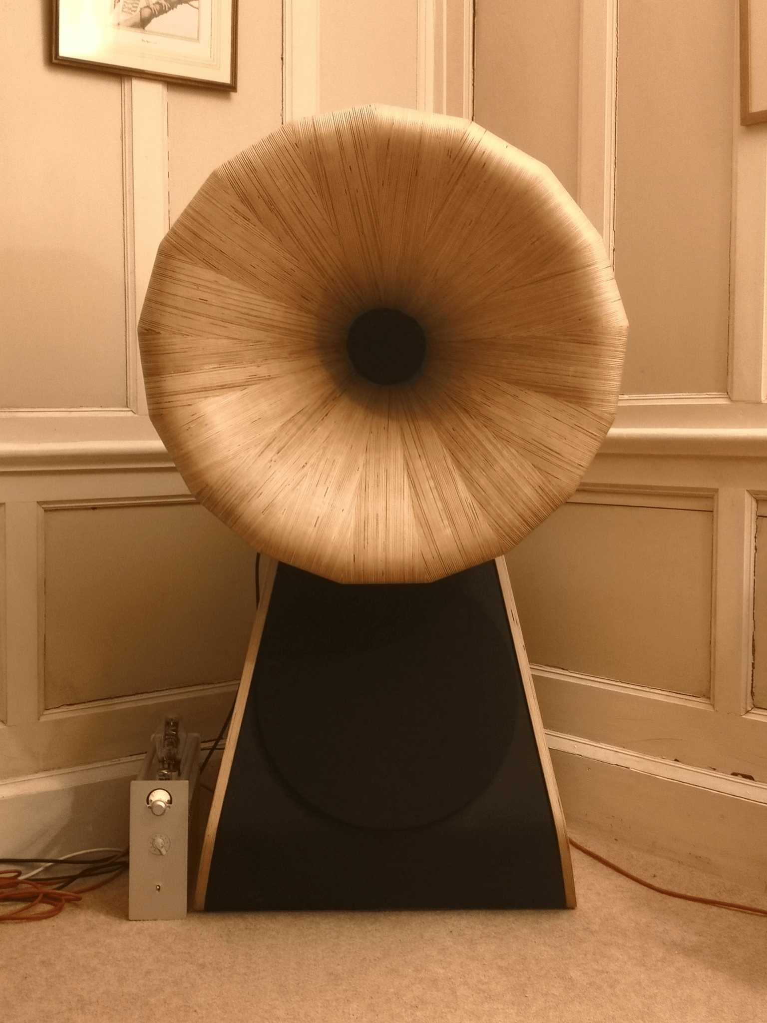

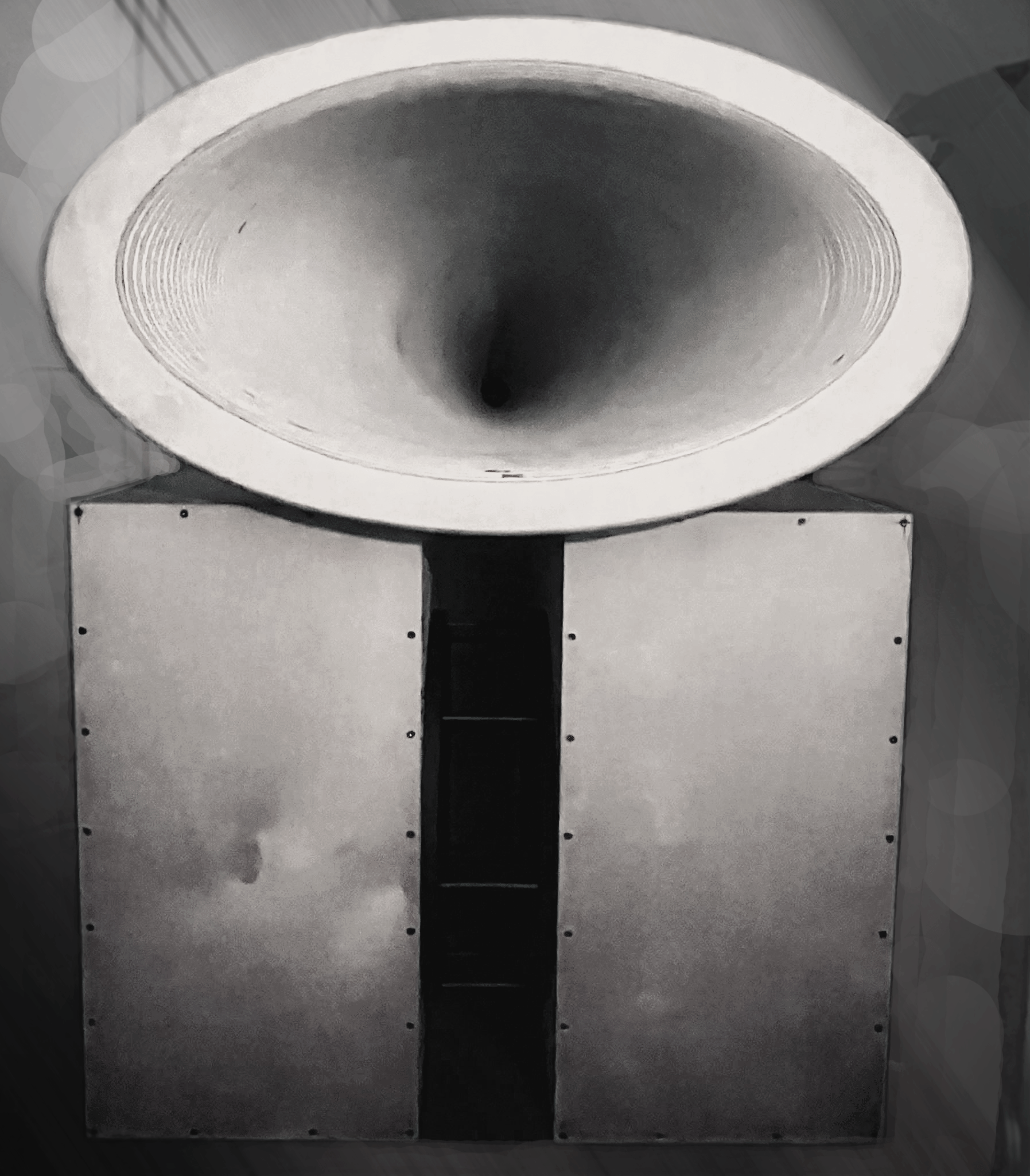

I wouldn't mind a slightly larger horn, a complete roll over, could do the trick, I'd love to see measurements of the horn above on the Axi. 142hz isn't saying much.@maravedis
After realising that 90% of my listening if of pre-1930's recordings I made up this - which gives lots of pleasure!
142hz hybrid-horn with Axi2050 and a sealed bass 18FH500.
The horn driven by a 300b amp with Nickel OPT and is loaded from 200hz and is pretty flat to about 15khz. I use a WARM tube EQ and adjust freely for each recording. The bass is driven by a Behringer NX3000D which adds the delay to meet the treble horn.
This also functions as a centre speaker in a 3 way stereo system.

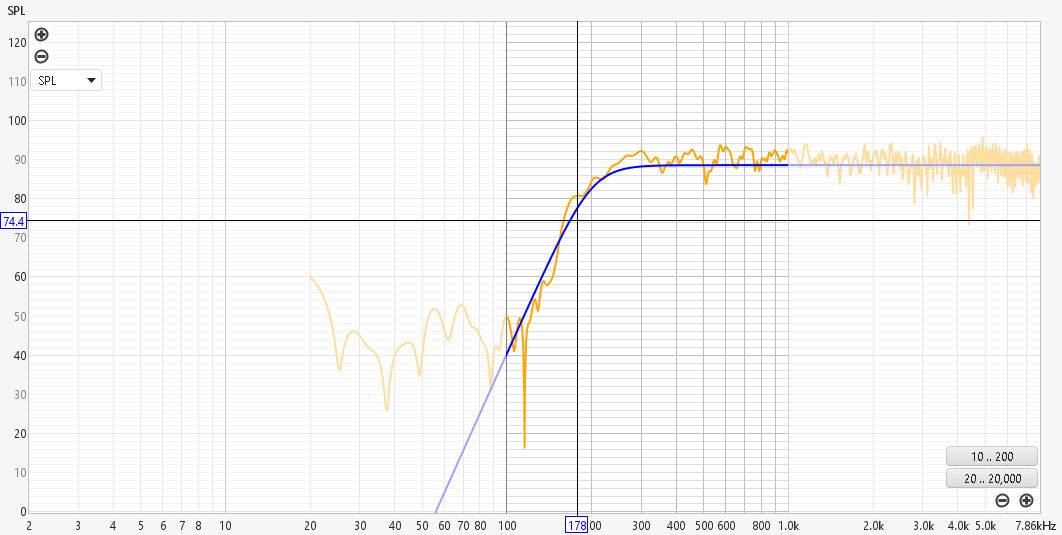

I can't get my laptop to start up in windows where my other measurements are but I came across this, This is at 1m, in untreated room, IIRC these are 1db increments, Whats the issue at 200hz?
I believe that a better voicing and crossover is achievable, as this was sort of thrown together, using the amps dsp. FIR software would do better, right?

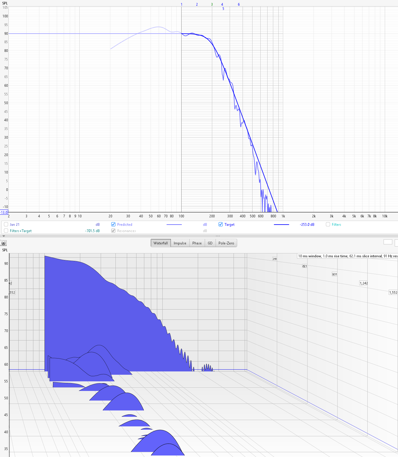

I also did tests by running a sine, up and down the crossband. FR is not going to be perfect because of the room but I listened for some type of abnormality that would suggest some type of failure in the crossing and I don't remember finding it. I think I found the opposite.

do you mean the phase trace? Likely nothing.Whats the issue at 200hz?
The phase seems to be plotted so that there is +/-180deg visible, so the phase wraps around the plot when its more / less than that. The phase trace has undulation to it and it just the plot that looks like it's all over the place as the undulation makes it wrap multiple times back and forth. If you smoothed the graph there would be just one wrap around the 200Hz mark. Or if you plotted the phase like +/-900deg I bet it looks the same around 200Hz as above, smoothly changing curvature.
The XO point is at 200hz.... I am trying to analyze the "flaws"... For a 1m measurement in an untreated small living room, rough draft Xo/voicing at the most...... probably 100ms window... hows it look?do you mean the phase trace? Likely nothing.
Hi, not sure how usable information that is, but looks fine for what it is.
1m is likely too short measurement distance for such big speaker. VituixCAD measurement manual suggests 1m or 3x of device width measurement distance in order to reduce near field effects that are not present in actual listening distance at far field.
In general, since the system is big and crossover is so low, it is hard to get good data around the crossover indoors due to reflections messing up.
You should use some kind of tricks to reduce reflections, arrayed mics or something, see "klippel scanner on shoe string" thread. Or do measurements outside, group plane or high up in the air.
Big speakers are prone to measurement errors, as some issues could be windowed out from measurements, or the measurements contain anomalies from the environment that aren't really there.
