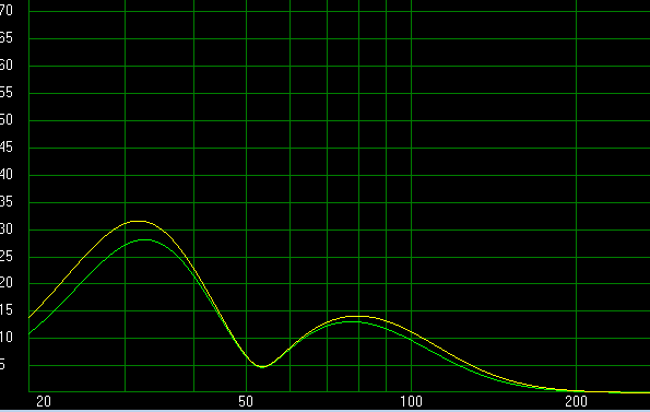

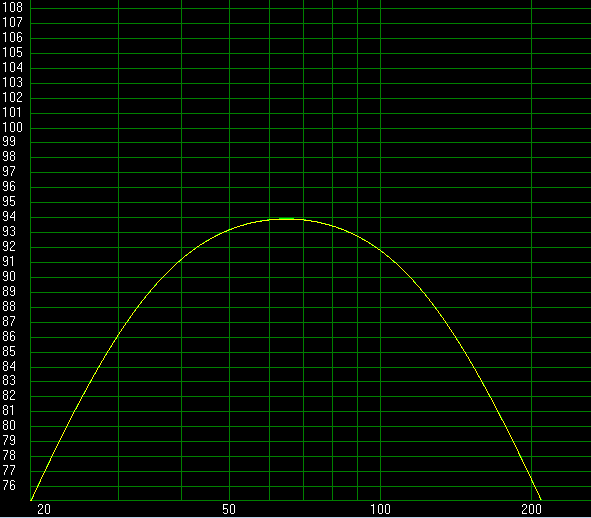

I am confused... your data doesn't support the logic of your statement. You data showed higher BL having more sensitivity than the lower BL driver. No where did you need to boost.... IF this is frequency matched and green is higher BL the lowest chart shows less energy being used by the BL driver.....We ended up lowering the BL actually, because otherwise a boost of more than 6dB was needed to get a certain target response.
You forget the first picture, which shows the amount of boost.I am confused... your data doesn't support the logic of your statement. You data showed higher BL having more sensitivity than the lower BL driver. No where did you need to boost.... IF this is frequency matched and green is higher BL the lowest chart shows less energy being used by the BL driver.....
View attachment 1258898 View attachment 1258901
Even says in the description EQ curve.
You didnt have to boost the low end, you chose to, you could just as easily cut the high end. This chart shows Green using less energy regardless of what eq you used to frequency match.An higher BL also shifts up the frequency response, as can be seen in the paper as well.
Meaning that for the same acoustic response, we have to boost more in the low-end.
The filter used vs net gain or loss of input voltage. You adjusted the transfer function...
High Bl is more efficient. Raising BL does not lower LF efficiency according to that data...

We actually started that same driver with even an higher BL.
Resulting in having to boost 11.5dB for that same target response.
Which is just not doable for your pre-amp stage unless you want to clip the entire thing.
As I also said in the post, the difference in power is only a little bit.
The difference in total amplifier voltage was also only 1.5dB.

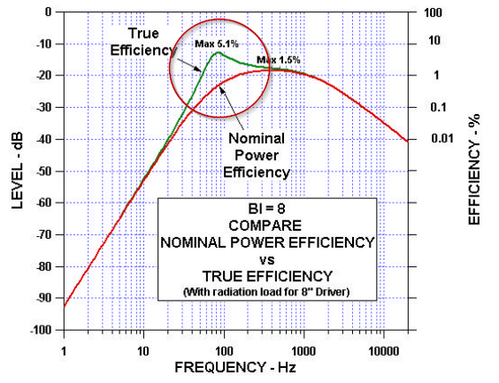

Fig. 1. Theoretical Thiele-Small nominal power efficiency frequency response of the systems described in Section 3.2 for two values of Bl (Bl = 8N/A and Bl = 40 N/A). The nominal power efficiency model predicts the frequency response of the system when driven by a constant-voltage source. Note that according to this model, the high Bl value raises the upper-frequency efficiency of the system to 60% which is 14 dB above the Bl = 8 N/A efficiency, but severely rolls off the low -frequency response of the system.
as well as;
When the true efficiency of the driver is considered, it is clear that increasing the Bl factor will directly result in higher efficiency values at all frequencies. Unfortunately, the constant-voltage-drive low-frequency response may suffer, but this only means equalization must be used to flatten the frequency response.

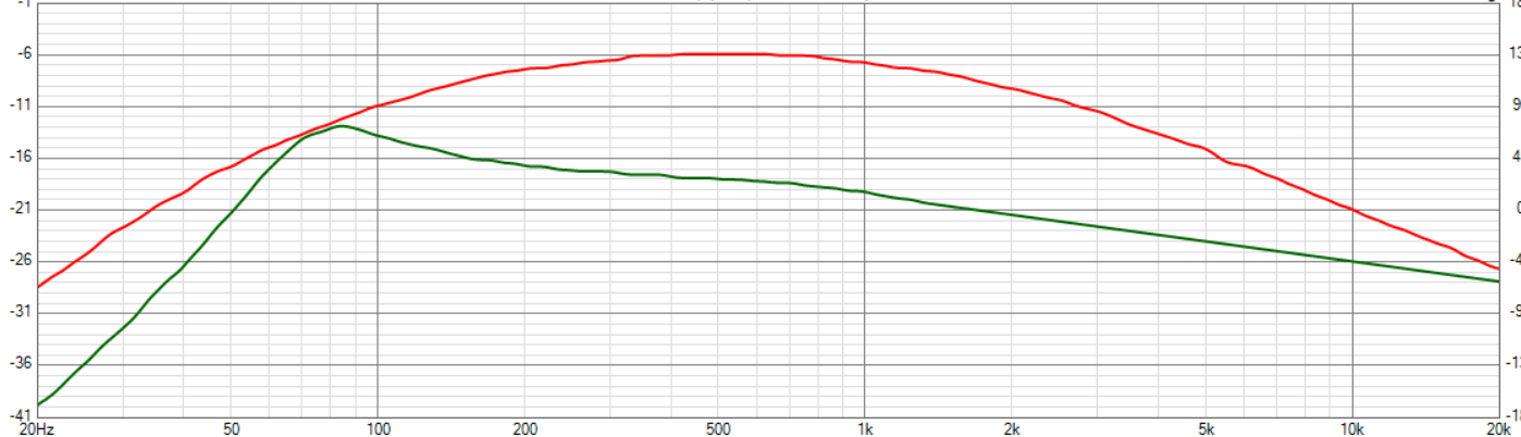

Btw, there is even an additional catch that even that paper glossed over.
A subwoofer only has a very limited bandwidth.
So while the total system efficiency seems to be much greater, if we focus and optimize on just a smal portion, the difference becomes actually very small.
If you compare to the the other graph (I traced them just for good comparison)
You will see that the efficiency is actually extremely similar in that part of the freq resp.
This is where the Fs is of course!
