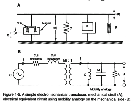

Anyway if you're still unsure, just check the mechanical equivalent circuit of a loudspeaker.
It immediately shows how and why the Mms and Le interact.

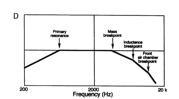

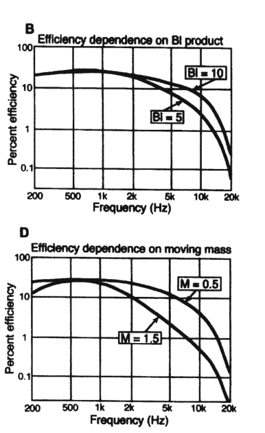

Unfortunately I couldn't find the right graphs for woofers atm, but here are some visual examples what things like Mms, BL and Le do with the frequency response for compression drivers.
Although they are not exactly the same as woofers, the same effects can be expected.
If you really want, I can find the ones for woofers as well, but it has been a while so I have to dig deep.

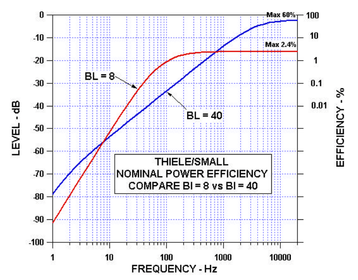

D.B.Keele considered an effect of BL factor on woofer efficiency
Comparison of Direct-Radiator Loudspeaker System Nominal Power Efficiency vs. True Efficiency with High-Bl Drivers

System efficiency or rather usability is an entirely different thing.
An higher BL also shifts up the frequency response, as can be seen in the paper as well.
Meaning that for the same acoustic response, we have to boost more in the low-end.
So eventually we will end up in a circle of compromises between acoustic volume, acoustic power, electrical power and the amount we have to EQ. (VAS also has a tiny bit of importance in here)

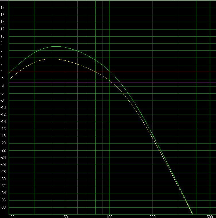

For a very specific custom project for a customer (can't disclose anything unfortunately), we have been investigating a custom subwoofer.
We ended up lowering the BL actually, because otherwise a boost of more than 6dB was needed to get a certain target response.
Which can be troublesome for either the amplifier or pre-amplifier stages/active filter.
Green = higher BL
Yellow = lower BL
Except for BL, all other parameters are the same.
EQ curve:
Freq resp:

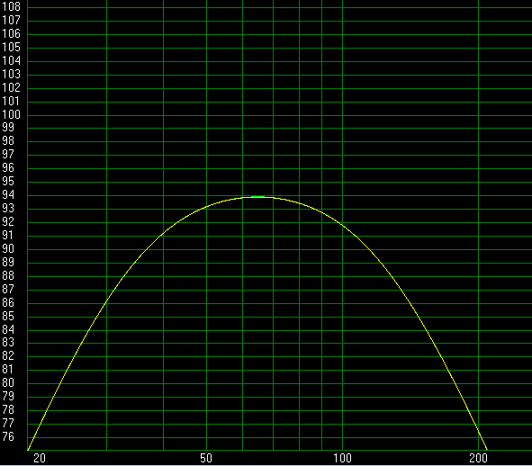

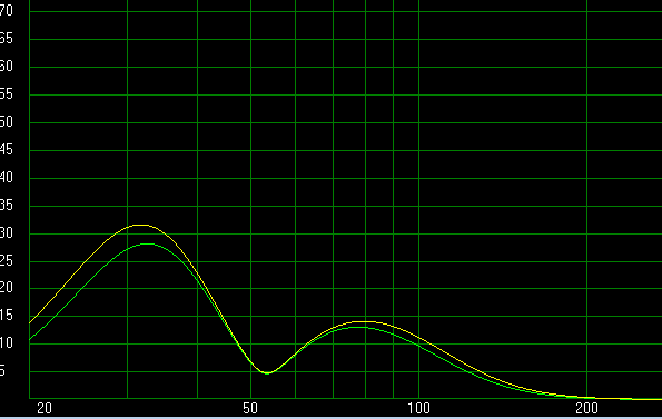

This is the power graph (VA curve), as you can see, the amount of extra power is only a little but more;
Even for people with big mamma woofers, this is important.
Unless you just buy the biggest amplifier you can buy with a pre-stage that has plenty of headroom.
But otherwise you really run the risk of clipping and/or wasting power for nothing.
Green = higher BL
Yellow = lower BL
EQ curve:
Freq resp:
