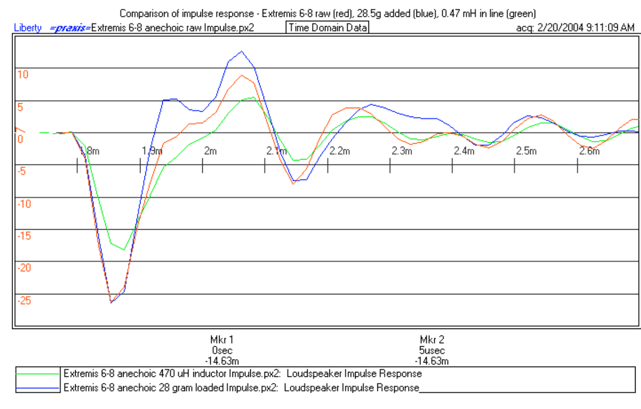

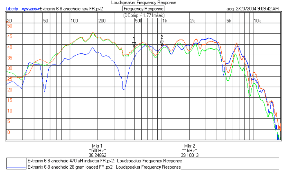

Transient response = speed, faster = wider BW, ergo a 'faster' transient = higher peak SPL for a given frequency and the lower its inductance, the wider its BW till the driver's vibration inertance/'stiction' rolls it off.
The added mass actually damps the driver's resonances above its upper mass corner (Fhm) where Le dominates, ergo no Qes, BL, mass ratio theory and above Fhm arguably better performing.
Increase inductance though and the HF response begins rolling off above Fhm to a lower HF corner frequency.
All this is clearly seen in the driver's measured response(s) in the 3rd plot you didn't post.![sigh :sigh: :sigh:](https://files.diyaudio.com/forums/images/smilies/sigh.gif)

Why don't we say that Le and Mass both dampen the HF sensitivity. Le and Mass both dominate, Le did not defeat mass, just like a super light cone can't defeat high inductionTransient response = speed, faster = wider BW, ergo a 'faster' transient = higher peak SPL for a given frequency and the lower its inductance, the wider its BW till the driver's vibration inertance/'stiction' rolls it off.

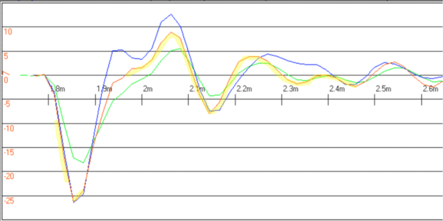

"Transient response = speed, faster" _ exactly except you havent stated that the Raw driver is performing faster than the Weighted
True, there's 'no replacement for displacement' and combined with critical damping = compression horn. Congrats! You've proved that the pioneers got it right the first time.Removing excursion, Obviously is the key. One side of the Spectrum would be a light coned system where all large excursion has been remedied.
![cop :cop: :cop:](https://files.diyaudio.com/forums/images/smilies/cop.gif)
The quote below (which is now correct) was originally and incorrectly showing as being by camplo. Not sure how that cam e to be, however...
But mass doesn't, just as the driver's measurement shows, i.e. it 'tracks' the driver's response out to the full 20 kHz whereas even its very low Le rolls it off sooner.
Once again, these measurements are incorrect. The added mass should reduce a peak value of the IR graph compared to the raw driver. While both the frequency response in the Hi and Mid range and initial part of the IR graph of the driver with the added mass is almost is the same as the raw driver. This contradicts to fundamental laws of physics. The higher the mass is , the lower driver efficiency is (lower efficiency leads to lower sensitivity and lower peak value of IR graph ).

Why don't we say that Le and Mass both lower the HF sensitivity. Le and Mass both dominate, Le did not defeat mass, just like a super light cone can't defeat high induction in terms of HF sensitivity.Transient response = speed, faster = wider BW, ergo a 'faster' transient = higher peak SPL for a given frequency and the lower its inductance, the wider its BW till the driver's vibration inertance/'stiction' rolls it off.
"Transient response = speed, faster" _ exactly except you haven't stated that the Raw driver is performing faster than the Weighted
The raw driver is ahead of the weighted driver, I highlighted it in the areas that it is. The impulse isn't the same as the steady state, but it should give some clues about it. It wants to do what IR does on every Cycle, its just that the voltage is defeating it. Every new transient which is every peak and trough, it is influenced by the IRs character, to some degree. In the above example they added pennies on the dollar, there are 300g mms drivers with the same BL as another with a 190g mss driver, those areas in yellow only get farther behind as mass increases but 28g is not enough to super crazy is all. Look at the FR below.... they barely made a dent in the HF sensitivity with le or Mass.... All 3 examples have the ability to play up to the same frequency... not the best example to show effect. Increasing mass will lower Q specs if only mass alone is increased. Is that enough said? These penalties will only be exaggerated in the outskirts of excursion, especially with additional mass void of additional damping and motor to control that mass.

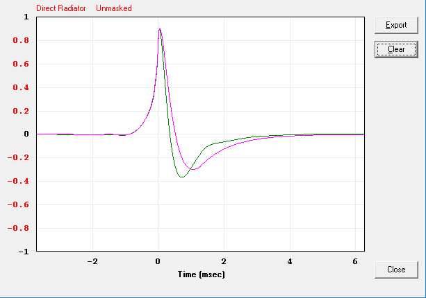

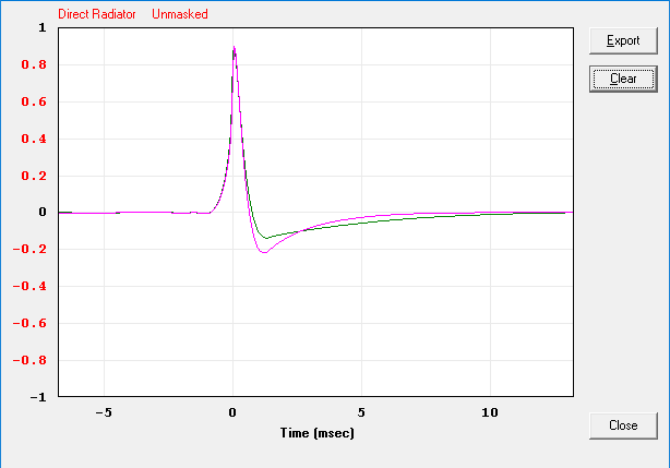

Here Is 720g qts0.17 Purple versus 72g qts0.10 Green
720g Qtc=0.17 Purple vs 720g Qtc=0.34 Green
I think the missing element is FR matching below. Until you match SPL you aren't seeing the final transient response. Thats if what we see below is the representation of each response IR we saw earlier. The already bad Decay of the Weighted driver will be even worse than what's seen here. I believe the difference between a lot of drivers will be at higher velocity

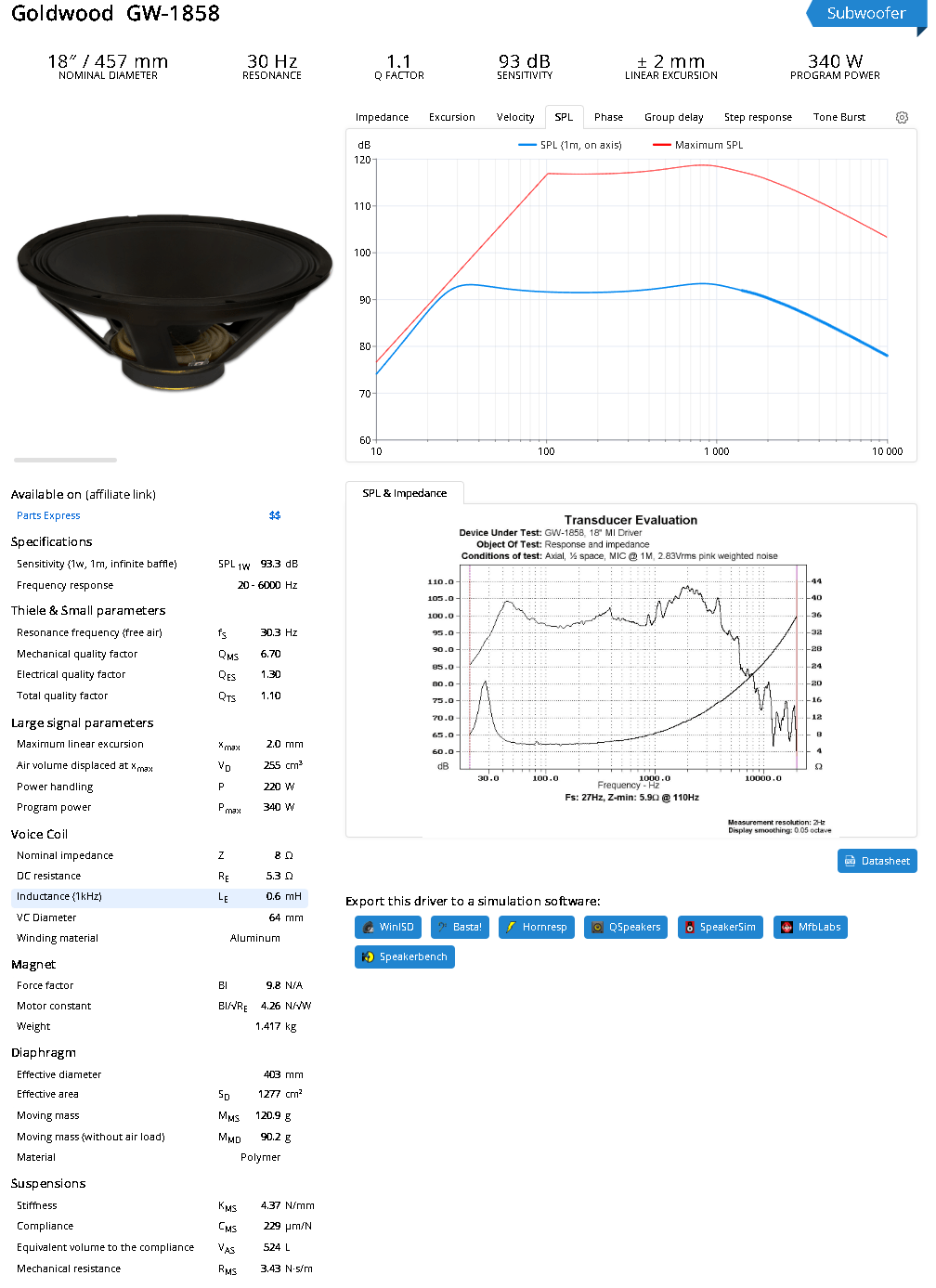

PS. The GW-1858 data seems like nonsense since the impedance peak and the response peak are way off of each other and they should be at the same frequency.

Yeah, they removed it from their site some time ago, but a couple of actual DIY measured ones I've seen show each graph as accurate enough.
@gedlee @GM Im trying to understand the chain of events. I'm not sure what errors I spoke but I concluded that Le is responsible for transient response. Now I am able to agree with you guys, without just blindly following. You guys are on another level, you see errors in thiele specs, like a woofer whisperer.
The other thing I spoke on, that I'm not sure how you guys think, is the issue of the performance of decay versus transient response. I think that the worse decay is, the worse transient response is. I cannot suggest to what degree. I was theorizing that the decay character of the IR is present to some degree at every oscillation. Voltage of the source can
Dampen this, and how it is expressed in the signal will be complex. This was relevant to experiment recently discussed, as the driver with the added mass had worse decay.
I am not sure I follow completely. The transient response is given by the shape of the transfer function / frequency response. Impulse response is just another way of displaying the same thing. That is theory. Are you trying to find out how much does the reality differ from theory or what is your aim? I mean real drivers vs TS parameters based model?
