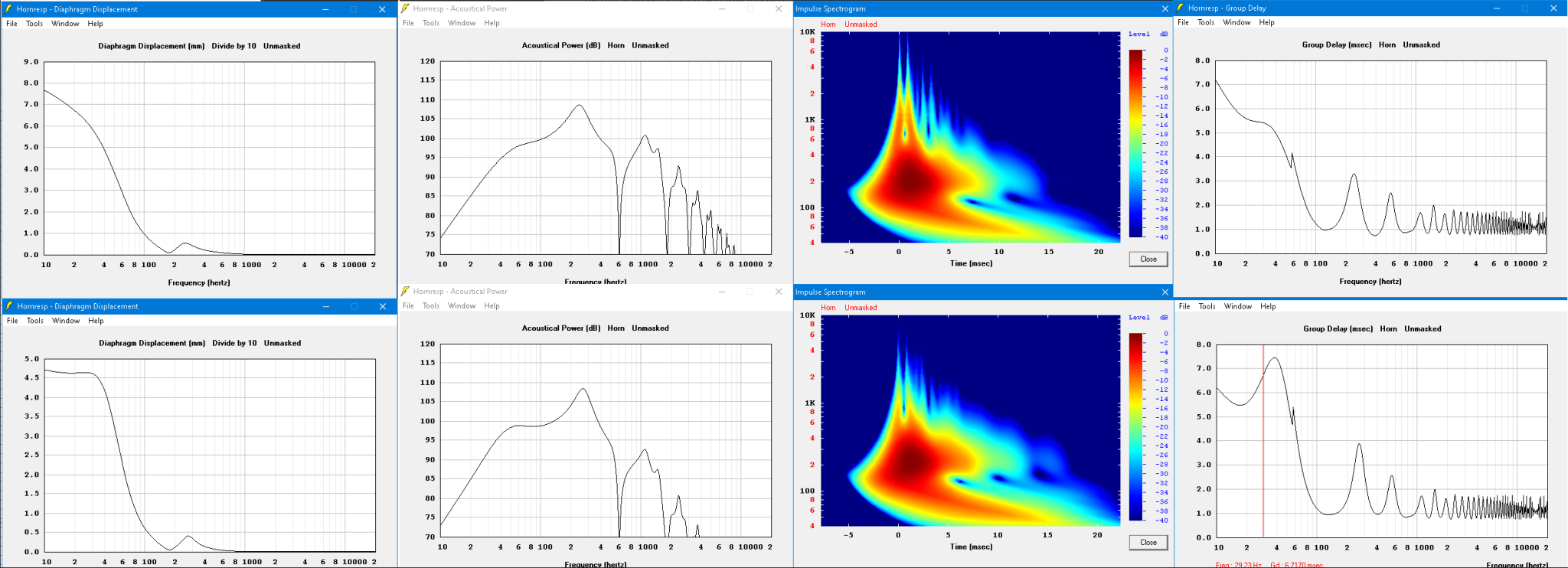

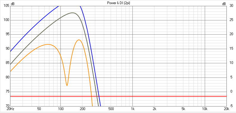

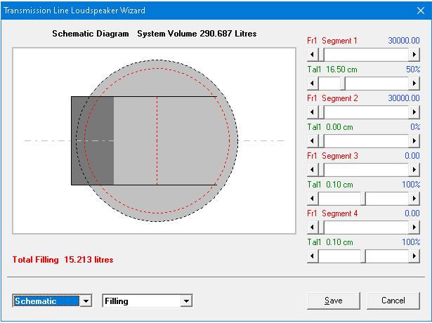

I've modeled a different slot loaded enclosure... The 21" on the bottom and 18" on top. 2.83v

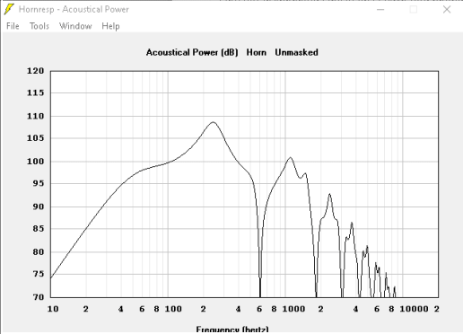

The huge peak/dip that results from slot loading has hardly changed. If used as a subwoofer, (<100Hz) those peaks are not much of a problem.

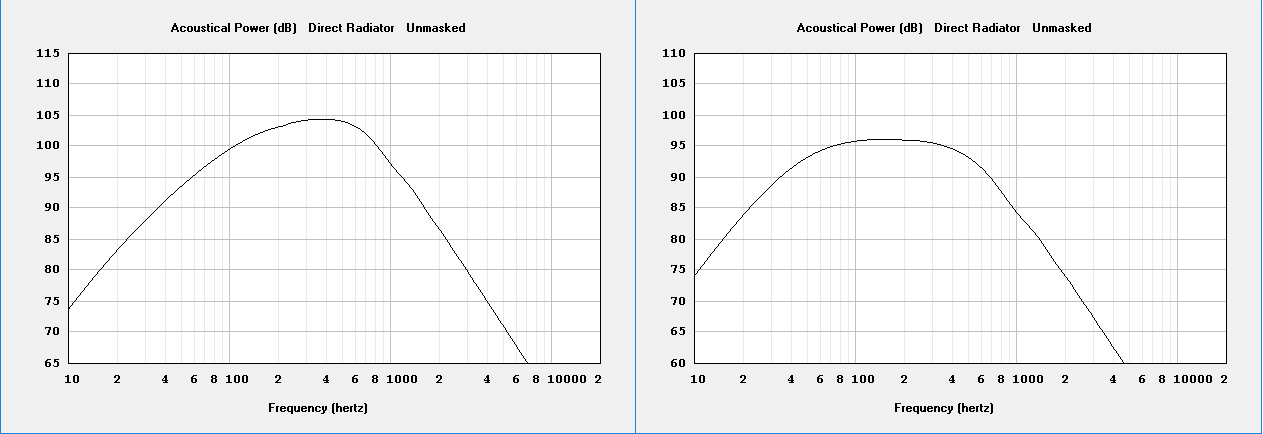

Your front loaded 15" frequency response is far better (more linear)in the 200-1000Hz range than the dual driver slot load, whether "in combination" or separately.

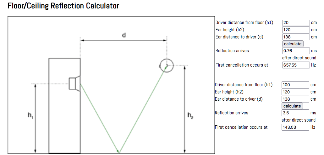

Boundary reflections will cause peaks and nulls dependent on the distance relationship between the acoustic point of origin, the boundary, and the listening position.
https://mehlau.net/audio/floorbounce/
Floor:ceiling reflection.png
At close distances the inverse distance loss and a higher directivity index increase the direct to reflected ratio, reducing the depth of cancellation.

The location of the woofer in relation to boundaries (floor, corner, any wall) will affect the measured response.
Whether the peaks and nulls at a particular listening location are "better" depends on what range you look at.
In combination with room, unfortunately the 15's response was not better. In situ, the FR of the Sub, was better than the 15". The design is based around an ear height tweeter, and full spectrum mains. The flaw is tied to floor, ceiling bounce and at least one of the cancellations won't change due to the height of the mid, which is at where its supposed to be.... So if it can't live where its supposed to, it cannot live. The floor level woofer has the best FR. I can't cover 200-20hz with the 15" so no reason to "reposition" it there. Theres another dip around 80hz from the ceiling, I think, for the floor level sub.

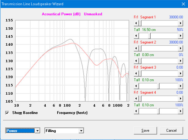

I just needed to move the null, that was the only issue, nothing else is an issue in the current design except there a null in the middle of the crossband band. The "peak" is not an issue, even in the Horn resp sim, the decay times where not an issue, in particular, after designing a HF roll off. After that, the decay is no existent. There is a GD spike, at that peak, but after EQing out the peak the GD is gone with it.

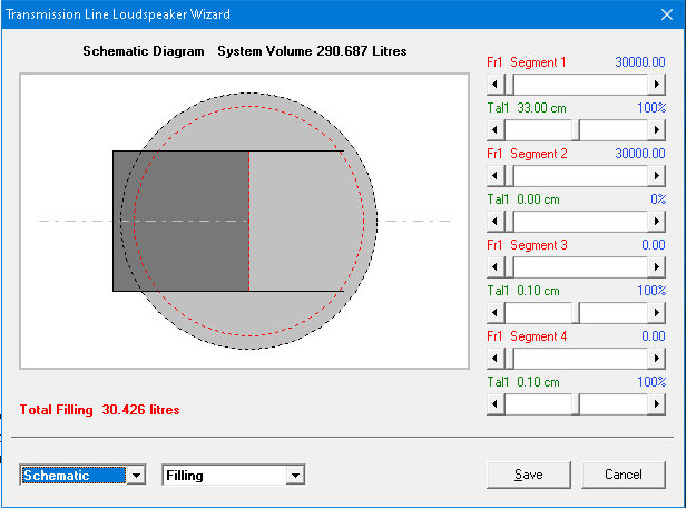

There is another approach I haven't entertained. Damping material in the slot, very simple in HR but in real life? Never tried.

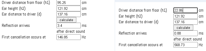

You found boundary reflection cancellations at 54"... What about the one meter (39") listening location you wrote you had decided upon?

As your sim indicated, damping material in the slot will reduce the depth of the dip and peak.
Mineral wool (Rockwool, GeoWool etc.) would be fairly easy to cut and friction fit in the slot.

In the picture, The top of the sub cabinet is 29" Desired HF axis height is 48"... This is ball park scale accurate (+/- a few inches)
A tweeter height of 42"-48" would create a distance of 33"-39" CTC.
Its either that or raise the woofers off the floor. Lose the good mode performance or lose the 1/4WL spacing. If I raise the Tweeter up to said height, allow it to rest the same way as it rest's on the sub, the tweeter is slightly angled up. I could enjoy a slightly lower tweeter, this way, other wise I have to point the tweeter by raising the rear of the horn some how. I imagined the pictured configuration and thought.... There's room for another woofer. I wasn't thinking about how I got to this point, nor did I keep this cancellation business in mind, at that time.
There is a floor cancellation that I need to avoid. I can see 42-48" being the tweeter height. The tweeter angle needs to be adjustable.

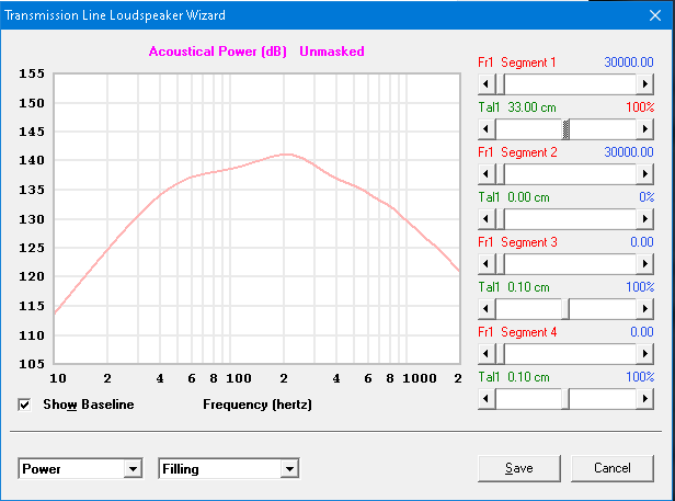

The above is to show what happens when I fill the slot to the middle of the current 18"s. I looked at this before building the box, just never took a chance to see how real life would play out, yet. Keeping the filling towards the back, leaves the lf un attenuated according to the sim.
This, below, looks like the performance I might have in the basement from the midwoofer. Somewhere between 100hz-200hz there will be a null, as it were upstairs. I can get a little better result if I finish the baffle sim in the program but really, is the two way version that bad>? Seems to have potential for a better FR at least. There is always the sacrifice of keeping the horn as I had it previously, sitting on the 26" box putting the horn center at about 36" slightly pitched upwards

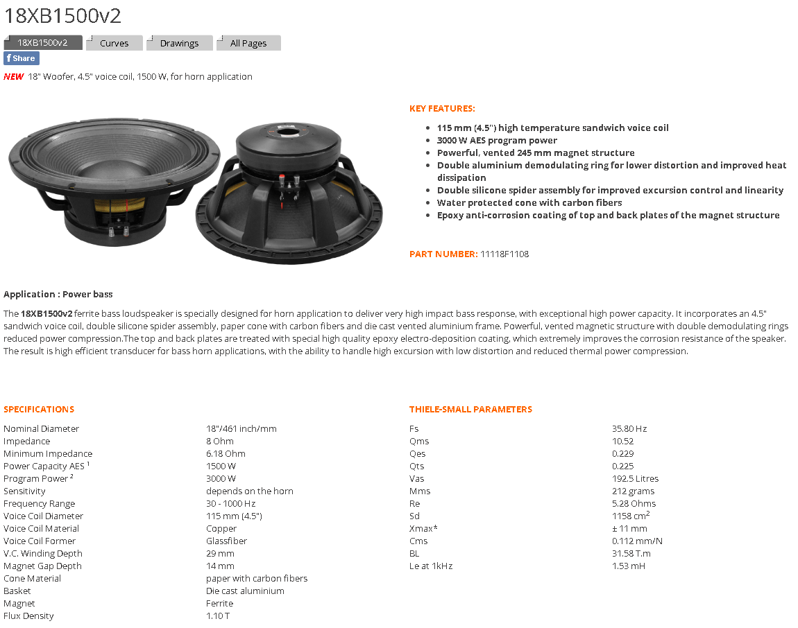

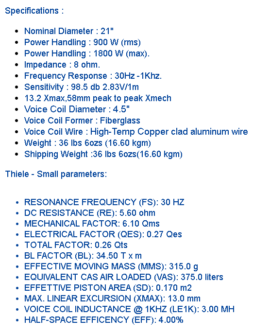

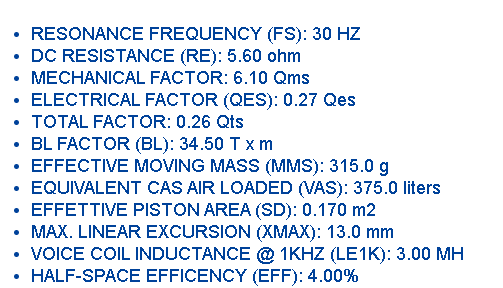

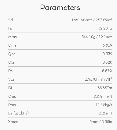

This is the small print for xmax on the above driver
@b_force @GM
I haven't gotten that book yet but I do have a small knowledge base on this and along with the forums help, I should be able to pick some woofers, without reading the book first. I started comparing BL to mass, this is when I seen a new perspective as I noticed the BL to mass ratio was highest on certain woofers, like the M2 Woofer.... 18H+ is up there as well. So from there I was able to start organizing the loudspeaker database in a better way to expose this trait, and thats how I found the Oberton. I think Qes, Bl to mass ratio, and Le affect transient response, either can be a bottleneck. A driver like the JBL where the BL to mass ratio is high but the Qes isn't low confuses me..

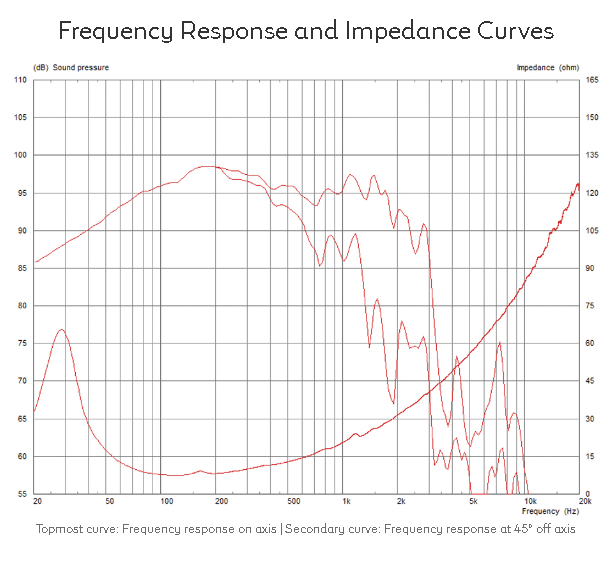

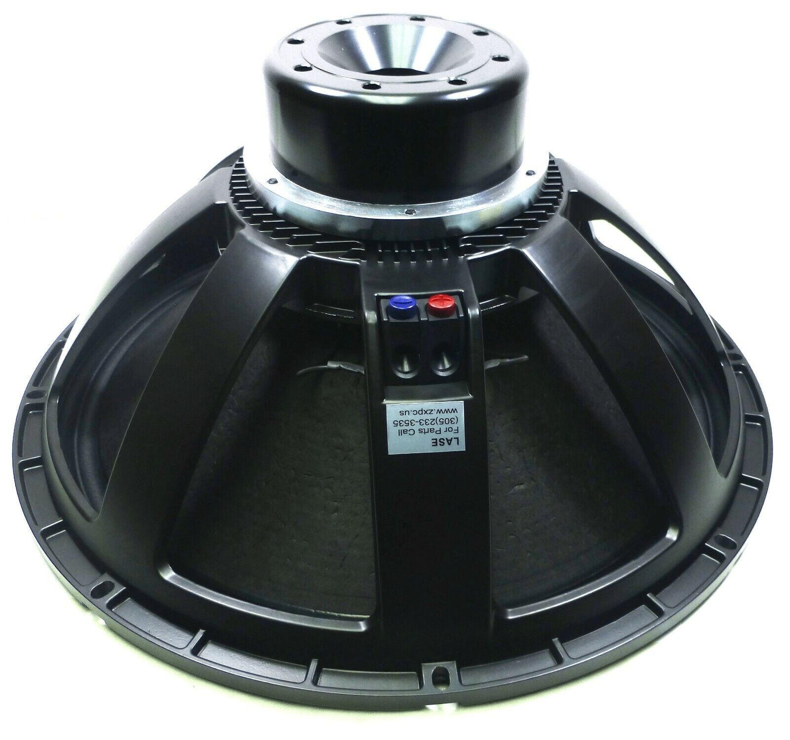

If I step away from the BL to mass idea, this Celestion is decent, pretty much a cleaned up version of the Dayton 21"
The Lase is best bargain but is this real? I mean like, is this a trusted brand?

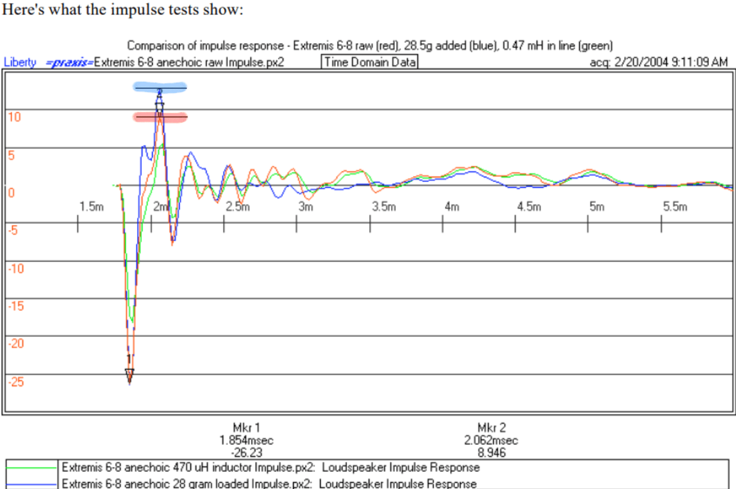

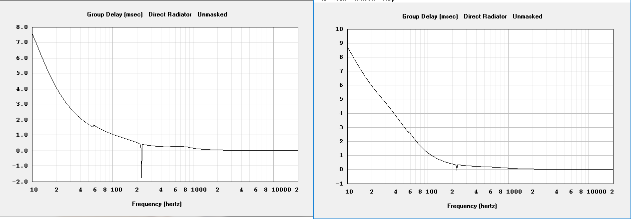

I don't see how its missed in this study, this huge overhang. I can't see GD in the IR but... in my experience, low motor control increases GD in bass or where ever resistance is and has worse Decay performance.

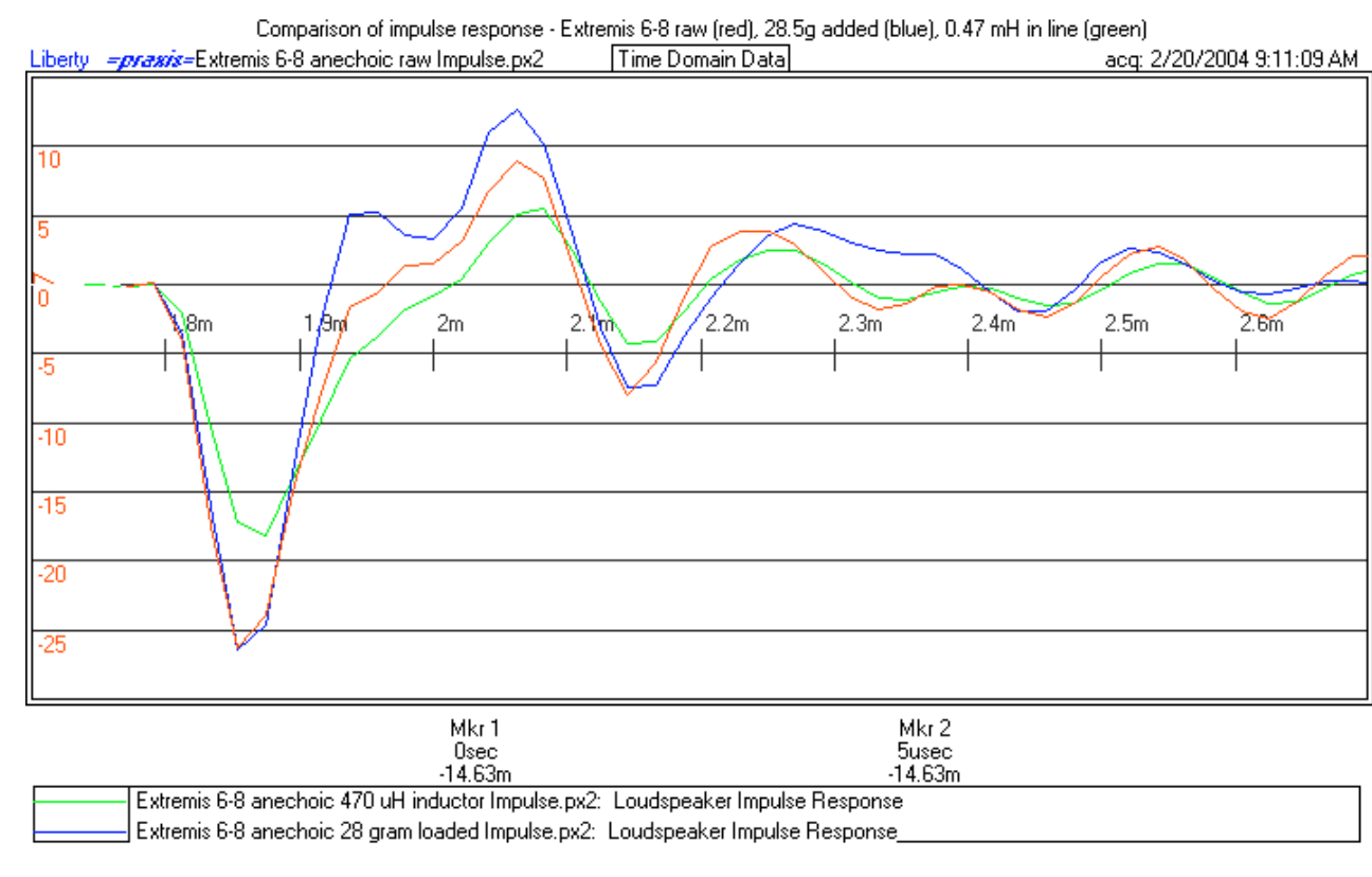

The added mass method is perfect at low frequencies , when the cone approximately moves as rigid piston.
If you can add rigidity without the mass, I think performance is better. Increasing mass without increasing BL, worsens transient performance. The issue is creating a cone that is rigid enough to hold shape at high SPL. This is the reason why we see lower distortion at high SPL with more mass. If you null out cone Material, I believe this will hold true. By creating variance in cone material and size, as you compare you lose the relationship of mass to rigidity so the obvious is not obvious anymore. Using the same motor, cone material and size, as the cone gets thicker, it increases rigidity. At higher spl the cone is less likely to misshapen. At lower velocities the higher energy storage will lose to the lighter cone. Nulling as many variables as possible exposes the truth but when comparing cones that are made from different materials and geometry, thats complicating everything.

Can you elaborate? The above graph shows that adding mass literally distorts the transient, more.....
Why are we ignoring the overhang? Transient performance and HF performance may be connected but aren't literally the same thing. Just because something has no issue taking off from a resting position doesn't take away from the what it goes into motion. Impulse test are inconclusive evidence for this topic.
If I simulate this in horn resp, GD will be higher in the LF

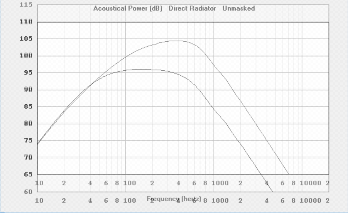

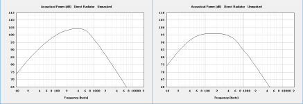

Above is a driver in a sealed box and on the right I have increases mass from 74g to 300g
What I see is that anywhere there is resonance, transient performance is worse. The areas above and below resonance will have better transient performance.
The poorer the performance of the carrier signal, the worse the modulating signals will be.
The blue curve has added mass and it makes an existing cone resonance much worse
isn't this true for resonances sources else where as well, like from the cabinet? It would seem so.
Low pass filter.
Le= low pass filter
Mass= low pass filter
The only difference is that mass can be counteracted by motor force, but back to this image, the Blue Impulse is worse, than the Red one. Take this same test at 80db and another at 115db and then we will really see the truth, even more exaggerated. I don't believe some are interpreting the data correctly. velocity affects transient performance.... The test isn't even volume matched.... The Green and the Blue are worse performers than Red.
The initial attack from rest, is identical of the Red and Blue, at this volume, but I am saying that the overhang will be an issue for an modulating frequency that resides witrh the cycle time of the overhang. Clean transients not exist outside of the over hang. The worse the overhang, the worse the symptoms. Adding mass increases overhang.
I'm starting to feel like looking at Fs as a function of Q manipulating the roll off of the True system resonance, which is where ever sensitivity has peaked.
Here, Q has changed but LF below Fs has not. In this view it is obvious that the mass has lowered the HF sensitivity, which is what we also see with raising Le.
( same graphs from above superimposed, 74g and 300g everything else the same)
