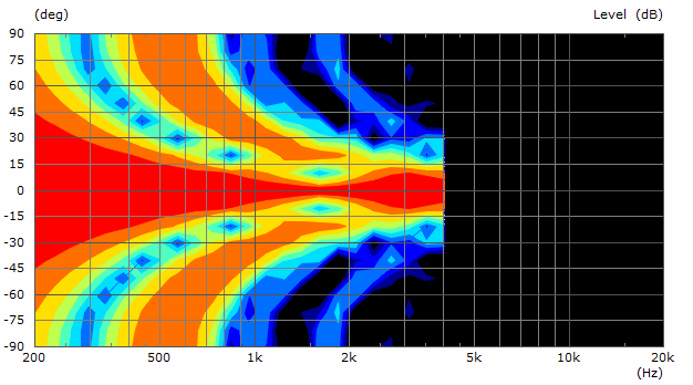

For a start, this plot of two oscillating 15" pistons in infinite baffle and 25 cm distance (edge ​​to edge) vertically, may shed a light (courtesy of FollGoTT):

As I understand it, MTM has a narrower dispersion pattern and potential off axis lobing issues and is exacerbated by using larger woofers... That's from what I read, not based on any experience, so take with grain of salt.
Also, two woofers side by side is not a good idea as the moment you move your head, you will hear comb filtering issues, or at least that has been my experience when I tried that as an experiment. The psychoacoustics behind it from what I have read is that the ears are more sensitive laterally versus vertically when it comes to sensing location.

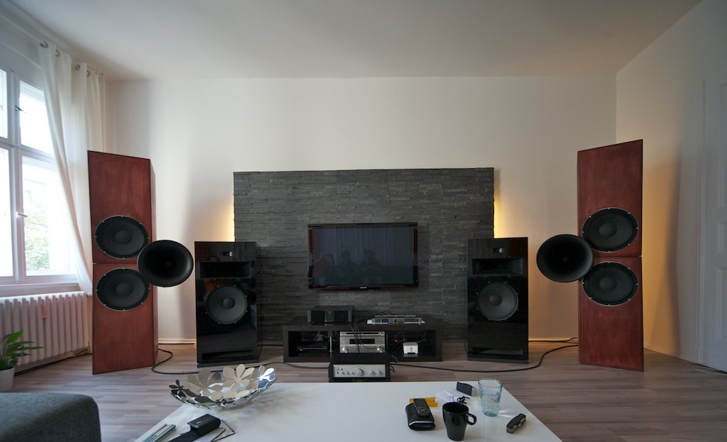

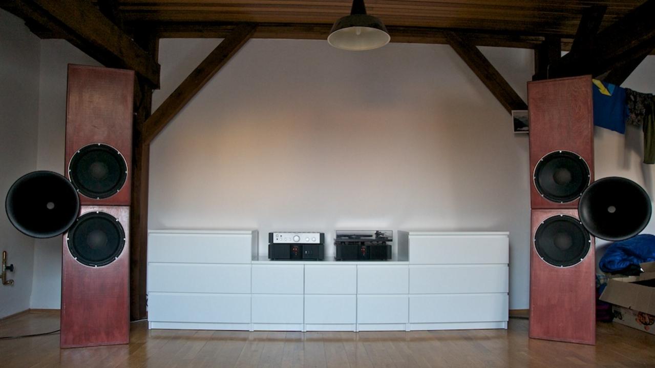

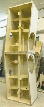

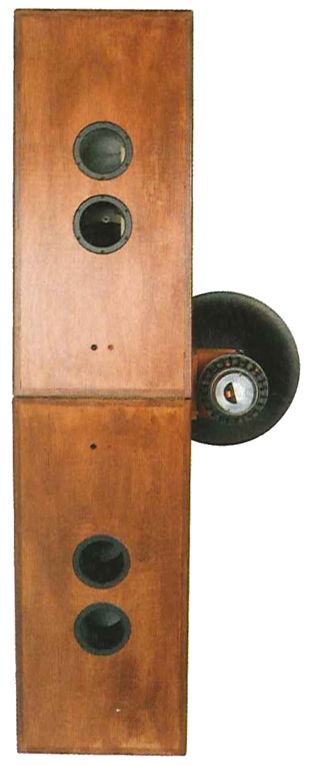

camplo, for your inspiration.
This was a project in a German DIY magazine about 9 years ago, based on:
- 2x Eminence Kappalite 3015SLF
- BMS 4590
- StereoLab 250 spherical horn.
