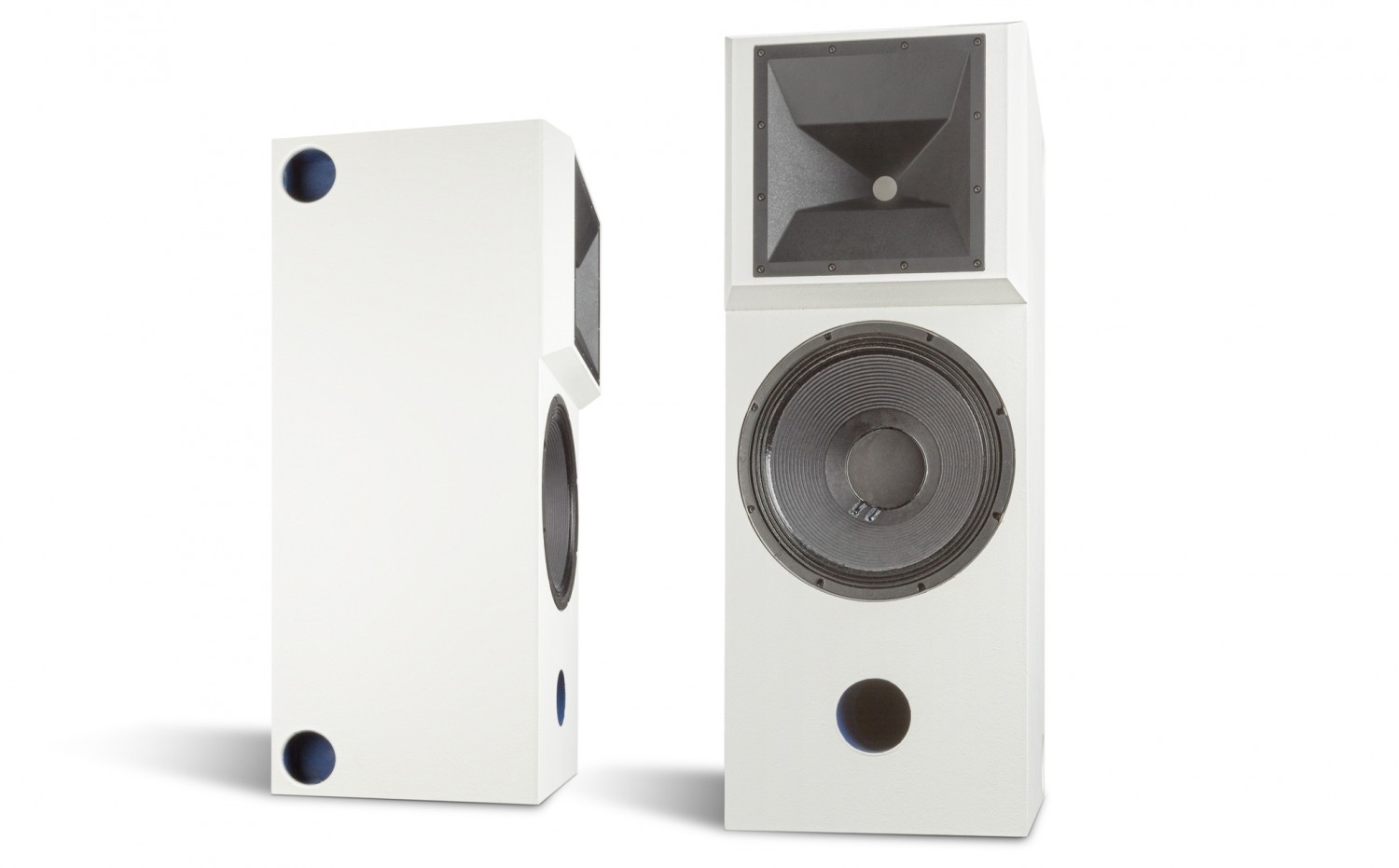

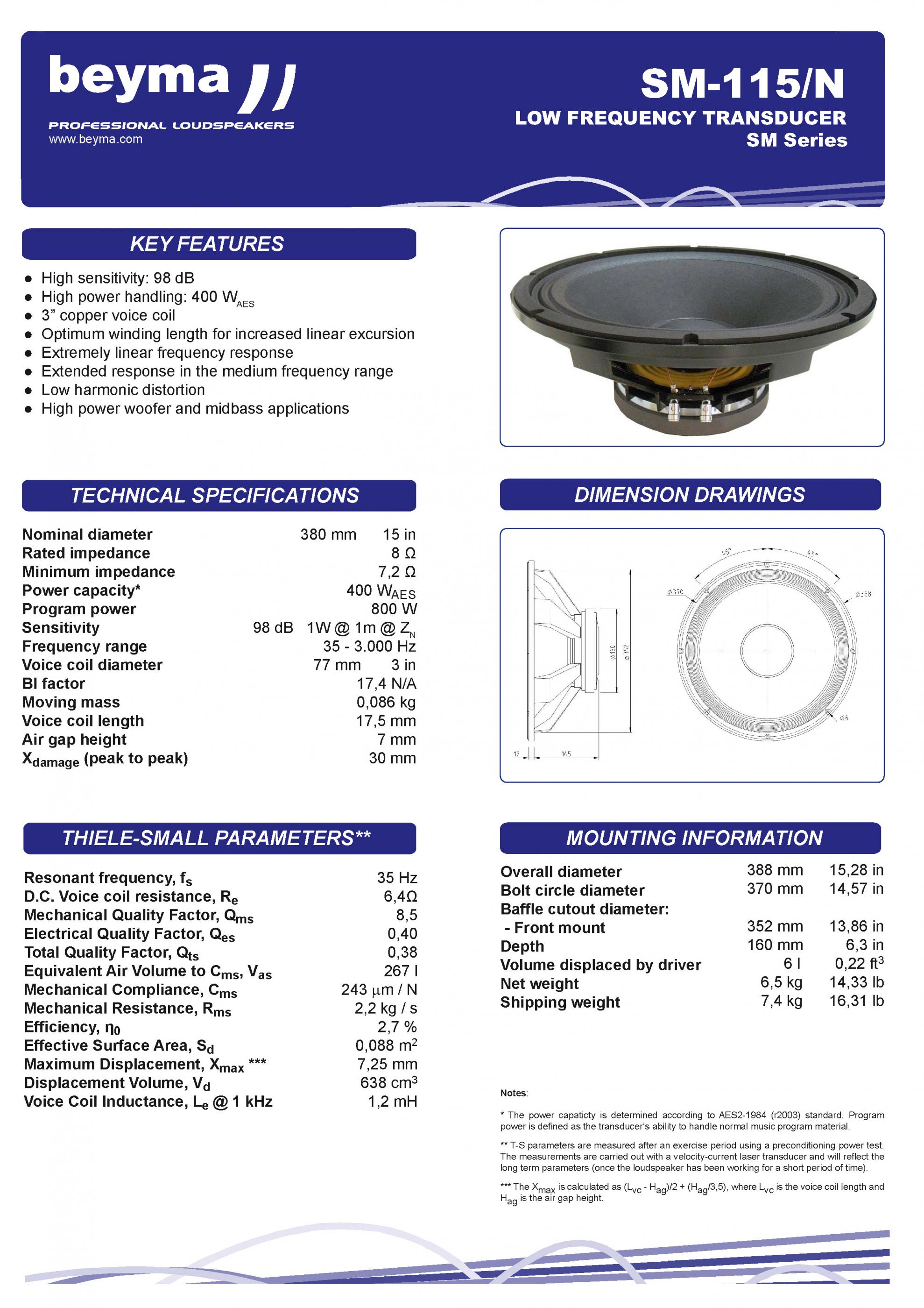

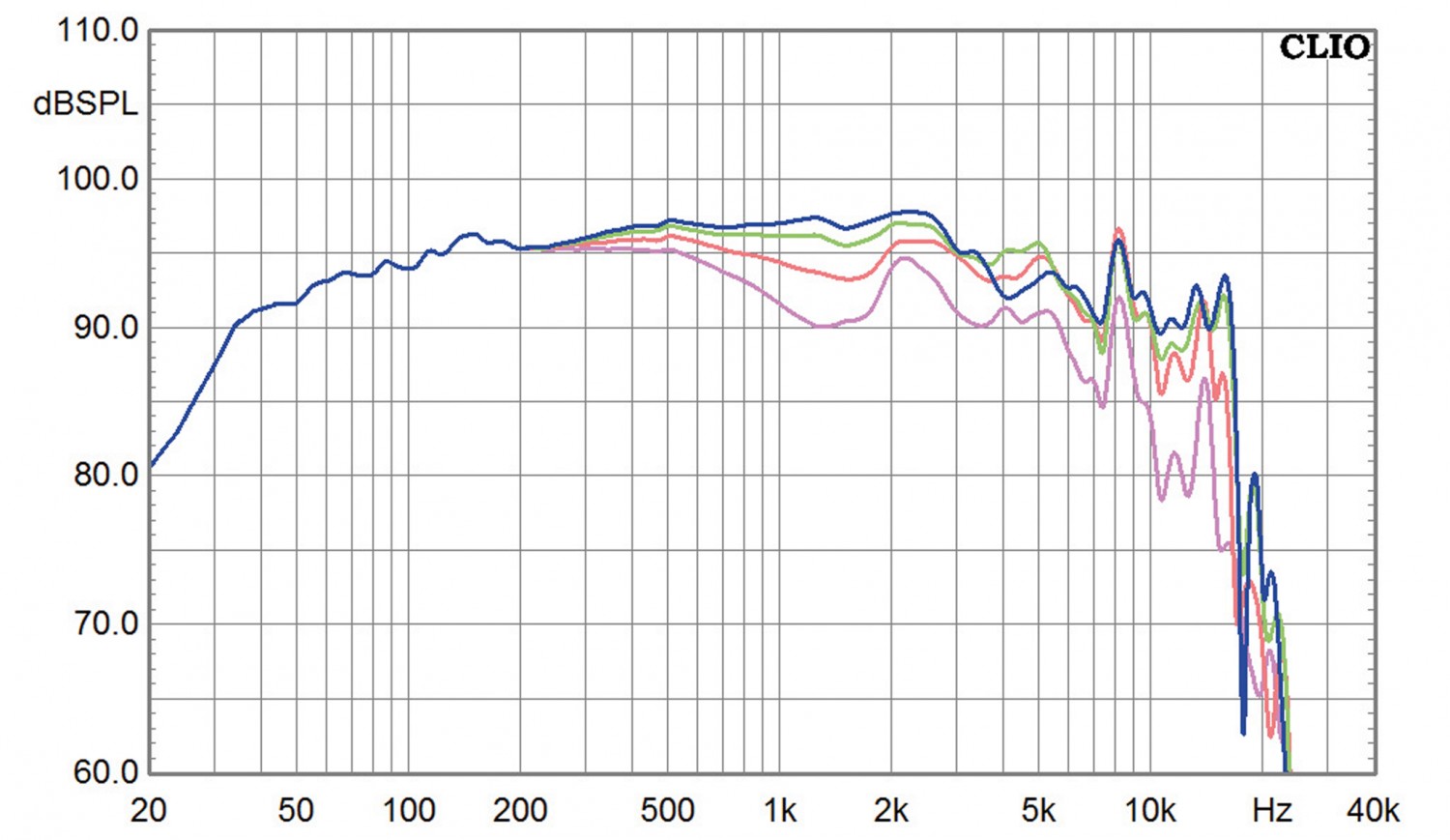

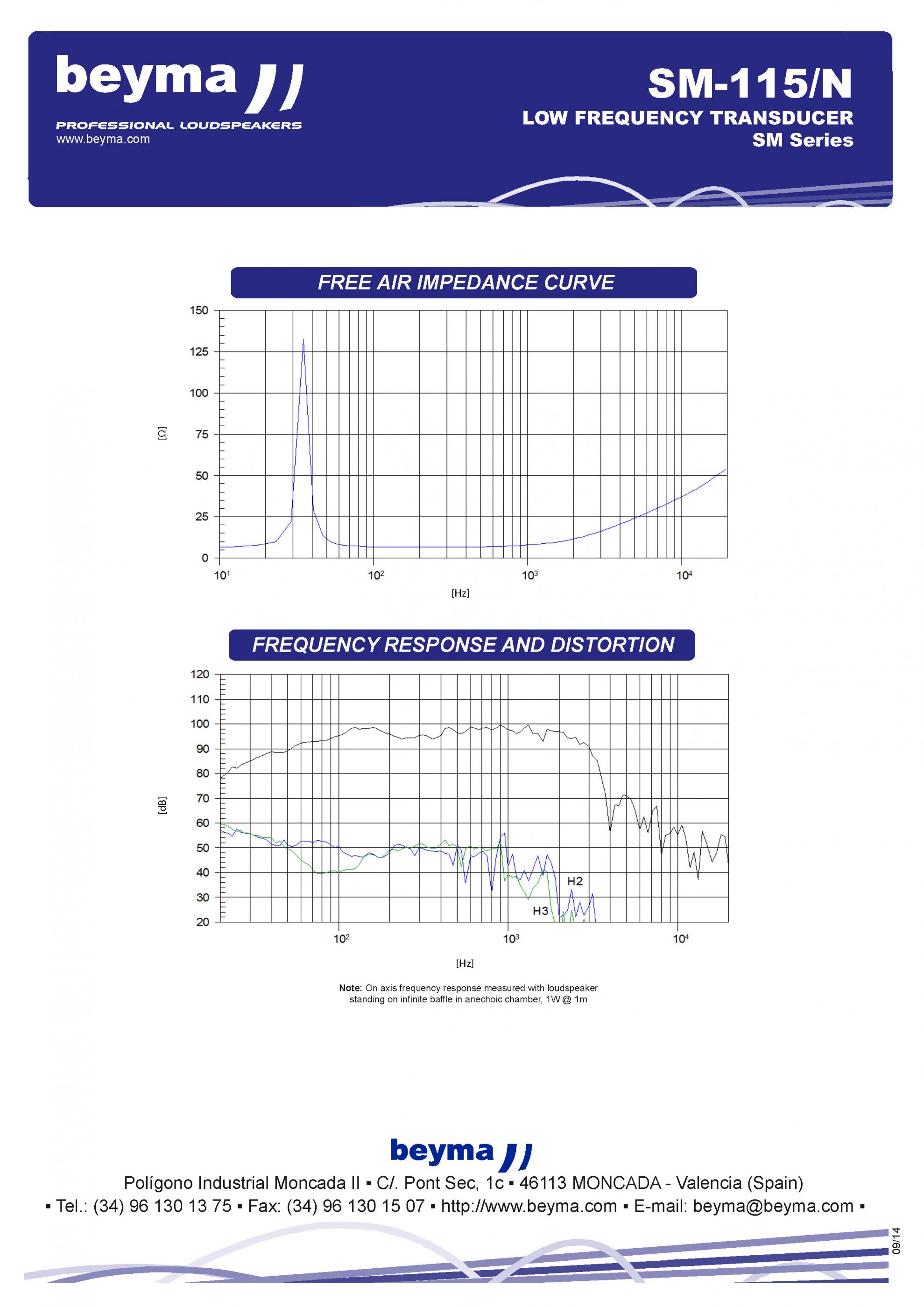

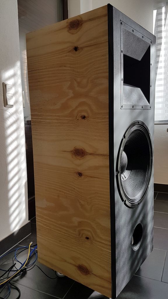

Another DIY project from Germany. This time an active dsp-ed 2-way.
I like the concept and the woofer is ok, but personally I would build this thing with Faital, B&C, or Beyma parts.
It's a 160L cabinet with 1.4" horn and 15" woofer and Fb: 35Hz.
Woofer is Monacor SP-38A / 500BS and comp. driver: Monacor MRD-300.

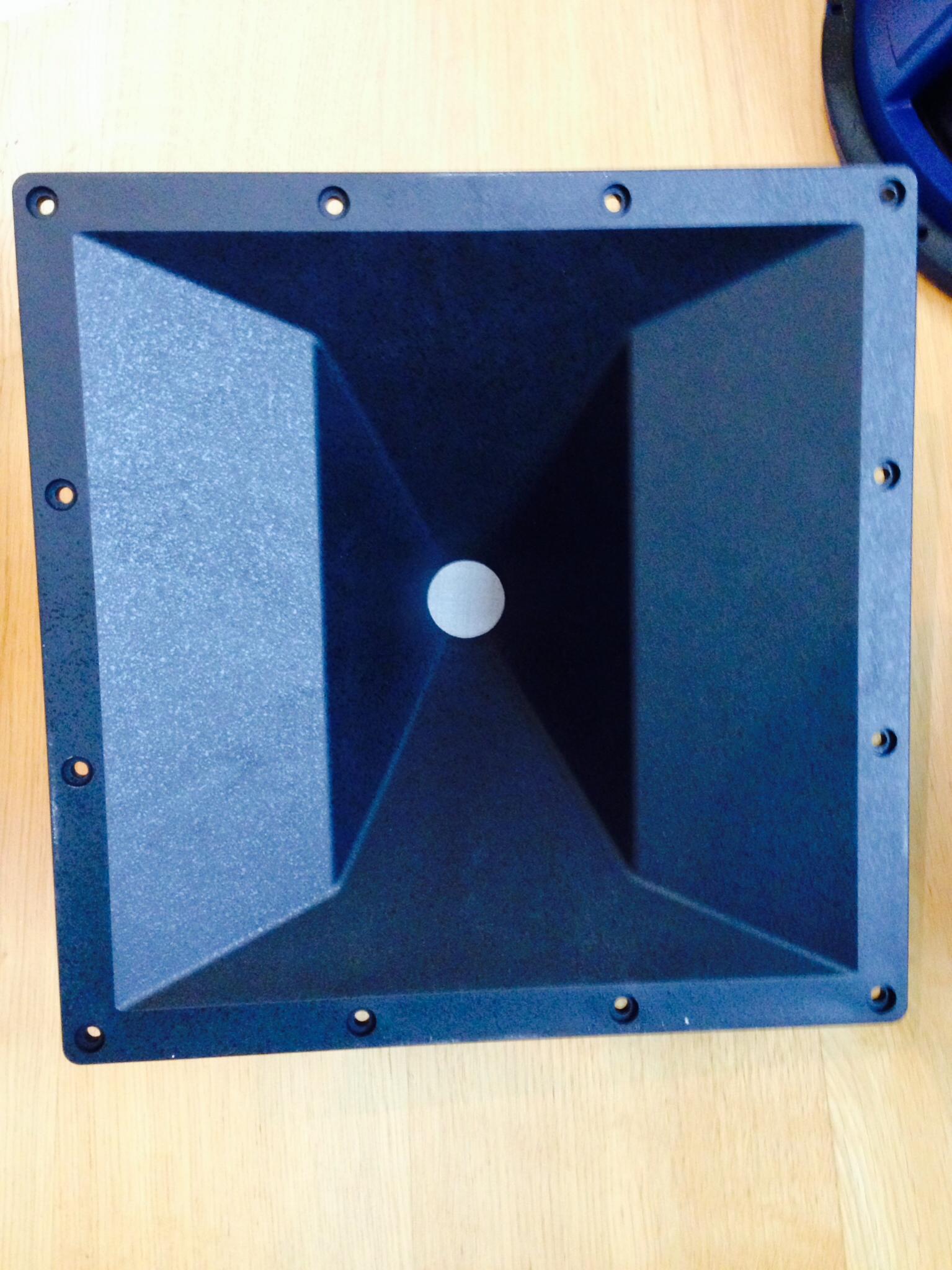

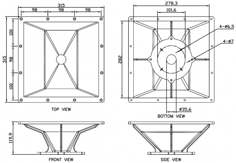

The horn is sold under the Monacor label (MRH-300), but it's actually a P.Audio PH-94.
It's not supposed to sound like horn, which isn't surprising given its depth of only 12cm.

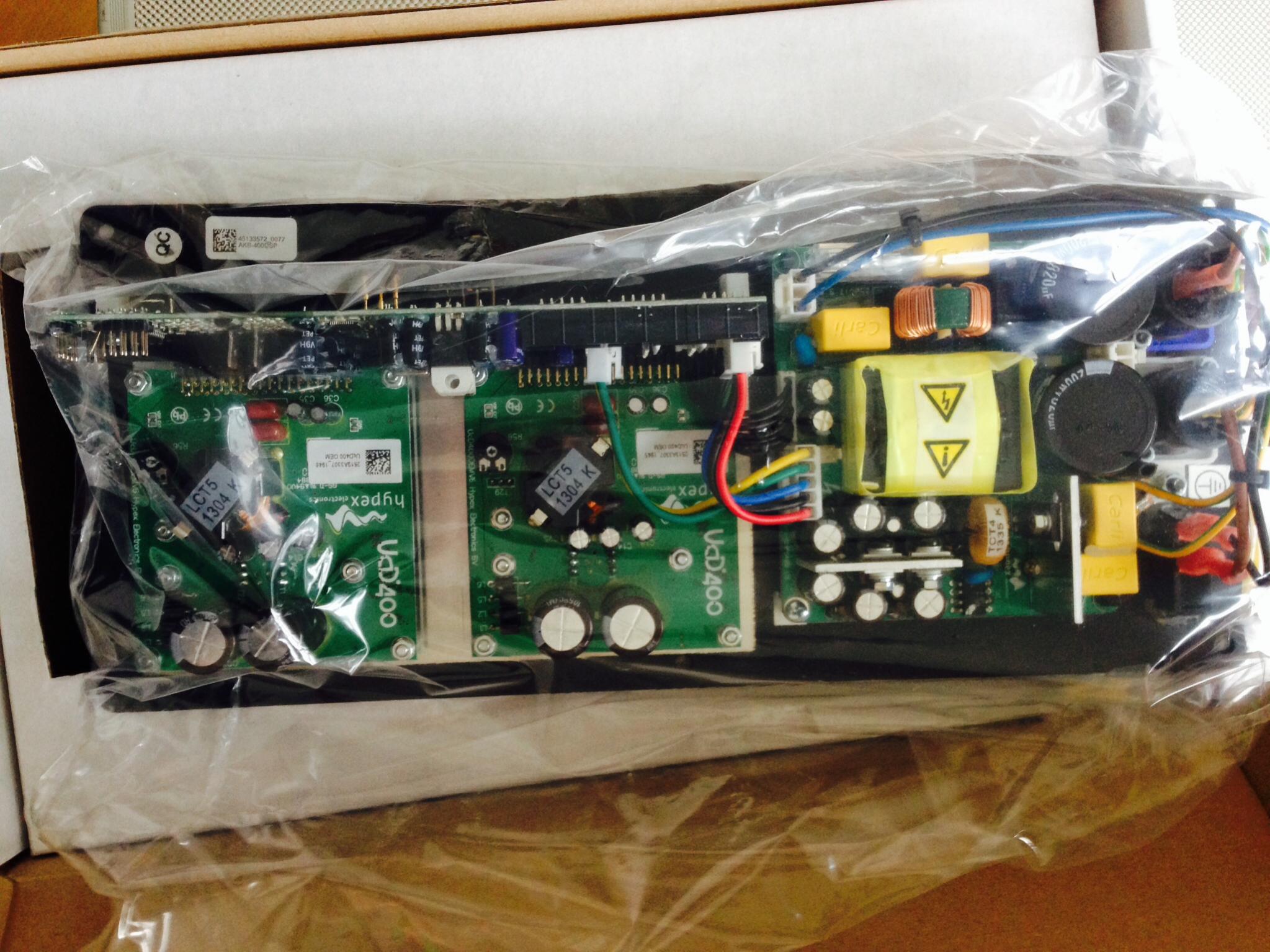

A Monacor AKB-400 active DSP-module is mounted on the rear, which includes Hypex UCD-400s.

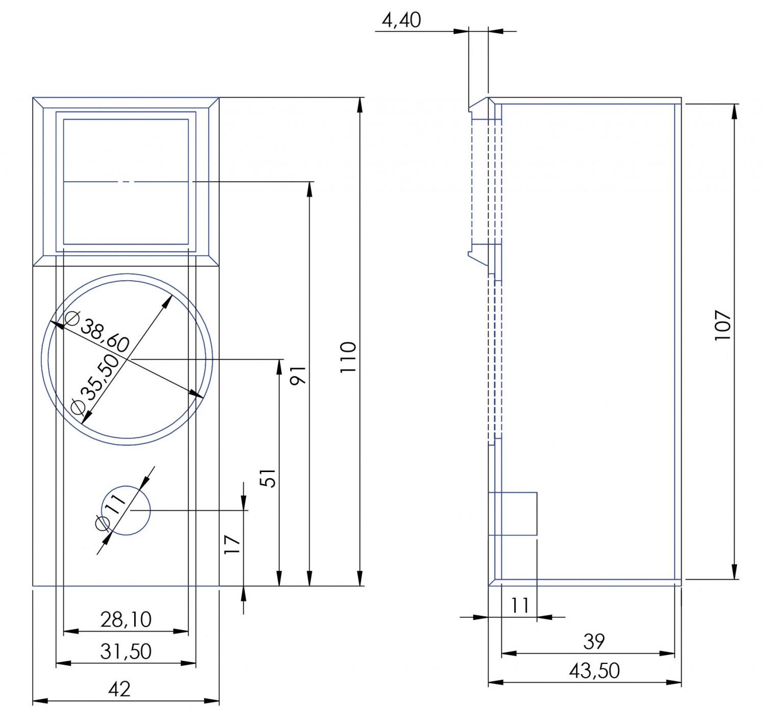

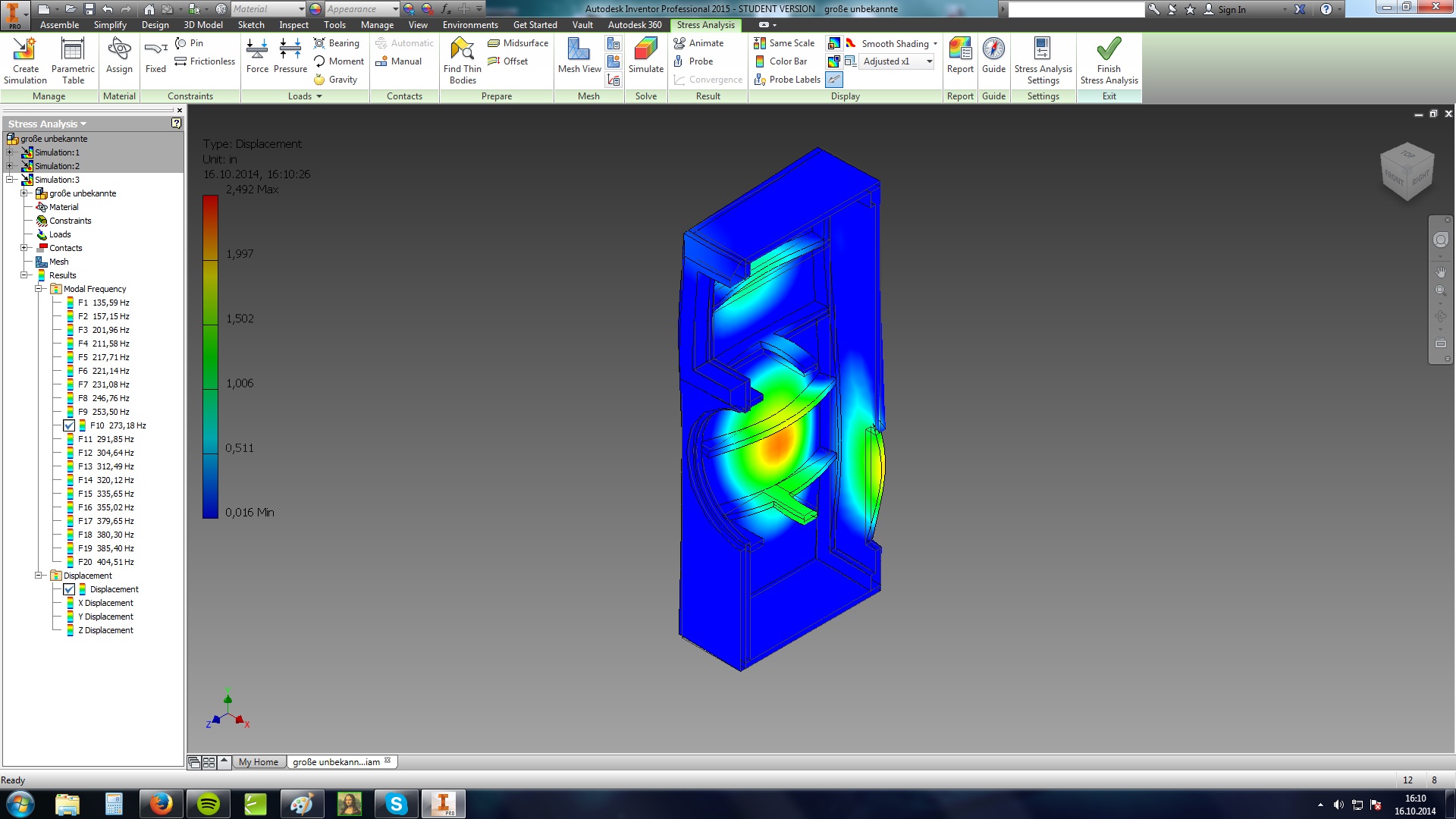

For those interested, this is the build thread > German, so use google translate. The project seems well thought-out,
with some sims of the cabinet, ports etc. in Inventor.
Clean look. From this thread so far, it's made me rethink the capability of 2-way horn designs. I've always thought horns need minimum 3-ways to be give true hifi quality reproduction. I guess not!

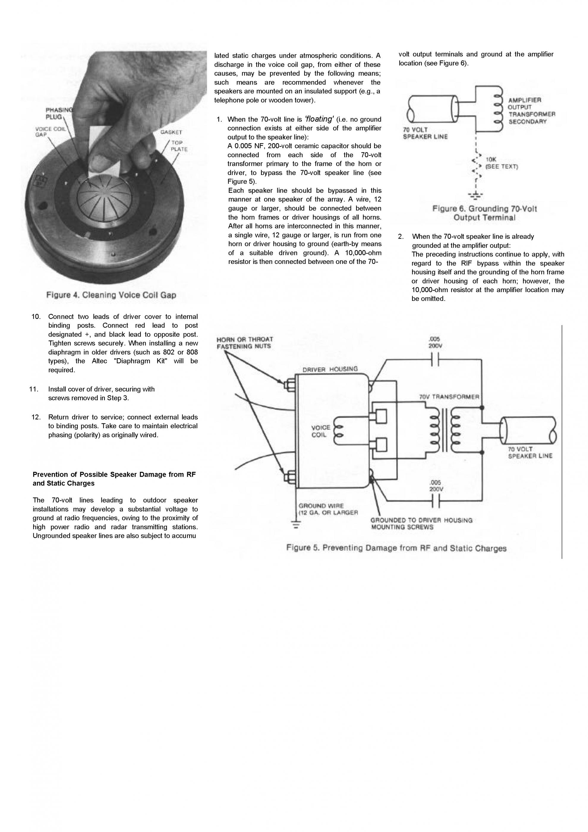

Picked up pair of Altec 511 horns + Altec 808-8b 1" drivers locally last night. Drivers in mint condition. Owner had previously paired them with big ported box with a single Altec 515 15" woofer. Has now moved to the Altec 805 multicell horn with Altec 288 1.4" drivers. All reports on the Altec multicell horns are that they have least 'horny-ness' effect compared to other designs. Does this still hold true?

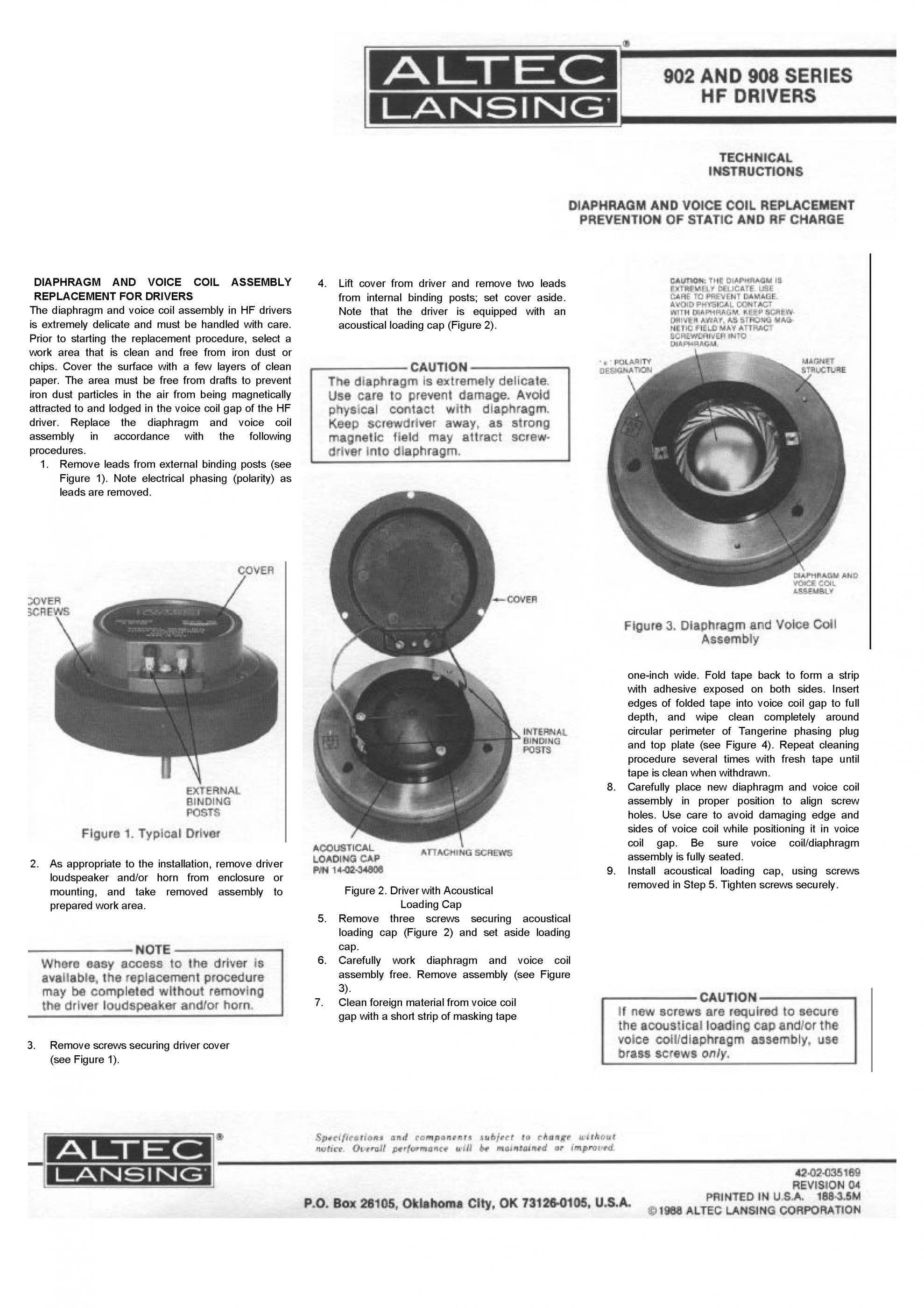

If the 808 still has a Symbiotik diaphragm, need to replace with GPA 34647 alum. if still available and/or convert to the 26420 for higher power apps. Both need a terminal conversion kit.

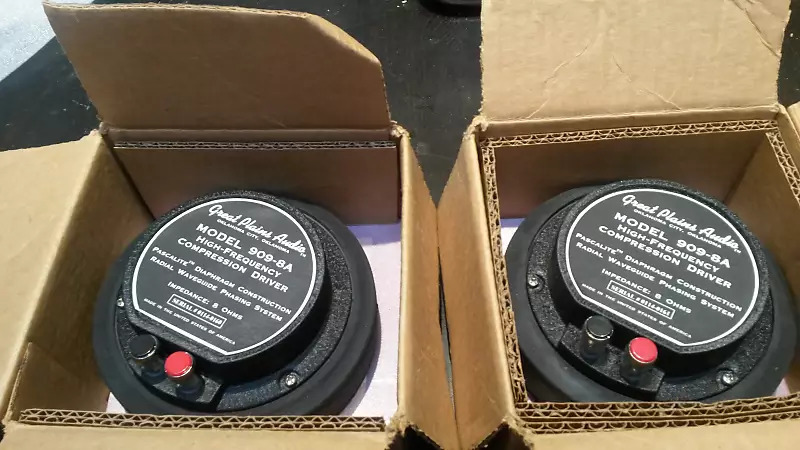

Were original Altec 1" drivers sold with wrinkle coated cap, copper coloured magnet structure and terminals like the GPAs below ?
The ones I recall were a mild Hammertone finish, though heavily sprayed and especially if dipped, can look somewhat 'wrinkled' or maybe 'mottled' is a better description. The Wrinkle finish I've used looks like on valve covers, so maybe GPA decided to personalize it a bit, or more likely, save a little money using spray bombs as every Hammertone spray bomb I've tried didn't flow out nicely like when through a spray system.
No, magnets were the basic ferrite charcoal gray.
Different terminations occurred in '83 according to GPA, presumably a cost cutting change, but frankly didn't notice till buying some 909s many years later on closeout at the distributor along with their last pair of 802 ultralites since they were fed up and B0$3 made an offer they couldn't refuse.
