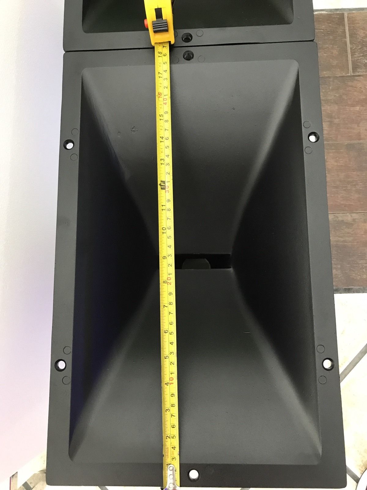

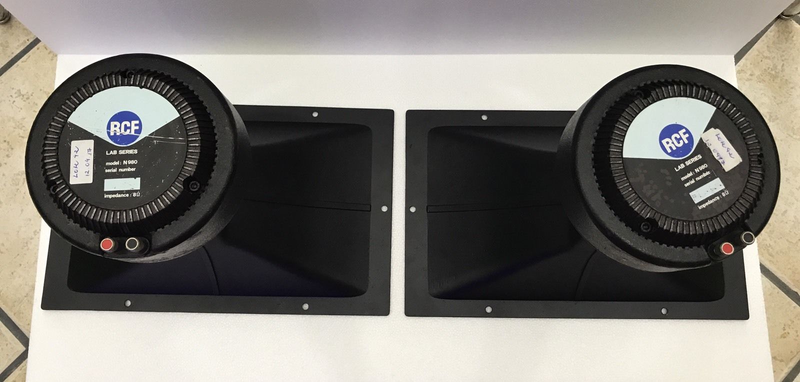

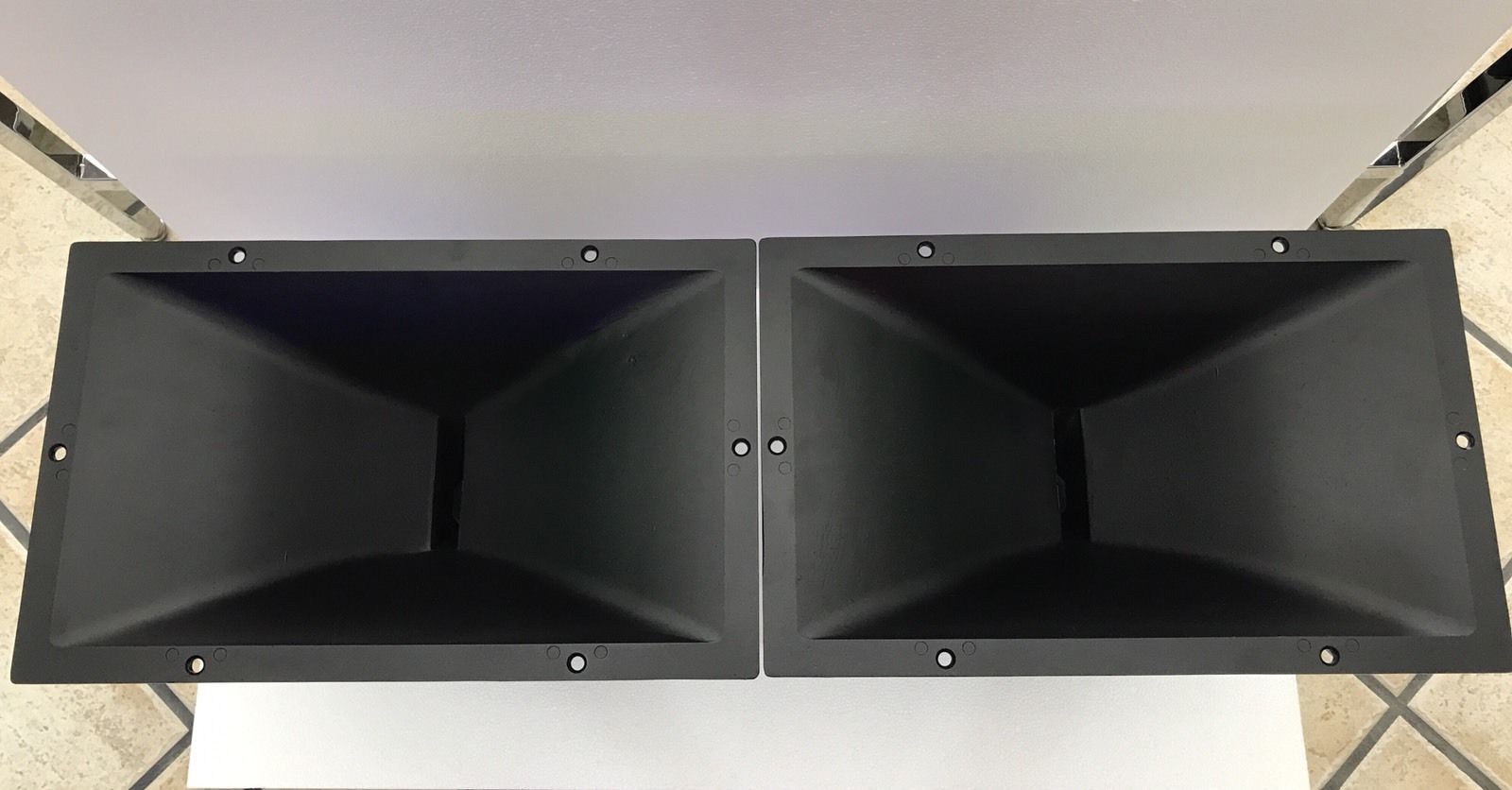

What I don't get is the small horn used in RCF ART745 MKIV?
All horns in RCF 2-way (plastic) cabs are based on their compact hf series of horns. These are small in order to meet industry standards.
Their current biggest horn, the HF950, has a small mouth circumference like the others, but is reasonably deep.
RCF phased out all bigger horns some time ago.
This was their lastest:
