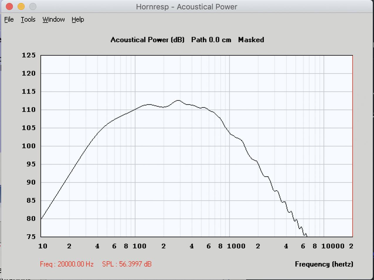

Another question I have is regarding using a front loaded horn like in the La Scala. Would it be feasible to have that run up-to 650 to 700 Hz? I've done some Hornresp simulations (using 15PR400), and with a bit of tuning and tweaking you can get the response smooth up-to that range. The question is how it would sound?

Sometimes better, sometimes worse.Did anyone ever try extending existing horns? The horns that don't have roundovers and smooth transition to the baffle could quite easily be extended with wood panels.
4real: Here is my FH-1 clone (very similar fold to LaScala) with 600 Hz crossover. I cannot say a bad word about the sound. Actually, it improved slightly when I turned it 90 degrees, so that the split was placed horizontally. I cannot find the raw measurement without crossover, but there was definitely enough output up to 700 Hz.
Now I use a straight front horn for this band and I must say it is again slightly better.

Sure, just change the throat area, initial horn flare as required. As long as you don't exceed a 2:1 CR, it's normally near enough to a full size throat.
