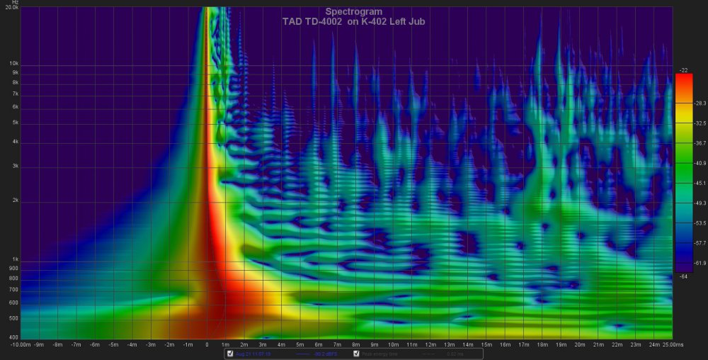

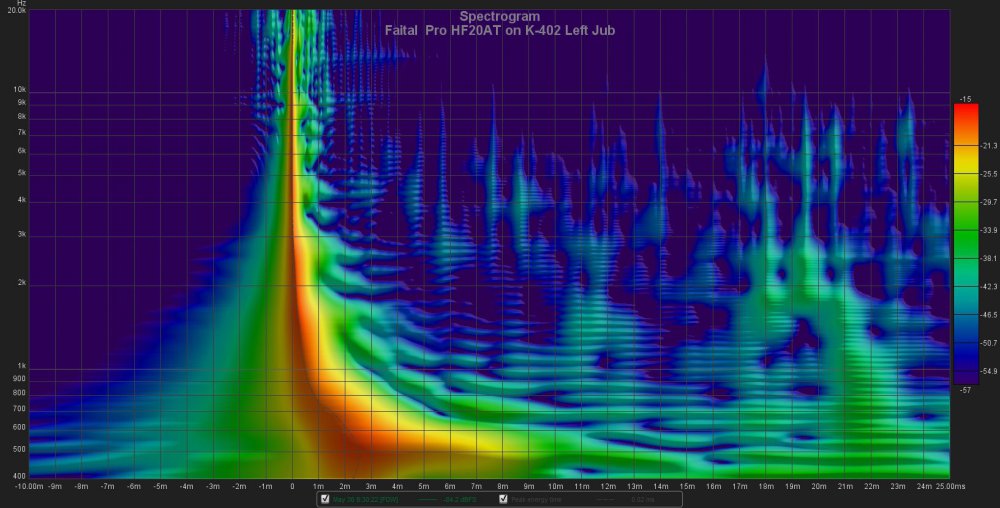

Posted elsewhere by cask05, but relevant to this thread I guess.
Spectrograms of the Faital Pro HF20AT and the TAD TD-4002 on a K-402 horn.
Not bad, considering the TAD is 10x the price of the Faital.
Not likely to see a difference on the spectrogram.considering the TAD is 10x the price of the Faital.

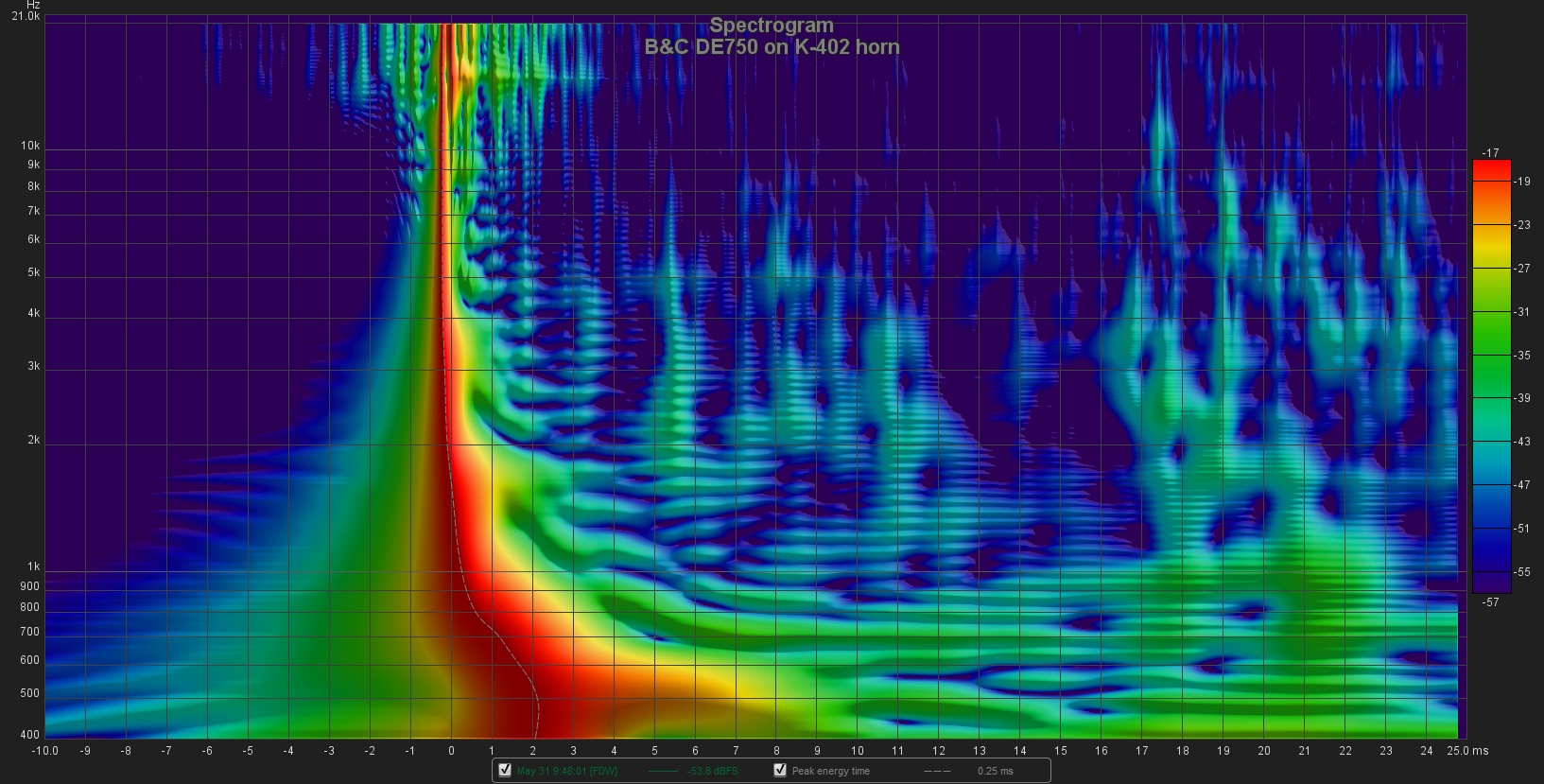

eek, I thought the k402 would be less reflective..................
Its mouth radius either needs to be much larger or damped enough to mimic it. A rounded over wooden perimeter horn extension would be a nice cosmetic double duty tweak, though of course the trade-off is a wider crossover gap, so for me it's always a foam mouth termination or fiberglass insulation if a grill is used.
Folks tend to forget these type horns are for being within 3/4" of a perforated screen [assuming it hasn't changed over the decades], so the whole area is coupling to it to a greater or lesser extent, making this ~moot.
From just looking at photos though, mounting the horn to a frame and wrapping foam around it starting at the horn's flange form line to create a diffuse 'bumper' seems a worthwhile tweak once the right density is found.
The easy choice would be water pipe insulation, but it's closed cell foam, so to some extent reflective, but not having tried it might be worth gambling a few bucks to find out.

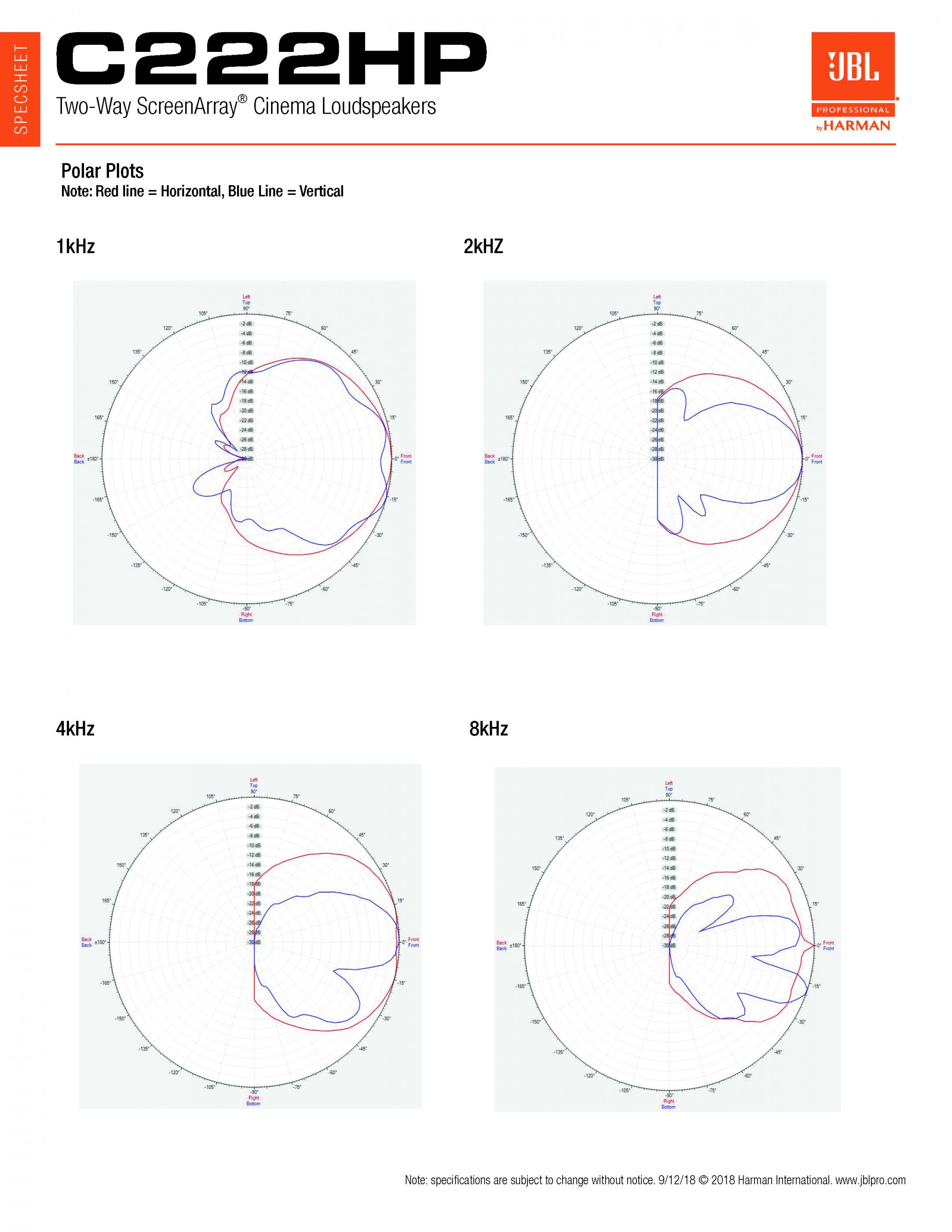

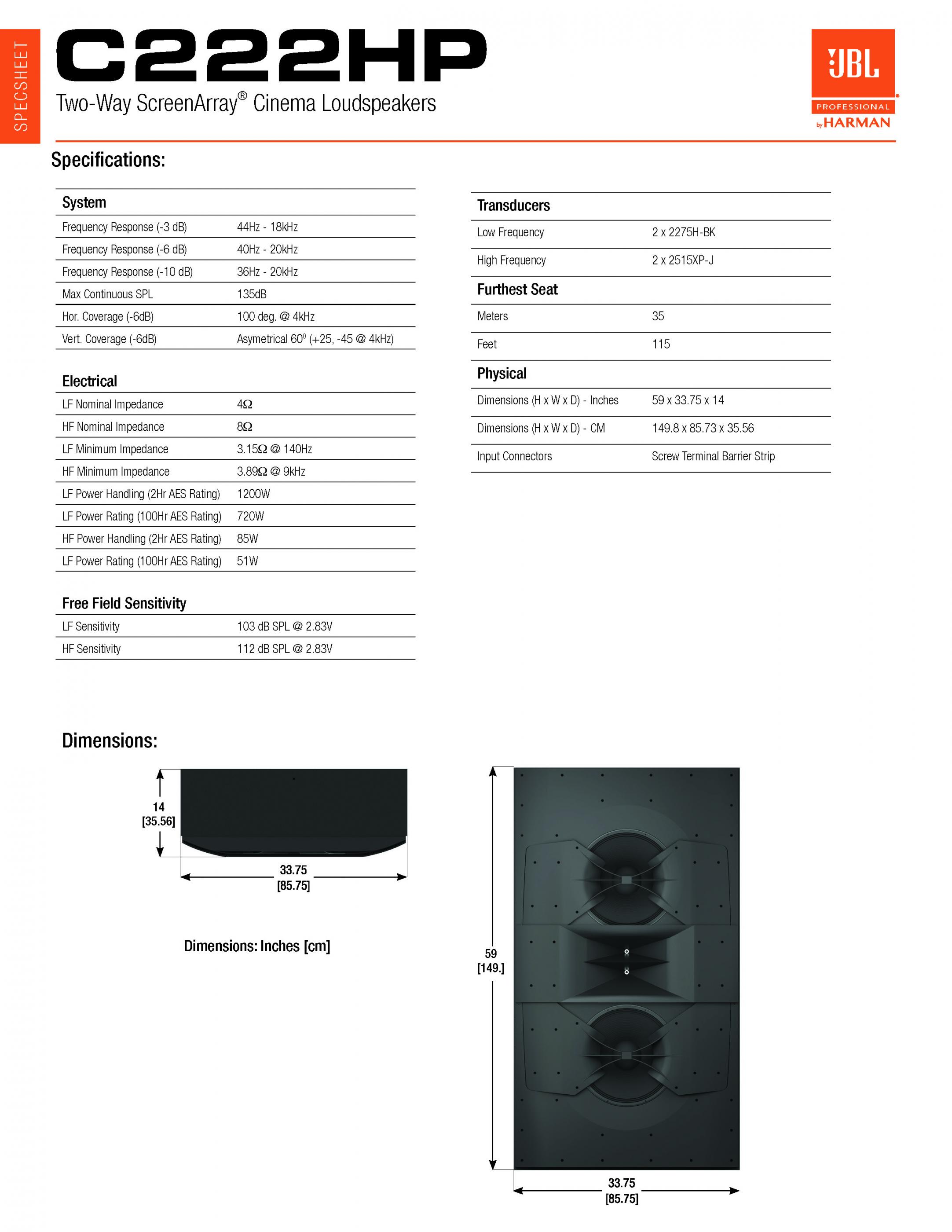

Same series, top-of-the-line model (it's also a 2-way).
SPECIFICATIONS
Frequency Response (-3 dB): 44Hz - 18kHz
Frequency Response (-6 dB): 40Hz - 20kHz
Frequency Response (-10 dB): 36Hz - 20kHz
Max Continuous SPL: 135 dB
Horizontal Coverage (-6 dB): 100° @ 4kHz
Vertical Coverage (-6 dB): Asymetrical 600 (+25, -45 @ 4kHz)
SPECIFICATIONS
At less than 50% of the price of a pair M2s these seem to offer quite a lot of value.
