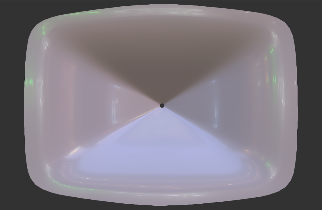

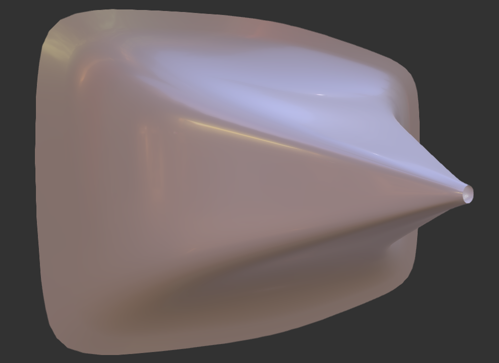

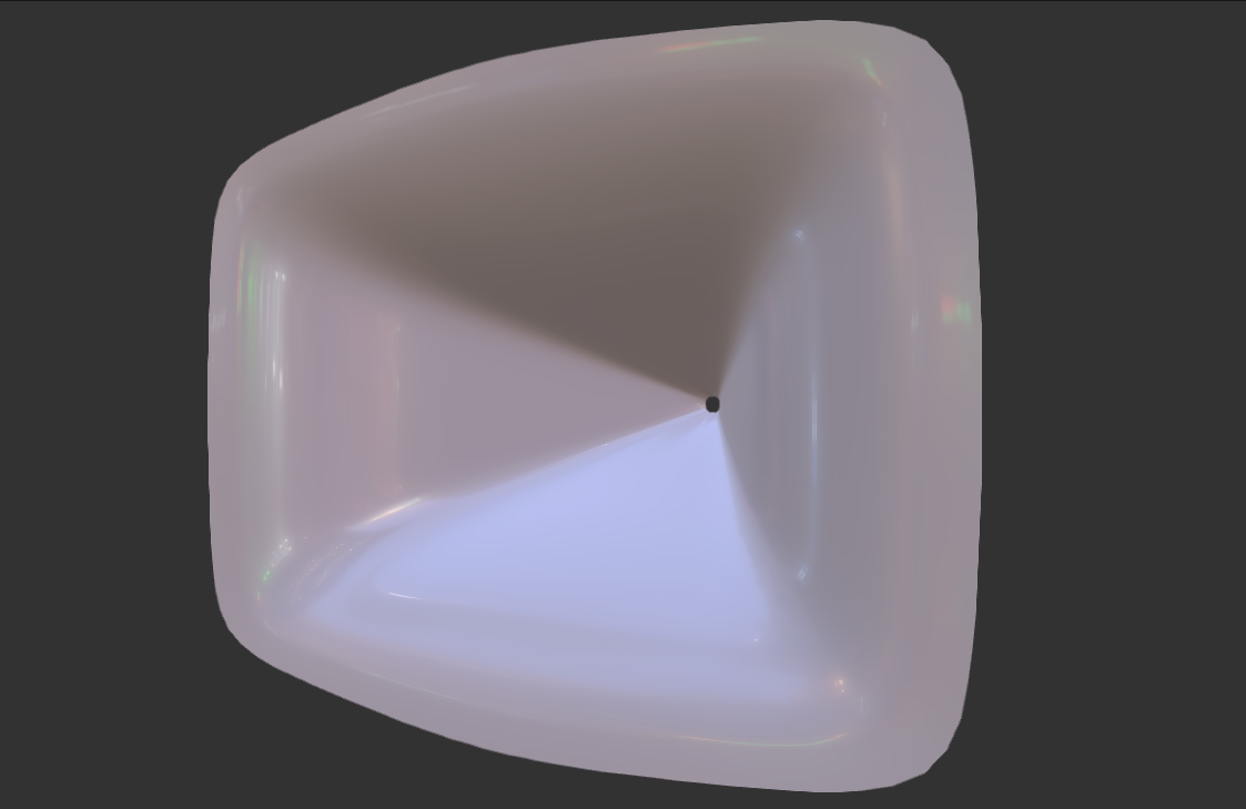

Just for fun, the biggest OSWG ever...
Horizontal coverage angle: 70°
Vertical coverage angle: 50°
Width: 2002.66 mm
Height: 1471.66 mm
Depth: 1000 mm

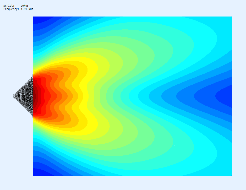

This also applies to OSWGs, as illustrated by Marcel Batik in the sims below of a 52cm (diameter) OSWG.
Now that he has released his tool to the public, I guess it's permitted to show some sample waveguides.

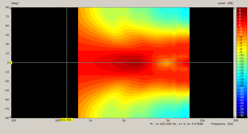

If that polar map is of an OSWG it's probably not accurate as I see no axial aberrations from the mouth that always occur in a circular device.

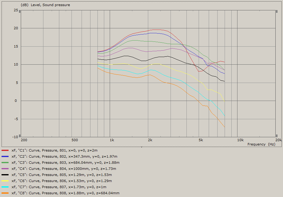

These aberrations?
I'll leave it at that, because I won't take credit for Marcel's (huge amount of) work.
The point of these ABEC sims was to illustrate that 'bigger is better'.

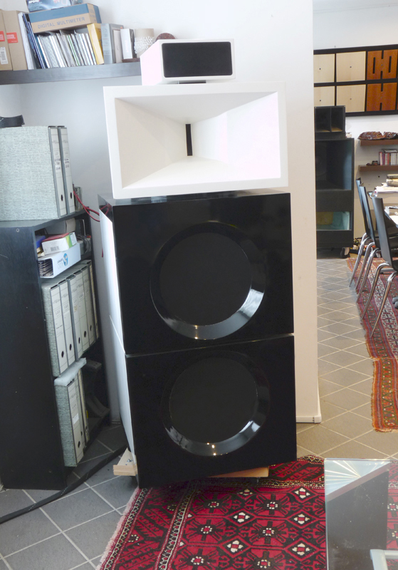

Hello Gedlee
Thank you for joining the conversation, it is an honor! As you can see this topic has gone viral. Predictable I think, since the 2-way is the "coaxial" we never had. Make that make sense....anyway...
Do you have any ideas to help me produce a better final product?
I'm aiming to put the area between the top woofer and horn at ear level. The horn can be angled. Me sitting with feet flat, makes the enclosure about 47" tall
That would put the center of the bottom woofer at ~23.5"
With a xover of 630hz, I wonder what is the most dramatic listening angle I should allow from the 15"s
I forget what KA I'd be at. Though I intend to use room correction at the sweet spot, the polar shape ultimately will affect the rooms energy, Changing the eq for my listening position affects everything else and being that I can't seem to get in the middle of that polar (close listening distance).....wait....thats it!.....I need to be able to angle the woofers as well........back to the drawing board!
Thanks so much Gedlee!
greetings from Wyoming Mi!
Sometimes you have to improvise.....My chair is adjustable, I can always lower my chair, thus lowering the intended sweet spot. 47" inches tall has its merits.
