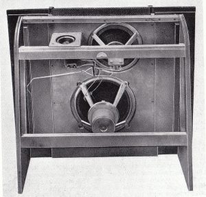

I think that the idea is to make sure that the resonances are pushed up with adequate bracing. Regardless of what materials you use. You can always double the face (baffle), and other surfaces until satisfaction is achieved..

Acoustic instruments produce music while loudspeakers reproduce music. The former must resonate to amplify and the later should not resonate, it should be inert. The former have have low damping factor and the later should have high damping factor.

We only use MDF for things like spacers (disimilar material) or bases & such. Quality plywood has significant advantages. But actual box design and execution play significant roles too.
I have seen (& have) some very nice solid wood speakers. Not for the builder faint of heart. Stranded/fossilized bamboo plywood is the best sheet material we have used.
Next up would be constrained layer boxes.

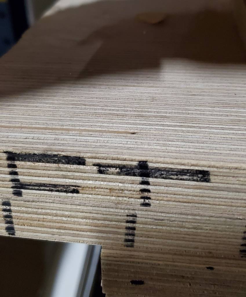

I came across this while looking density specs. Looks interesting
I really like bamboo thought.

I have access to Baltic Birch and many exotic hardwoods locally, so I never use MDF anymore. Plus, I hate MDF dust.
13 ply BB is 18mm. It is avaialble in a range of construction quality. We used lots & lots of it (and 15, 12mm) but switched over when we found the quality of the BB we were getting was getting poorer*, we switched to the Murphy Ply birch plywood which was of a higher quality. A quality Baltic core which they skin with maple veneeres (sp ominal 18mm gets 15 plies).
*(BB can come from Finland, the Baltic States, Russia & China (list in our experience shows a general decrease in quality).
The BB we were getting did not cost a whole lot more than decent MDF.

planet10 - Agree with you on the BB quality declining, my favorite (although it has gotten expensive), is State's Appleply. (both States Ind. and Murphy are in my home town)
Another interesting material is PaperStone - in black would look nice as a baffle.
Good materials are easier to work with than the cheaper stuff - flatter, consistent thickness, etc.
