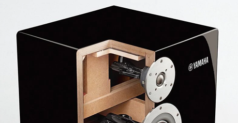

MDF is good sound wise
Plywood is almost the same.
I know somebody who made the two version of the same cabinet : they sounded the same.
The advantage of plywood, is the mecanical resistance , way better than the one of the MDF
The advantage of MDF, is for the perfection of finitions : perfect for chanfering , and ready to be painted.
Making a sandwich of Plywood and MDF is a fine solution, but nothing replace a good bracing.

Well honestly I think it is more important to make speakers than endless debate bout what is the best material to make cabinets with. However one of the deadest subwoofer boxes I ever made was using a couple of scrap shipping boxes made from thin 12mm chipboard that I glued scrap MDF panels to on the inside and whacked in some stiffening at random.
Glue; lots and lots of yellow PVA glue.

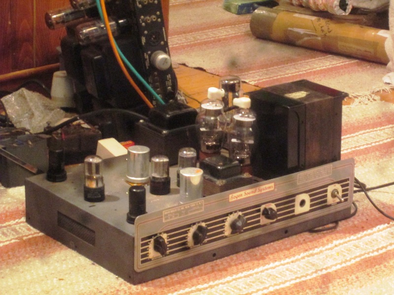

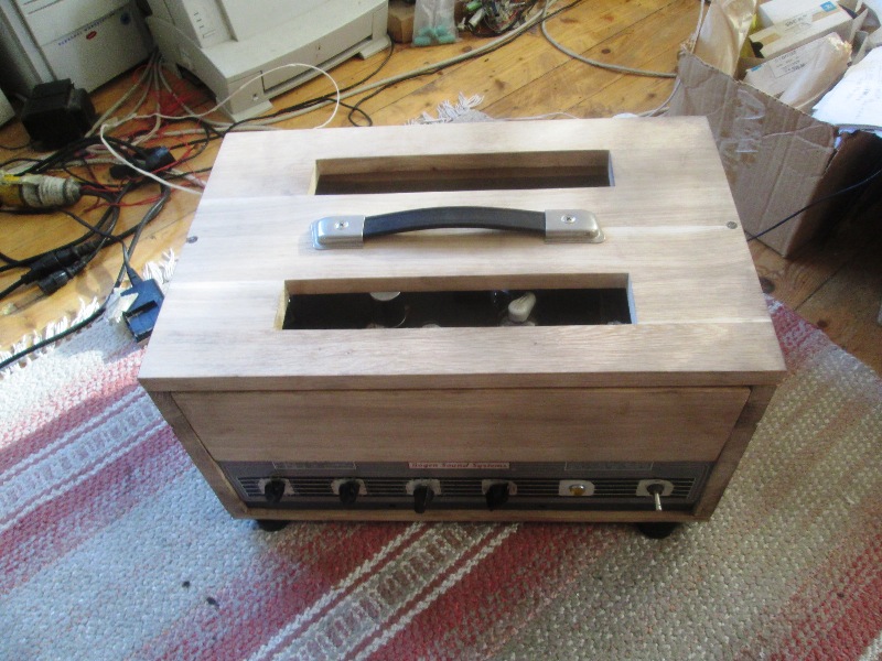

I made a vintage amp an oak case.
Looks beautiful now, again the same workshop did the donkey work for me.
(ex-soviet union countries,- brilliant working in local materials)

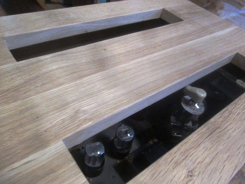

No way would that have been done in pine or chip, - way too weak.
In this case it has to resist heat, and of course keep fingers away from those 600V top caps. (make them impossible to access in use), at the same time as funnelling all that heat out of there...
Also made to measure came out 1/4 the price of any commercially made stuff off the www.

That's a really solid amplifier case you have pictured. Your use of OAK is way better than OK!
Yes, I am thinking of doing that again to house the monster heavy MO200 (2 x 100W) amp.
(I have a pair).
Believe it or not it cost me just 40E including the wood and cuts.
