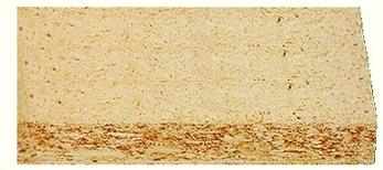

Don't forget chipboard.
My enclosures are made of chipboard, but it is important to choose the correct grade.
Chipboard is available in a number of densities; normal, medium and high-density. Normal density is fairly soft and 'flaky', high-density is very solid and hard (often used for worktops and fire doors) - medium density is somewhere in between.
The random orientation and size of the wood chips results in superior vibration absorption properties to those of MDF with it more homogenous structure.

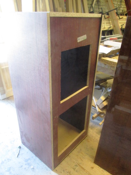

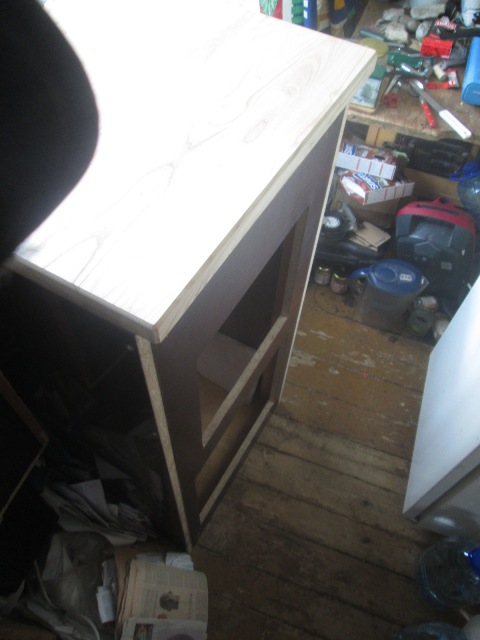

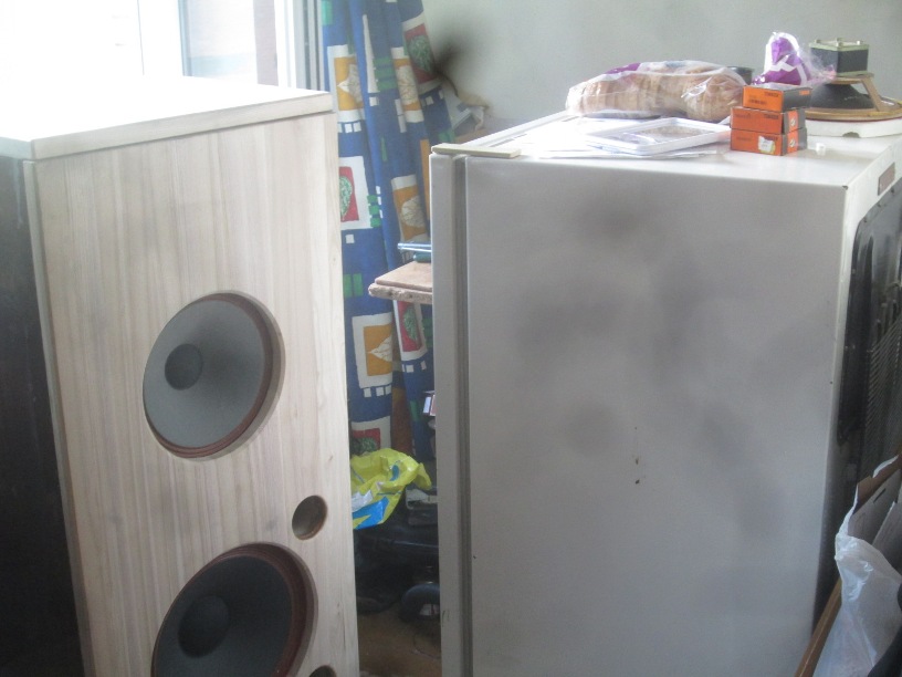

When I came to make my cabs I chose to use a support mask in MDF or chipboard whatever it was, from a salvaged soviet cupboard I cut up.
The support mask construction has some big advantages in sound projection, placing the driver out of the direct box area.
I am a great believer in making the front which mounts the drivers absolutely rigid and chamfering the outer edges, so we made that and the top a good 1" thick.
The whole thing must weigh a good 80kg+ as I can't lift it,- no way.
See it's bigger than my huge old freezer
The MDF or whatever they used, was covered in a typical delicious heavy varnished verneer, looking like real wood.

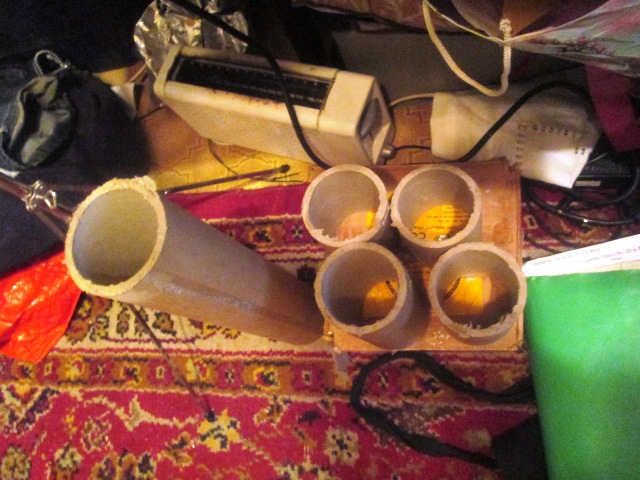

The front and top we made from ASH, it's 1.2m high with 2 HUGE drivers on it, and the ports which were salvaged cardboard tubes I got out of a big plotter from a local printer.
This should give you some ideas, common sense mostly and a brilliant local Baltic workshop.
They did all I asked and bought the right special hole cutter and chamfered the driver holes, just like they should be.

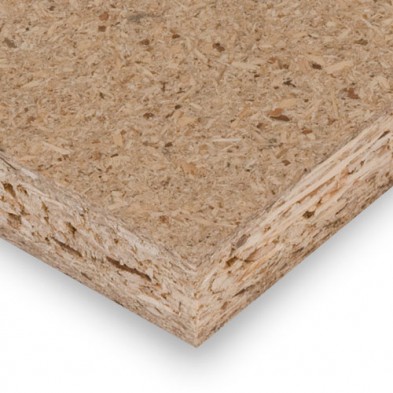

I am in agreement with Galu on the chipboard being a remarkably good choice of a material and my personal preference as well. A quote from Stereophile review of Wharfedale Linton Heritage, page 1st.
Comeau has a clear preference in cabinet materials. "Personally, I'm a fan of high-density chipboard for cabinets and pioneered, for Wharfedale, the sandwich of chipboard with MDF skins that we now use. I have a raft of technical research which shows the superiority of chipboard over MDF."

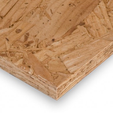

Chipboard = OSB (oriented strand board), not foil covered particle board (everything I've seen from Ikea). I rescued a bunch of 19mm OSB from a shipping crate at work and made an extremely dead MLTL (inherent bracing) subwoofer. Was pretty surprised about it, honestly. Could see skinning it with 1/8" MDF skins to get a good veneer/paint surface (probably want a vacuum press though), but mine was a rough and tumble box. It's also fortuitously cheaper than both plywood and MDF, so definitely something worth using for prototypes!
