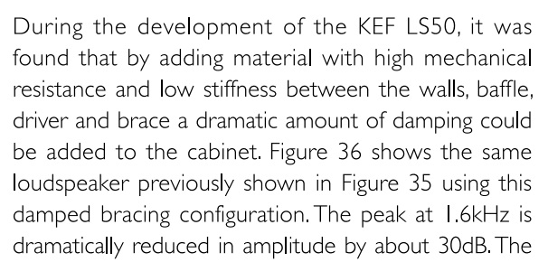

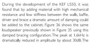

I came across a KEF document where they also mentioned the benefits of a "lossy" bracing scheme - excerpts attached.
KEF was also the company that grommet mounted the midrange in the 105 to isolate it from the box. Measured good, but didn’t sound as good as removing the grommets and properly tightening the bolts. I am always suspicios of suff that KEF “measures” into existance.
dave
