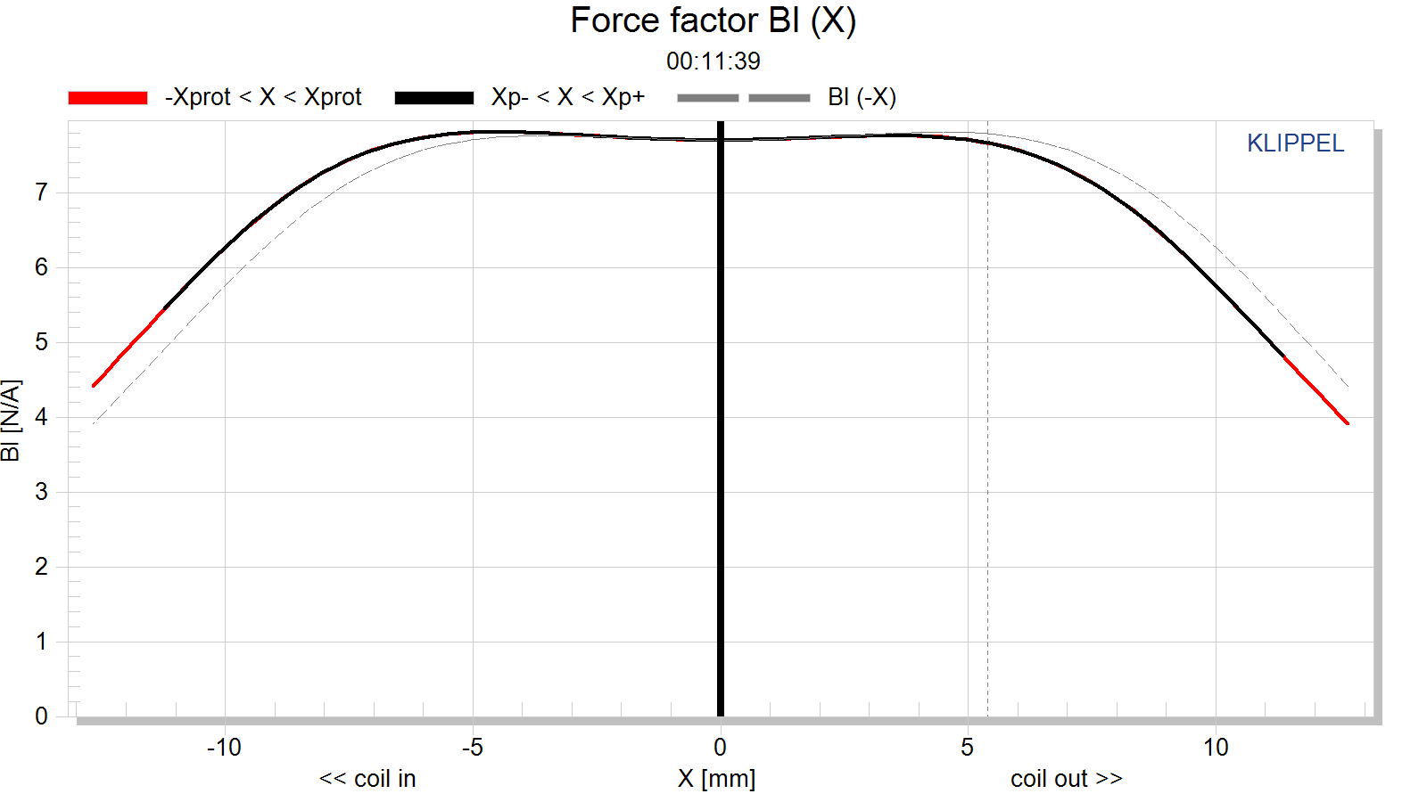

To avoid any misunderstanding: I a looking for a BL vs X graph, not for X-max as absolute value. The latter is usually known, but the BL vs X curve is much more revealing about the real quality of the motor assembly and the real X(max)lin.
By looking at the Klippel measurements in e.g. Erins Corner, it can be observed the real X-lin is far smaller than the classic VC length-minus PP thickness/2 with most woofers; the Purify woofers being one exception.

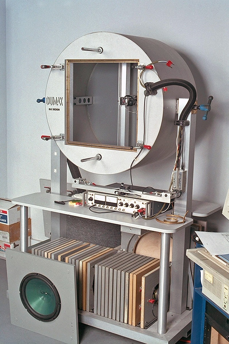

Boden,Is there a DIY technique to measure the BL curve of a woofer?
One could (in theory) DIY duplicate the DUMAX (Drive Unit Measurements At eXcursion) system, which was created around 1995 by David L. Clark (R.I.P.).
Not an easy DIY, obviously- there are a lot of mechanical details in the servo-controlled variable pressure system. The chamber can rotate 360 degrees, mass rings can be added to the cones, different baffles for different size drivers are stored below.
Then there are the laser measurement system, current source driving different functions of applied voltage, etc. etc.
This video explains how it works in detail:
One comment went something like: "air pressure wins over magnetic force "
All good stuff, gets into operation at around 55 minutes in, block diagram at around 1:27.

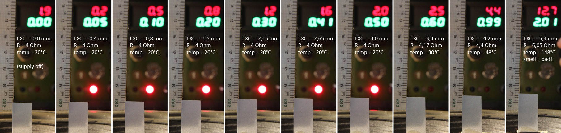

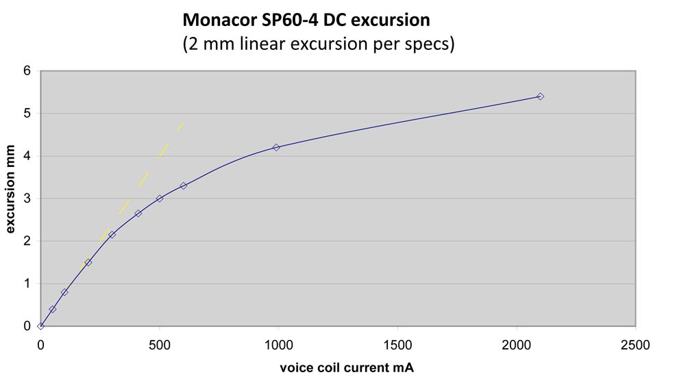

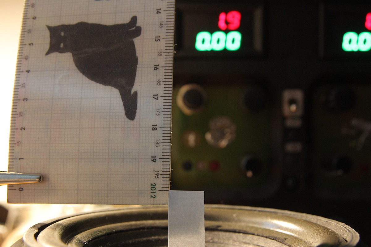

I tried this just for fun, with a small monacor mid-woofer, SP-60-4.The DC method suggested by stv on post #5 looks promising to me.
I taped a small paper strip to the dustcap and aligned it with a ruler:
then applied DC current from the lab supply.
Xmax as defined in spec sheet: 2 mm
this corresponds quite well to the measurement:
see results - keep in mind, this was no exact measurement, just a feasibility study!
DC resistance is calculated via voltage/amps and temperature of voice coil is calculated via increase in DC resistance (copper +0,4%/°C).
smell was not measured but easily noticeable!

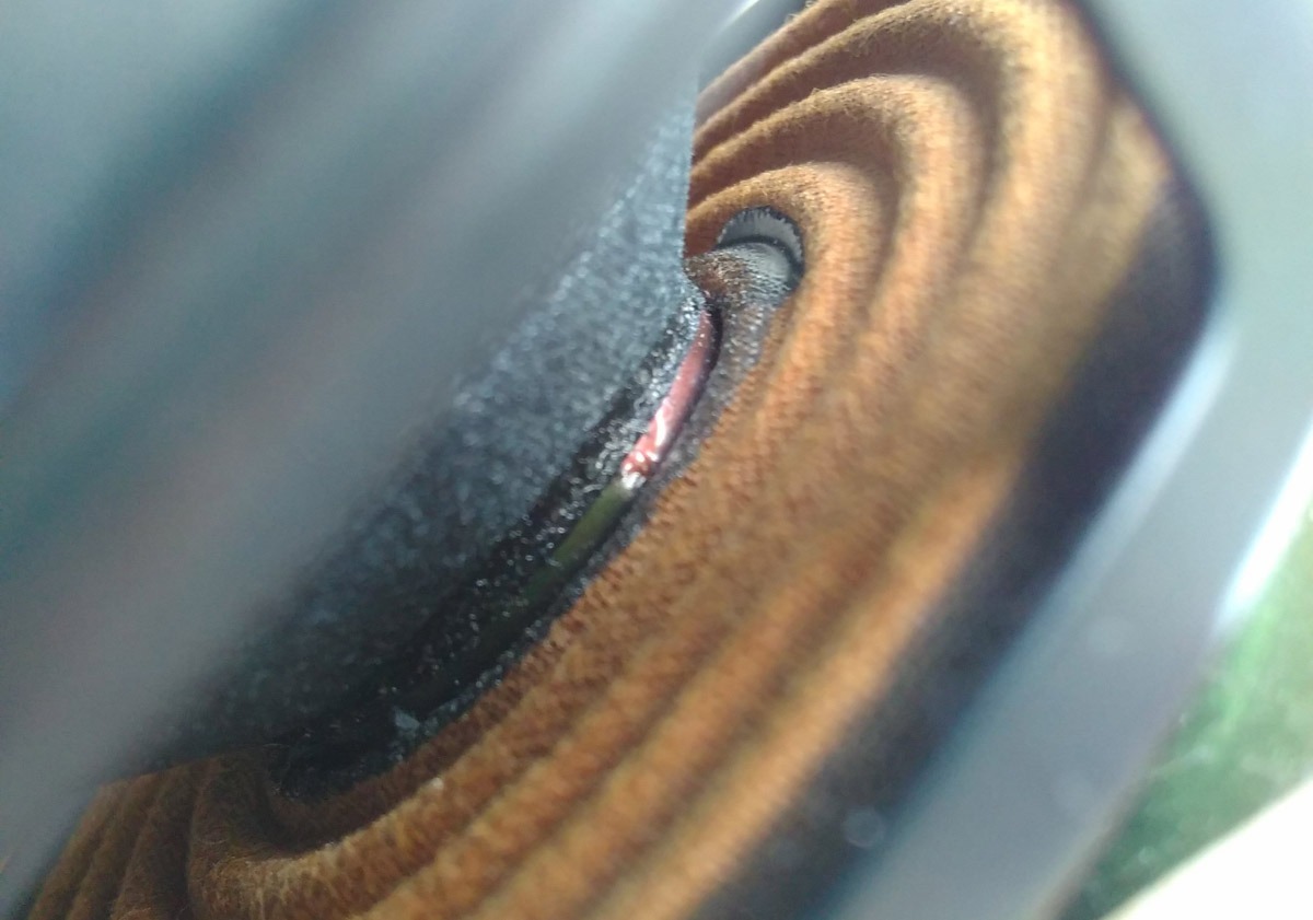

Voice coil overheating big time because this is DC, no back forth movement to cool it. also a great part of the coil is outside the gap, so no metal nearby makes it even worse.
Notice you took your voice coil to the limit applying "only" 12.7*2.01=meager 25.5W RMS
of course DC RMS, which is DEADLY.
I always laugh at "500W-1000W" speakers ... physically impossible.
Your temperature measurement was very accurate, the real thing, and you got very close to failure , which would have been 170-180 C
Not surprised at the smell, at all.
