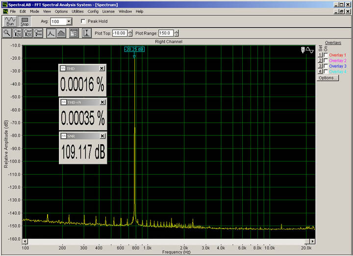

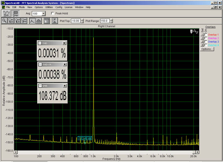

I've been playing around with software sources, and it is very interesting. I'm using an older version of FFT software that does not have a 24 bit source built in, but does allow for 24 bit FFT's. And using it with an M-Audio Audiphile 192 sound card.
I found a few free programs that work good. The first was Dr. Jordan 24 bit freeware test version here
http://www.dr-jordan-design.de/Downloads.htm
I noticed it puts out only 777.1 Hz. The mystery starts. The version of this one must purchase to get 24 bit support is $79. - kinda high if you only need a nice pure sine generator.
It worked very well when set to an output level -13dB, so became the benchmark. With some finagling, it produced much better results for the M-Audio card than shown previously.
I ended up using a block size of 131,072, with 100 averages. In this and most cases, using "triggered" measurements gave better results, but the trigger level needed to be set pretty low (2-3% of input). I also found some low level 60 Hz noise initially, as I was using an 8 foot non-shielded twisted pair cable initially for analog loopback. By replacing the cable with a 12 inch BNC and adapters, the 60Hz noise went away.
Next I found this one,
http://www.tropicalcoder.com/ASIOTestSigGen.htm
which works very well, same as Dr. Jordan with one exception - it only runs for 60 sec. max. But it does allow you to program any frequency you like. Not bad for free.
Next I tried the Virtins "free trial" generator, and had a hard time getting it to work, until I turned off the Spectrum analyzer and Scope. It worked the same the above two packages when set up the same way.
http://www.virtins.com/page3.html
I tried 3 or 4 more, and found them lacking, almost all worked in 16 bit mode only, even though some had settings for 24 bit. Try before you buy! Found them here
http://cricket-sound-generator.qarchive.org/
Last I tried this one, the DSSF3 Basic from Yoshimasa Electronic Inc..
This being a complete packe, tt was tricky to get setup for generator only, but when all set to ASIO was fine. It worked OK, but oddly had an average noise floor about 5 dB higher than the other packages. It must be a a math thing, like a software rounding error, and tells you all generators are not created equal.
http://dssf3-basic.yoshimasa-electronic-inc.qarchive.org/
Now, the mystery of the frequency used correlating to THD results. It seems that most packages loop the generator signal, which means you may have the same problem with discontinuities at end of record creating distortion products. So it appears you really want an integral number of cycles to exactly fit in the time record for the generator as well. I can't say for sure why, but using frequencies like 777.1 (48kHz sample rate, 131072 block size) and multiples show lower THD and fewer harmonics than nice even numbers like 1,000 Hz. Graphs of results later.
Bob

Hi Bob- that's really interesting. Given the number of things one has to worry about, and seriously doubting any two people can get the same results, it makes me appreciate my old analog equipment all the more ;-) Speaking of which, those spectral plots would make me think the waveform on a scope should be absolutely pristine. Do you have a scope and have you looked at it?
Conrad Hoffman said:... those spectral plots would make me think the waveform on a scope should be absolutely pristine. Do you have a scope and have you looked at it?
Yes, there is about 20mV pk-pk of HF noise on the waveform with a 500MHz scope. I see similar stuff on my ono-sokki FFT when I turn off the anti-aliasing filters - the noise floor goes up. I think is typical for any digital based measurement.
Any digital source like a DAC or CD player likely puts out as much or more...especially the people that use zero oversampling DACS that shun output filters (way more).
You probably want to excite any tendency to oscillate while testing, rather than get surprised later. But yes, digital stuff has low level RF, and likely you could get rid of it, with a nice passive output filter. I guess the real test would be to hook it up to typical audio products and see how much really comes through.
Bob
