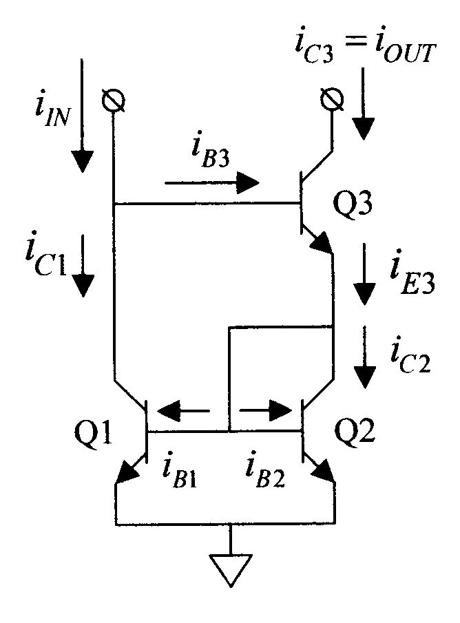

Speaking of current mirrors, devices, etc.:
Since a mirror attempts to duplicate the current you'd ideally like to use the same transistors, match them, and put them on the same heatsink. (The resistors should be matched too.)
Conversely, with a feedback current source, it's not important that the transistors be matched, or even be the same transistor.
Do I have that right?
Thanks,
Jeff.
Thanks,
Jeff.
The two transistors in a standard current mirror operate at vastly different Vce's**, so they dissipate vastly different amounts of power. Putting them on the same heatsink ensures their Tc's are about the same, but ThetaJC guarantees that their Tj's will be different.
The Wilson mirror, and other cascoded mirrors, brings the Vce's down to the same level. Now the power dissipated in the two devices is roughly equal.
Heavy emitter degeneration makes the 2T standard current mirror less sensitive to deltaVbe (caused by deltaTj). Remember deltaVbe =approx= -2.2 mV per degree C. If deltaTj is X degrees C, why not drop (10 * X * 2.2mV) across the degeneration resistors. Aaaah.
BTW this is cumbersome to simulate in SPICE, whose default assumption is that all circuit elements are at the same junction temperature. You gotta work hard to tell it otherwise. Simulation Program with Integrated Circuit Emphasis, after all....
**especially so in a power amp whose rails are many dozens of volts.

........the best ways to improve accuracy a mirror is to reduce the early effect and reduce dissipation(heat) in the mirror devices. The other issue is peaking of the mirror response but this occurs at such high frequencies it is not much of an issue in our application.
The helper transistor works on the early effect and the cascode on dissipation.
The Buzzbomb currently uses a Widlar mirror which is the most primitive form of mirror, The Wilson mirror as used in the HPA-1 is a big improvement and will work well in the BuzzBomb if you want to reduce complexity.
Jam
Jam
Jam
Then this should be implemented, or it's not truly a JamJar.
The warmer device is running at about 500mW, so its junction is going to be 9ºC above the case temp, giving a deltaVbe of about 20mV.
The current mirror is running at 11mA with 100ohms emitter degeneration, so I already have 50X.
However, in the Wilson current mirror the cascode is implementing feedback, so it doesn't need to match. And it's the only one that's getting hot, so it could go on the heatsink by itself, and the two standard current mirror transistors can even be TO-92s. Right?
