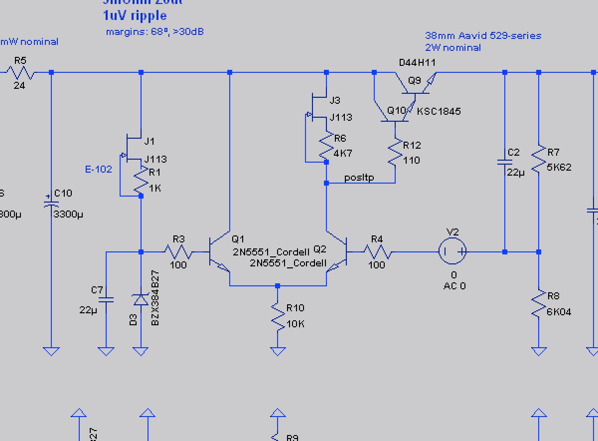

Borbely's all-FET regulator uses a current source instead of a current mirror inside the LTP. I tried it out, and it performs about the same, although it has better margins leaving room to experiment with different transistors.
Mostly just curious to see what people think about it....
A bit of discussion on practical choice on jfets for current sources.... Mostly just curious to see what people think about it...
Ideally you would like to use a high input impedance jfet for a constant current source, so a 2SK246 is prefered over the 2SK170. It is, however, a large pinch-off voltage jfet, so voltage drop is larger...

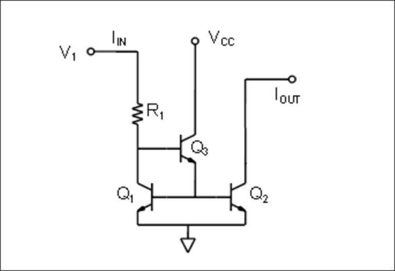

Another way to skin the cat, of course, is to build a cascode out of two BJTs. If you carefully arrange to operate each transistor at VCE = 0.6 * VBE, you can get a truly excellent current source with truly excellent performance at low end-to-end voltage. But it costs another transistor.

Interesting. The JFET/resistor is actually a placeholder for an E-301, which I don't have a SPICE model for.
The E-301 of course has the same problem, although to a much lesser extent. Your J113 chart shows a delta-I of 20% from 1 to 1.5V, whereas the E-301 shows 5% over the same range.
Assuming SPICE has a semi-accurate model of the J113, then it's using the higher figures. I tried a straight SPICE current source, but only got 0.6dB more attenuation. So either it doesn't matter much, or SPICE is somewhat challenged here.
PS: I can't find any indication of what Borbely used there (he just shows a current source symbol), but he does label it D5 (and not Q5), which is probably a pretty good hint.

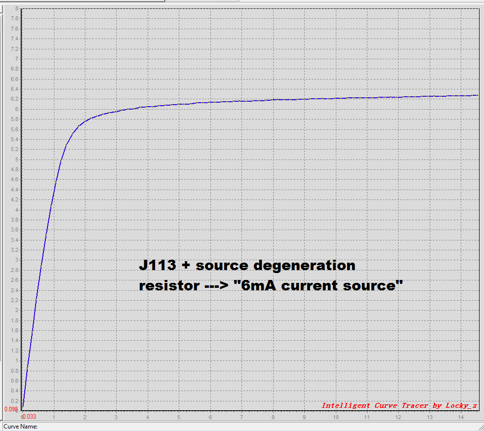

1. Which one of the eight J113s in #730 are you modeling in SPICE?
2. Why not the other seven? They are just as real.
3. If you connect a variable resistor in the source of your simulated J113, and vary it until the output current becomes 6mA, does that I-V curve match the measured data?

Jeff,
I would have to agree with Mark about bipolar current source also the added benefits of cost and predictability.
With regards to the differential I would keep the mirror but add the helper transistor to counter early effect. I think that there are advantages to use a mirror in this application over a current source.
