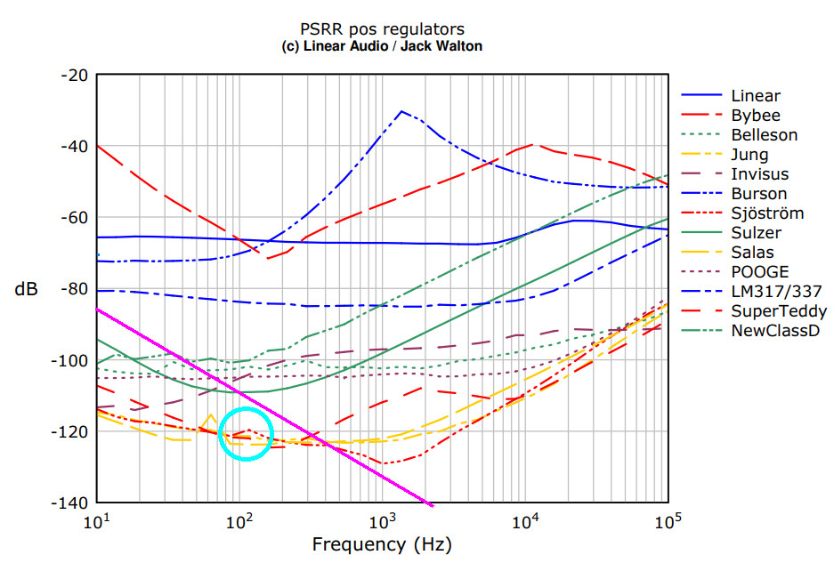

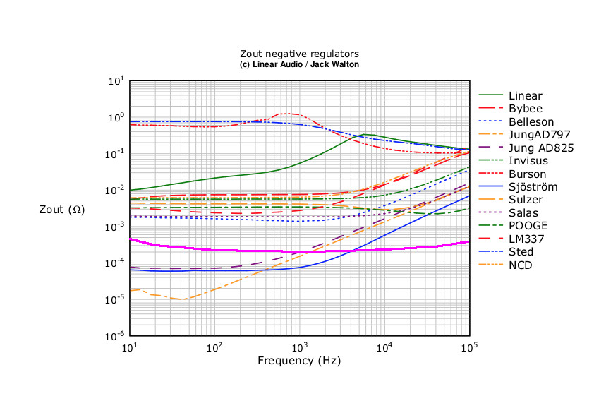

I'm going with an E-562 (mostly because it comes a diode shape and the widely-spaced pads are easier to lay out).
From 20Hz we're at 90dB attenuation, 3mOhms output impedance and 1uV residual ripple.
It still makes 70dB and 10mOhms (the original target specs) at 2Hz.

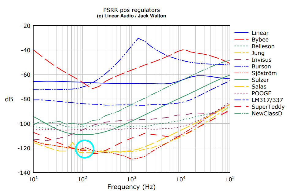

Then you need more gain. That is the reason why the Jung and the Sjostrom regulators got excellent ripple rejection at 2 x fmains: they have super high gain. (I'm not familiar with the others inside the blue circle)

I saw those graphs before. It's from an article on linear audio website. They are measured results. The article is on this website. The Superregs | Linear Audio NL
