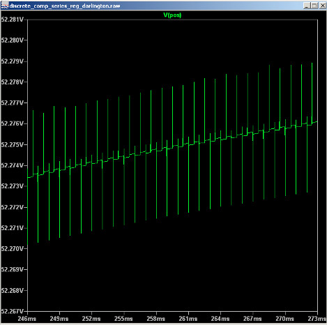

Jeff, what didn't you like about the topology of Jam's suggestion back in post #618?
This is (or at least was meant to be) descendant from that. Did I mess something up?
(I did move one of the LTP legs as it seemed to help something, but I can't remember what now.)
... Is this the topology you tried out the darlington and CFP?
Haven't tried them in this one yet. FWIW, the pass device seems to contribute less in this topology so I think they've got a better chance of working out well....
And finally, a topology where the Darlington is superior. ![nod :nod: :nod:](https://files.diyaudio.com/forums/images/smilies/nod.gif)
Note that the 2SD2081 is likely to be actually worse than the TIP122 in this circuit as its hFE falls off more at low collector currents.

No and yes. Missing gate stopper was accidental, but phase lead comp didn't seem to be doing anything.
Speaking of which, do I need the output capacitor? It doesn't seem to contribute anything....
I take the second part back -- a tiny bit (10p) of phase lead capacitance does improve the margins.
...I wonder if attaching the tail of the differential to negative supply might help performance, then again maybe not.
Likes a little bit less phase lead comp this way, but overall performance is worse.
Jeff.
It wouldn't be an astonishing surprise if the #646 circuit performed poorly when the load current is a 1 kHz square wave, that alternates between 5% max-load-current and 95% max-load-current, with 25 nsec rise time and fall time on the edges of the current waveform.
It will stimulate one of the asymmetries in the topology.

Jeff,
Try a resistor say 250 ohm to 1k from base Q19 to emitter of Q9.
Jam
I assume you mean base Q10 to emitter Q9?
Results are uniformly worse. I also tried a voltage divider wiring the midpoint to the base/emitter junction inside the Darlington, but also to no avail.
How 'bout that output capacitor? Do I need it?
Jeff.
Huge win on the voltage-divider bypass cap. (This is also how I fixed the low frequency in one of the earlier MOSFET shunt regs -- not sure why it didn't occur to me to try it here.)
Using 10uF allows me to either (a) increase bandwidth that it's within spec down to 2Hz, or (b) drop the CRC capacitors to 2,200uF so that I can fit 105º versions.
Preferences?
(FWIW, going up to 100uF still doesn't allow "cake and eat it too".)

Hmm... can't repeat my earlier results. Best I can get with the 85º CRC caps & the new bypass is 6Hz.
Note that because C2 no longer gives us phase lead comp I had to add dominant-pole comp. Margins are a still healthy 58º & 20dB.

I don't have a SPICE model for the BC505, but I played around with some other very-high-gain alternatives. I noticed that I had some gain peaking up in the 10s of MHz that compromised my stability margins -- and it turns out not to be a result of the very-high-gain devices. (I had just failed to notice it before.)
I tried slowing down the Darlington to avoid the problem. This worked, but of course slow transistors are mostly obsolete and hard to find.
Then it dawned on me to use one of those unusually-high-Cob Zetex thingies in the first stage of the Darlington. Worked a charm, and in fact, makes a fine dominant pole too (so I could get rid of the Miller cap).
Specs with ZTX851/MJE340:
70dB attenuation down to 8Hz
10mOhm output impedance 8Hz - 100KHz
5uV residual ripple
phase margin 75º (gain margin infinite)
Looks pretty swell to me....
