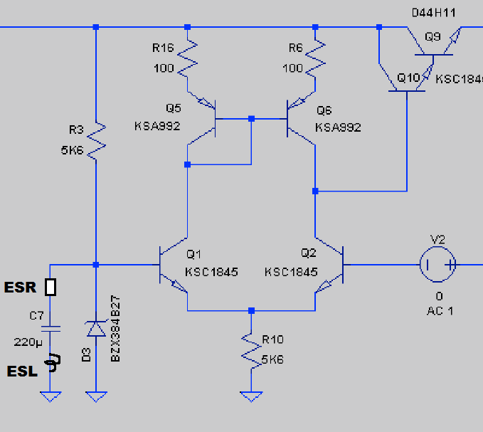

Does the simulated reference voltage get noticeably worse when you include realistic, nonzero ESR and ESL of the VREF capacitor "C7" ? Do ESR/ESL have any effect upon the simulated ripple rejection at 120 Hz?
Are you happy with the amount of non-DC that is present on the VREF node?

ESR seems to have no effect; ESL will introduce a spike, but it's upside down. (120Hz is normally around -97dB; at a resonant ESL of 50mH it drops to -108dB.)
Interesting comment regarding the non-DC present on the Vref node. That seems to be where 90% of my error is coming from....

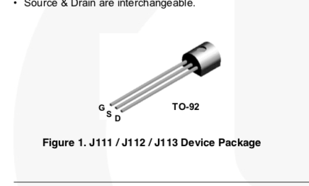

I had a similar thought last night which works well:
attachment.php
I even have some ~ 2mA Idss parts, but not enough to build all the different variations. J113 might be the ticket....
PS: I just looked at the spec sheet of the CR160. It's just a diode-connected JFET too, so it's actually exactly the same thought. 🙂
One nice thing about parts such as the CR160 series is that they are already bin sorted for current. The J113 will probably need source degeneration resistance to achieve the desired current.
Jam also mentioned a good technique to improve performance of the voltage source – which is to use an RC dropping network to supply power to the current regulator diode. Once you have that in place, you can also try connecting the emitters of Q5 and Q6 to that same filtered power node. The emitter resistors can probably be eliminated if you do this.
.... the non-DC present on the Vref node. That seems to be where 90% of my error is coming from....
Jam would have warned you about it eventually. So would the other commenters in this thread who offer ideas on how to reduce it. Personally I am fond of the two-zeners approach because a zener diode costs ten cents while a current regulator diode costs two dollars from Mouser. If you buy them on eBay, you pay less, but what exactly do you receive?
I first saw the two zeners approach in the John Curl / Mark Levinson ML-2 power amp. Nelson Pass used it fairly often too, back when he was designing with BJTs. I put a minor variant of it in "Mountain View," and it works quite acceptably well there.

Without doing any calculations, I would tend to use more than 2mA to bias the Zener if you are using a bipolar ltp.
Most likely 5mA as a rough starting point.
Maybe an lm329 would be better here or maybe use leds.
Or use 5.1 V Zeners.
You could also use tl431.
