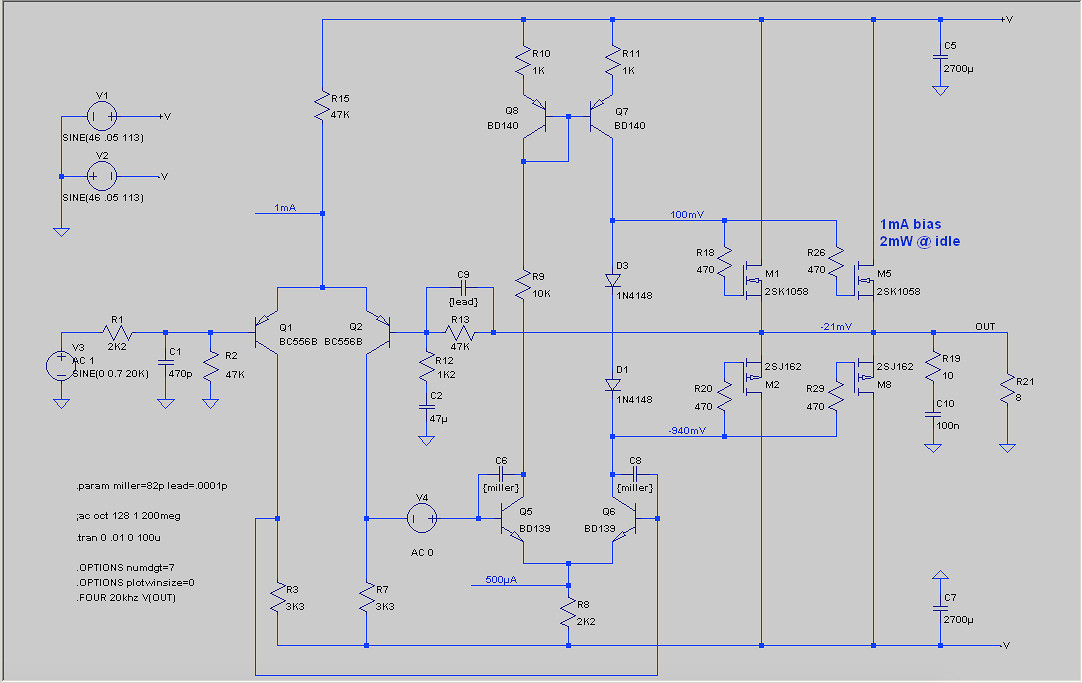

I started looking at the Hitachi topology. Here's the baseline, based on the schematic Jam posted:
While it performs well at lower frequencies (aside from a shockingly poor phase margin), it falls apart at higher frequencies (17% THD20K @ 60W).
The VAS current looks really low to me; raising it to 1.8mA appears to fix the high frequency issue (dropping TDH20K to around 1%).
But there's still that scary phase angle. The AC waveform says it should be oscillating at 400kHz (at least the phase angle goes over 180º at that point, and the gain is still way above unity at +10dB). However, if I feed it a 440kHz signal it shows an ugly -- but non-oscillatory -- sine wave.
I can improve the non-existent phase margin by replacing the Miller compensation with a moderate amount (30p) of lead compensation, but the phase margin is still a paltry 20º.
Thoughts?
Thoughts?
