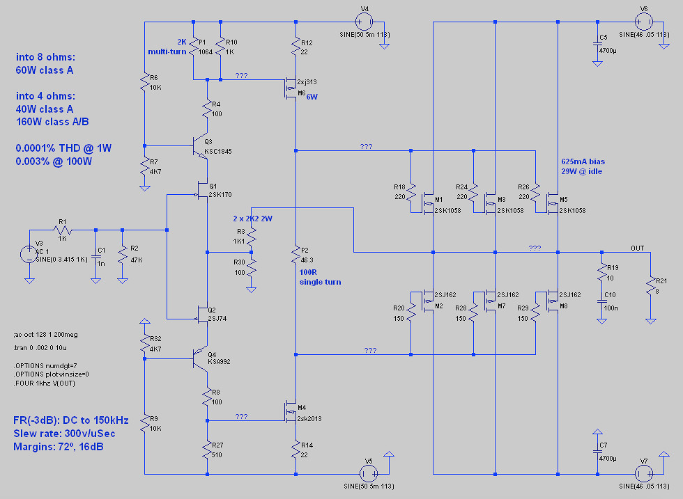

The whole output stage bias arrangement (D1, D3, M1, M2) gives me the willies. The voltage dropped across D1 and D3 is known and repeatable. But the Vgs_th values of M1 and M2 are unknown and highly variable. I suppose Hitachi, as a semiconductor manufacturer, could measure, and sort, and cherry-pick the ones which happen to have just zackly the right Vgs_th voltages. But normal people? Hobbyists? It gives me the willies.
BTW, I expect about 1200 microamperes flowing in R8, not 500 as written (?)
I have only looked at the circuit on your opening thread. You do not need Q11 and associated parts. A single resistor could set the bias. Lats do not thermally run away, as temperature increases their resistance increases. In many of my designs I used a single diode to bias at optimum current for lowest THD, which is a round 100 mA.
Hi Nico,
Yes, indeed the schematic for the current mirror version has been updated (the feedback was simplified as well):
attachment.php
Jeff.

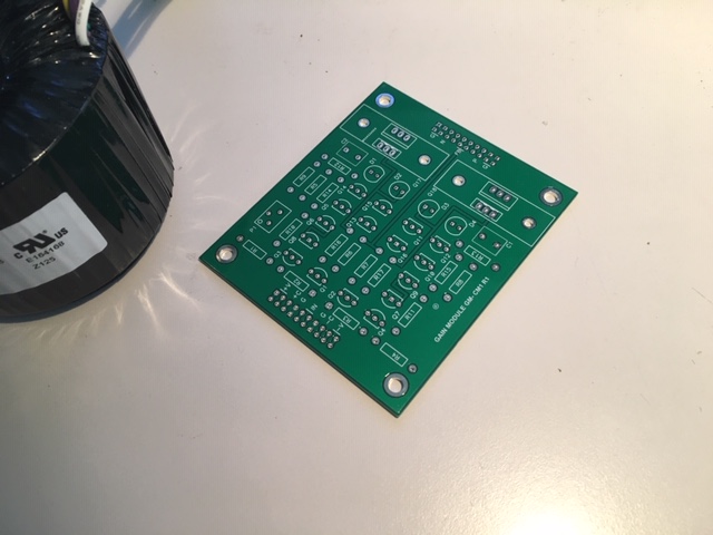

Hi Jeff,
We are waiting on the edges of our seats for your desicision on the choics of front end for the JamJar.
Meanwhile I am working on the next headphone amplifier (HPA-2? ;) ).
Picture of the prototype of the gain module board , minus devices, bias circuit and servo ( which could be adapted for a power amp.)
Jam

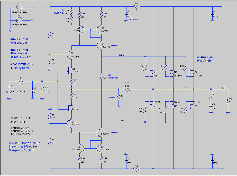

I took another run at the push-pull VAS and this time managed to make it behave.
It has slightly more complexity due to needing a split supply, but also runs the output devices slightly cooler because of it. Other than that, it produces very similar performance numbers as the current mirror version.
attachment.php
Hi Jeff,
Unless your matching is very tight I would use small source resistors for the output devices.
I would use larger gate resistors for the outputs (safety)
Add protection zeners from gate to source.
The weakest part of the circuit is the VAS.
I still would use a Vbe multiplier for the bias circuit as apposed to the resistor.
Jam

I have found being fearless with laterals is actually a very trivial matter.
Getting closely matched parts with laterals is easy compared with traditional mosfets.
Then you have the temperature coefficient that works in your favour, current hogging never actually happens in practice, provided the person doing the matching is not a complete melon head.
I vote in favour of being a DIYFAB.
Having said that it doesn't hurt to add space for degenerating resistors. You just install links instead of resistors.
I would load the output of the voltage gain stage, eg maybe 1k to ground.
