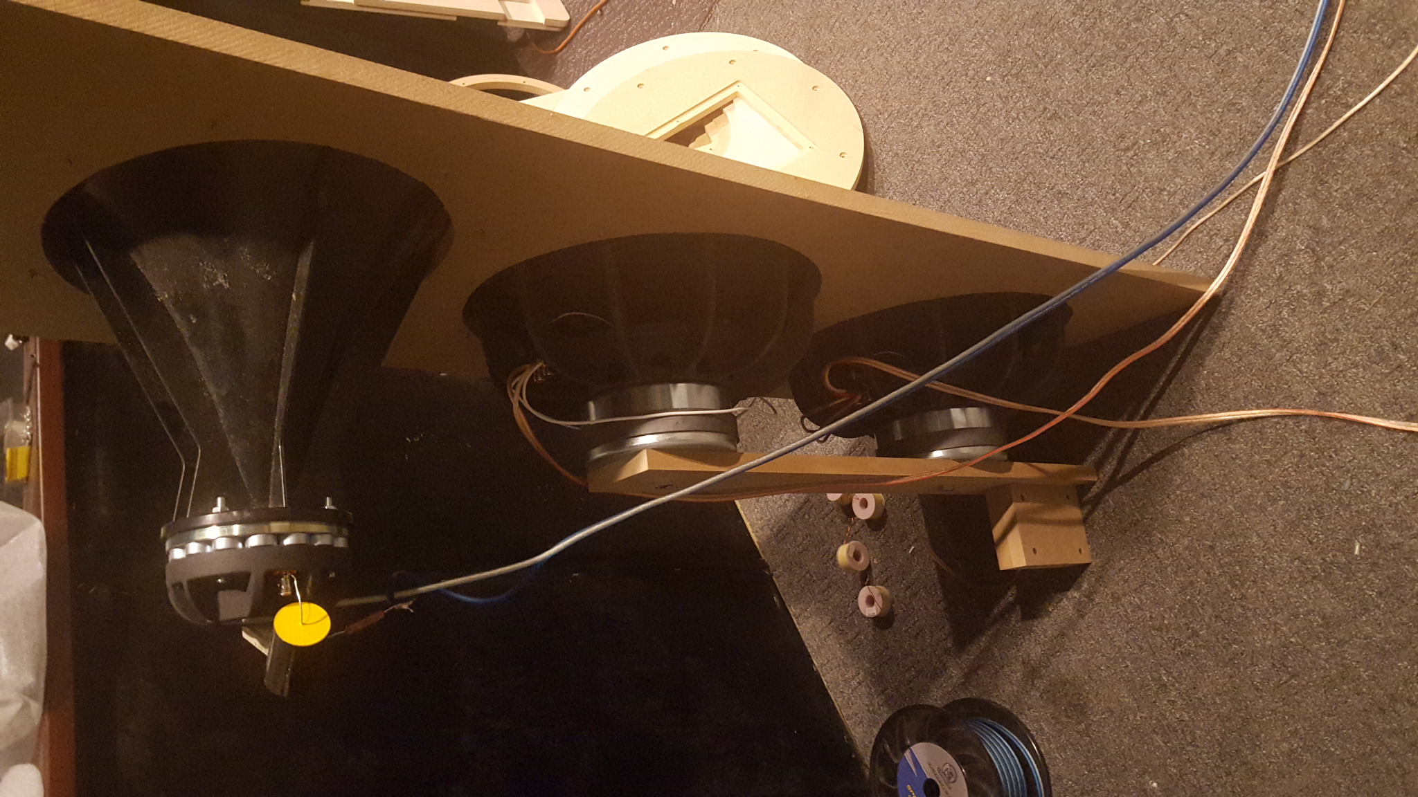

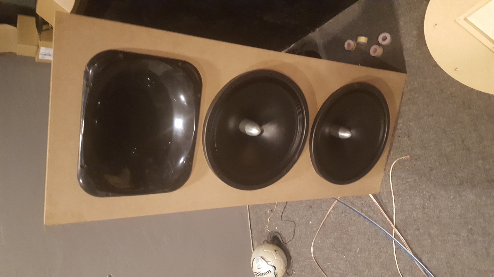

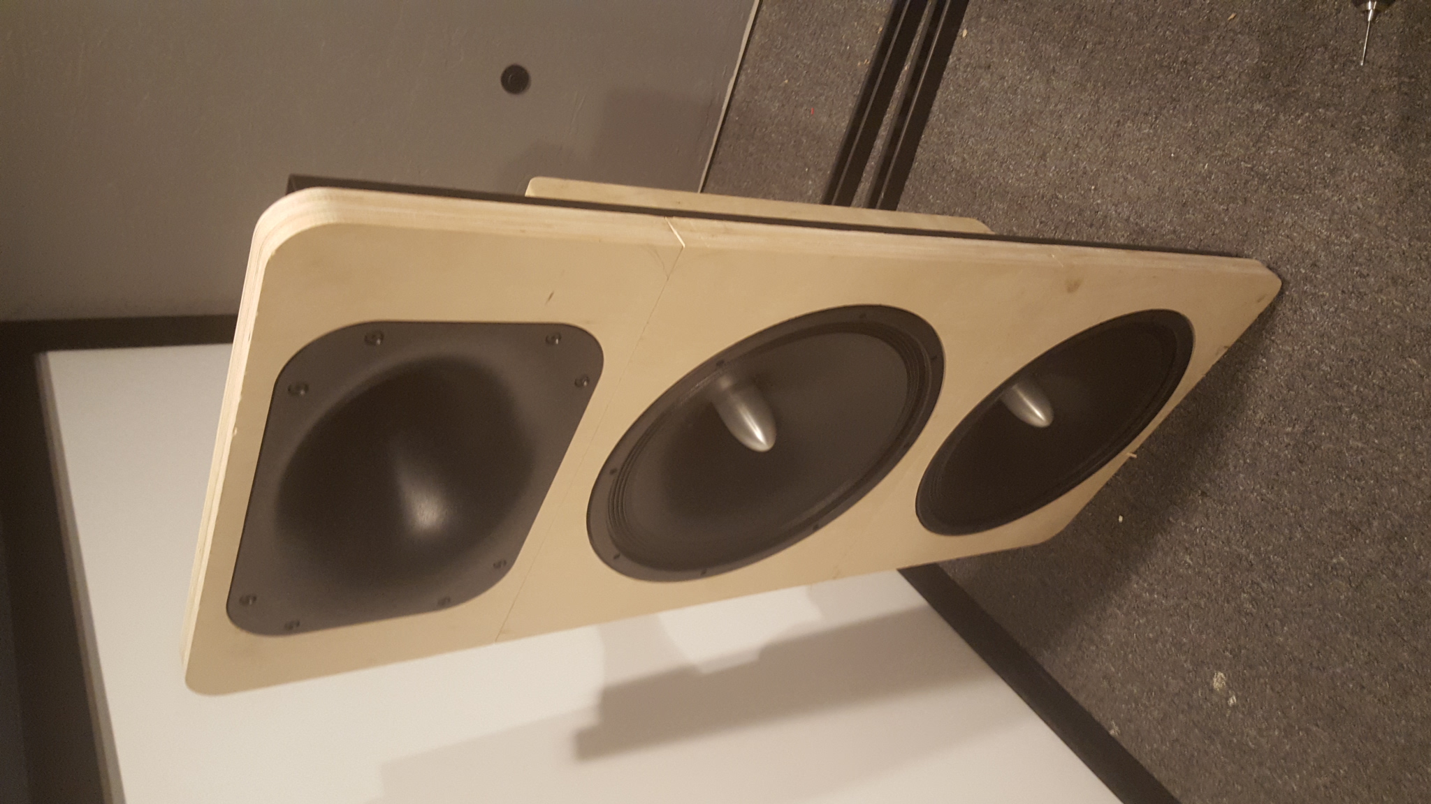

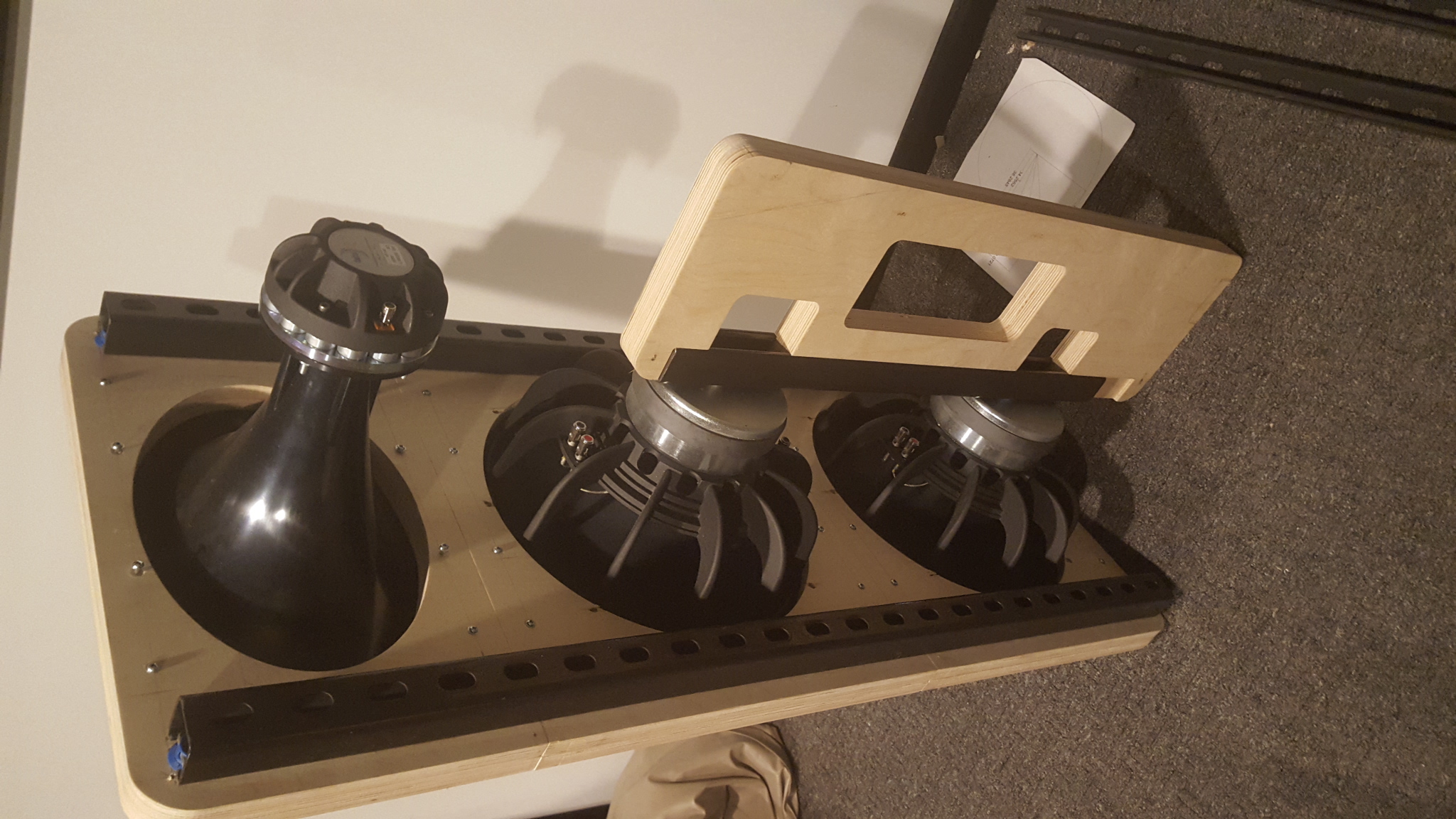

Ozone seems to have disappeared but there has been a lot of interest in this. It is one of the most shared and most asked about projects. I decided to put something together that is a super simple DIY project. I am constantly helping OEM customers with designs that may end up selling for $100,000 or more. Doing an ultra cheap design was a new experience but I think it works out well. Plans will be available free. Material cost is very low. That allows money to be put into quality drivers where it is best spent.
There were a few revisions to get to something super cheap. The first version was going to use extruded aluminum tubing from 8020 to make a frame. Then it clicked that one of the benefits of the Dipole and LO woofers is they have a solid pole and phase plug. No vent in back. We can drill and tap the back plate allowing to bolt a rear leg right onto them. No need for a separate frame. This let us bolt the unistrut to the back in the first revision a simple MDF leg in the second even cheaper version.
The LO15 were an easy choice. The goal was for more priority on efficiency over extension. These will get down quite nicely to 32-35hz depending on room placement. The distance from the wall behind can either decrease or reinforce the low end output. Room position is somewhat important in this case. The upper end we tried many things. We tried smaller waveguides and even large SEOS24 waveguides. The main issue is we need something readily available. Supply of the SEOS is never a guarantee so we looked elsewhere.
On paper, the Faital HF146 on the LTH142 horn looks great. The upper end is extended well without much craziness in the impedance curve. We used this in the design with the unistrut and baltic birch plywood. This was a modular design that bolts together and has no fasteners from the front. The issue is that the HF146 has a pretty good dip around 1800hz. On the LTH142 it is about 8dB or so and wide enough that we don't like it. Faital didn't really have any answers for us. We are still discussing this. The other issue is the LTH142 doesn't REALLY extend as low as we would like. By 800hz it is fairly rolled off. It should be a little larger or deeper. This was the same issue with the SEOS15 which is quite small and shallow for a 15" waveguide.
The second revision ended up using the deeper, slightly larger 18sound XT1464 waveguide. This loaded lower bringing the real useable response down to 800hz without problem. It also reduced the dip at 1800hz to something that was reasonable. Now we had something to work with. This one makes the materials VERY cheap. Each baffle is made from a single 2'x4' piece of MDF that can be purchased from home depot. A 4" strip is ripped off and used to make the rear leg. Three holes are cut and drivers are flush mounted. A pair of baffles with rear legs can be made for about $30 with all bolts included. The sample here is just raw MDF. Not painted. No rounded edges. Drivers not flush mounted. People can take that and work with it though. It could be nicely veneered plywood, painted, rounded edges, double or triple up on the baffle, etc.
Now, in regards to the waveguide, it is 60 degrees. This actually matches quite well to the open baffle pattern. While a 15" driver is normally about 90 degrees up to 800hz, in the OB configuration it is really closer to 60 degrees. You get the nulls to the side that eliminates reflections from the walls. The directivity of the waveguide does similar. Yes, there is no rear wave in this case. However, take into account the wavelength. At low frequencies, you may be only 1-2 wavelengths away before the rear wave hits the wall, turns around and comes back. By the time you get to 800hz, you may be 8-10 wavelengths away before the sound reflects back forward. It can add a little to the spaciousness of the sound, but in reality it is not helping with the accuracy of what is intended to be played. For this reason, I prefer the sound of the upper end not being open baffle.
When it comes to compression drivers, the HF146 sounds pretty good. It is the best reasonably priced compression driver I have found. The top most octave is quite good. It isn't as good as a JBL, TAD, or Radian Beryllium, but it is 1/4 the cost. 18Sound did tell me they have a Beryllium compression driver coming soon. It is quite expensive, about $1100 retail, but they assured me it is the best available. I will see when it gets to that. For now, the HF146 on the XT1464 is pretty good and available easily.
The other issue though is that the compression driver needs to be substantially padded down passively. It simply doesn't need to have the efficiency it does. For this reason, I may look at using a beryllium dome on a waveguide soon. SB Acoustics has a Beryllium dome coming out that could be a great solution. Using it with a waveguide to bring up the low end output and lower distortion could be a perfect option. I will know more on this by end of the year.
A final option is the Mundorf AMT164UM2.3-R. This is a NICE AMT. Vertically we don't need much dispersion. This is the cleanest and lowest distortion AMT I have seen. For 800euro it should be though. In comparison, distortion is 25dB or more LOWER than something like the PHT1-6 planar from PE. I am looking into a waveguide that can extend the response just a little more to get under 1KHz. Distortion is already low enough it can get close but we don't want power limits to be the issue.
