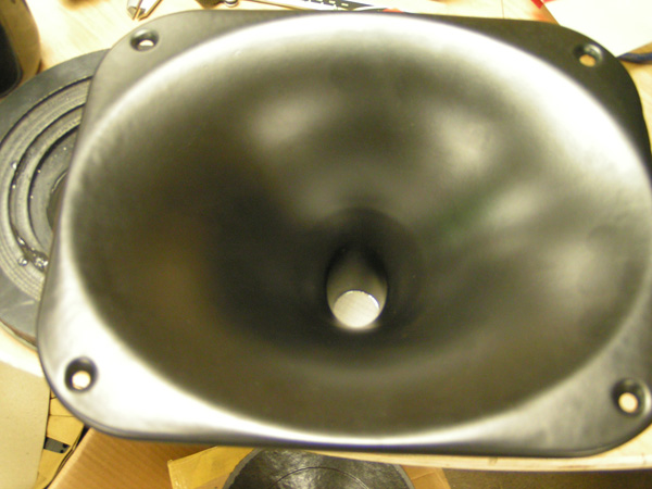

To understand the JBL M2, you have to look at the 18Sound XT1086. 18Sound came out with this horn about ten years ago, and it's still available here:
18 SOUND XT1086 Horn Flare
The XT1086 does something interesting, which is that it has a diffraction slot similar to the Manta Ray horns from 35 years ago:
![QkaCkHH.jpg](https://imgur.com/QkaCkHH.jpg)
But the diffraction slot in the 18Sound is exceptionally short. It basically takes the circular throat of the compression driver and converts it to an elliptical shape like this:
![gbQrHtE.jpg](https://imgur.com/gbQrHtE.jpg)
(note the ellipitical exit about 3cm from the throat of the horn.)

Oh, one last point about the JBL waveguides:
The 18Sound XT1086 came out about twelve years ago. It has an old-school diffraction slot, but with a verrrry smooth transition from the slot to the waveguide.
If you took a couple of XT1086s, rotate one by 45 degrees and the other by -45 degrees, then merged 'em together it would look a lot like a...
JBL M2 waveguide. Same diffraction slot, now in 3D. The idea is to "have your cake and eat it too". The low frequency loading of diffraction horn, without the resonances that are generated in a conventional diffraction slot. Pipes are very resonant and a diffraction slot is a pipe. The JBL slot, with it's varied geometry, reduces the resonances. A clever design. (Keep in mind, a plain ol' OS waveguide works pretty darn good. The JBL style is required because they're covering such a wide bandwidth with a single driver.)
![lJEzpYC.jpg](https://imgur.com/lJEzpYC.jpg)
![gDpLqOU.jpg](https://imgur.com/gDpLqOU.jpg)
