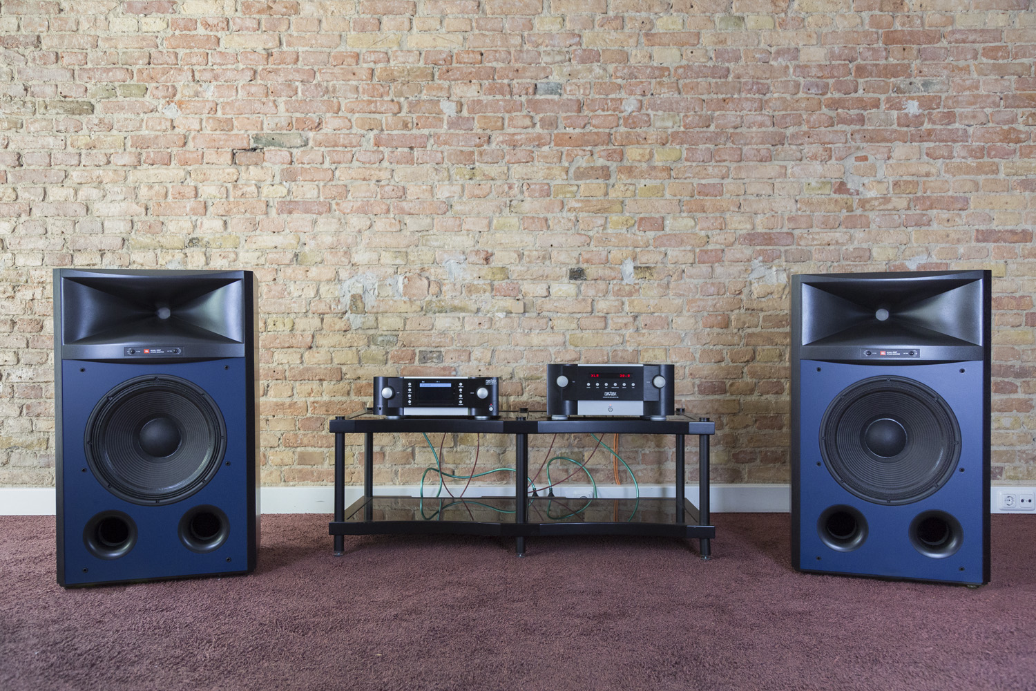

Something I've been curious about; why squash the waveguide so heavily, then leave what appears to be an inch or more of empty baffle between it and the LF driver?1) Squash the waveguide, so that the center-to-center spacing is tighter. JBL did this with the 4367.
Those blue baffle JBLs are for consumer market, and their cosmetics are at least as important as their sound.
