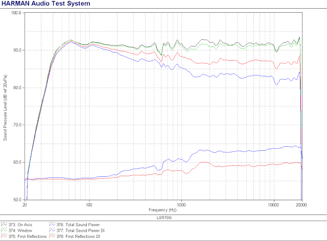

I think the 708i is the "poor" mans M2. Compression driver and pro derived woofer and a similar spinorama curve... I believe they are passive wich is also cost saving compared to the M2 that require a set of crown amps or a Harman based DSP.
LSR708i Products | JBL Professional

I think the 708i is the "poor" mans M2. Compression driver and pro derived woofer and a similar spinorama curve....
Yes, really a poor one as well : 114 dB peak max, no more than my old hifi Kef 104/2 from the 80s'
Surely no more than 90 dB efficienty
Both spec are far from the PA world but maybe thanks to the compression driver it has the subjectiv dynamic behavior !
Anyway with such poor SPL & efficienty I can't understand why not to go with a more linear classic driver in the horn !
