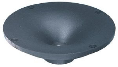

I'm talking about reflections in horn path.
This would be reflection free.

I see your point as you explain in your first post. This would be a good waveguide by those guidelines. I think calling it reflection free is splitting hairs.

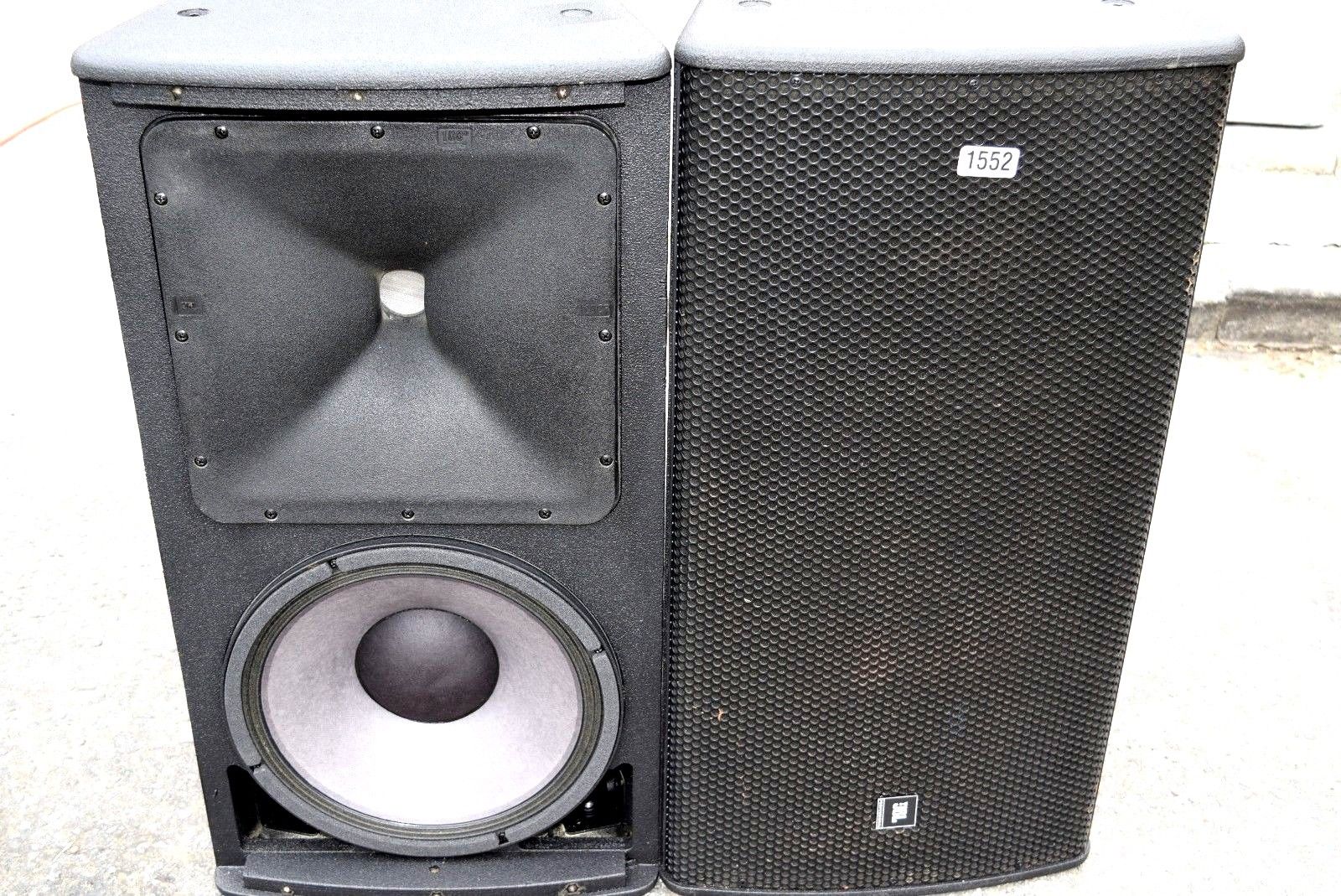

I see there are the older pt waveguide in a jbl speaker.
The am4212/00.
I can speak for the compression driver, the 2407 doesn't have the big peak at 10khz that the 2408 does (jbl usually notches it out).
And no ferrofluid to worry about if 10 years old.
JBL AM4212/00 2-WAY LOUDSPEAKER (ONE) | eBay
If you offer 250, they will probably counter offer with 300 each (plus 85 shipping each).
The pic is the 4212/00, notice the bubble near throat.
I have no associations with seller and they are not mine.
