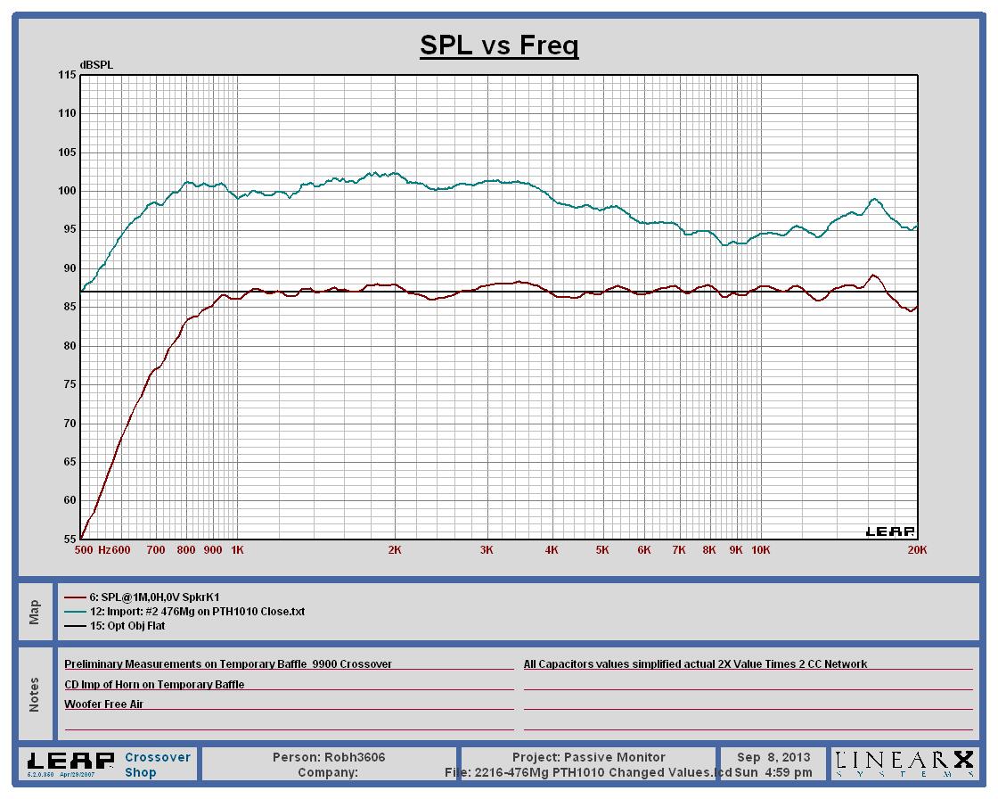

Looking at the plane wave response of a 2431 (post 2)
2431h
then the overlay of the directivity of the pth1010 horn, well it does narrow a little past 4khz, so it may offset it.
It pinches (1010hf horn) down at 10khz, maybe that explains the 10khz notch in network.
So, yea, I guess it may measure flattish to 10khz. You can see a droop off axis at 10khz+.

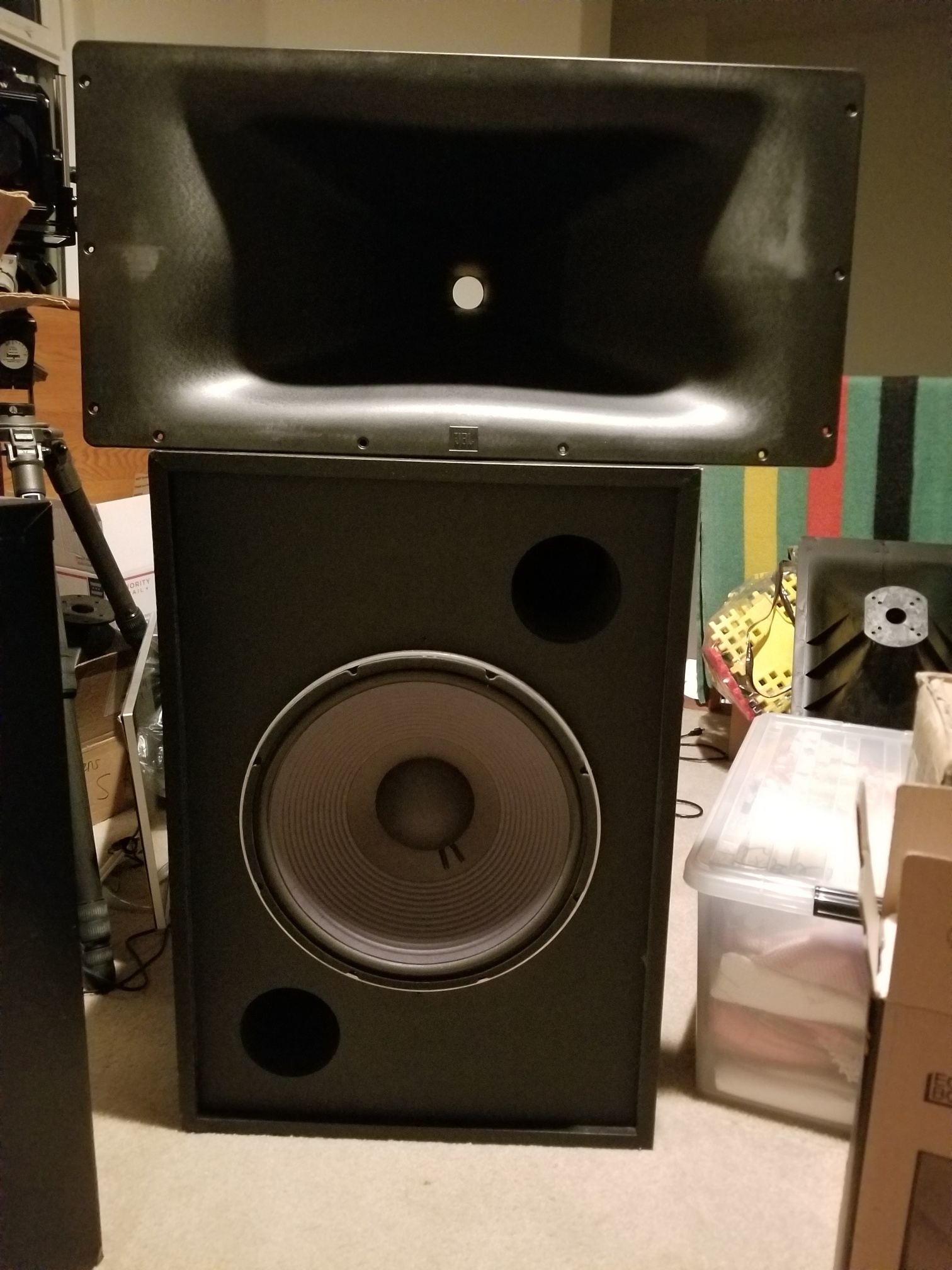

In the fengshui of things that horn is too big for my space, I am downsizing; maybe for movie night out in the yard.
My listening room is sharing a large bedroom with my work benches. No more HT.
I like the semi-tower shape my speakers are taking with; woofers JBL 2204’s, JBL 2123’s and PT H1010HF-1’s.

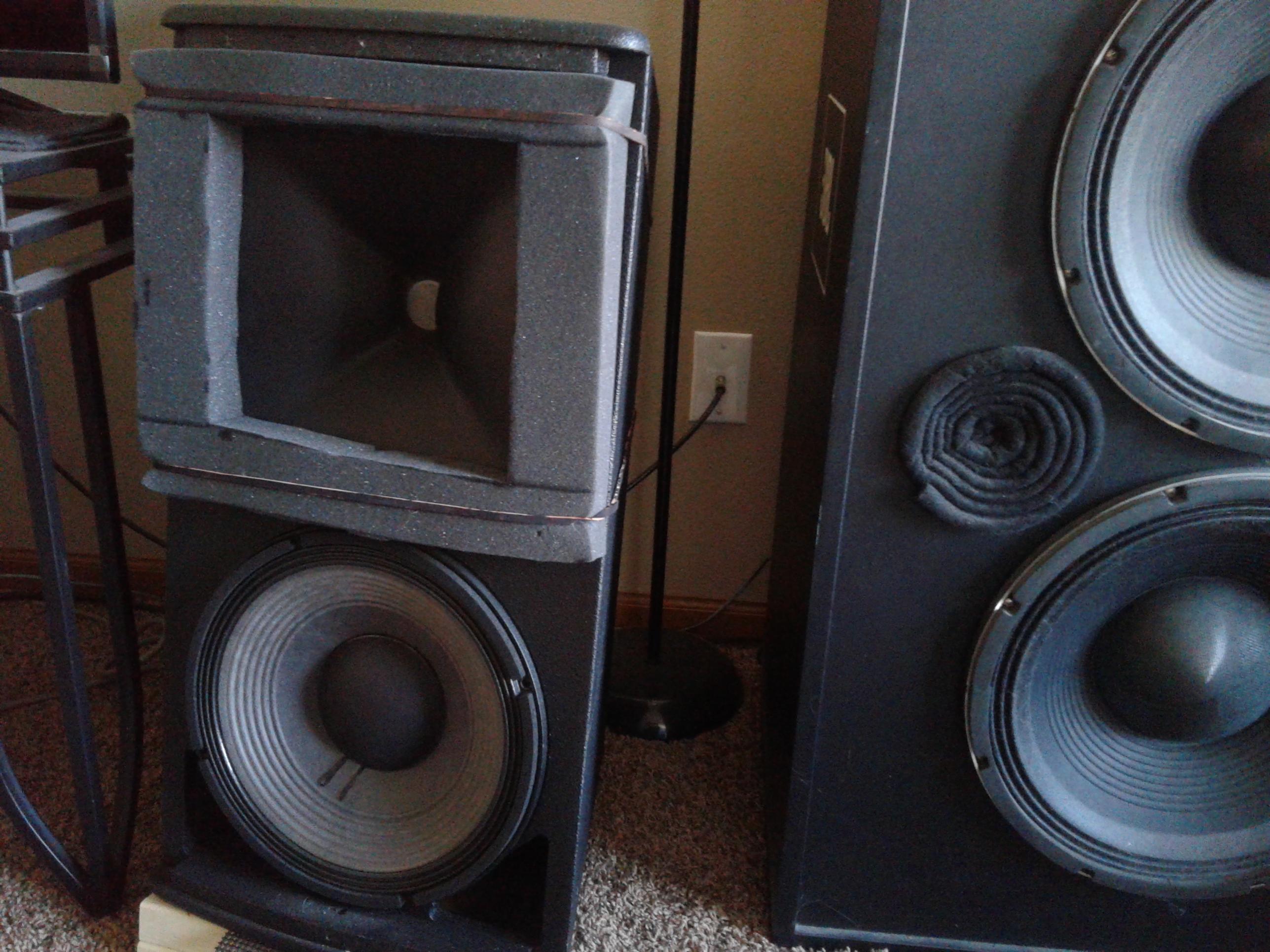

Anywho, guess I'm a bass head. Before sub, i thought jbl sounded funny, constantly fiddling with eq.
I do have foam around mouth absorbing reflections.

Hello Norman,
In your posted photo I see the “foam” you have placed partially obstructing the mouth of the waveguide.
The foam looks to be soft and absorptive to a degree. The foam also appears to be cut with square edges that are likely to be reflective to a degree as well. The sharp edges seem likely to also add a significant amount of diffraction.
The smooth waveguide factory surfaces appear to be the product high tech design and iterative testing. Do you have any documentation showing how the application of foam over the mouth of the waveguide is an improvement?
Thanks DT
nope, my ears like it.
The pt waveguide is a very short horn, flare is very quick and rounded.
On the big 2384horn, the rounded over horn walls I believe made foam around the horn mouth less noticeable.
Like the highs just can't get around the bend, unlike a diffraction slot edge in the throat.
To be honesty, it helps, a little, not jaw droppingly, more like a strong subjective response to a better speaker cable.
I've been playing with foam like this (maybe 30ppi I think) for a long time around horn mouths.
I have better luck with felt with my dome tweeter (there is documentation on that), but I couldn't tell you how much it would be for a piece 1" or more thick 14.5" wide by 12.5" tall (F10).

My current jbl is using 2" foam (I think), very porous but you are right, it may be reflecting something, I doubt it after trying to listen through the foam, small effect.
Your ears may like it, and that's important. As a proponent of 100x100 horns, I can't help but think you have shrunk the pattern, and, while introducing an artificial/non-design boundary on the horn, I can't help but think the full pattern of a smaller dispersion pattern horn run as it's supposed to be, might not be better in every way.
What do you think?
I bet the foam isn't doing much below 4khz.
I think of the foam is absorbing reflections hitting box edges and reradiating (probably see in a waterfall response) than narrowing dispersion in room.

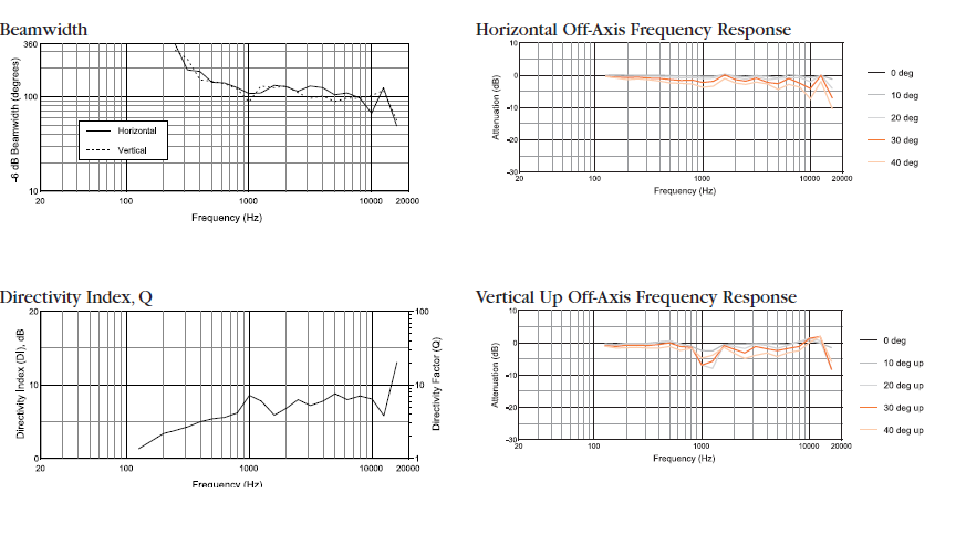

I sit 7' away, so I don't notice a lack of off axis, the horn narrows past 8khz as do most 1.5" throats.
The horn itself isn't really 100 x 100, more than that then narrowing to that past 5khz (compression driver).
