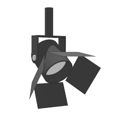

First blush my impression was that the foam was a little odd, you know blocking the output of a carefully designed wave guide.
Then I gave it some more thought and got the idea that the foam may serve some purpose similar to what the wave guide is supposed to do in the first place but more of it. I see the foam shaping the beamwidth and or reducing the sound reflecting off the walls much the same effect as absorption material placed on the walls. I also see the off axis frequency response curves being completely different than the factory curves.
I kind of see the foam attached to the waveguide as flaps on a barn door spotlight.
I recently got a calibrated microphone and acoustic measurement hardware. When it quits raining here in Northern California I plan to go out in the backyard and do some frequency response testing.
Thanks DT

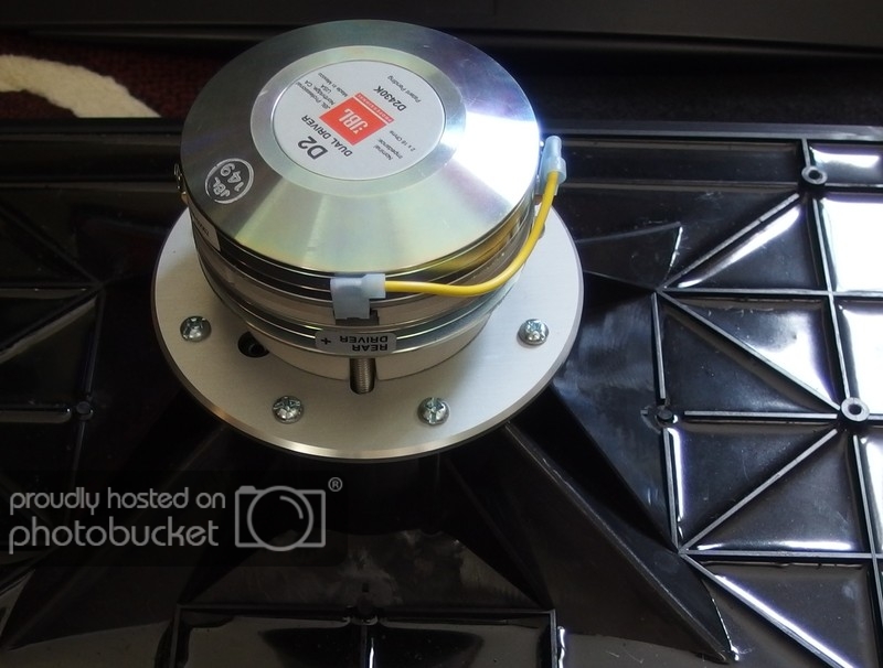

That M2 waveguide looks a bit complicated on the back.
Looking at the Speaker Exchange site there is a 8 hole adapter flange that is used to connenect the compression driver to the waveguide.
Do you know what bolt circle dimension of the D2 driver is?

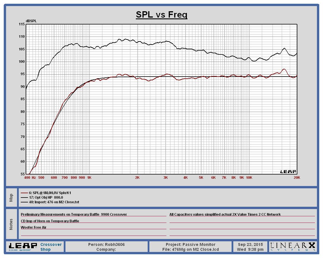

Did you ever get a chance to listen or measure the M2 waveguide?
Hello Mitchba
I have done on axis measurements and worked out a passive network compensation for it. If you have CD driver with relatively smooth response it works out nice. I have to actually build up the speakers come spring been sitting on them for a while. Hear is an on axis with a passive network doing the comp and the high pass.
The bolt pattern is the same as 2431's and 2435's and 476Mg's

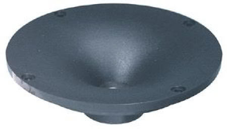

1st pic = jbl synthesis
2nd pic = jbl m2 horn
3rd pic = mcm 54-580 horn

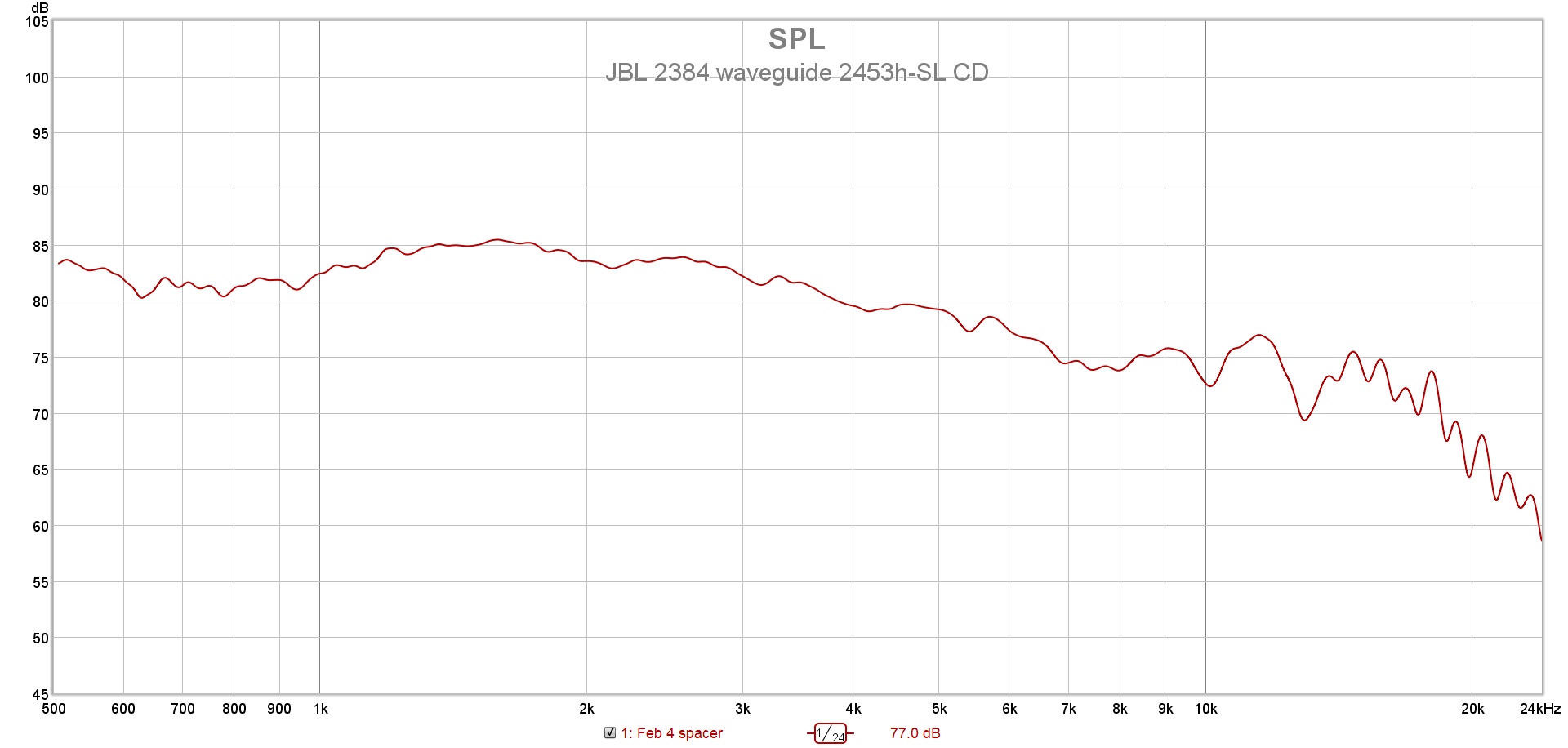

I have JBL 4722 with the 2384 waveguide and changed out the 3" 2432 CD to a 2453h-SL auquaplased Ti CD. Not bad response up high for a 1.5" exit:
attachment.php
The only two things I don't like is the notch between 12 and 13 kHz and wish for a bit wider directivity as it is a 90 x 50 pattern. I used a 1/2" spacer between the CD and waveguide, which helped reduce the notch. But looking at the throat of the waveguide and where the CD joins, pretty rough around the edges. I thought about taking a dremel tool to smooth out, but don't know if that would help the notch in the FR or not... Or is it simply the case with the large format 4" CD with a 1.5" exit..?
Take a look at post 47 top trace that is also a large format 4" with a 1.5" on an M2 also JBL. If I remember the 2453 is in a shorter package above the top plate than say a 2451/52 so I think you may have a shorter phase plug. Similar to a 2431/2435. It can't hurt to smooth it out aka Earl G.
Rob
Thanks Rob - 476Mg - whoa!! Yes, the 2453 has the shorter phase plug. Maybe not a great match for the 2384...? I do like that the 2384 mates well with the double 15" at 630 Hz. I tried raising the XO to 800 Hz and it shifted the image up towards the waveguide and not inbetween the top 15" and wg. I can try smoothing our per Earl, but maybe I am wasting my time and should be looking at different waveguide and/or CD combo...
I wouldn't worry about that dip, it is way up there and better than a peak.
