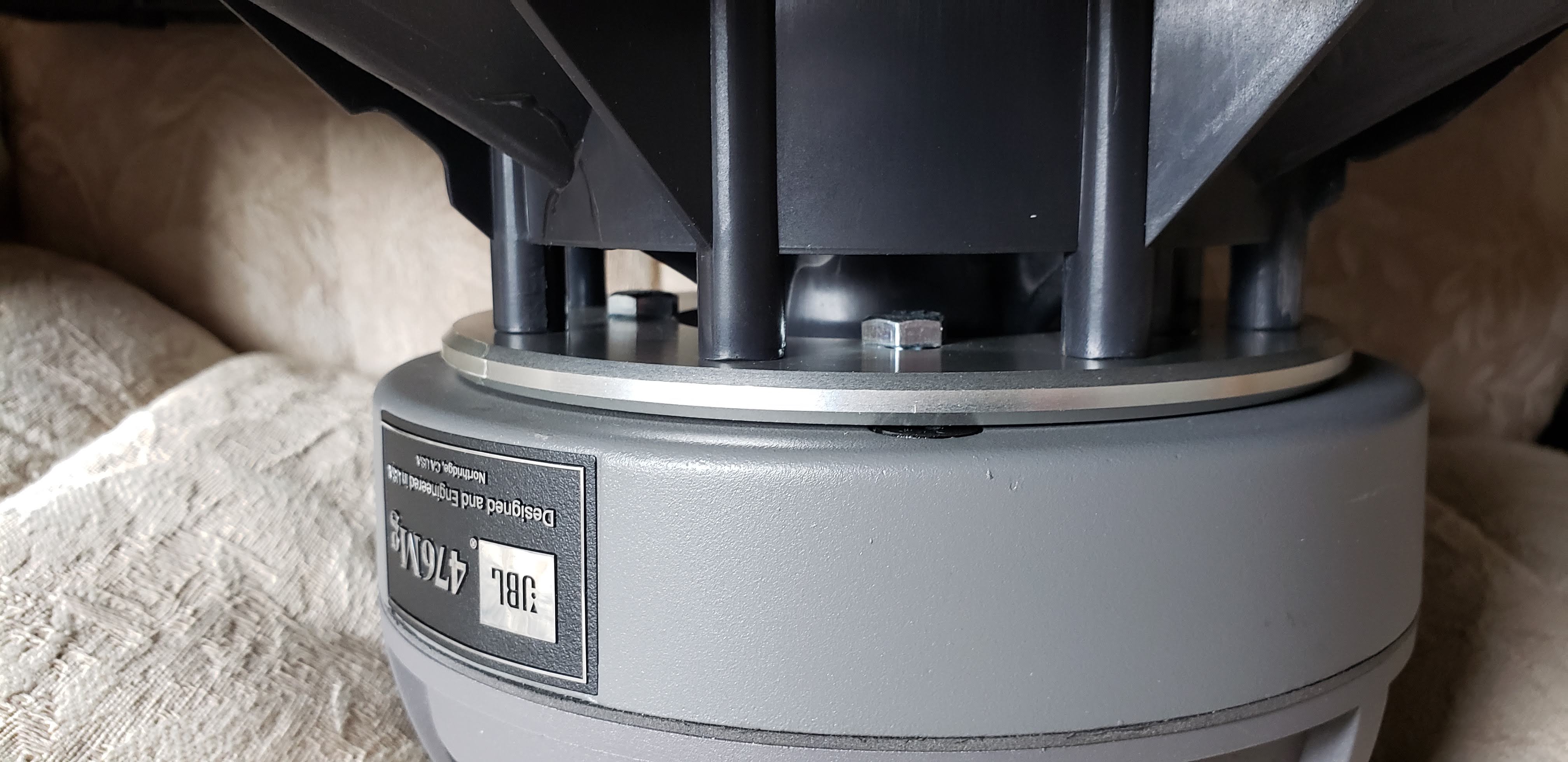

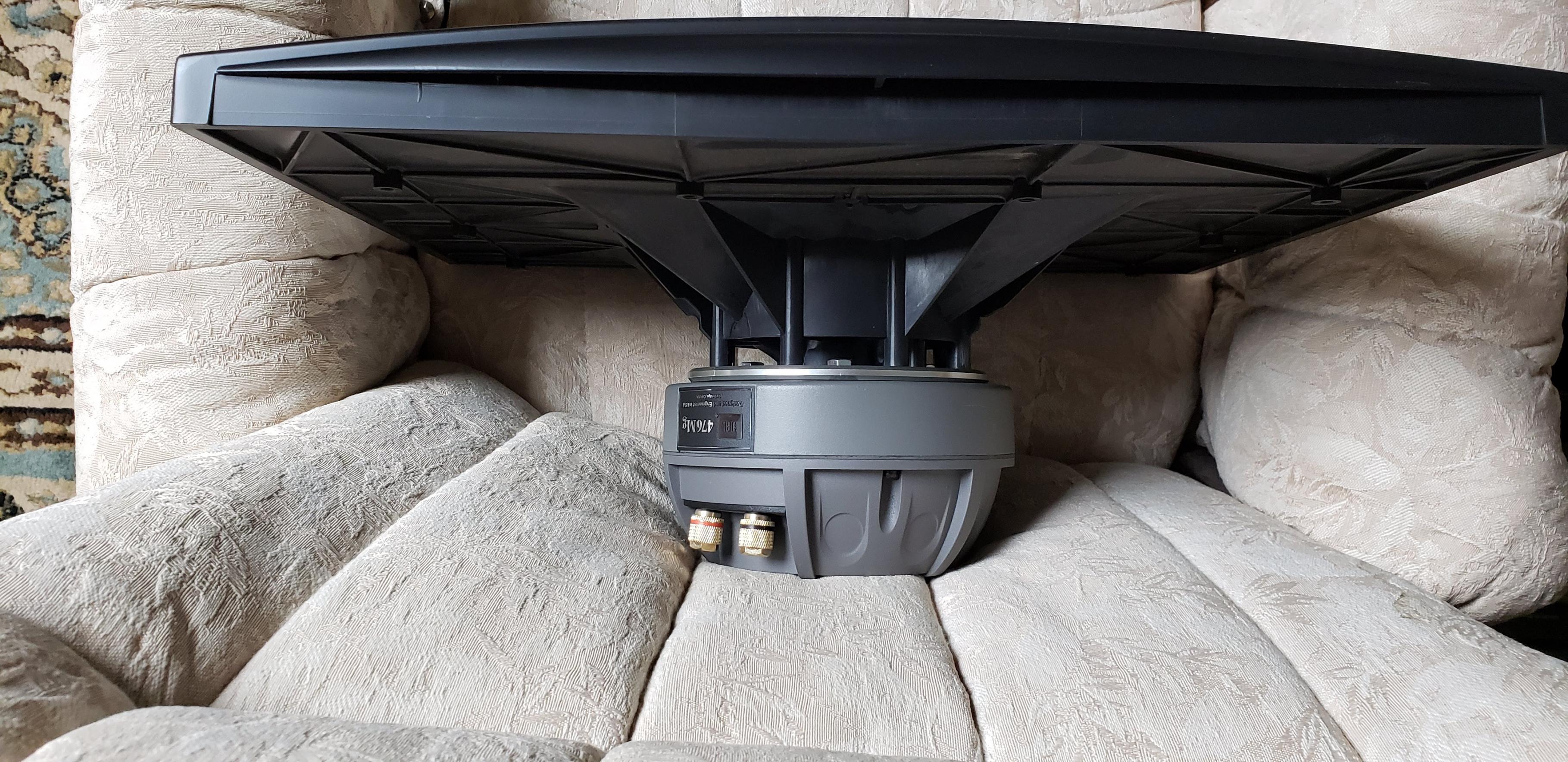

Hello,
Take a look at the third photo above. The flange has 4 slotted holes for the attachment of the driver. With my handy ruler the slots will accept 3 ¼” to 3 ½” bolt circle drivers.
As far as I can tell 3 ¼” to 3 ½” bolt circle drivers will fit.
Both the D2430H and 2432H have a 3 ¼” bolt circle and fit the OEM flange and waveguide the same.

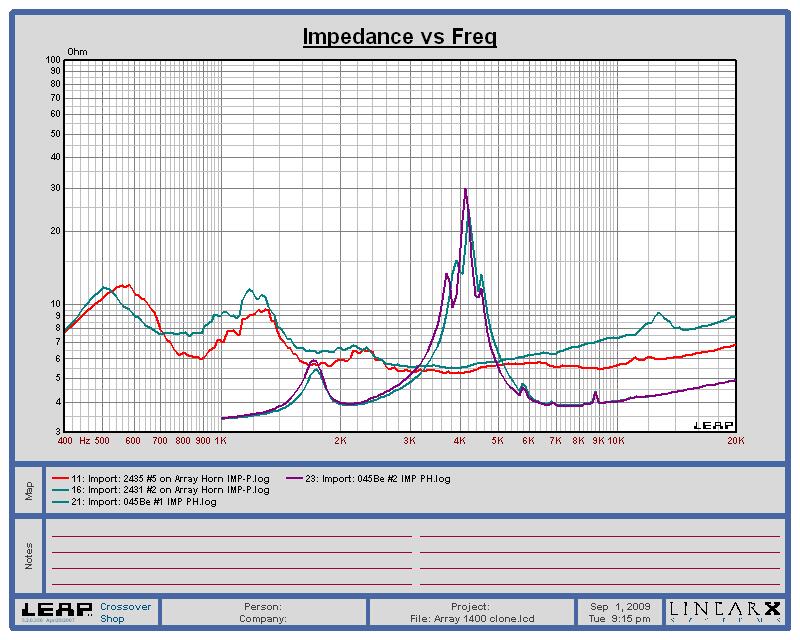

I am going to be taking a closer look at the impedance curves of these 100 X 100 waveguides and CD combinations. Looking at cone drivers my impedance curves are turning out to be relatively smooth compared to the curves that I am getting with the CD PT H1010HF-1 (this is the newer one). My curves for the CD and PT waveguide combination is looking pretty much ragged especially related to the 1.7K ish impedance peak. See post #67
Looking at your attached impedance plot above you have the same 1.7K ish peak with a little related roughness. The edges on my plot look like a serrated kitchen knife.
I think that there is some instability going on with the CD diaphragm and or waveguide or both around that 1.7K ish impedance peak.
What are your thoughts and experience with this?
Thanks DT
yup, horn standing waves show up in the Z plot, throat to mouth, and across mouth also (even little ripples cause by reflections from edges in horn path), I think a compression driver's Fs is there somewhere, maybe not. It will not be as flat some drivers with a copper cap. So I hope others can chime in.
On google, you can look up images of "compression driver" impedence to see what we are looking at.
I've seen comments on AH forum about the pt (older) not loading much below 2khz (maybe 1.5khz, I can't remember).
replaced my 2420 + 2344A with 2435 + PT-H1010HF - Page 2
Flatter is better, but the big throat to mouth peak is probably unavoidable.

Hello DT, your measurements are looking good. Maybe you have already seen this M2 adapter: Compact monitor - Page 6
Mitch
Hey Mitch,
Thanks I took a look at the adaptor flange in the link that you provided. I am still scratching my head thinking about it.
At this point it looks like that I can drill 4 new holes for the larger bolt circle required for the 2451 CD.

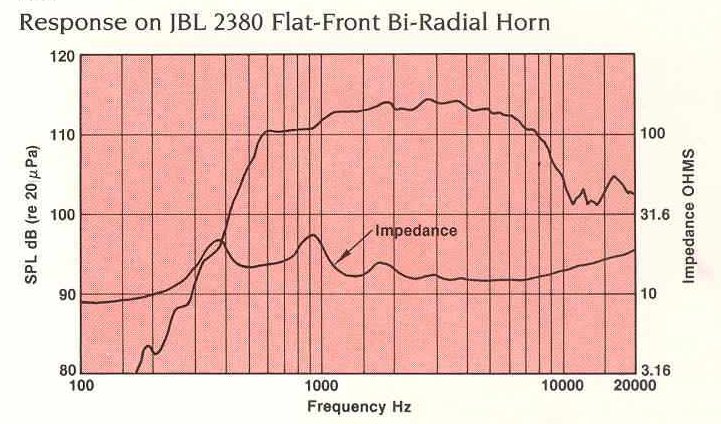

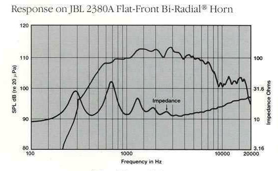

Hello DT
Frankly I am not sure that is what's happening. If you take a common horn like the 2380 Flat Front Bi-radial and look at the impedance curves with different drivers the peaks are all over the place and not consistent in amplitude or location. If you had a strong horn resonance going on wouldn't you expect a bump in impedance curves in all drivers at that frequency?? Don't see that in the plots with 2427 2445 and 2446 drivers??
Rob🙂

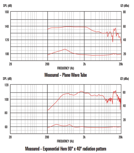

I found a plot of a celestion cdx20-3075.
Its impedance plot then its plot on their 90 x 40 horn, notice it went from 1 Z peak to 2 smaller ones.
Did not know that, thanks for the prod in the right direction.

Hello DT
Rob🙂
