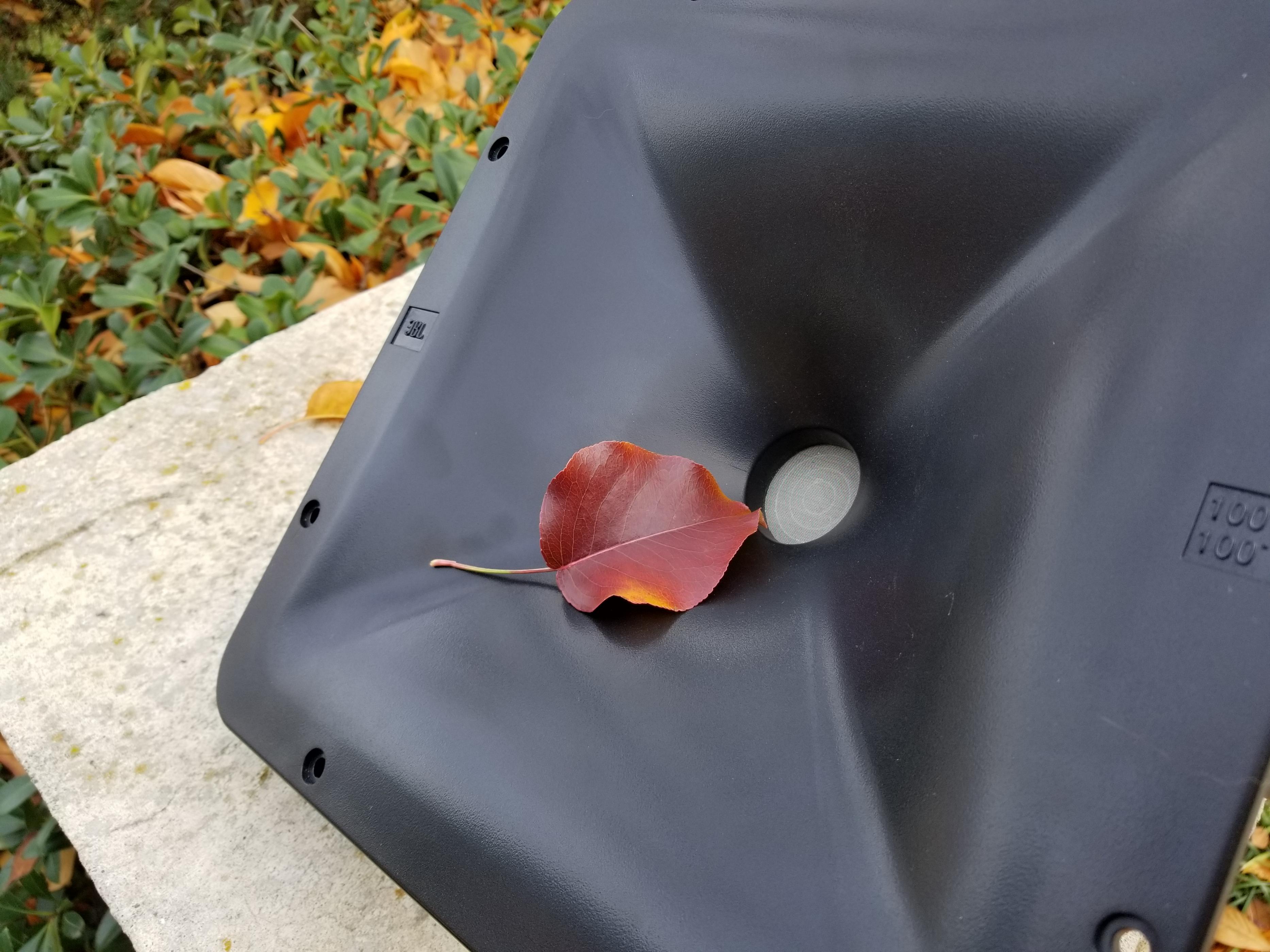

Hello DT
Your set up sounds like a good choice of drivers. I basically did something very similar except I had a 10" as my mid and the directivity was matched at the crossover point and it sounded really good imaged great with an imperceptible transition between the 10 and the 2344. Curious to see how your comparison goes.
Hello Norman
You would be surprised how good an old design like the 2344 has held up. Especially crossing it over almost an octave higher than in the 4430. I still have my pair and one of these days I would like to get them running again. My favorite CD horn from that time.

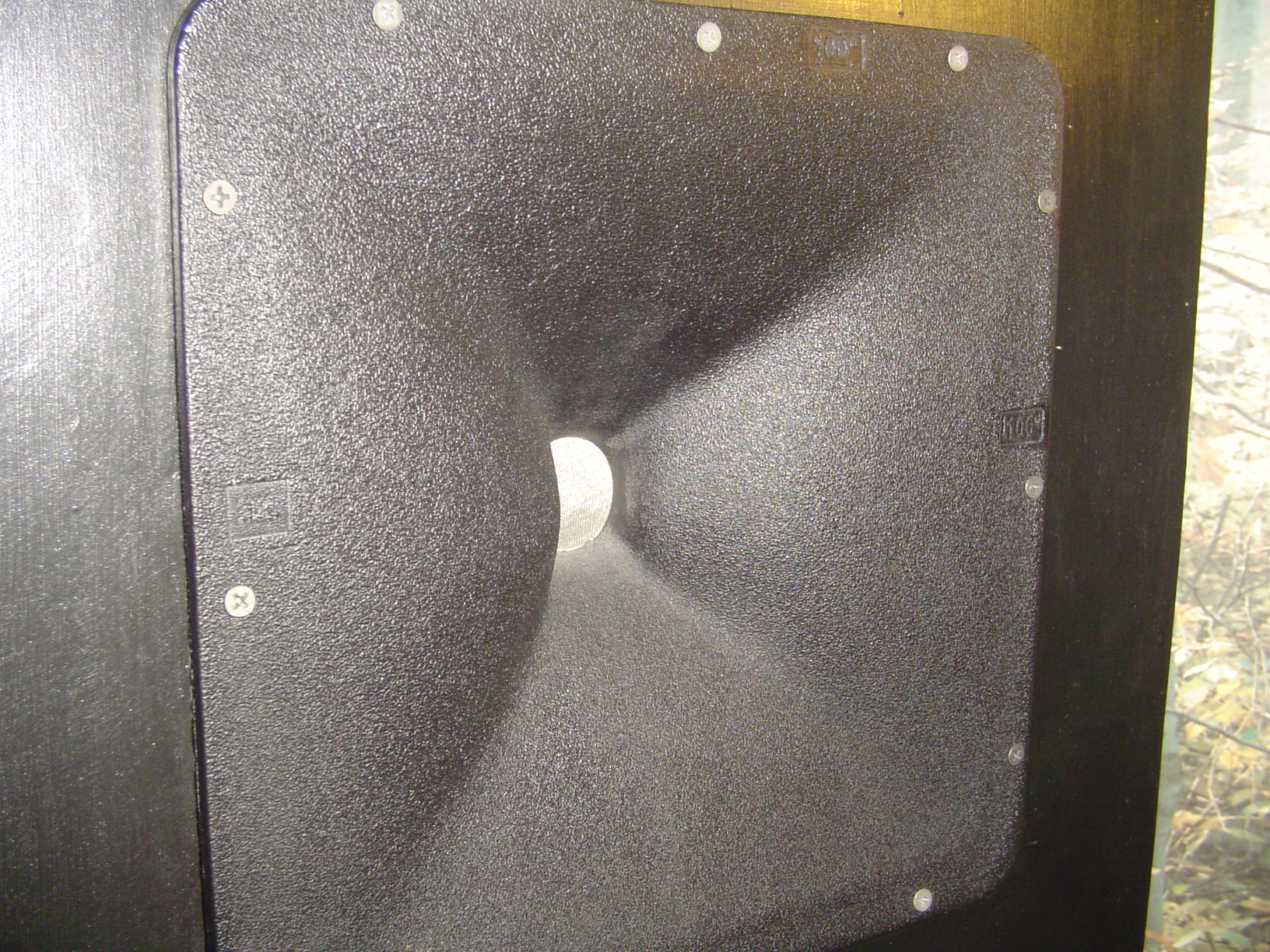

Robh and TurnItDown:
Both of you have used the 2344a quite a bit, and still find it to be a good setup. In your opinion, how do the older 2425 drivers perform? A couple of other questions, which I hope are not too far off the path for this discussion:
1. You both comment on mids that mate up well with the 2344a...what about a 12" mid? Too big?
2. The compensation circuit 4430: does a constant directivity circuit in an electronic crossover such as the TDM brand do this same function for the 2344a?
3. Strictly for the purposes of experimentation, is there anything inherently wrong with putting a 2344a on top of a vintage speaker that has a wide range, efficient 12" woofer? I'm thinking of bypassing the stock midrange horn and crossover in that speaker, and using the 2344a, and a 2404. Not sure if the 12" woofer is a good fit. It is not going to go low in the current 3 cf box, but that can be augmented, of course.
Appreciate your input. Thanks!

A twelve would work great and if you use a DC300 from PE you'll get plenty 'o bass in that size cab. Bonus #1 - it's less than $50 and Bonus #2 a crossover is already worked out. Just tune the box.
PS - some actives have horn compensation, but the 2344 is a different animal as you can see by the factory crossover. If you can run some curves on the cd/horn combo, we could suss out the compensation.
PPS - you'll just have to work out the box tuning. That woofer should play pretty well sealed too.

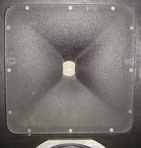

2425's are just fine IMHO. I use them in 4344 clones and they sound just fine. As far as a 12" no real issue look up the 4425 monitor.
Use the stock compensation network as a canned curve won't work as well. Now if you have DSP then you can dial it in.
The 2425 and 2344 run out of steam at about 17 Khz or so. I used them without and added tweeter. Sounded fine by me.
If you go with a 12 try to match the directivity at crossover so I think the 4425 used a 1.2K crossover point as a ballpark figure.

does the 2344a require to the compensation curve to get to 17khz?
Yes take a look at the spec sheet it's a true CD horn.
2344
The stock woofer is an alnico magnet, 100 db per 1 watt jobbie.
Are you doing active or passive crossovers?? If your woofer is 100Db you may have an issue using the stock 4430 compensation. It's a passive compensation and it bleeds off midrange sensitivity. It was designed to work with a max sensitivity of 96db 4435. May be OK but something to think about.
