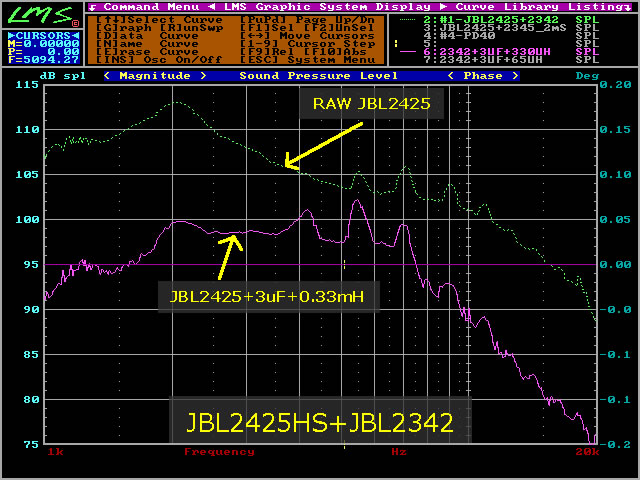

So, the z peak at 1,600hz using the pth1010hf-1 horn, that is probably horn length (mouth to diaphram distance).
I know that horn is 3" deep, or 1/4 wavelength of near 1,100hz.
Seeing that it is basically conical but rounded throat and rounded at mouth to baffle, i think it may not load as well down lower (people say about conicals, drooping at low end), but less horn reflections are most important to me. I was hoping to get flat response on that horn to near 1.2khz for crossing to a 12.
Ideally the horn loads down maybe 1/2 octave below crossover point, but using 24db lr, you are already 6db down at x-over point and rolling fast, so it may not be an issue.

And yea, resonances can be eq'd flat but still ring in time, and sub harmonics sneak around a notch and the cone rings again.

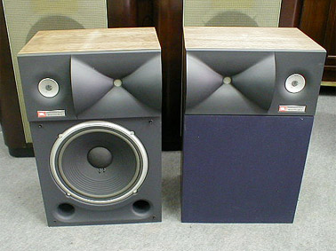

I found an interesting jbl horn, marked for japan as 4400 line, less vulgar than the butt crack horns.
Jbl 4425 Mk2
Jbl 4425 Mk2
