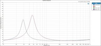

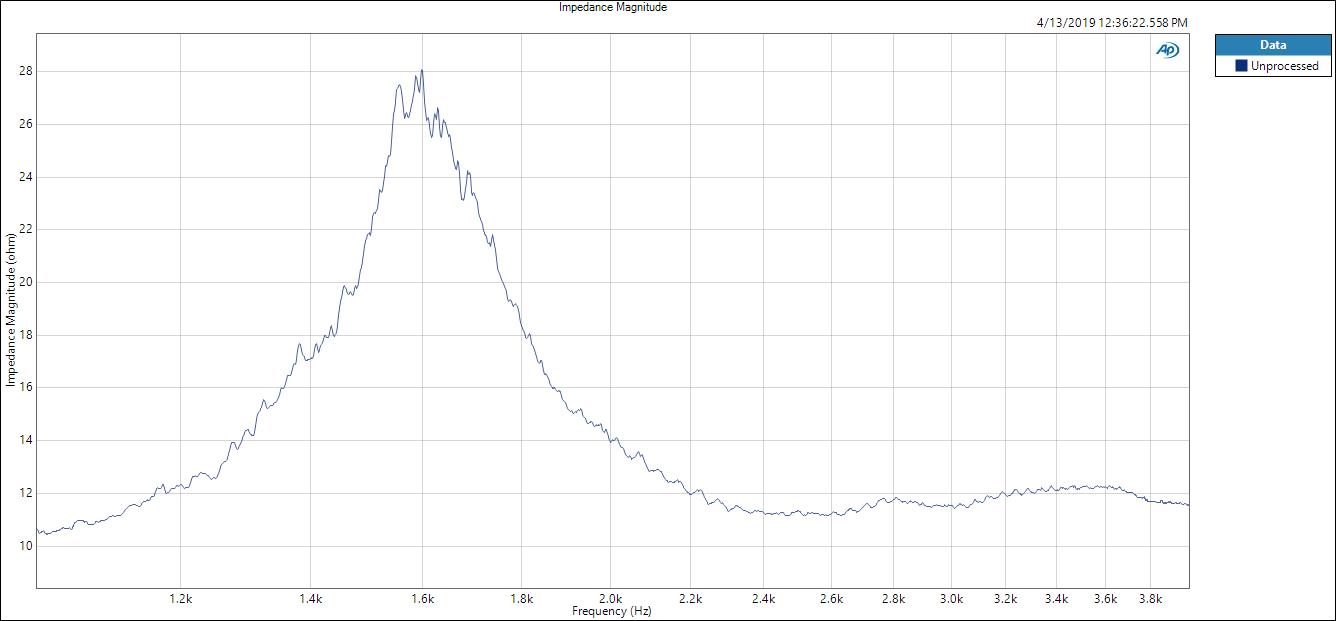

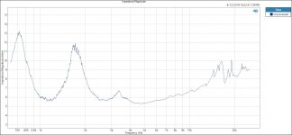

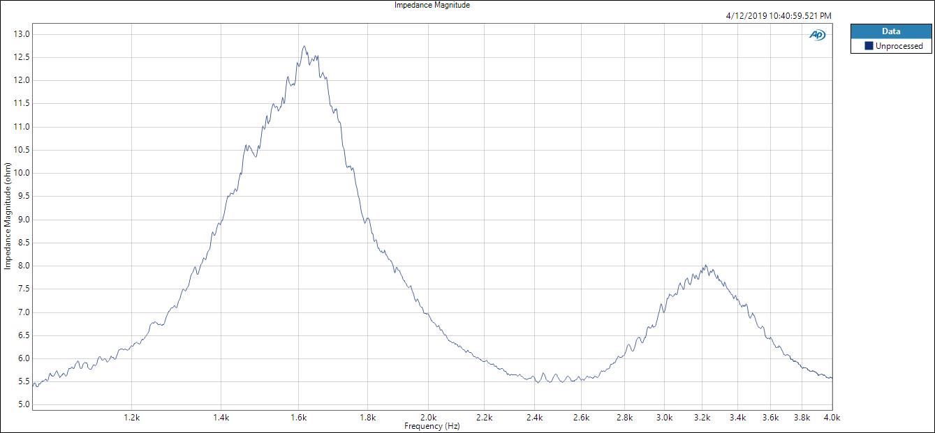

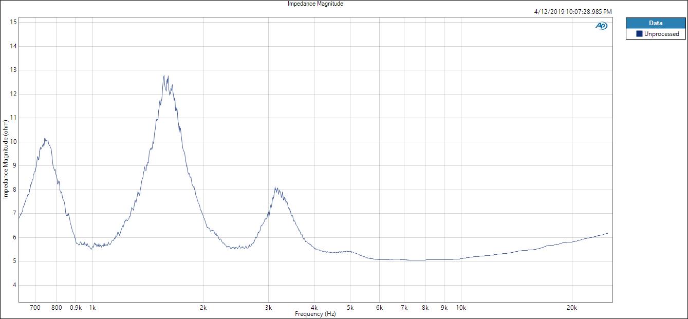

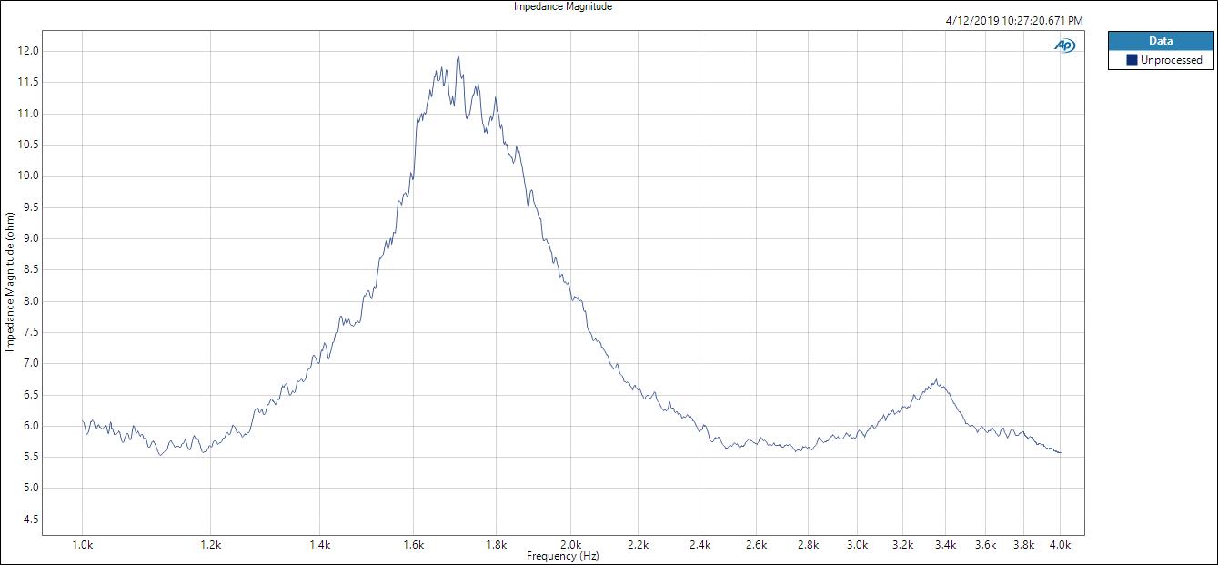

Hello All,
Had a good couple of days testing things, would have tested more but went to the beach instead.

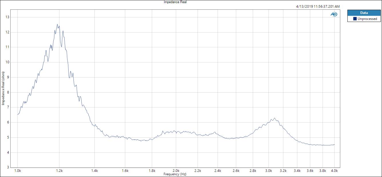

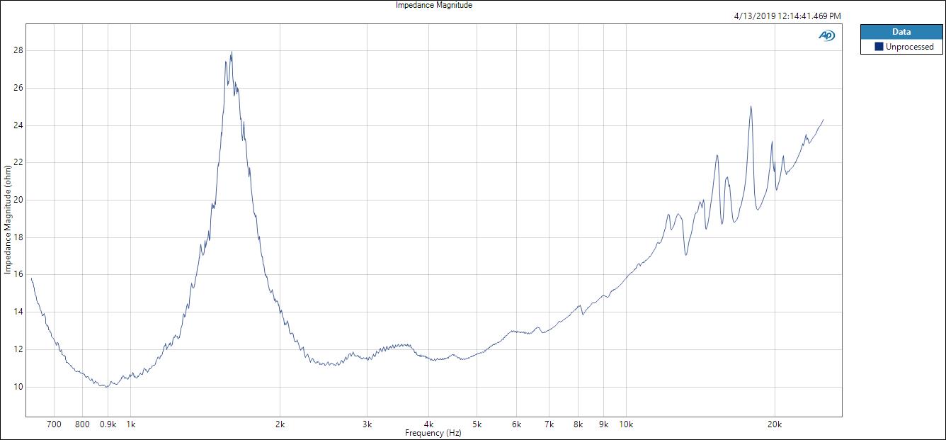

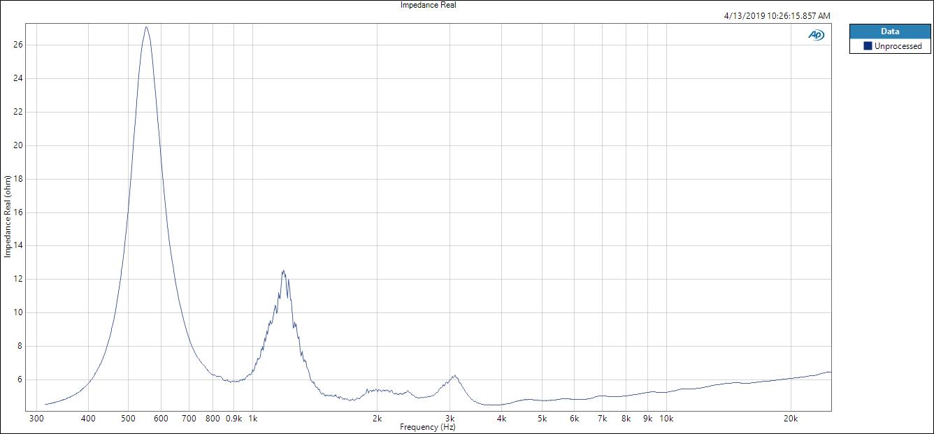

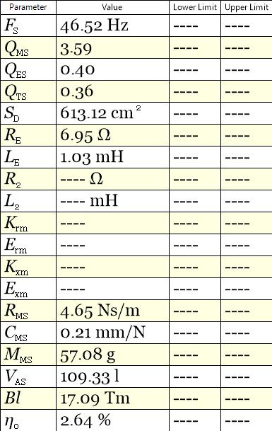

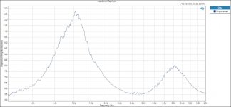

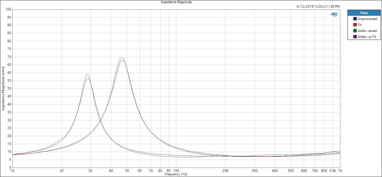

Tested TS / P for several woofers trying out for the woofer job in my new mains project, results are saved on a thumb drive. See the sample curves and TS /P for the 2204H.
Tested impedance with the PT H1010HF-1 waveguide (the new one) with several drivers; 2432, 2451J and D2. I will post these in this thread.
Also tested the smaller version of the JBL Butt Cheeks the 2342 with a 2425HS driver. I will also post this one.
One thing worth noting is that the impedance plots for the cone drivers and CD / waveguide look completely different. In my head this helps explain the reason that cones and horns sound different.
Similar to the cones all of the CD / Waveguides have what I call a voice coil impedance / resonance peak. The CD / Waveguides also have what Rob calls a Throat Mouth impedance / resonance peak.
Another thing in the CD / Waveguides curves absent in the cone curves is what I call Micro Resonances. At first glance they look like sort of random saw teeth. I plotted and replotted the CD / Waveguides curves many times on the same graph. Each plot fell exactly on top of the previous plots with each MR exactly matching the previous plots. These MR’s are not random noise or artifact.
Attachments are:
JBL 2204 H impedance curves; in air and with added 93.5 gram weight and TS / P table.
JBL PT H1010HF-1 with JBL 2432H driver; Full band width and zoomed in 1K to 4KHz.
Thanks DT
